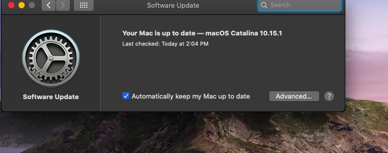

First of all thanks to DosDude1 for the 1.2.1 patcher. Used the patcher to download latest Catalina OS 15.1 and installed it over existing Catalina OS 15.0. (Also made my USB bootable Drive). Every thing went smooth without hiccup. Apparently, it made me loose airdrop and handoff/continuity totally. Now I have to apply all those ktext, sh commands through terminal which is an agony. Wish a followup Patcher could be made with all unsupported mac models and their respective ktext for smooth install of airdrop and continuity. I have the MacBook Air 4.1 mid 2011. Someone with good command on Terminal can surely make this patcher just like DosDude1 has done for the community. Thanks to all again for helping out.
Finally ran all sh commands for Airdrop as well as handoff , logged out/in to apple ID and now all is working perfect. Only loss is Airplay since graphics card does not support Metal. (SAD).

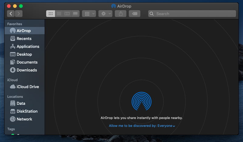

my laptop is Macbook Air 2011, is there anyway to enable AirDrop in Catalina ?
Thnx
check here
AirDrop Catalina patched MacBookAir2011 4,2.zip
Ensure your MacBook Air model is 4.2 to use these files which are machine/model specific.
