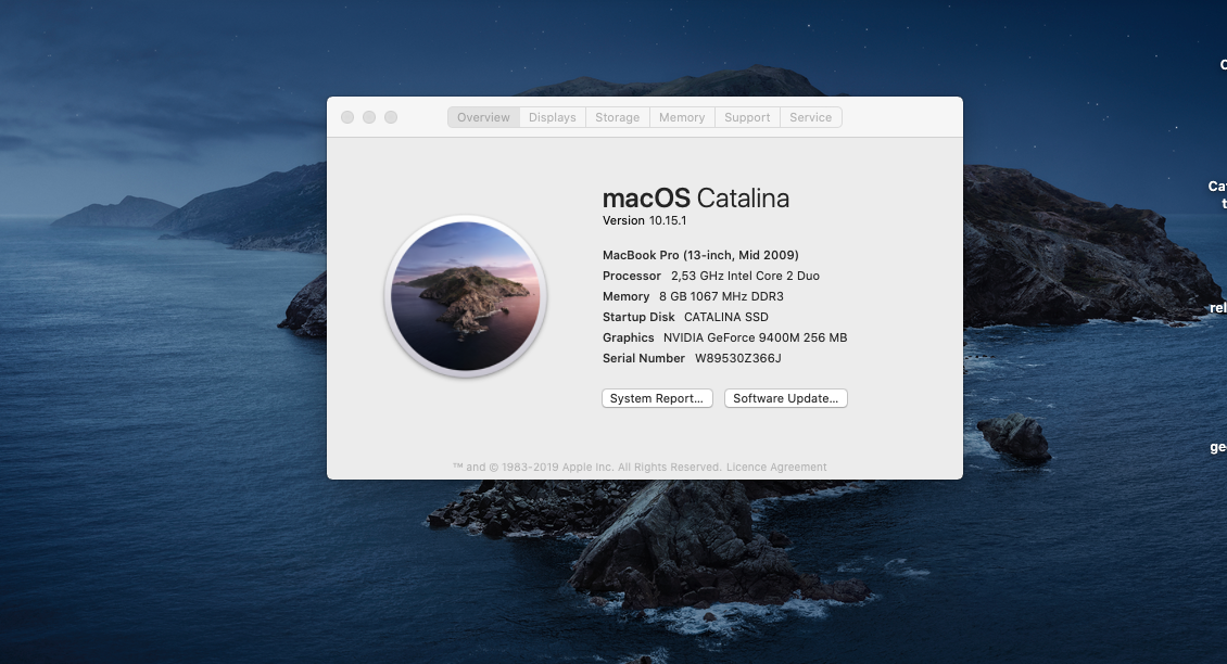

hello guys, first of all a big big thank you to dosdude1 for all his fantastic work !
that being said, i have a MBP 3.5 (late 2009) last night i upgraded to 10.15.1 from 10.15
when i tryd to install the update directly to the hd it did not work and booted to the old version.
i made a USB drive and all went well and i'm on 1.15.1 now ! :) ofcourse i have the same issues as many of u guys like airdrop no showing, imovie crashes among other things but overall i'm pretty happy with all
again a big thanks to Dosdude1 for making this possible !
p.s.
is there a way to enable airdrop on a MBP 3.5 ?
Reactions: TimothyR734
Always ensure your SIP is disabled by entering command in terminal status csrutil . Since we are using patched os on our unsupported macs this step is very important. Then use the 1.2.1 patcher to install over your existing 1.5.0 Catalina.
Perfect... Now on 10.15.1 :)

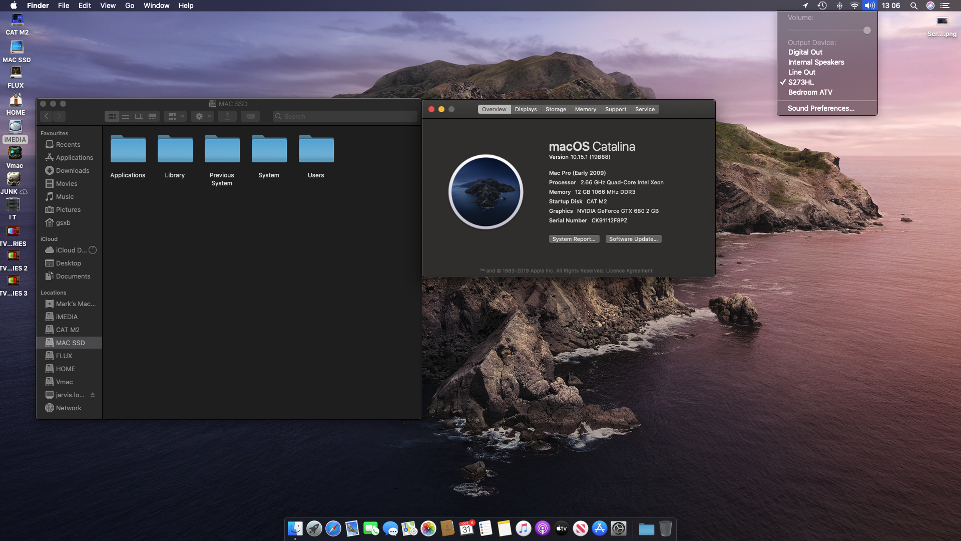

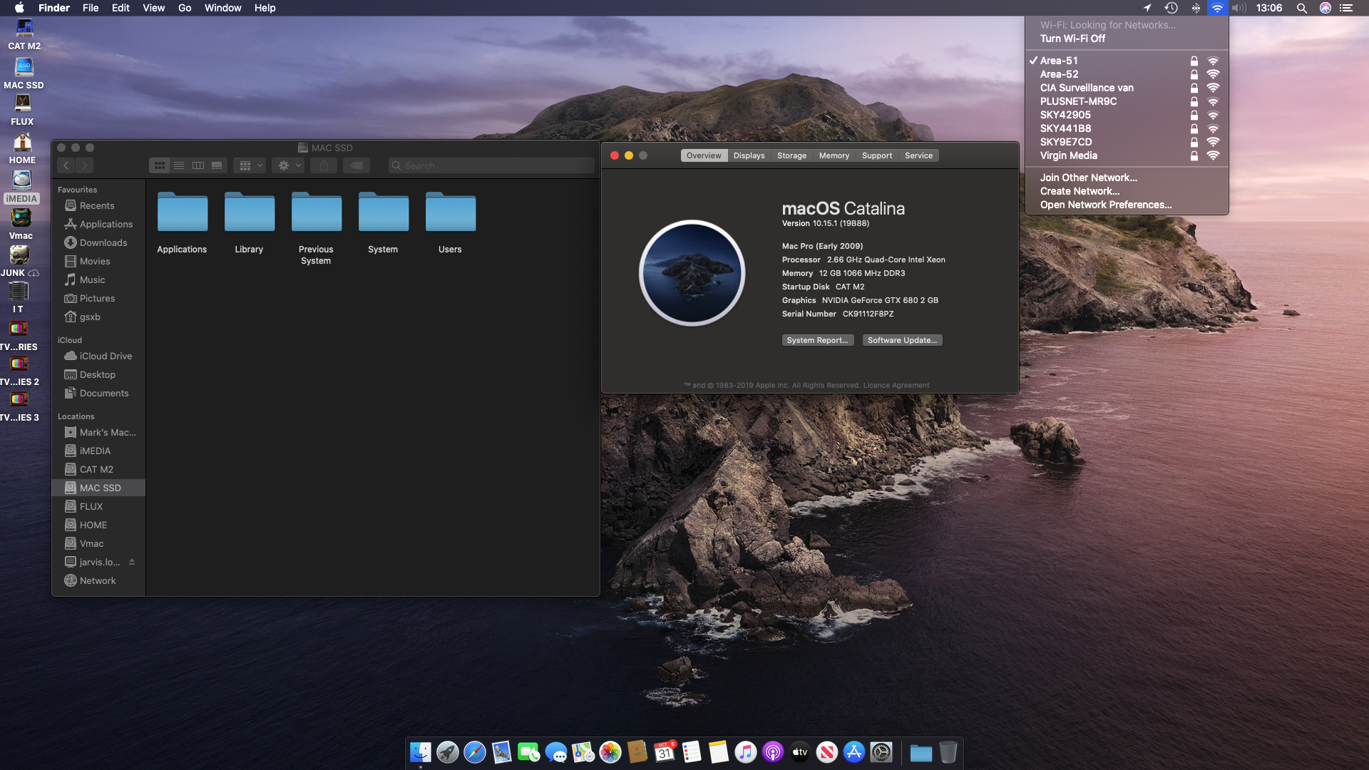

10.15.1 installed with no patches from the patcher,
alll working fine. Added Lilu, innie and appleALC HDMI sound working
all pci drives now seen as internal
So you mean, You could install original Catalina without any patches to your system ?
if yeah, how ?
if yeah, how ?
I deselected auto patch and used the patcher to create the usb installer, then used it as normal to install Catalina. I used “ hacktool “to install the WiFi kext I had from a previous beta build all usb and sound are working as the should
if yeah, how ?
How this is possible?
Hello
In MP4,1 & 5,1 no post-installation patches are needed.
Only the creation of a patched USB stick is necessary to install Catalina.
The only fact that Apple does not allow the installation of Catalina on these machines is that they are not originally equipped with Metal capable GPU and the WiFi card is no longer supported.

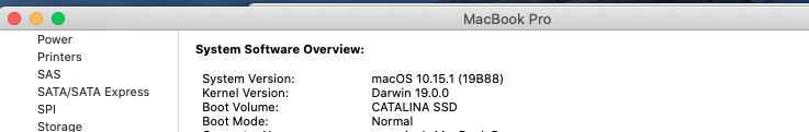

p.s.
iMovie crash is because it's been updated to use Metal. You'll have to find an older version and then avoid updating it.
@jackluke has posted a fix for AirDrop.

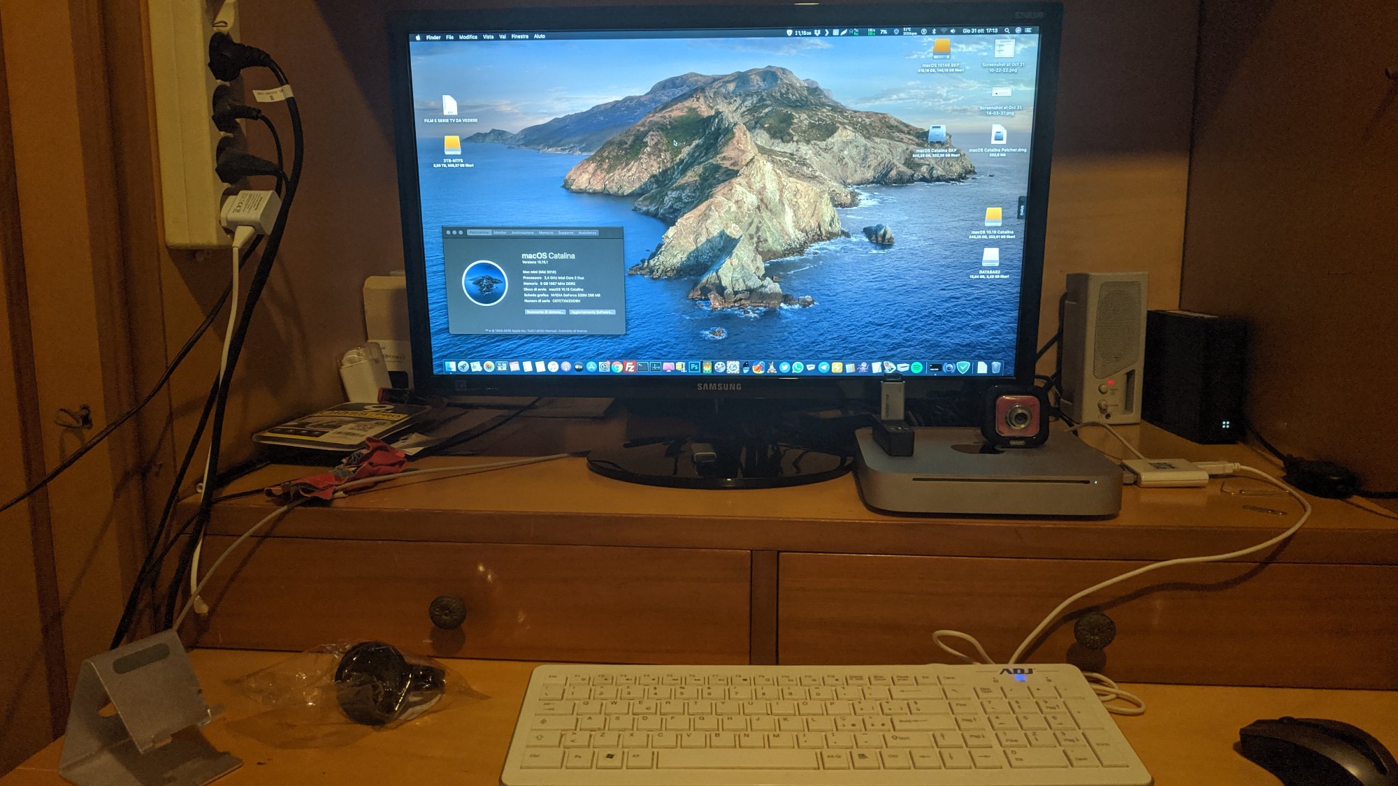

Hi, I recently installed Catalina on a Mac mini 3.1
It apparently works all good, but I had some strange errors at the boot saying that some images and png are missing. Is only my problem? Can I fix it in any ways?
Thanks
