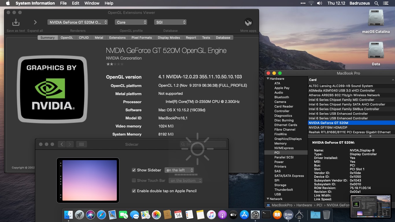

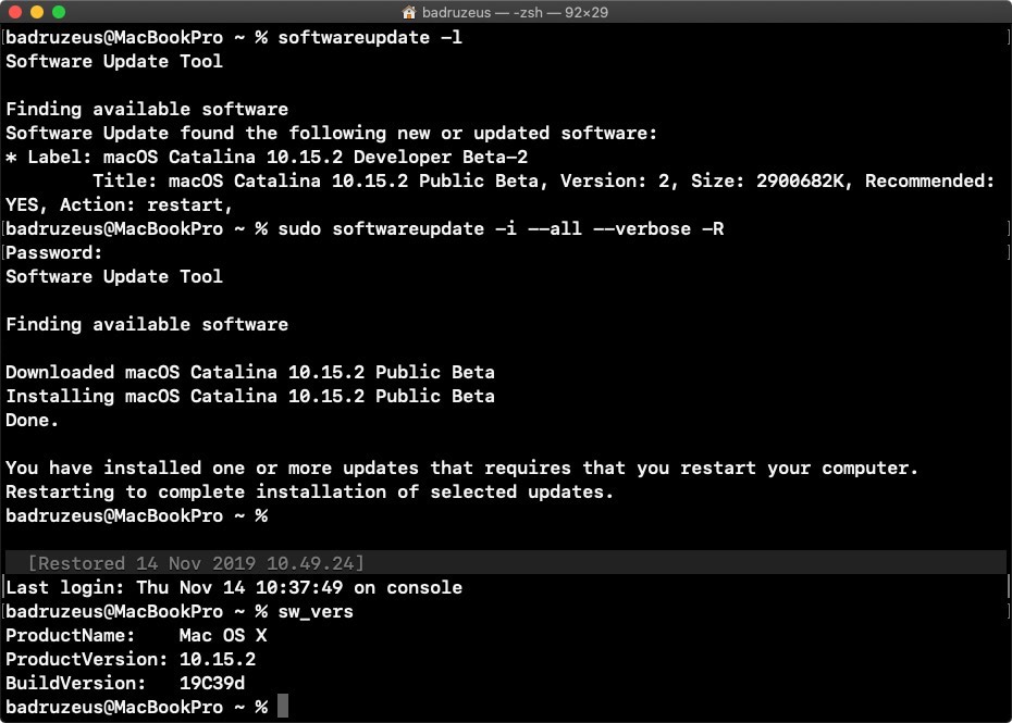

MacOS Catalina 10.15.2 second beta has been released by Apple.
macOS Catalina 10.15.2 Beta 2 should be good with non-Metal GFX.. Again, thanks @ASentientBot ;)
