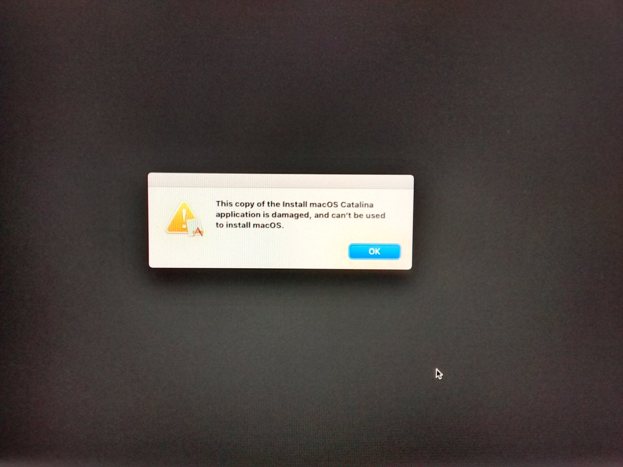

OK, let's try making a new USB boot drive, thought I to myself, thought I.
Patcher downloaded again, Catatonia installer downloaded again, USB drive built successfully. Reboot from USB drive, Recovery OS peers at drive and OKs it to boot from, Recovery OS menu appears. 'Re-install macOS' option chosen, then this:
At a bit of a loss now. Anyone with a MacBook gets to run Catatonia, and I'm not...
try a 32GB flash drive - this works, as I had a 16gb and Catalina didn’t like it - also make sure the patcher is downloading the installer.
Had the same issue when i used Mojave and it seems to be due to the time on the system. I set the date back in time a few months using the command date -u which did the trick as it was due to the signed bits.
hope this helps.

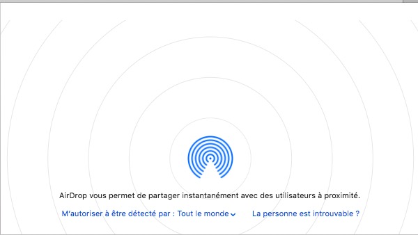

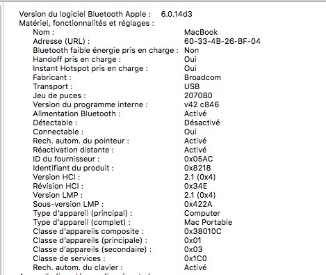

I followed all steps. Now I have aidrop detected by my macbook7,1 but doesn't work between my mac and my iPhone 7.
Handoff doesn't work neither.
I use this BT 4 dongle. Mpow Bluetooth
Do I need to deactivate the other 2.1 BT or maybe the dongle is defective ?
Please how can I know that the dongle is correctly connected and installed under macOS ?
Thank you

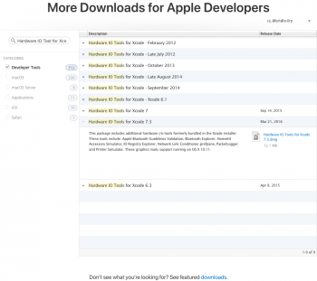

j'ai eu le même souci avec cMP5,1 après avoir branché un dongle Bluetooth 4.0 USB (Belkin), il n'était pas pris en compte.
Un outil Apple, "Bluetooth Explorer.app", permet de permuter les cartes Bluetooth. Il se trouve chez Apple dans la section des outils de développement (Additional Tools for Xcode).
Pour le trouver il faut utiliser la recherche et écrire: "Hardware IO Tool for Xcode"
Il y a plusieurs version disponible, j'ai donc choisi la dernière en date, qui se trouve être la version 7.3
J'ai donc téléchargé "Hardware_IO_Tools_for_Xcode_7.3.dmg" (Cette version à fonctionné sous Mojave et sous Catalina)
A l'intérieur du .dmg on trouve "Bluetooth Explorer.app" que j'ai enregistré dans Applications/Utilitaires (mais on peu aussi le mettre dans le dossier Applications).

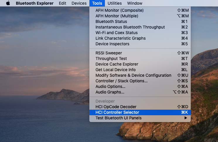

Afin de forcer la commutation il suffit de lancer "Bluetooth Explorer.app" puis Tool --> HCI Controller Selector

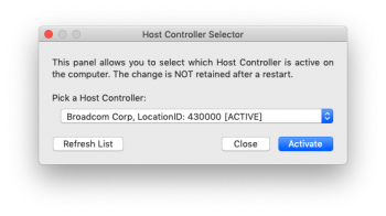

Dans l'image ci-dessous on peux voir que c'est la carte Bluetooth interne du mac qui est active et non le Dongle BT4.0 USB.
Pour permuter sur le Dongle BT4.0 USB, il suffit de le sélectionner puis de cliquer sur "Activate" cela prend entre 20 secondes et 1 minute (parfois cela ne fonctionne pas du premier coup il faut donc fermer "Bluetooth Explorer.app" et recommencer).

I had the same problem with cMP5.1 after connecting a USB Bluetooth BT4.0 dongle (Belkin), it was not taken into account.

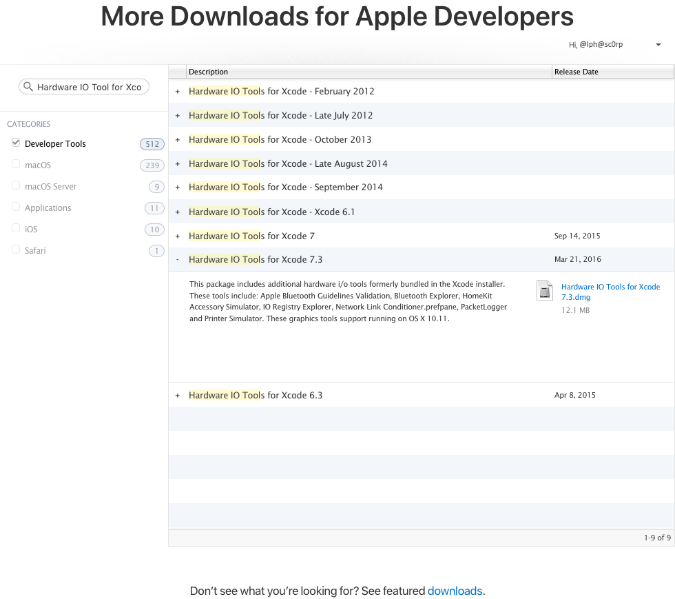

An Apple tool, "Bluetooth Explorer.app", allows you to switch Bluetooth cards. It can be found at Apple's Development Tools section (Additional Tools for Xcode).
To find it, use the search and write: "Hardware IO Tool for Xcode"
There are several versions available, so I chose the latest one, which happens to be version 7.3

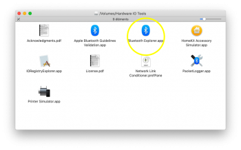

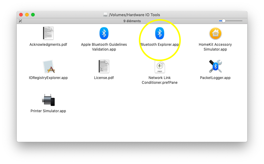

So I downloaded "Hardware_IO_Tools_for_Xcode_7.3.dmg" (This version worked for me on Mojave and Catalina)
Inside the .dmg we find "Bluetooth Explorer.app" that I saved in Applications/Utilities (but we can also put it in the folder Applications).

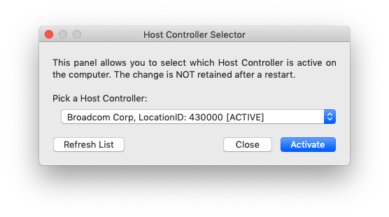

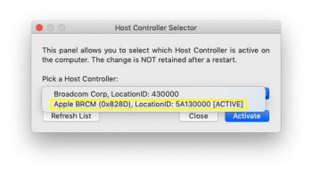

In order to force switching: launch "Bluetooth Explorer.app" then Tool -> HCI Controller Selector
In the image below we can see that it is the internal Bluetooth card of the mac that is active and not the USB Dongle BT4.0.
To switch to the USB Dongle BT4.0 just select it then click "Activate" it takes between 20 seconds and 1 minute (sometimes it does not work the first time so close "Bluetooth Explorer.app" and start again).
On the other hand if one has several OS on different disks/partitions during the changeover from one OS to an other one it is possible that we must re-execute the permutation from the USB Dongle BT4.0 to internal Bluetooth card.

OK, left system date as today to download Catalina installer (else browser sulks), then changed date to 2018 before using the Patcher to remake the USB installer drive. That completed, used the USB drive to boot from, checked the system date on Recovery Tools/Terminal session (still 2018), then ran the 'Reinstall MacOS' option. It failed again with the 'damaged' message. So date is probably not the answer.
And the answer is : SIP. Execute Dosdude1's patcher to create a clean USB installer, invoke Recovery OS, Terminal 'csrutil disable', restart with USB installer in place as startup drive, and after a while one has Catalina.
