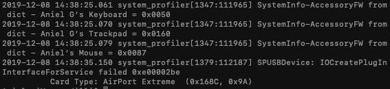

This is my board id Mac-942B59F58194171B, will the integer value change accordingly. But after applying my board id and giving following cmd in terminal:
iMac:~ dilli$ sudo /usr/libexec/PlistBuddy -c "Set:Mac-942B59F58194171B:ContinuitySupport true" "/System/Library/Frameworks/IOBluetooth.framework/Versions/A/Resources/SystemParameters.plist"
Password:
Encountered non-empty <true> on line 604
Error Reading File: /System/Library/Frameworks/IOBluetooth.framework/Versions/A/Resources/SystemParameters.plist
The plist command works. I think it's complaining about a preexisting error. Did you edit the plist manually before? Non-empty <true> means you have something like this in the plist file:
Code:
<true>hello</true>
You can verify a plist without changing it using the plutil command:
Code:
plutil /System/Library/Frameworks/IOBluetooth.framework/Versions/A/Resources/SystemParameters.plist
If it doesn't say ":OK" then you need to open the file and fix it manually. Go to line 604 and change "<true>...</true>" to "<true/>"

You need a BT 4.0 dongle for BLE function needed for Continuity features, but first the output of this terminal command: system_profiler -detailLevel mini | grep "Card Type"
To use continuity you need also that "Allow Handoff between" is showed as submenu in System Preferences / General settings: macos-catalina-system-prefs-general-dark-mode.jpg
and to enable this (either on Mojave and Catalina) you need a patched AirDrop Broadcom 4360 driver.
As I wrote earlier, AirDrop patch is needed to use continuity features, so for @Dilli from your attached you have enabled continuity on this unsupported board-id : Mac-942B59F58194171B
that should match an iMac12,2 so you need AirDrop, and to check if a patch is possible I need the output from your iMac12,2 Catalina Terminal: system_profiler -detailLevel mini | grep "Card Type"
if the output string is "0x14E4 , 0x9* " or higher, then a patch is possible, otherwise no.
I got following result
So can I use a cheap BT 4.0 usb dongle with my iMac
Reactions: TimothyR734

0x168C is an Atheros Wifi card, for continuity features on Mojave/Catalina apple allow only the 0x14E4 Broadcom Wifi cards, so you need an upgraded wifi/bt4 card.
That finally sums up . @jackluke tsk. It seems another expense haha. The dead iMac seems to be asking for more. I rather just use Catalina without continuity /handoff feature. It isn't that important. As far as speed goes for a old machine I think the existing hardware should suffice. Tks mate for all help and inputs. 👍 :p
