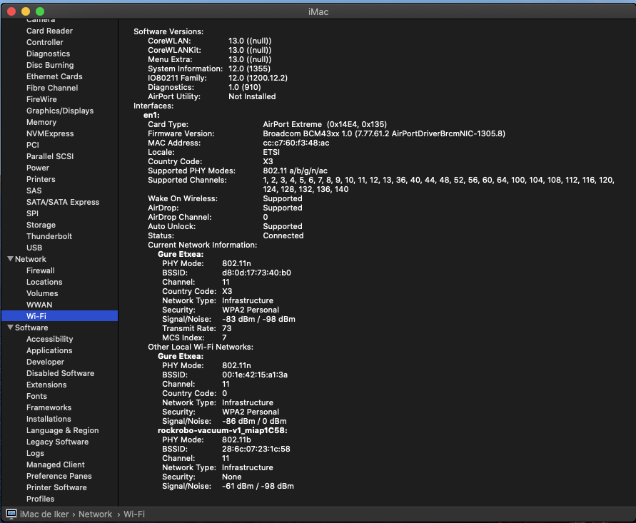

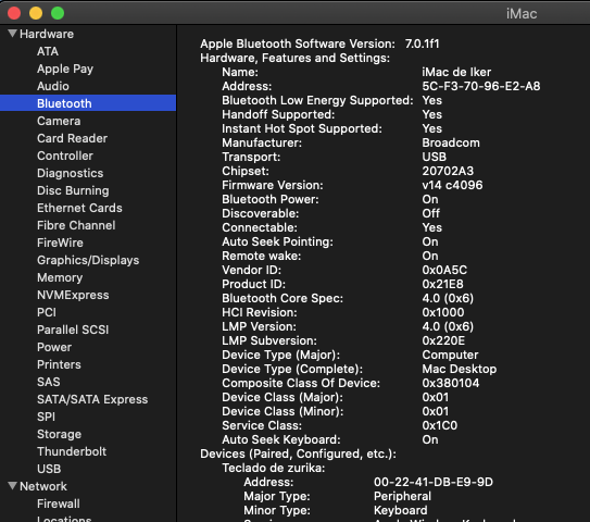

I have an early 2009 iMac with an Airport Extreme wifi card (pci14e4,43a0) and a Broadcom bluetooth 4.0 usb dongle.
Airdrop works well, however continuity sometimes fails when taking pictures or scanning documents.

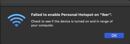

The main problem is that personal hotspot doesn't work, it's not possible to connect to any hotspot.
It is also not possible to unlock with iwatch.
I appreciate any help to solve this problems.

You have "0x14E4, 0x135" that is a Catalina supported Broadcom Wifi 802.11ac , and Bluetooth 4.0 usb dongle is correctly detected, I'd advise to use the stock Catalina IO80211Family*.kext without any Wifi Patches, and also check if from Catalina Terminal: open /System/Library/Frameworks/IOBluetooth.framework/Versions/A/Resources/
open with any plain text editor the SystemParameters.plist and search inside for your Mac-F2218FC8
that the Continuity Support is <true/>
Code:
<key>Mac-F2218FC8</key>
    <dict>
        <key>ContinuitySupport</key>
        <false/>
        <key>DID ProductCode</key>
        <integer>18953</integer>
    </dict>
also check that in System Preferences / General the "Allow Handoff between" is selected.
If still not work, try to sign-out and sign-in again from System Preferences / iCloud prefpane.
Moreover if you are using a third party Bluetooth 4.0 usb dongle try this patched file that should fix those continuity unstable features: https://forums.macrumors.com/threads/macos-10-15-catalina-on-unsupported-macs.2183772/post-28016436

Could you make me a patch for my machine iMac 12,2 Board Id is Mac-942B59F58194171B for Airdrop.
So much of copy pasting I lost some files and feel confused. Tks
Update: I tried copying legacy Airdropinfoview file & even dropped whole contest of Mojave.zip folder in the location you posted on your post. After reboot I don't see any Airdrop on side bar.
I finally got Catalina installed. All went smoothly. If I have to loose out to BT/wifi at the cost of Continuity/handsoff I will hold on for sometime as it would be by ordering a Broadcom wifi/bt combo card then wiring an adapter to a 3 volts usb circuit etc. which I would avoid for the time being.
But If I use your cmd for activating airdrop will it work . I will just try it though.
