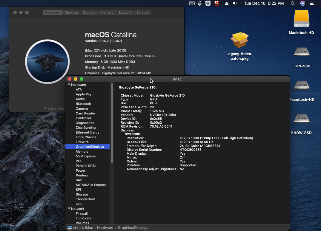

Ok legacy Video Patch works on 10.15.2 (19C57)
:cool:

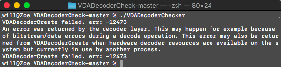

I've been working on the remaining acceleration issues on non-Metal systems (bad performance in some websites, lack of video decoding acceleration). I think I've made some slight progress, though I'm not entirely sure what to make of it.
This tool VDADecoderChecker reports the status of video decoding acceleration. On a supported Mac (or unsupported Mac running ≤ Mojave), it reports the following:
On unsupported Mac with Catalina (or at least on my MacBook7,1 with nVidia Tesla) it shows:
However, by copying this file from High Sierra (or, I assume, Mojave -- will test and update but I had only a 10.13 system readily available at the time):
/System/Library/Extensions/AppleVADriver.bundle/Contents/MacOS/AVA_HD_VP3.dylib
I am now getting the success message. Performance on websites like slither.io is still awful, though, compared to on Mojave. As for video playback, I never had any particular issues in the first place. So this may be meaningless or just one piece of the puzzle.
Any ideas?
As always, I'll report back if I find anything else... :)
Edit: I am also able to watch an episode on TV app, but it's very finicky. Edit 2: that's actually also the case without this patch. So, I'm pretty sure this does next to nothing other than making one specific command line tool happy...
