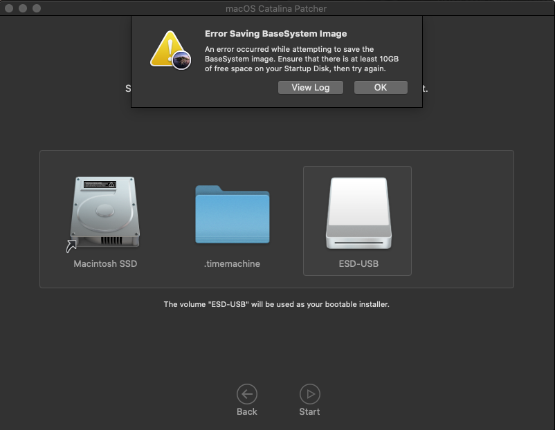

Hi Dosdude1. Thanks for quick update to version 1.3.0. However, after downloading Catalina version 10.15.2 find that I cannot create the USB Installer. I am getting the following error....Please advise how to fix as I am using a 32GB USB drive.View attachment 882032View attachment 882033
Having same issue. MBP 9,1 and cMP3,1 neither can make a bootable usb no matter what size drive I use. Also, cMP3,1 gives same error if I try in place install.

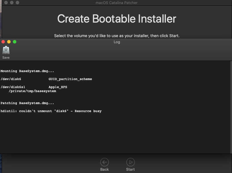

Hey Guys, I need your help.
I tried to make a bootable Stick with Catalina for ma iMac late 2009. On High Sierra it worked perfect but now I got this Error:
"/dev/disk5 GUID_partition_scheme
/dev/disk5s1 Apple_HFS /private/tmp/basesystem
Patching BaseSystem.dmg...
hdiutil: couldn't unmount "disk5" - Ressource ist belegt"
i also have tried different usb sticks and different Macs but same problem. should I format the usb stick with GUID or Master Boot?
thanks guys
Reactions: TimothyR734
Refresh the webpage, your cache is out of date.

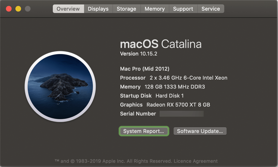

Successfully updated my Mac Pro 5,1 with Radeon RX 5700 from Mac OS 10.15.1 to 10.15.2 by doing the following:
Downloaded version 1.3.0 of macOS Catalina Patcher.
Used macOS Catalina Patcher to download a copy of Mac OS 10.15.2.
Used the 'install on this machine' option.
Installation took about an hour.
On reboot Patch Updater automatically updated the Night Shift patch.
Everything works well.
