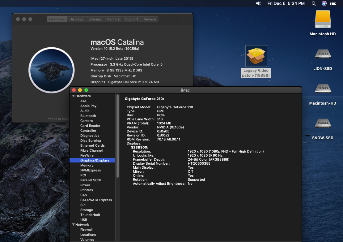

Alright the Legacy Video patch work again on 10.15.2 B4
BIG Thanks to ASentientBot :D
I will Update on Github

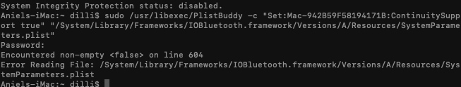

My SIP is disabled but I cannot get Continuity Terminal command to complete. Getting following error.

From Catalina Terminal:
ioreg -l | grep board-id
You have made me expert in terminal cmds haha.
This is my board id Mac-942B59F58194171B, will the integer value change accordingly. But after applying my board id and giving following cmd in terminal:
iMac:~ dilli$ sudo /usr/libexec/PlistBuddy -c "Set:Mac-942B59F58194171B:ContinuitySupport true" "/System/Library/Frameworks/IOBluetooth.framework/Versions/A/Resources/SystemParameters.plist"
Password:
Encountered non-empty <true> on line 604
Error Reading File: /System/Library/Frameworks/IOBluetooth.framework/Versions/A/Resources/SystemParameters.plist
I copy pasted the paramaters.plist after editing on desktop with my board id and adding value true. I restarted the iMac but I don't see hands-off activated in preferences.

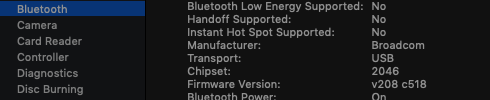

I think my iMac 2011 is not supported for Hands-off as it does not have low latency Bluetooth 4.0

How do I whitelist my USB Bluetooth 4.0 dongle to use the continuity features with a third party BT 4.0 dongle?
As I wrote earlier, AirDrop patch is needed to use continuity features, so for @Dilli from your attached you have enabled continuity on this unsupported board-id : Mac-942B59F58194171B
that should match an iMac12,2 so you need AirDrop, and to check if a patch is possible I need the output from your iMac12,2 Catalina Terminal: system_profiler -detailLevel mini | grep "Card Type"
if the output string is "0x14E4 , 0x9* " or higher, then a patch is possible, otherwise no.

On iMac12,2 not, but only if you have an upgraded combo Wifi/BT4 card.
In this case, from Catalina terminal try:
Code:
sudo chown -R 0:0 /System/Library/Frameworks/IOBluetooth.framework/Versions/A/Resources/SystemParameters.plist
sudo chmod -R 755 /System/Library/Frameworks/IOBluetooth.framework/Versions/A/Resources/SystemParameters.plist
restart, then try to sign-out and sign-in again from System Preferences iCloud prefpane.

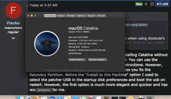

If I upgrade to an unflashed NVIDIA GPU, is there video when using dosdude's cat installer when I choose where to install Catalina? If not, how do you install in this configuration?
I have responded about the GPU on your link. For installing Catalina without a boot screen I do this on my cMP5.1 with the RX580. You can use the "Install to this machine" option and just follow the instructions. However, worth having a current patcher USB as a backup unless you fix the Recovery Partition. Before the "Install to this Machine" option I used to select the patcher USB in the startup disk preferences and boot the usb on restart. However, the first option is much more elegant and quicker and has worked well for me.
@Syncretic is that of any value?

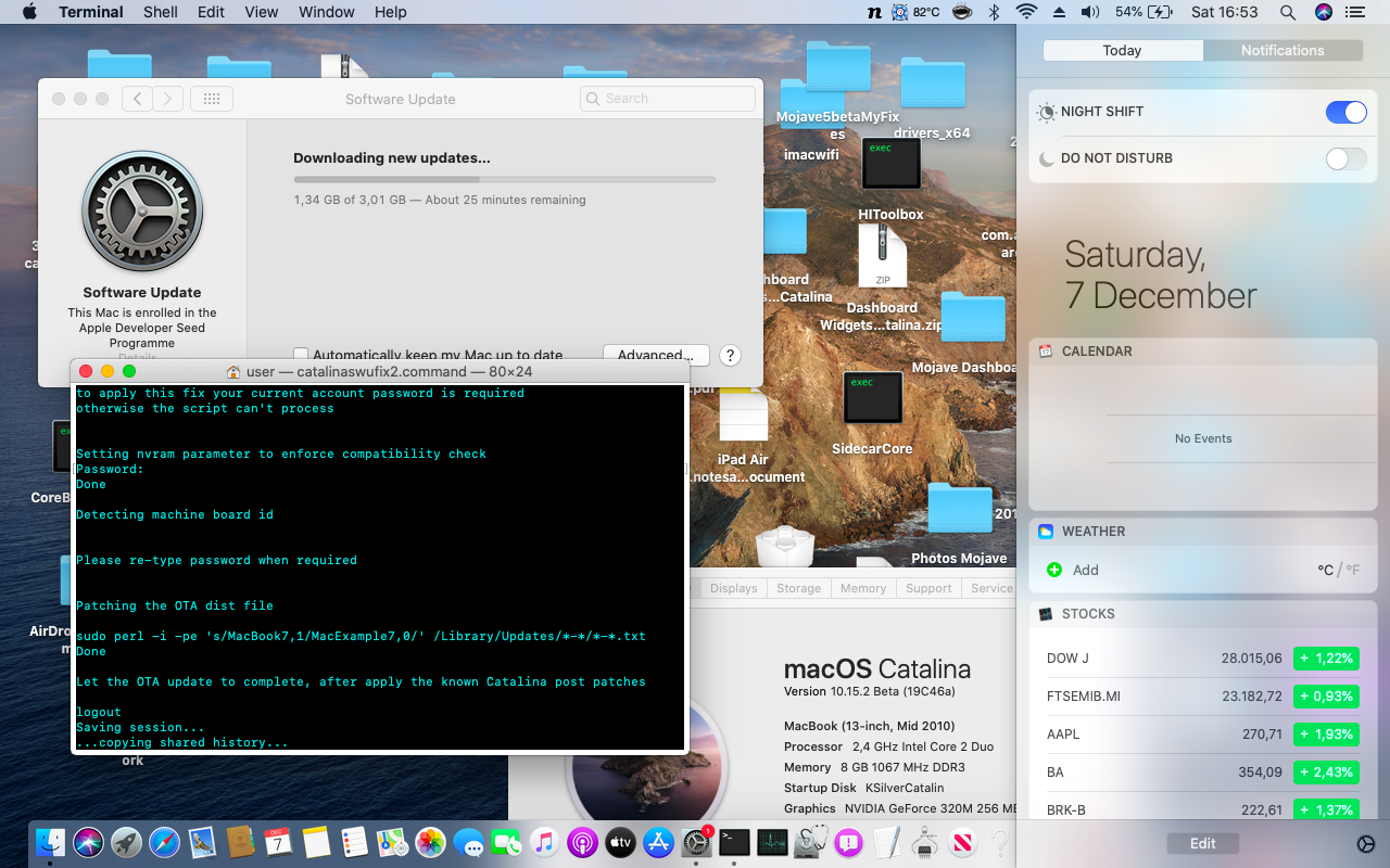

To those interested in Catalina OTA updates, using the @Pinarek method, I just wrote a little script that automatically whitelist the unsupported machine, note that this script must be launched after applied the dosdude1/Czo Software Update patch and when at least about 3% of OTA downloading is done, to allow apple to create your XXX-XXXXX unique product ID language updates folder.
This script should work without issues.
I repeat the steps:
- Launch the Sierra's Software Update patch by @dosdude1/@Czo (swupatch.zip)
- Detect the Catalina OTA update from System Preferences and click "Update Now"
- When downloading progress bar is ≥ 3% , launch my attached script (catalinaswufix2.zip), for safety you can also re-apply the script before OTA update invites to Restart.
Let the OTA update to autocomplete, and after re-apply the Catalina post patches.

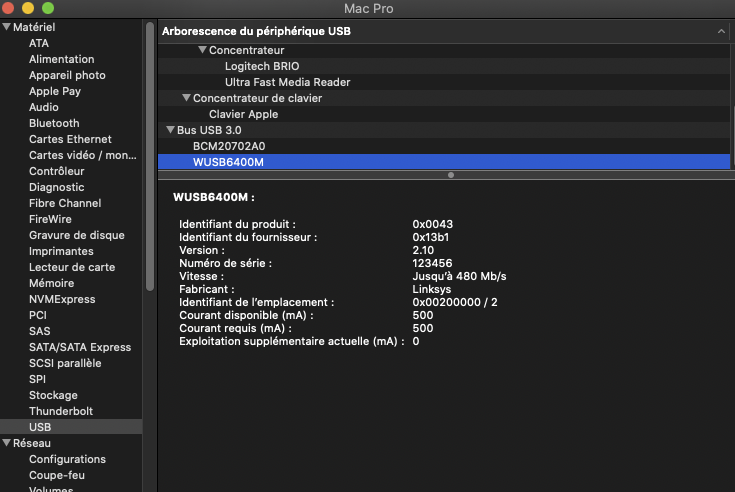

Bonsoir,
I have a Linksys usb3 Wifi dongle (WUSB6400M) but, actually, it doesn't work with Catalina, even with the "drivers" supplied by Linksys (this program is not compatible with your OS version...)...
Too bad !
Any idea from the experts ?
Many thanks in advance,
Serviteur

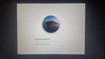

Concurring with the "Install to this machine." option to install Catalina, in fact, it was the only method to install Catalina on two (2) Mini3,1. After numerous attempts trying different USB sticks, different Macs, date jiggling, etc. altogether have been unable to make a functional USB Catalina Patcher using the same Catalina installer which installed perfectly with "Install to this machine."
The weird USB install method breakdown was never present with Mojave or High Sierra as some have also reported, here. Making "Install to this machine." the only way to go and "is much more elegant and quicker and has worked well for me." (Flacko)

Tried it, but doesn't work !
The Wifi adapter is recognized as :
...but nothing? The LED on the adaptateur is orange.
Edit : seems to work now with a reboot and a reinstallation of the post-install patches (@dosdude1)
Serviteur
It's the @chris1111 Wireless usb driver that made it to work, since from Catalina AFAIK there is no available third party driver for external usb wifi dongles, instead it is "emulated" through an "ethernet adapter" and a third party "Wifi.app" for network wireless scan.
