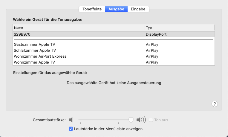

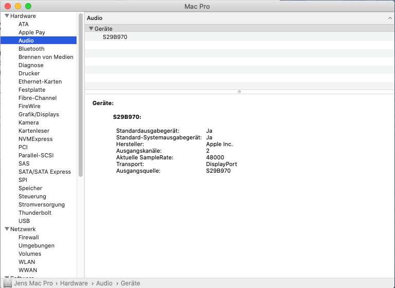

Catalina 10.15.2 on cMP 5,1 audio?
Quick question as I was unable to find an answer by searching the forums. Does the internal audio of a cMP 5,1 with DosDude1 Patcher 1.3 on Catalina 10.15.2 work?
On my system the audio devices do not show up. DP Audio via the AMD RX 580 is working fine to the display.
Thanks much and Happy New Year!

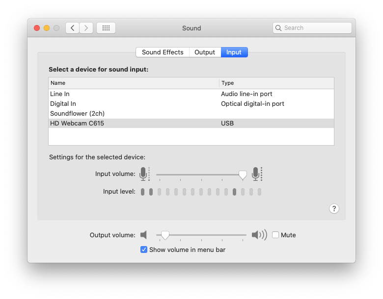

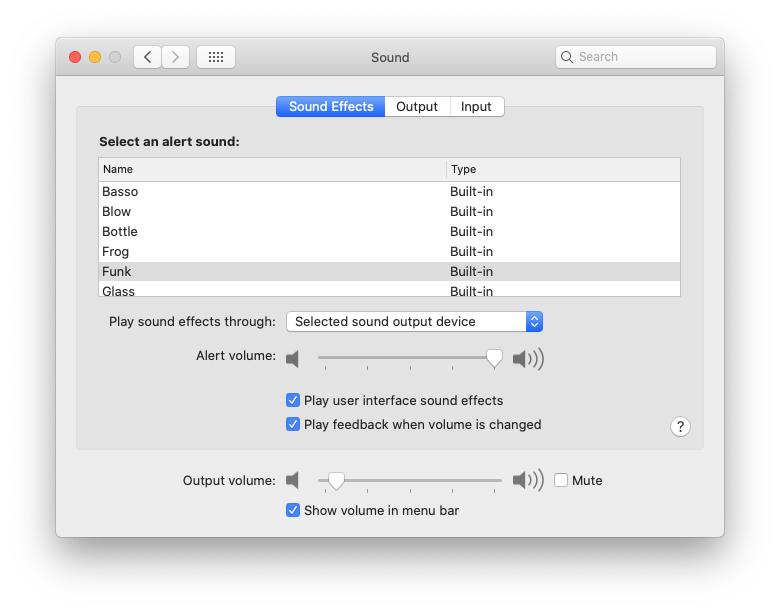

The audio on my MP51 is no different under Catalina (using @dosdude1 patcher) than it is under any other version of macOS. It works fine here.

Try booting back in the Catalina Patcher and reapply the legacy audio patch only and see if that works :)
There is no need to do that in a MP51. The Audio is supported properly out of the box.

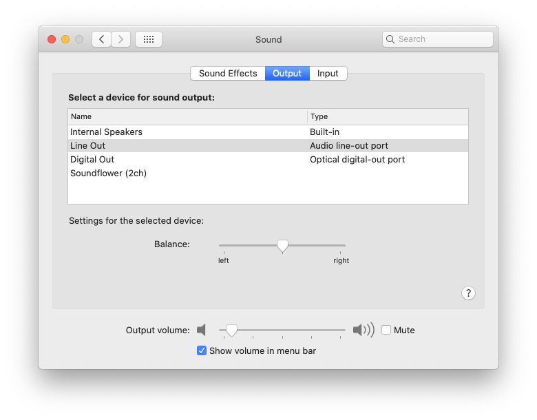

[automerge]1577819873[/automerge]

Problem solved.
Somehow when I transfered the Catalina installation from the SATA to an NVMe SSD it became "corrupt" in some strange way. Neither the source volume nor the destination volume showed the internal audio hardware.
I installed Catalina again onto a separate partition using DosDude1 Installer and the audio hardware was shown again. I then re-installed over the top of the existing installation on the NVMe and everything is working again now.
