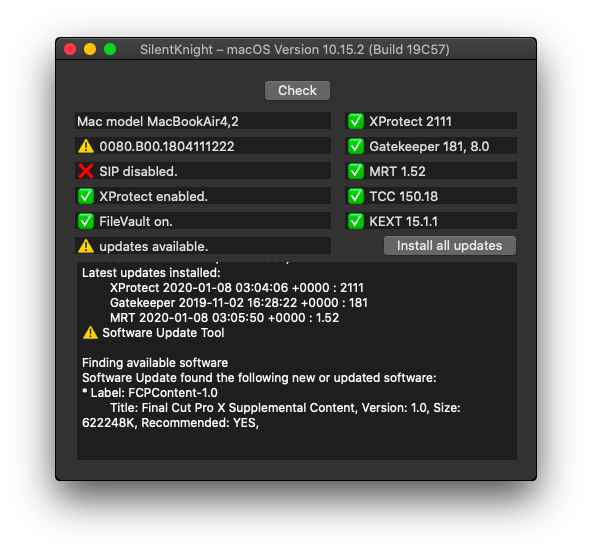

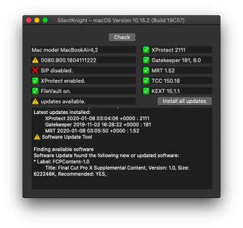

Have a question to @dosdude1 or someone else who can explain this strange thing...
Today launched SilentKnight to check for updates of core modules like MRT, etc... like on screenshot included.
After program notified me that I have updates available, just in same time native system updater notified me about available updates too! And I successfully install update by system updater. So its working but in some strange way or what? Or system updater can update all except system? Please explain some who can, thanks!
