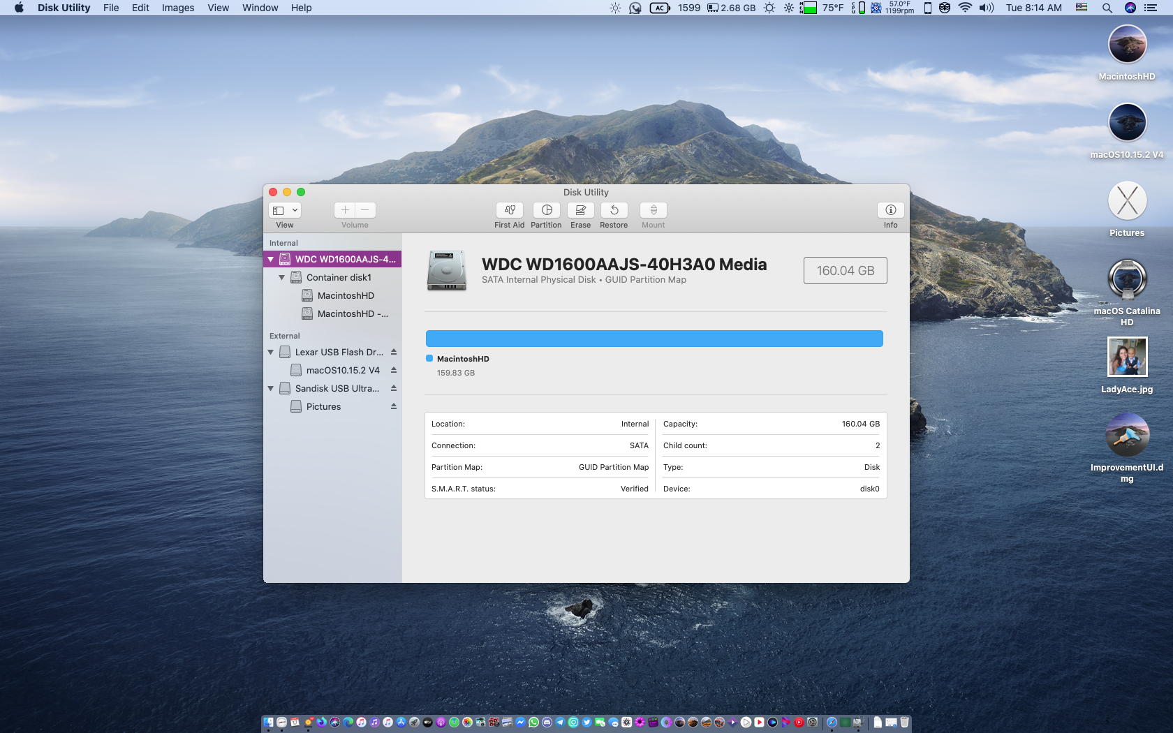

so I was able to get the catalina patcher on a USb. was able to make it a boot installer. it lets me select it when I restart my mac, im able to go through the install process but as its about to finish i get this error message
"could not create a preboot volume for apfs"
I think proceeded to try and delete the partitions and start fresh. but im unable to successfully get past this step, im not even sure if the partitions are deleted because it still says I have about 50gb used.

From your Catalina Patcher using disk utility click on View-Show All Devices then click on the top one like I have highlighted you can try erase use APFS then try to install Catalina again if that doesn't work go through the steps again but instead of erase you Partition- then select APFS
thank you so much!!!!!!
this did the trick I wasnt able to retain my bookmarks but atleast the mac turns on now!
I apperciate everyone in this thread who helped out
Reactions: TimothyR734

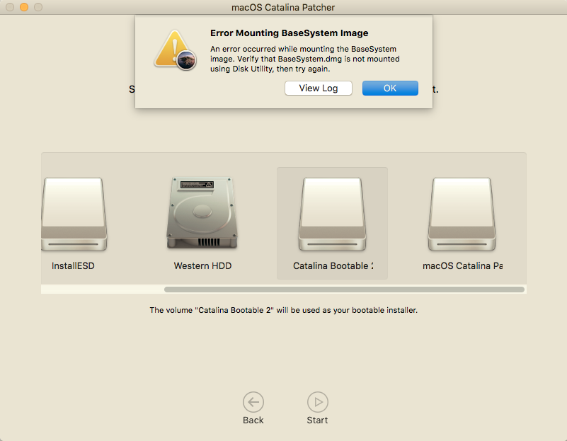

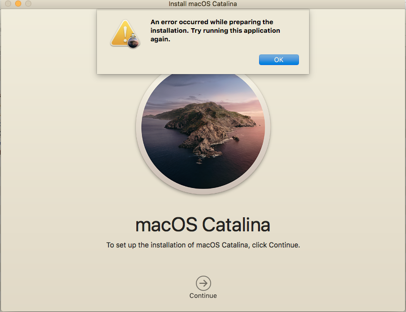

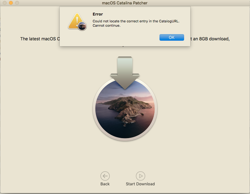

Hello good people
I need your help. The catalina patcher is not working for me at all.
When I select 'download' option I get this error:
"Could not locate the correct entry in CatalogURL"

When I select 'browse for a copy' with a first installer I sourced elsewhere I manage to make a bootable catalina drive but when I want to install from it I get this error:
"An error occurred while preparing the installation. Try running the installation again."

When I try 'browse for a copy' with a second installer from elsewhere, I can't even manage to make a bootable drive, I just get this error straight away:
"An error occurred while mounting the BaseSystem image. Verify that BaseSystem.dmg is not mounted using DiskUtility, then try again."

My SID is off
My system date and time is correct.
Early 2011 Macbook Pro with dGPU disabled with dosdude patch
Current OS High Sierra 10.13.6 (17G10021)
Latest Catalina patcher version 1.3.0.
The installer files versions:
Version 15.0.31 (15031)
Version 15.1.00 (15100)
Could someone please tell me how to either get this 'download' option working from the patcher, or alternatively where to get the installer file that would work with this patcher?
Thanks a million

Hello good people
My SID is off
Thanks a million
Try downloading a new copy of the Catalina Patcher then try and download a new copy of macOS Catalina 10.15.3 the two versions you have 15.0.31 and 15.1.00 might have expired certificates
Thanks, but where do I download a new copy of Catalina when I'm on an unsupported mac?
