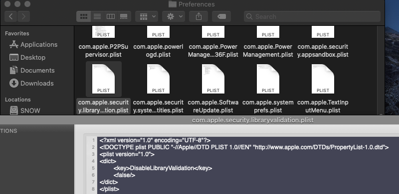

I had to install the script well at the start because I did not believe that I could make Legacy Video Patch on 10.15.4 work without com.apple.security.libraryvalidation.plist = true
And I said to myself I will test without using it and well, I deleted the plist and it works, I just did a fresh installation and it works after deleted
NOTE: I always SIP full Disable
EDIT
Since Tuesday it is my 4th install to test the deletion of the file and it works
EDIT again
And I also test after having deleted I installed the script in false
sudo defaults write /Library/Preferences/com.apple.security.libraryvalidation.plist DisableLibraryValidation -bool false
and it also works
:D
I confirm your test results. With SIP always fully disabled, installation of 10.15.4 with patcher 1.3.1 never failed even when removing all AMFI tranquilizers before.
(Always using a bootable USB installer, didn‘t try install-to-this-machine as I don‘t have patcher 1.3.1 anywhere else)
MBP5,2, APFS ROM patch applied.
EDIT: but see post #9308.
