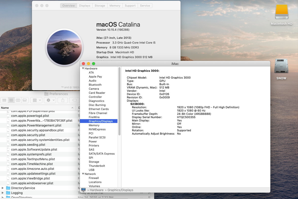

Fresh Install and GeForce 210 + Legacy Video Patch
I Not need to using Library validation scripts from @ASentientBot
What is incorrect on that
All system works like a charm, no crash anywhere
EDIT *** I also test Intel HD 3000 with my CPU i5 2500k
I disconect my GeForce 210
Its work
Did you see any com.apple.security.libraryvalidation.plist in Library/Preferences
EDIT *** NO 2
OK after lots of test 'Cause I know I'm not crazy
I had to install the script well at the start because I did not believe that I could make Legacy Video Patch on 10.15.4 work without com.apple.security.libraryvalidation.plist = true
And I said to myself I will test without using it and well, I deleted the plist and it works, I just did a fresh installation and it works after deleted
NOTE: I always SIP full Disable
