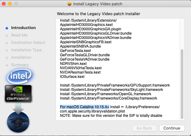

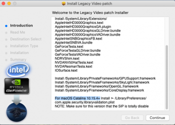

Then repeated the boot part of the exercise.
- verified that the .libraryvalidation.plist is in place on the clean-installed dsik and on the over-installed.
- reset the nvram
- the clean-installed doesn't boot, with the AMFI messages shown in single user mode.
- csrutil status in single user mode shows SIP disabled, but there is no csr-related entry in nvram
- the over-installed disk boots nevertheless...
Then in terminal of the bootable USB installer. Also here csrutil status shows SIP disabled. Still did csrutil disable. Now there is this entry in nvram: csr-active-config w%00%00%00.
Now booting works again with both disks (clean-installed and over-installed).
After csrutil disable I have the exactly same entry for nvram -p : csr-active-config w%00%00%00
This key means that SIP is correctly disabled on an EFI mac
and of course for me any amfi_get_out_of_my_way=1 disabling method (nvram, com.apple.boot.plist , disablelibraryvalidation.plist) worked too.
So now that through "csrutil disable" from a recovery terminal environment you can use "amfi_get_out_of_my_way=1" in nvram when you need, on next catalina ota update you could continue testing the catalinaswufix that includes all the amfi methods too, provided that SIP is correctly disabled.

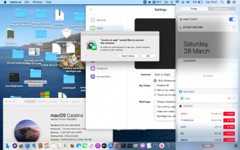

No working video with Zoom on non-metal patched Macs: this is what I did on my Catalina-patched MacMini 2011 and MacBook 2009.
Zoom up to version 4.4.53909.0617 installed a mini-webserver which was found to be vulnerable to hackers. As of version 4.4.53932.0709 this webserver was removed and a different approach implemented. Alas, this version does not show video on non-metal patched Macs with Mojave or Catalina. Sentientbot posted a link to this earlier version, but that is not very safe. There is a workaround:
* Uninstall Zoom with the built-in uninstaller
* Install Zoom 4.4.53909.0617 (see link in post from Sentientbot #8.969: https://d11yldzmag5yn.cloudfront.net/prod/4.4.53909.0617/Zoom.pkg )
* It will automatically start, after that close zoom.us
* Right-click on the app zoom.us, ‘Show package contents’, go to folder Frameworks: remove item ‘Zoomopener’
* Use terminal to remove ~/.zoomus or have Finder show hidden files (Command-Shift-Dot), go to your home-directory and remove folder .zoomus
* Restart Zoom and check your video, it should all work by now
One drawback (as expected) is that clicking a zoom meeting-link you receive will not open Zoom automatically. No big issue: you can use the meeting number+password for that. The other drawback is this version of Zoom not supporting a nice dark mode. All other functionality is there and working.
Well done @ErkSmeijer !
Using these from a Catalina terminal:
Code:
rm -r /Applications/zoom.us.app/Contents/Frameworks/ZoomOpener.app
rm -r  ~/.zoomus
fixed the Camera and Microphone allowing on 10.15.4 Catalina "Security & Privacy" Privacy tab. Adding it correctly to the Privacy permissions list.
