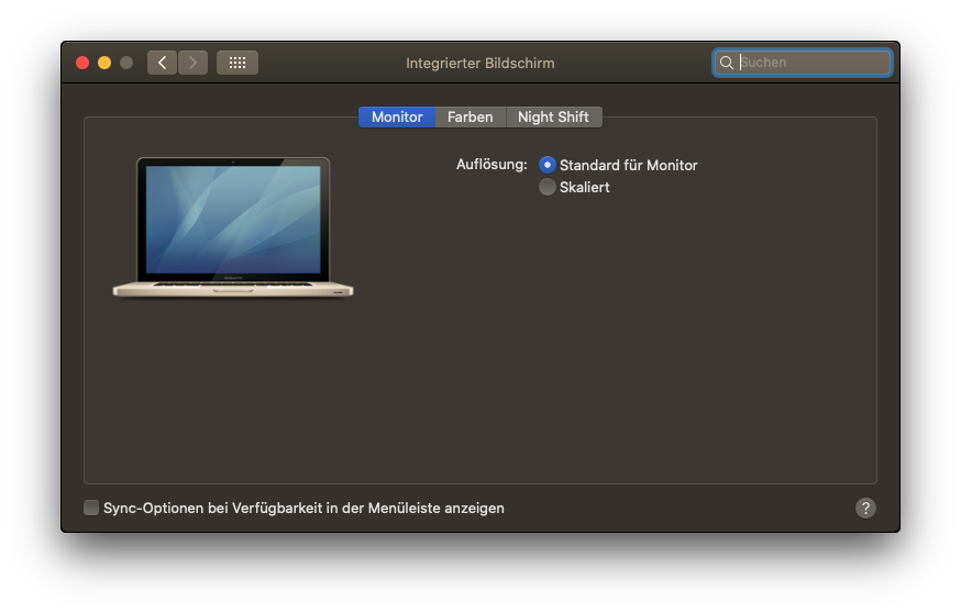

On 10.15.5b2 and 10.15.4supp, the Displays prefpane doesn't have the brightness slider. I think it was still there with 10.15.4 but I'm not sure.
If I remember well that was reported a while ago but fixed with ASentientBot wrappers.
There is no slider with or without NightShift (re-)installed.
I don't really need this slider, F1/F2 are working well. Just to report.

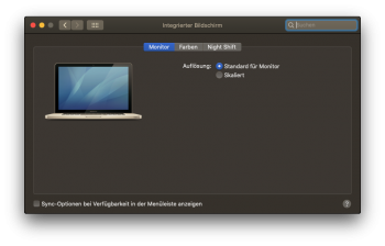

(MBP5,2 17" mid 2009, 2.8GHz T9600, Nvidia 9600M GT, 8GB, APFS ROM patch applied, Samsung SSD 840/860 EVO with APFS)

Try these attached from @indiawallah : Displays.prefpane fixes for Catalina
Hmm, I'll look into that. It definitely works on the non-APFS native Macs.
EDIT: It seems to be an issue with the machine's system firmware. Booting using the boot picker, and holding the Command + R keys while selecting your Catalina volume, works just fine.

Or you could have just used a fresh download of the 15.4.02 full installer, that has the Supplemental Update rolled into it, to create a new patched installer.
I tried this, as I did a while ago successfully (against 10.15.2 or .3?).
This time with 10.15.4supp I wasn't successful: empty Displays prefpane. Maybe I made a mistake,
Then went back to 10.15.4(19E266) by installing this over supp with patcher 1.4.3. Displays prefpane populated again but without the slider. Maybe it was before 10.15.4 that it worked.
