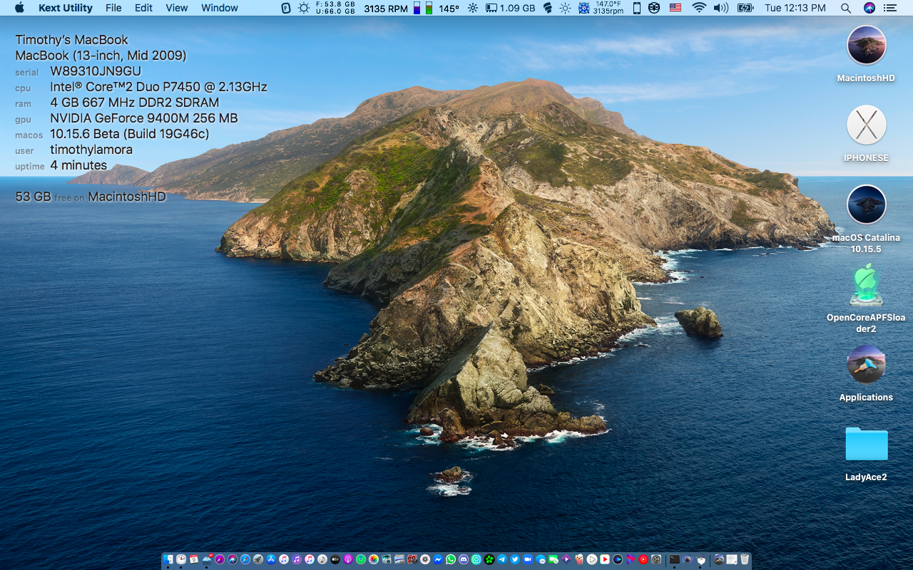

Same thing here... easy as always with CatalinaOTAswufix.app and 1.4.4 post-install patches (and OpenCore loader to help my MBP5,2 with USB disk across OTA phase 2).Successfully installed macOS Catalina 10.15.6 Dev Beta 2 with the swupatch-catalinaswufixamfi5 patch

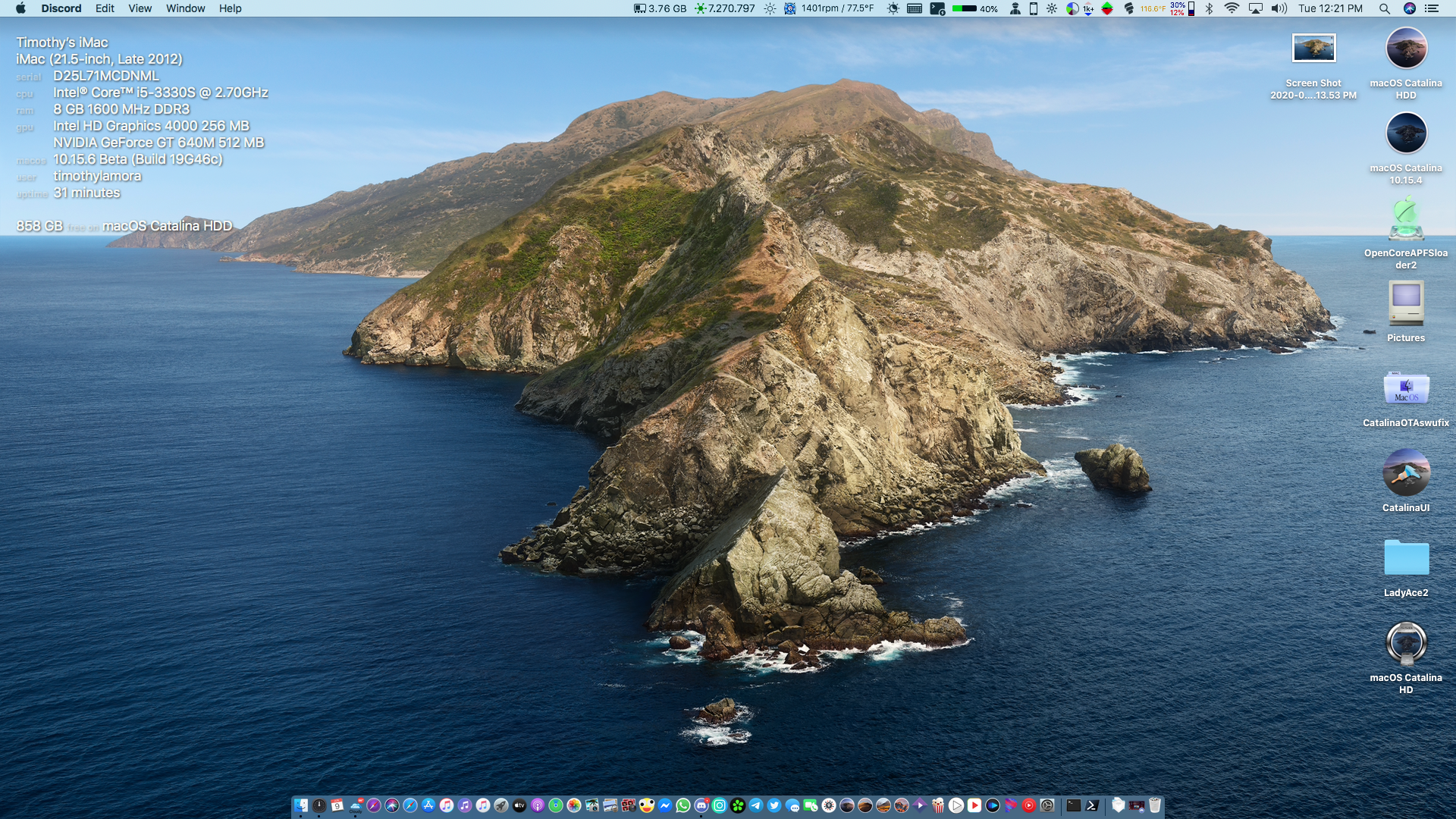

and on my iMac 13,1View attachment 922846
and if you asking about how I got the about this Mac info on my desktop use this app https://mac.softpedia.com/dyn-search.php?search_term=ParticularsI'm curious what software you used to annotate the desktop in the upper left corner. Been looking for something like that.

Hey, @TimothyR734 will it work on my iMac 9,1 ATI 4850?The iMac 13,1 is a supported Mac for Catalina but in my unsupported MacBook running Catalina I use this which is pretty close but it only works on 10.15.5 and the Supplemental update it will crash on 10.15.6 Dev Beta https://github.com/fabioiop/ImprovementUI
