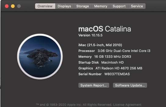

That is exactly what I did. But, I still only have 10.15.5. I don't have the letters in the parentheses, which is the Supplemental Update (I think).

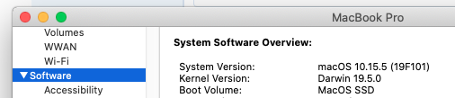

The same thing happened to me but when I went to About This Mac > System Report > Software, it shows the build.
I just downloaded the newest patcher 4.4 and a fresh copy of Catalina and installed it on my hard drive. I didn't get the Supplemental Update. See the attachment. :(
[automerge]1592140403[/automerge]
(19F101) is the Supplemental.
Thank you. I did it all again, but didn't get the Supplemental.
OMG!!!!!~!~! You are right! :)
I can sleep again!!

Tap the version number with your mouse in the About This Mac and see what happens?

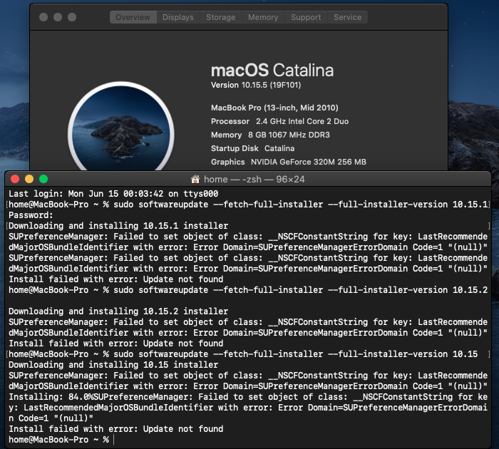

View attachment 924054sudo softwareupdate --fetch-full-installer --full-installer-version 10.15or10.15.1or10.15.2
Installing 83%… Install failed with error: Update not found

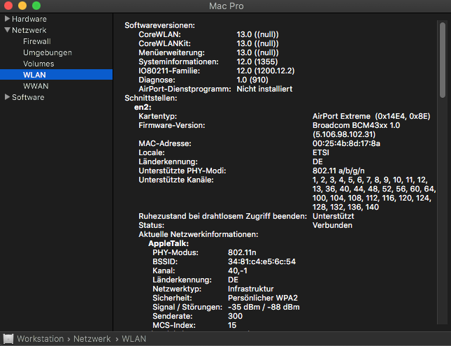

Hello everyone, thanks for being so awesome and genius and giving life to our old macs!
i been using OPENCORE 0.5.9 and also windows 10, works fantastic.
the only issue is that my mac pro 2010 the wifi doesn't work, but i see that you guys can make it work with a patch? how can i apply that patch to make mine work?
thanks so much! this will help the other opencore thread in mac pro 5,1 a bunch, there is many people that would like to make it work (the original wifi card that came with mac pro 5,1)

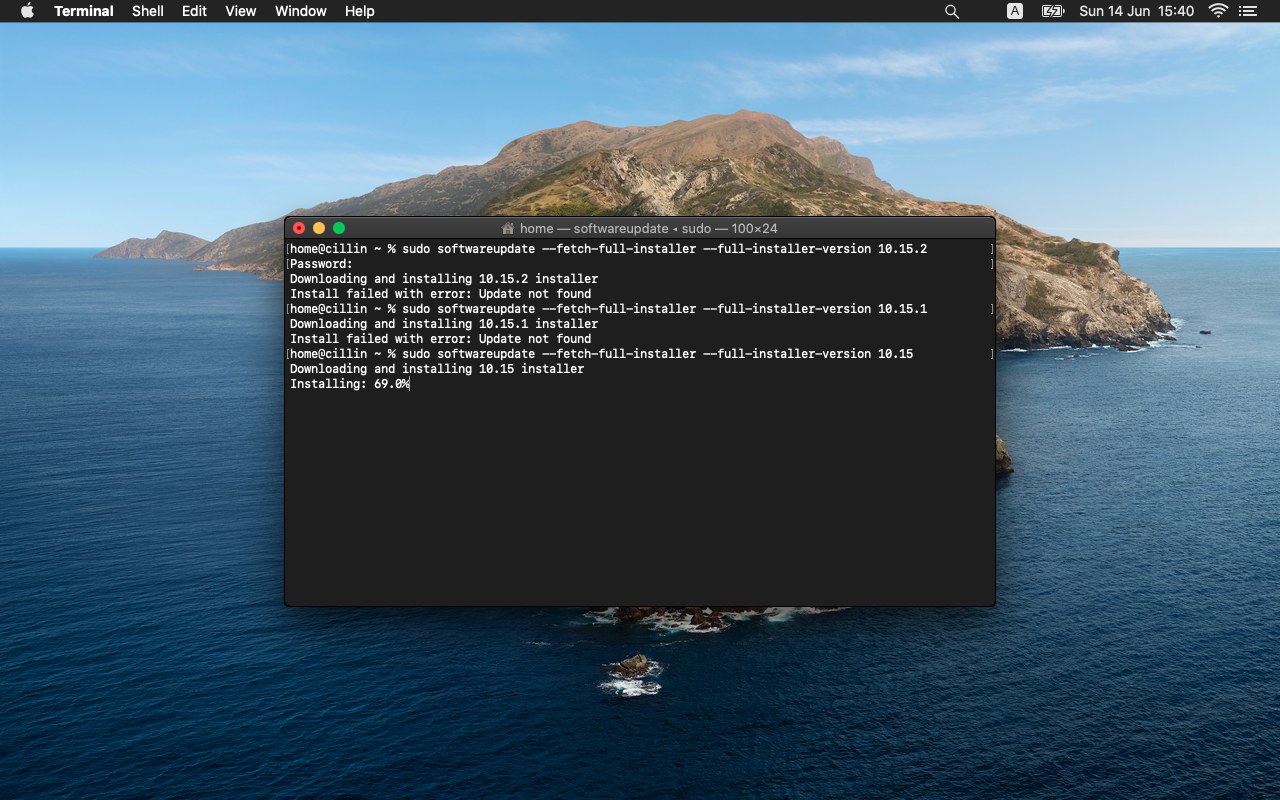

idk what to say. downloading 10.15 or 10.15.2 tells me "Update not found".
But 10.15.1 worked for me(twice now) 🤷‍♂️

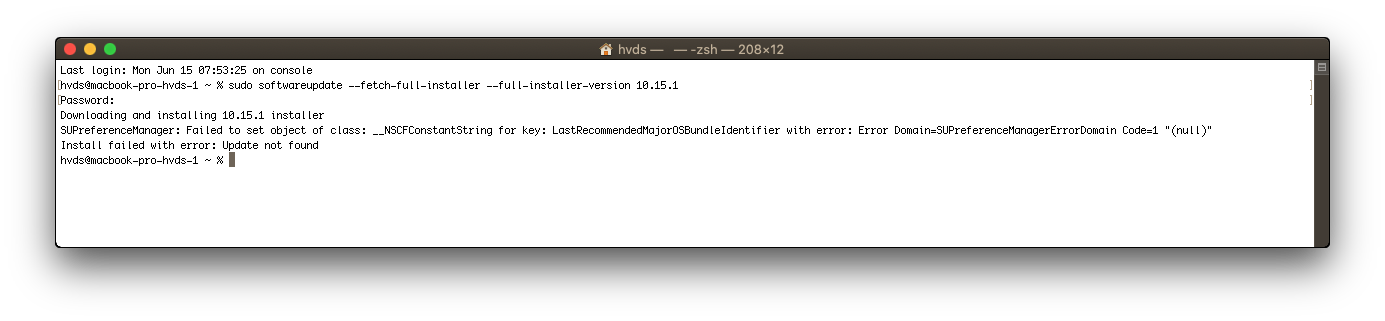

sudo softwareupdate --fetch-full-installer --full-installer-version 10.15.1
What I get - Downloading and installing 10.15.1 installer
SUPreferenceManager: Failed to set object of class: __NSCFConstantString for key: LastRecommendedMajorOSBundleIdentifier with error: Error Domain=SUPreferenceManagerErrorDomain Code=1 "(null)"
Hmmm?

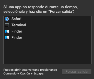

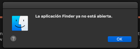

Hi, i was having some recent errors with 10.15.4 (latest build with patcher) address book, FaceTime, messages, would not respond randomly and would not fix until reboot (I notice because clean my Mac warned me about the not responding apps), now I have (today) updated to 10.15.5 (19F101), and have not yet experienced those error, but now Finder suddenly stopped working, it appear double, and tell me that finder is no longer open, I will going to restart with nvram reset, but it appears so much as the previous error, so I thought I might just post it here, maybe someone knows about it.
MacBook Pro 13'' Early 2011 8,1.
(updated with usb stick, latest patch)
* error appeared last week for the first time.
Update 16.6.20: Finder has not crashed since the reboot with nvram reset, also the other apps didn't crash.
Install Failed 4.pngI upgraded to 10.15.1 (19F101), Patcher 1.4.4.
Same install failure occurs, except this message now pops up repeatedly:

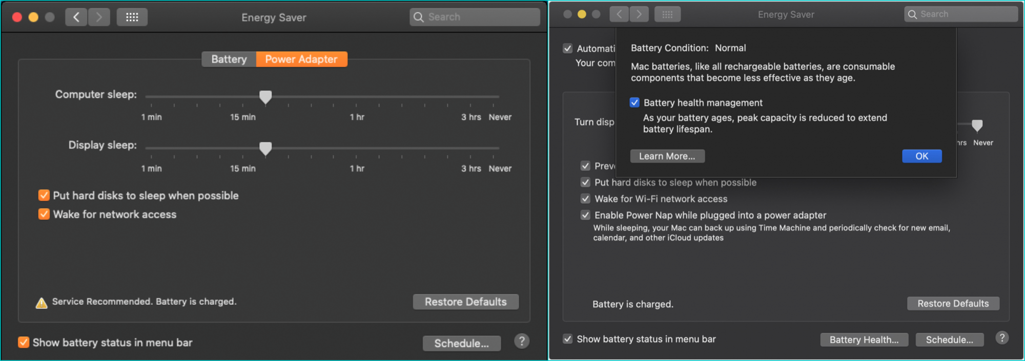

The new battery health management feature exclusive to 10.15.5+ is also unavailable to me (https://support.apple.com/en-ie/HT211094)
Hmmm?
WTF, now I'm confused.
Yeah i noticed those messages too, they were added in a recent macOS update. They look like debug messages so i just ignore them. I'm still not sure why it doesn't work for you though.
BTW the battery feature doesn't show up for me either so it probably needs a supported battery/mac or some patch.

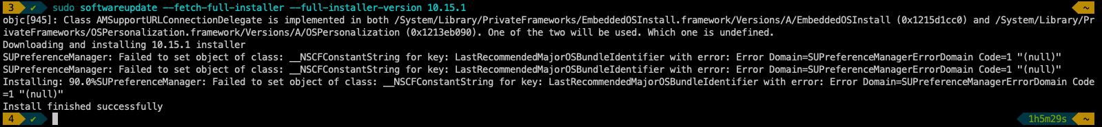

Oh i just realized something: i used the CatalinaOTAswufix.app jackluke posted in this thread to get beta updates.
Without this fix the Software Update Pane doesn't show any updates in the System Preferences.
I'm thinking maybe the fix also fixed the softwareupdate command and that's why it works for me but not for you two.
I'm using jackluke's CatalinaOTAswufix.app regularly to get the betas. Still the softwareupdate command fails.
Like K two I think it is deprecated.
dosdude's patchers always work for downloading (their respective latest) full installers.
Yeah i guess.
quaccOS was trying to get a version of the installer that doesn't have the safari extensions bug and i thought i'd help out but oh well i guess it doesn't work anymore.(even though i can still download 10.15.1 which is very confusing)
Also the --fetch-full-installer --full-installer-version arguments were added in catalina and i think it doesn't really make sense to add features to a command and then deprecate it so soon after.
But it's apple and they do a lot of weird stuff so 🤷‍♂️
View attachment 924161View attachment 924162
Try running this - https://www.titanium-software.fr/download/1015/Maintenance.dmg
