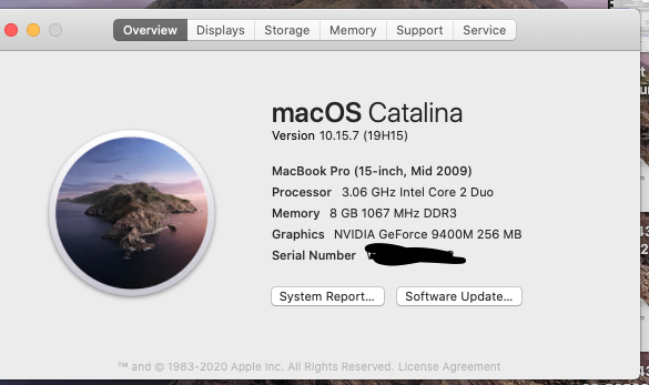

I finally updated my Catalina with the supplemental update 10.15.7 (19H15) , and I must say this is the best Catalina has worked for me.
I used the MD5 tool to download it, and dosdudes patcher to make the installer. Worked perfectly. Screen Shot 2020-11-29 at 8.07.59 PM.png
Reactions: pippox0 and K two

I know this question is repeated many times here, but this is really annoying!
Hi, I switched back before 6 months at least to Mojave due to the random crashes on Catalina, Now I came back to Catalina 10.15.7 and it still present, Please Is there is any fix for that? thanks.
Note: I am using a MBP 13' mid 2009, 2.53 GHz Intel Core 2 Duo, 8 GB 1333 MHz DDR3, NVIDIA GeForce 9400M 256 MB, Catalina 10.15.7 19H2, latest Dosdude Patcher.
Your MBP will never be stable no matter what OS is installed with the 1333 MHz. modules in there. S/B 1066 MHz. which are now cheap.
Reactions: Rami Ashqar
Your MBP will never be stable no matter what OS is installed with those 1333 MHz modules. S/B 1066 MHz DDR3. https://eshop.macsales.com/shop/memory/Apple_MacBook_MacBook_Pro/Upgrade/DDR3
Oops! Sorry for the post swarm. ?
