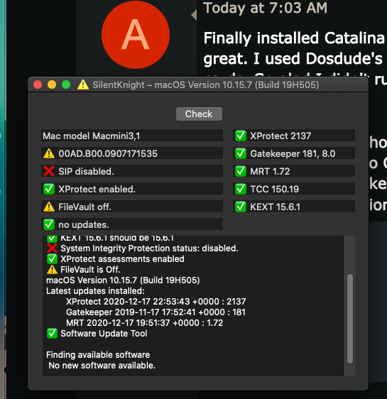

Finally installed Catalina on my Mac Pro 3,1 and Radeon 7950. Machine works great. I used Dosdude's 1.4.4 patcher which had support for Radeon 7XXX series cards. So glad I didn't run out and buy a GTX. Many thanks to @dosdude1 for this!!!!
I do have a question though regarding automatic system software updates. Is it best to disable it, or do OTA updates work properly now? Is it safe to leave the following options checked? I'm asking because I'm not sure if v1.4.4 of the Catalina patcher includes functionality for OTA software/security updates directly from Apple.
My experience is that it doesn't matter whether you check them or not since OTA system updates DON'T work even if they are listed. They will report incompatibility with your Mac on either downloading or installation, unless you also use OpenCore or Clover to spoof your Mac ID, which then has a chance to brick you Mac upon installation.
MRT and XProtect will update normally. SUs and Supps can be done using CatalinaOTAswufix.app. Full installers when available can be built with gibMacOS-master or MDS.
Thank you for clarifying. I'm sorry to ask, but this thread is enormous and searching for comprehensive instructions on how to go about applying system/security updates brings up a lot of commentary and questions but no clear or concise steps. Is there a resource available that could walk someone not well versed in MacOS (I use Windows 10 primarily) on how to do these things? When I was running DosDude's High Sierra patch, I ended up leaving my system un-updated for several years due to my poor understanding of the process.
It`s safe, because you are not going to receive any critical update.

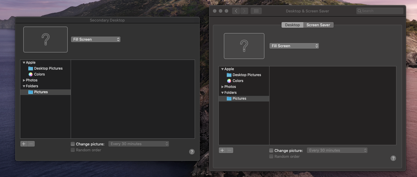

I've just discovered that desktop background selections aren't being saved after a reboot. Time Machine drive icon also isn't changing to the green icon unless I deselect the disk and reselect it. Can't find a desktop.plist in Catalina to clear the desktop preferences. How can I fix?
Regarding the desktop backgrounds, I've been selecting the dynamic images located under Apple/Desktop Pictures. However, after rebooting, it always default to the following:
Reactions: K two

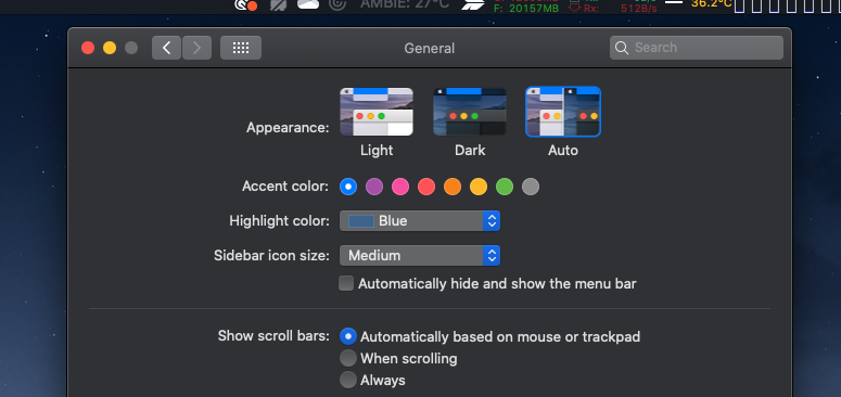

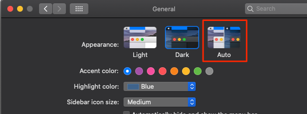

I just install Catalina on my unsupported iMac late 2009 and the only that not work is the auto switch the dark mode. Any suggestions?
For random post-install weirdness, give Onyx/Maintenance a go? The default settings are safe.

AFAIK that feature has never worked on unsupported Macs.
Are you talking about this function:
I wonder why? Dynamic desktop backgrounds seem to work fine, but I've noticed that when I switched it to auto just now, all of the menus and system windows got bright and stayed bright.
Edit: I take it back. Auto mode seems to work fine on my Mac Pro 3,1. Just had to wait an hour I guess.

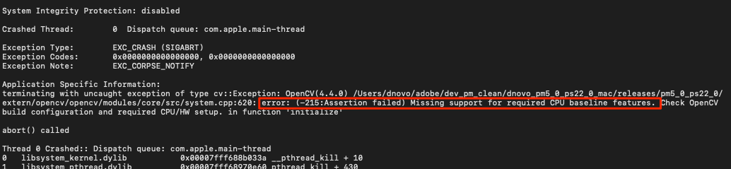

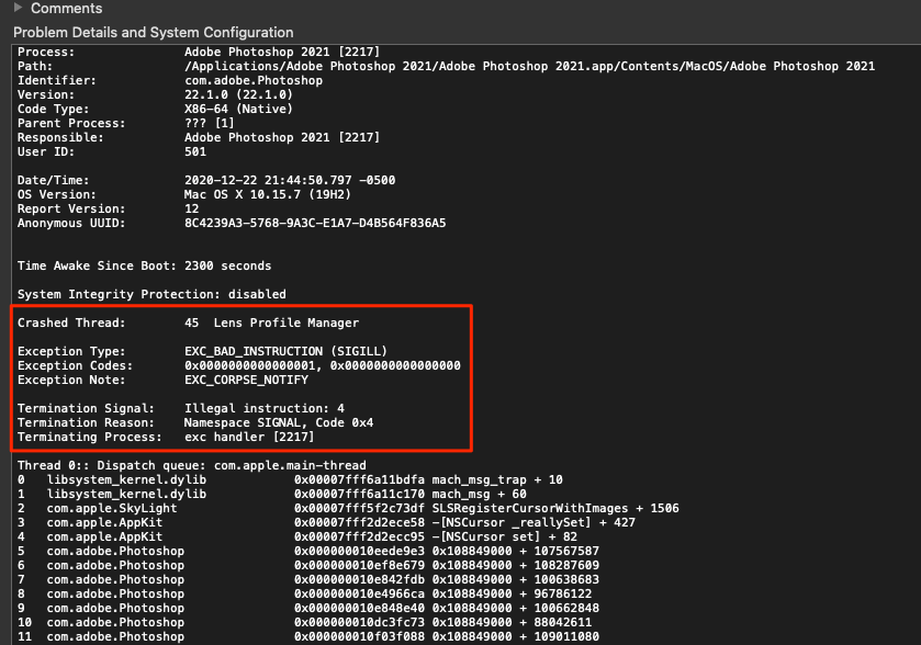

Welp, found something that wouldn't run. Photoshop 22.1 crashes the moment I try to open it. Seems it needs SSE 4.2. I really hate these companies sometimes. I thought DosDude1's 1.4.4 Catalina patcher had SSE 4.2 emulation in it to allow Radeon 7XXX cards to function?
amstel78
macrumors 6502a
Aug 12, 2018
517
183

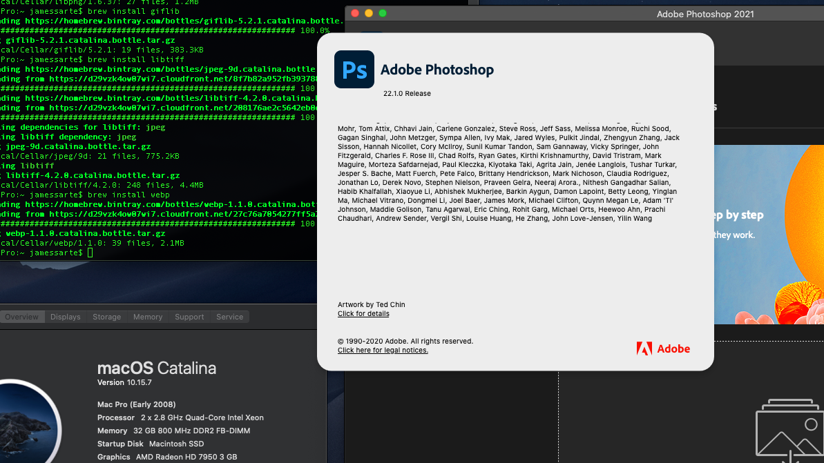

Hi, I have solved the problem with this command sequence:
Download libopencv_world.4.4.0.dylib from here:
Code:
https://www.sendspace.com/file/meab5g
copy it to Photoshop 2021 Framework directory:
Code:
sudo cp libopencv_world.4.4.0.dylib /Applications/Adobe\ Photoshop\ 2021/Adobe\ Photoshop\ 2021.app/Contents/Frameworks/
Download libopenjp2.7.dylib from here:
Code:
https://www.sendspace.com/file/59abvl
copy it to:
Code:
sudo cp -p libopenjp2.7.dylib /usr/local/opt/openjpeg/lib/
From the second libopencv_world.4.4.0.dylib downloadable from here:
Code:
https://www.sendspace.com/file/jwxnni
copy only libtesseract.4.dylib and liblept.5.dylib:
Code:
sudo cp -p libtesseract.4.dylib /usr/local/opt/tesseract/lib/
sudo cp -p liblept.5.dylib /usr/local/opt/leptonica/lib/
Install Brew
Code:
/bin/bash -c "$(curl -fsSL https://raw.githubusercontent.com/Homebrew/install/master/install.sh)"
Code:
brew install libpng
brew install giflib
brew install libtiff
brew install webp
That's all
Maybe someone can achieve this with less commands using only brew
Thank you, thank you!!!! Photoshop 22.1 now runs on my Mac Pro 3,1. You guys are a bunch of geniuses!!! :)

@lumos - many thanks for your instructions on getting PS2021 to start, however the program still crashes when attempting to do certain things, such as applying filters.
For anyone else that has gotten PS2021 working on their 3,1 Mac Pro - is it stable?
