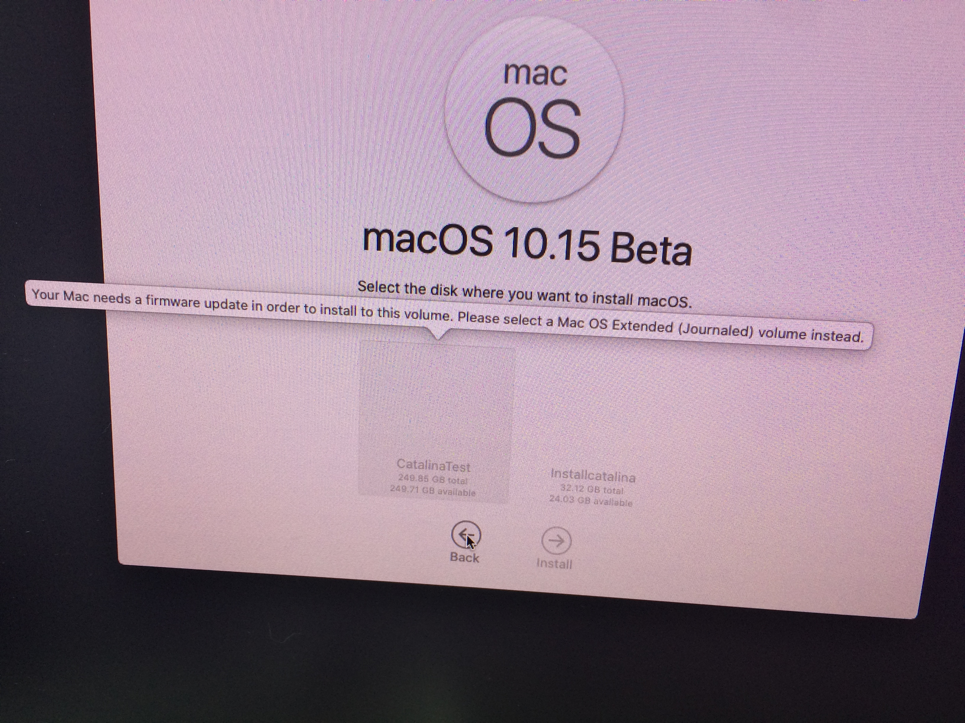

If you did any mods with the 10.15 Catalina install app that is why it won't create a patcher I re-downloaded the 10.15 beta app and I successfully created a patcher but it says I need a firmware update on my MacBook 5,1

Currently, it will only work on machines that support APFS booting natively. Do you have the APFS ROM Patch applied?
Yes I used your APFS rom patcher on both my MacBook 5,2 and iMac 9,1 both say needs firmware update or choose a drive Journaled extended

Ok, I'll have to patch that check out, then. I'll release an updated version soon.

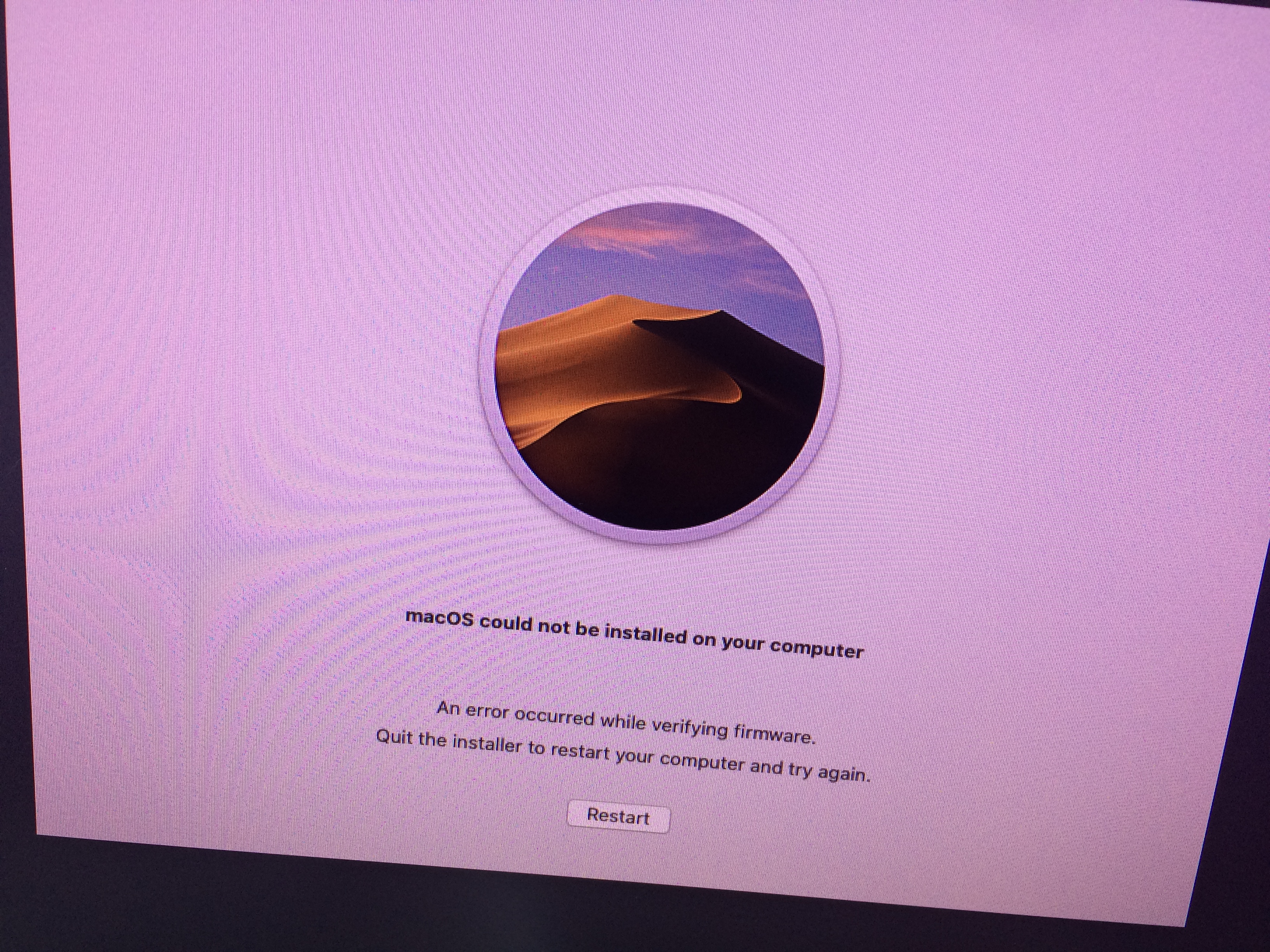

On a MacPro 3,1 with your APFS boot room and NVME patch, when installing to a clean APFS formatted SSD, I get this message at the start of the install.

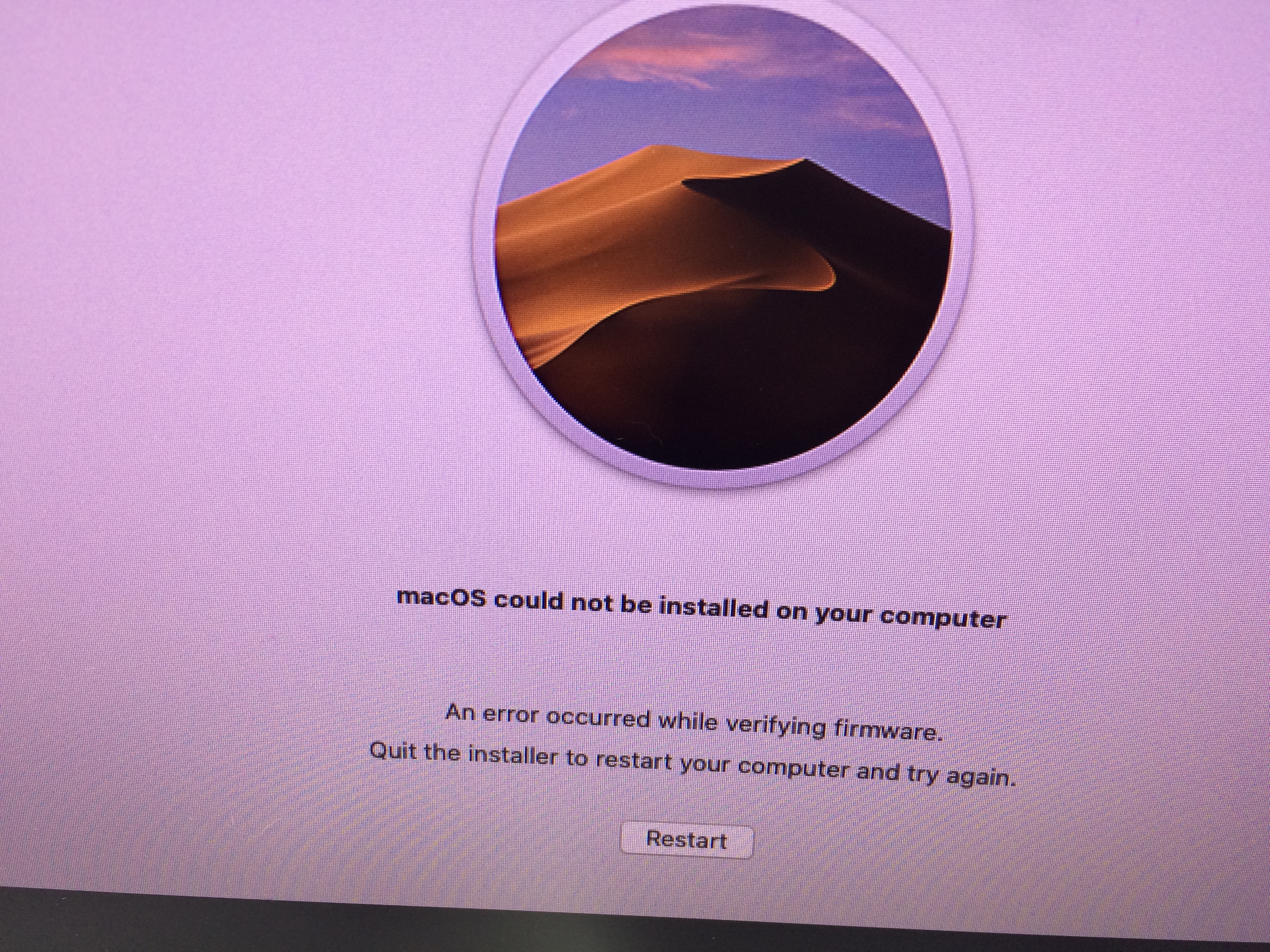

So I formatted as requested by the installer and the install proceeded until this.
It does not like the extant boot rom.

Firmware update required issue has now been fixed in Catalina PartialPatcher! New version can be downloaded here.

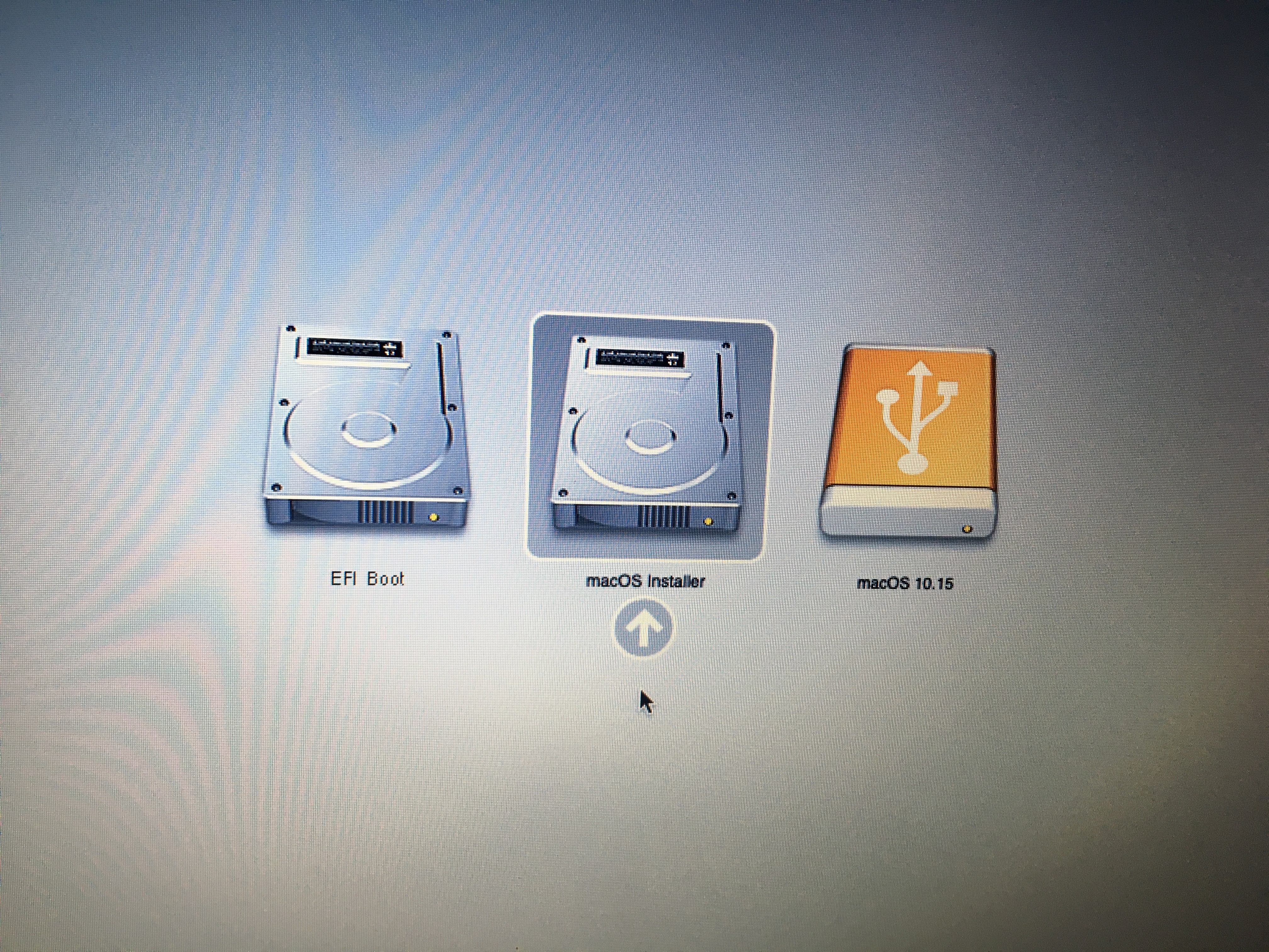

This is what is happening on my MacBook 5,2 its not decking my MacintoshHD and it was formatted APFS if I try macOS installer I get a circle with a line through it If I try EFI it hangs
