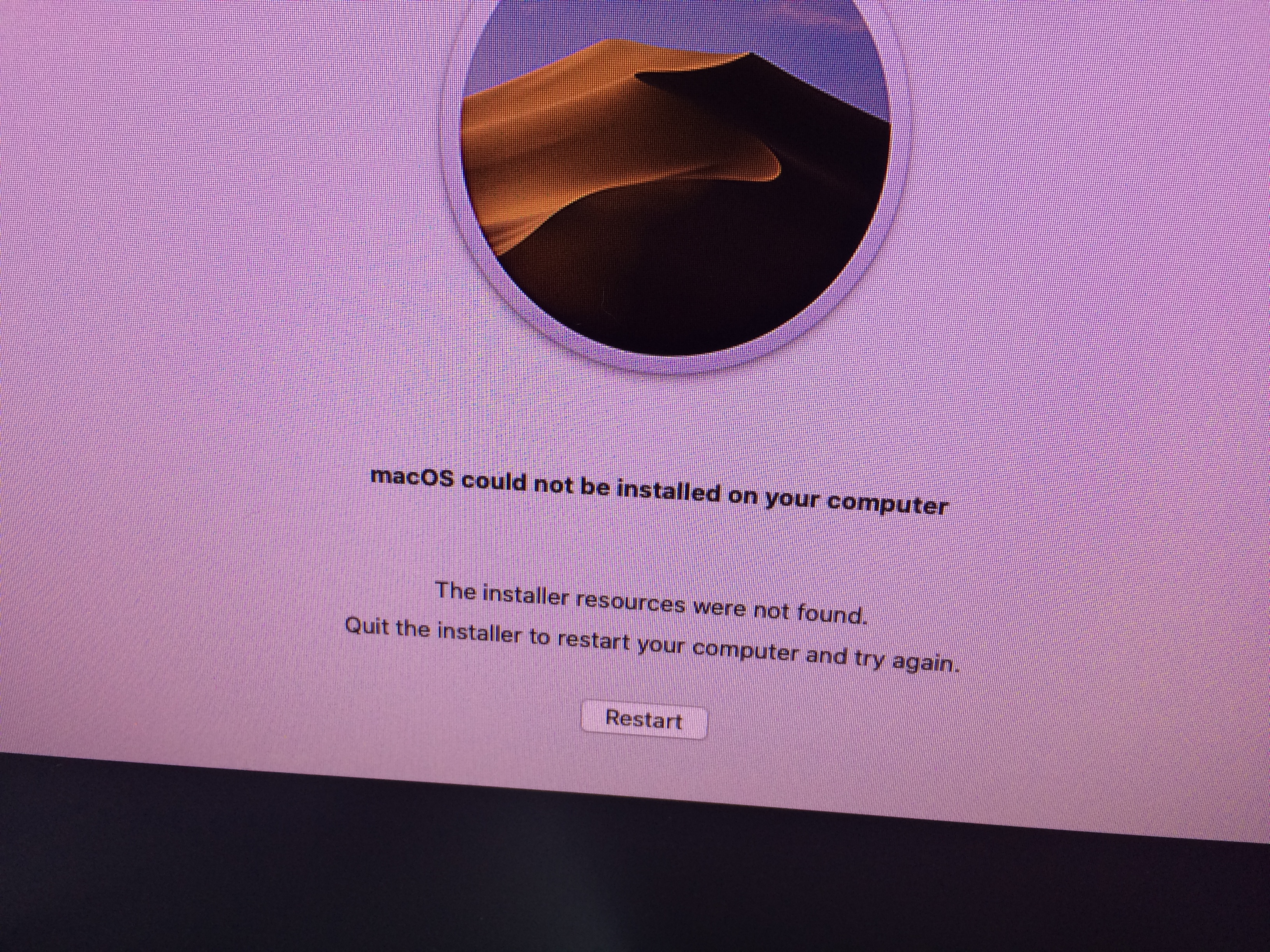

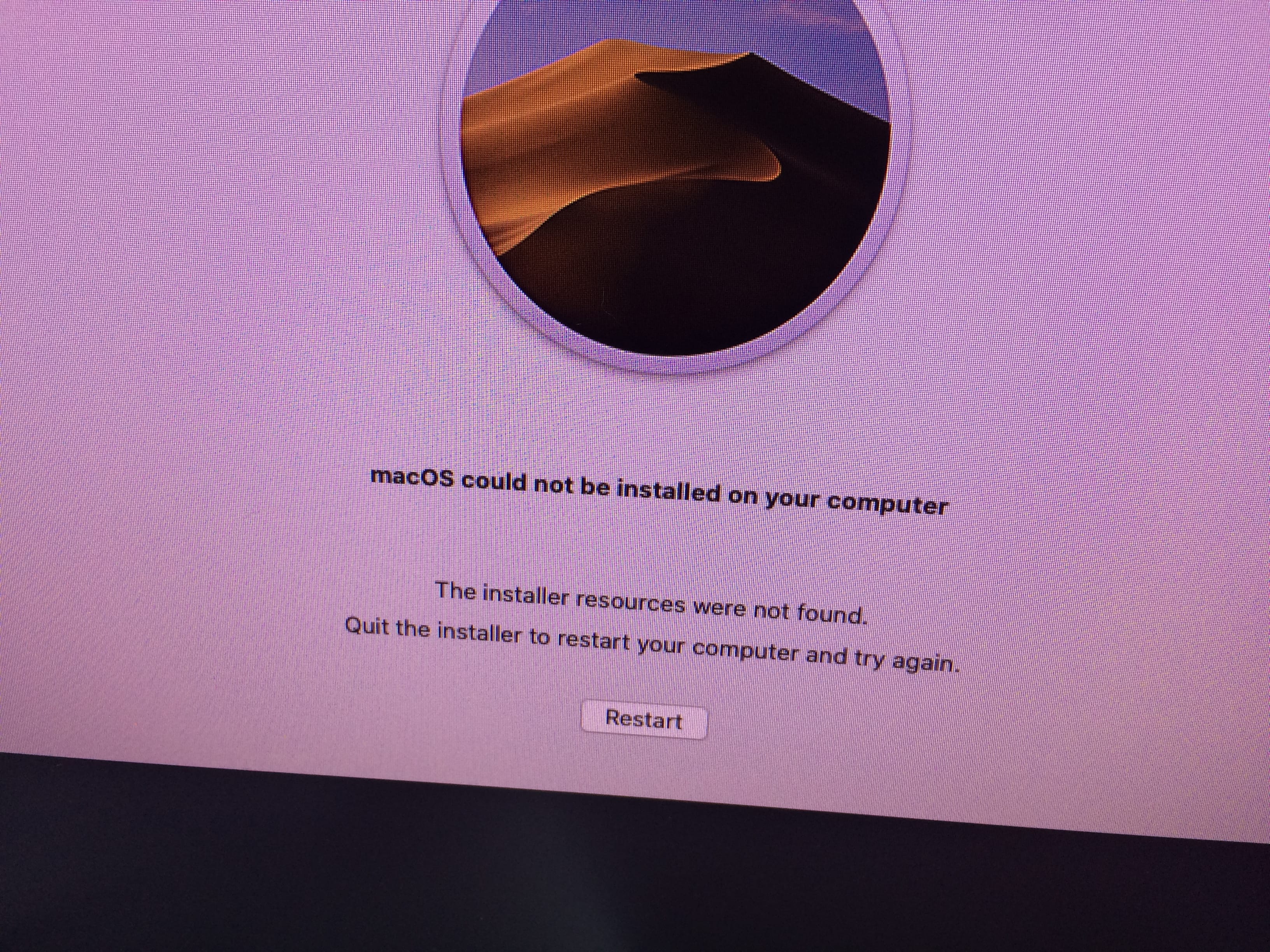

Third time was not a charm—different error message this time about installer resourced not found IMG_0082.JPG
Third time was not a charm—different error message this time about installer resourced not foundView attachment 843342
That means the pre-installer didn't work correctly. Try erasing the volume (formatting as APFS), and try installing to it again. If it doesn't work on the second attempt, send installer logs. Also ensure your system date and time is set correctly.
Yes I did and checked again tried the updated patcher still no detecting my MacintoshHD when I booted into the Mojave Patcher it detects my HDD
That's normal. If you get the circle with slash at all, that is a sure sign that NVRAM is NOT set correctly. If setting from the installer/Recovery OS, just run nvram boot-args="-no_compat_check", without sudo.

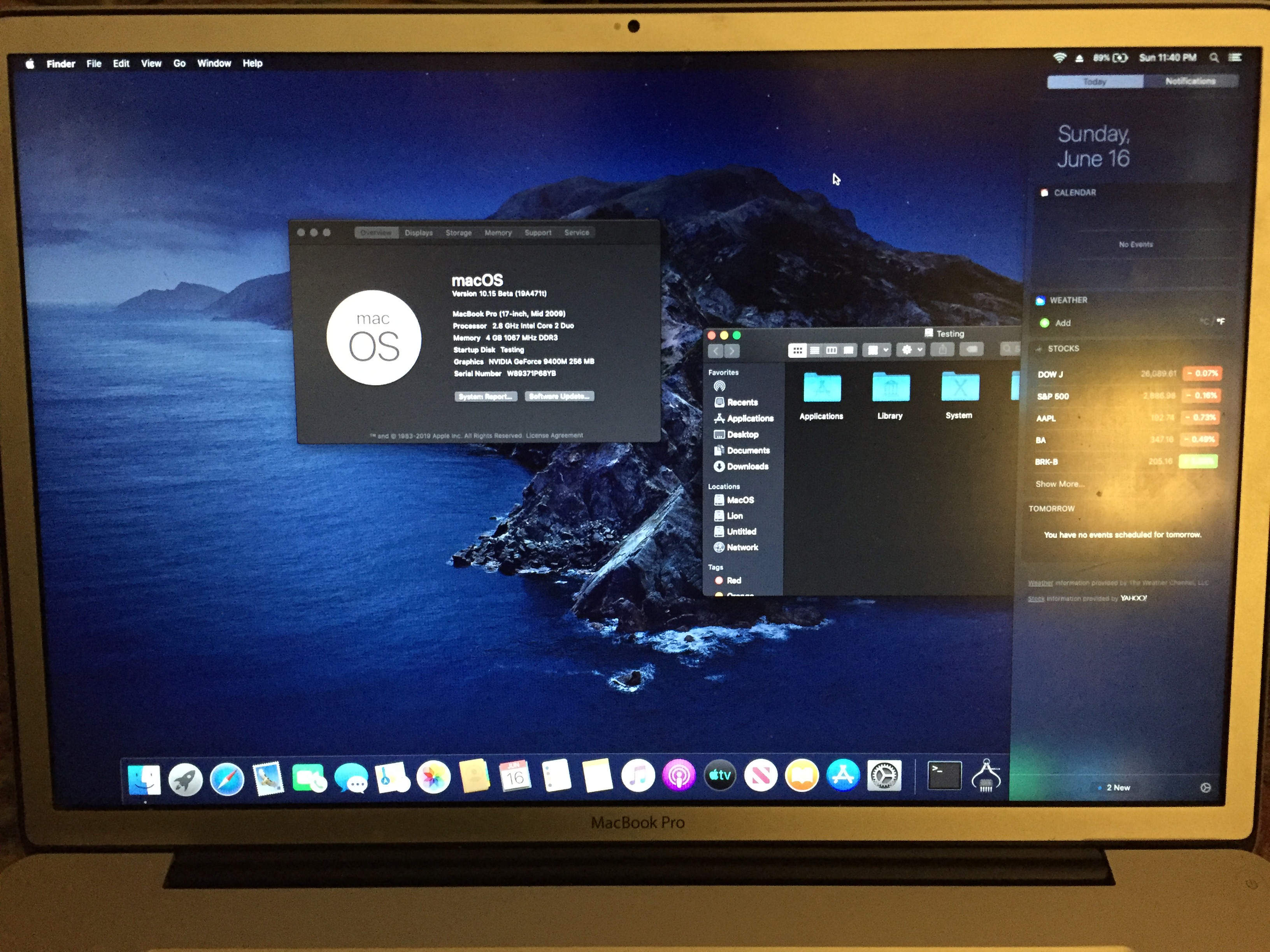

Again sorry to bother, but does that Mac have a Metal GPU
Edit: Sorry, didn't realize that you showed the About This Mac Screen. Do you have any clue about the possible release date of the next patcher? I just installed Mojave on a SSD I got for my birthday yesterday on a MacBook Pro of the same year as yours.

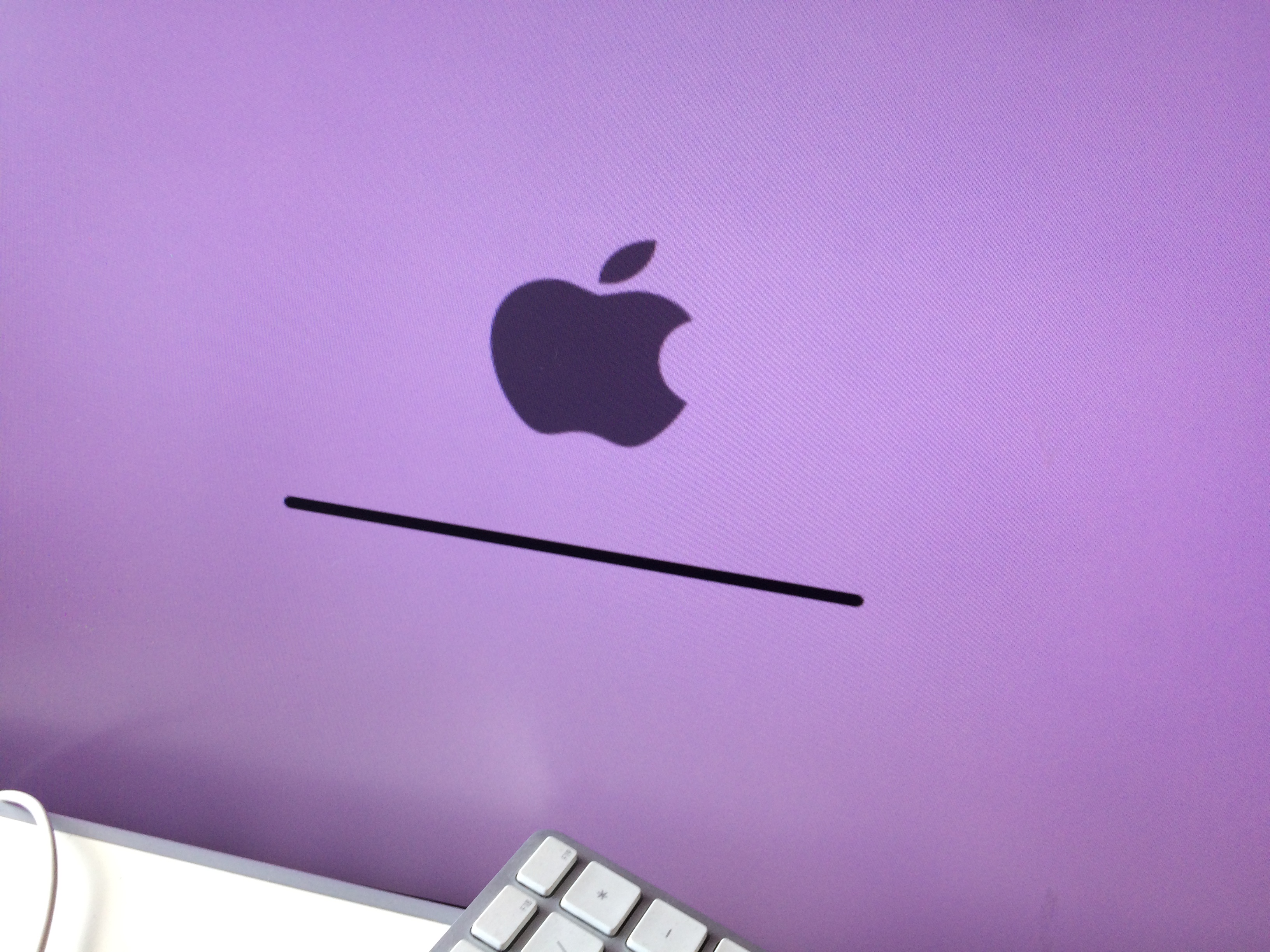

I thought the fourth time might be a charm because it went through the entire install as normal BUT on the first full boot the progress bar sticks 10 mm from the end or at the end. This is MP 3,1 with APFS and NVMe boot patches and a flashed NVidia 680.
Safe boot does not work.
I might connect to a supported Mac with Catalina IMG_0083.JPG and run DU on it to see if it needs a repair. So close but no cigar yet.
I might connect to a supported Mac with Catalina View attachment 843350 and run DU on it to see if it needs a repair. So close but no cigar yet.
I feel bad for you, but are there any errors in Verbose mode? If that is a stupid question, sorry as I am somewhat/not really new to macOS. Watching lots of EverythingApplePro.
That's the odd thing, command + s boot shows no errors at all—and once it did momentarilt flick to the initial setting screen but when I set the setup language to English it immediately went to the recovery screen—never mind I can wait a month.
