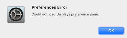

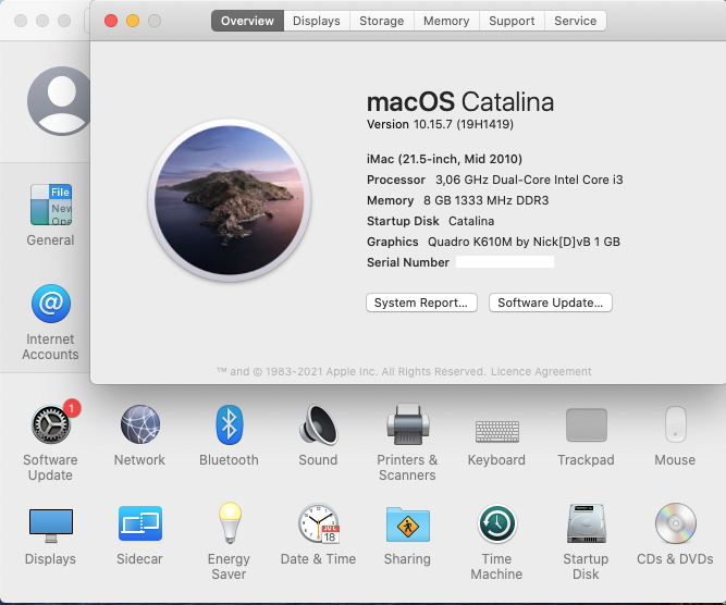

Preference Error: "Could not load Displays preference pane" after migrating to OCLP Catalina from dosdude1 Catalina for an iMac 10,1.
Tried various OCLP settings by changing "SMBIOS settings" and "Allow Accel on Mojave/Catalina:" with no luck.
A solution would be very much appreciated.

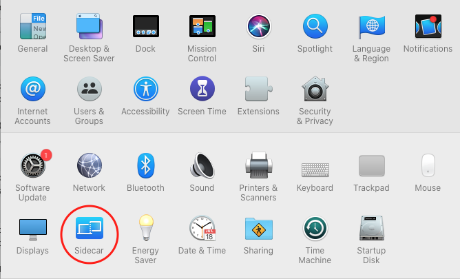

Added: Just noticed this Sidecar icon, which should have not appeared in Catalina. Not sure what happened and if this caused the error of Displays preference pane?
Migration will not work, you need a clean new installation in a new APFS container to start with. Changing the SMBIOS usually breaks some things. As I said before, it is experimental and I guess not a lot of people did it before.
Since my systems have a metal GPU and full support by OCLP no post-install patching is needed after doing a clean installation. Your system would need this post install patching after enabling choosing Allow Accel on Mojave/Catalina: while creating the OC.
So the process is installing OC using OCLP, booting OC, booting the stock Apple USB Catalina installer and installing it to the new container, booting Catalina and running the OCLP app again to run the post install patching process.
Pretty much similar to the @dosdude1 patcher. The complete process has been described for Big Sur legacy graphics patching and is in fact the same. So please check the OLCP docs.
Just like to clarify my "migration", which was to boot with a OCLP USB and re-install the stantand Catalina over the dosdude1 Catalina, thus retained all the existing data. The procedure is mentioned in this post. Once installed, I then patched AFPS with the latest OCLP nightly built TUI app. Not sure if this meets your definition of a "clean new installation". If not, I will need to erase the disk and start from scratch, and restore the data by using Migration Assistant afterwards.

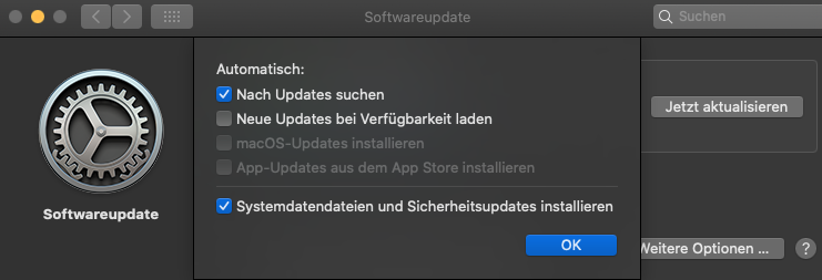

Wish I could help but I don't speak VPN. Don't forget to update X-Protect and MRT. Also, the Validation Patch in the Utilites ƒ Patch Updater. :cool:
Is this the correct configuration for possibly updating X-Protect and MRT? Thank you in advance and sorry for the screenshot in German - but I think the configuration points are in the same order like in English. (I want automatic updates disabled but I'm unsure about the last point).

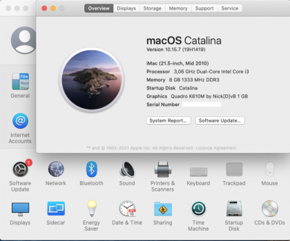

Updated to 19H1419 using OCLP 0.2.5:
Notes:
  1. The still available software update is Monterey Beta (enrolled to the DeveloperBeta seed).
  2. SideCar pref pane is possibly only available because of the FeatureUnlock.kext included in OCLP. But this system does not have the hardware to support SideCar (metal iGPU like HD4000 and better).
Notes:
