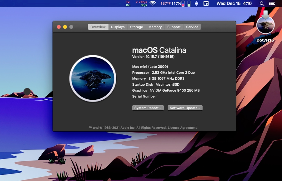

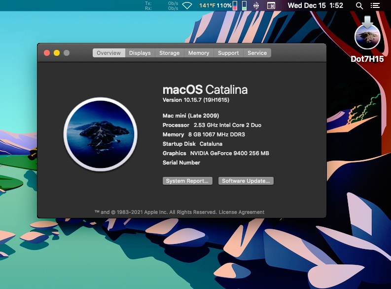

A couple of quick delta updates courtesy of CatalinaOTAswufix, OC, @dosdude1 Catalina Patcher v.1.4.4 both in less than 30 minutes incl. post install patches and Force Cache Rebuild. Both also required MRT and Validation Patch updates. Build 19H1615 is now the release version and runs as expected without issues. :cool:
