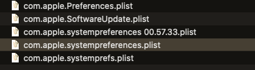

Re: Clean reinstall of Catalina 10.15.7 (19H2). Hung (beachball) on Software update after launching "CatalinaOTAswfix" following instructions as I have done numerous times before I went on to Big Sur for a spin. (I came back from Big Sur with complete SSD erase, etc. migrating just data and setting). I have tried deleting as mentioned in a few posts around the net but result remains a hung system preferences software update (wether I launch OTAswfox or software update directly).
All other system preferences work fine. Trying to update to security 2021-008 and then on to 15H1519.. Any suggestions? Thanks!
Update 12/9/21
Sorted out above problem by only migrating my Data and not "settings" from my time machine backup of Big Sur. All is good no hangs when accessing System preference/Software update. However what I am getting is an "infinite looping successful software security updates of 2007 and 2008". Once updated with one security update then shows another update available indicating the prior security update... strange. Both show in About Mac/system info/installations as having been successfully installed but impossible to upgrade to latest beta from 15H2 to 15H1519. Never came across this during Catalina (updates or betas) prior to my install to Big Sur. Most likely user error in otafix but what, I fail to see. Any suggestions? Thanks much in advance.

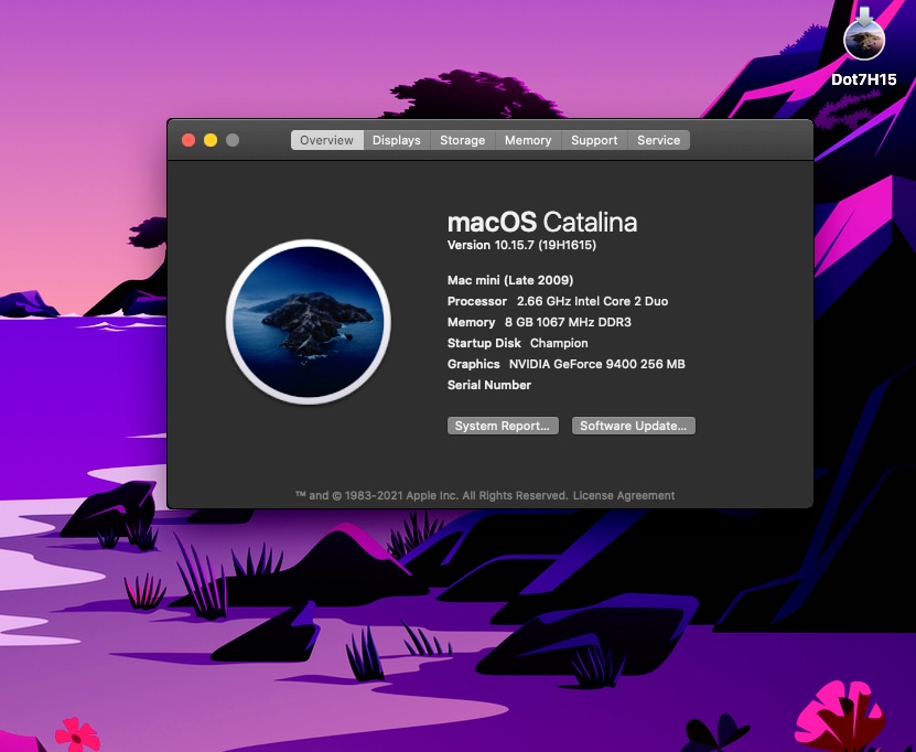

I'm on a Macbook 8,1, 19H1519, DosDude1 patcher. I am experiencing the same thing that the person above writes. When I launch imessage, my screen goes black, and I get sent to the login screen. Is there a fix for this?
Reporting successful update to 19H1615 on MBP4,1 17" (Early 2008). Seems a little slower overall since 19H1612. Safari takes about 5-10 sec. to get locked and loaded.
