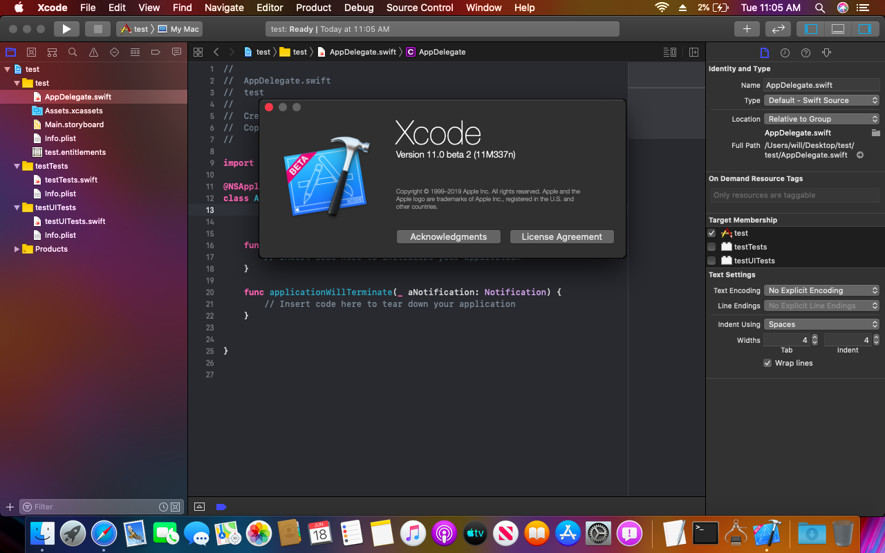

Xcode 11 beta 2 works on a non-Metal system with no patches :)
The mini-map is still non-functional, but I guess they added some error handling instead of just crashing when there's no Metal device.
Very cool. Cat and Xcode are still very buggy, so many of these issues may actually be Apple's and not our workarounds. Time will tell.
Yes, just installed it a while ago

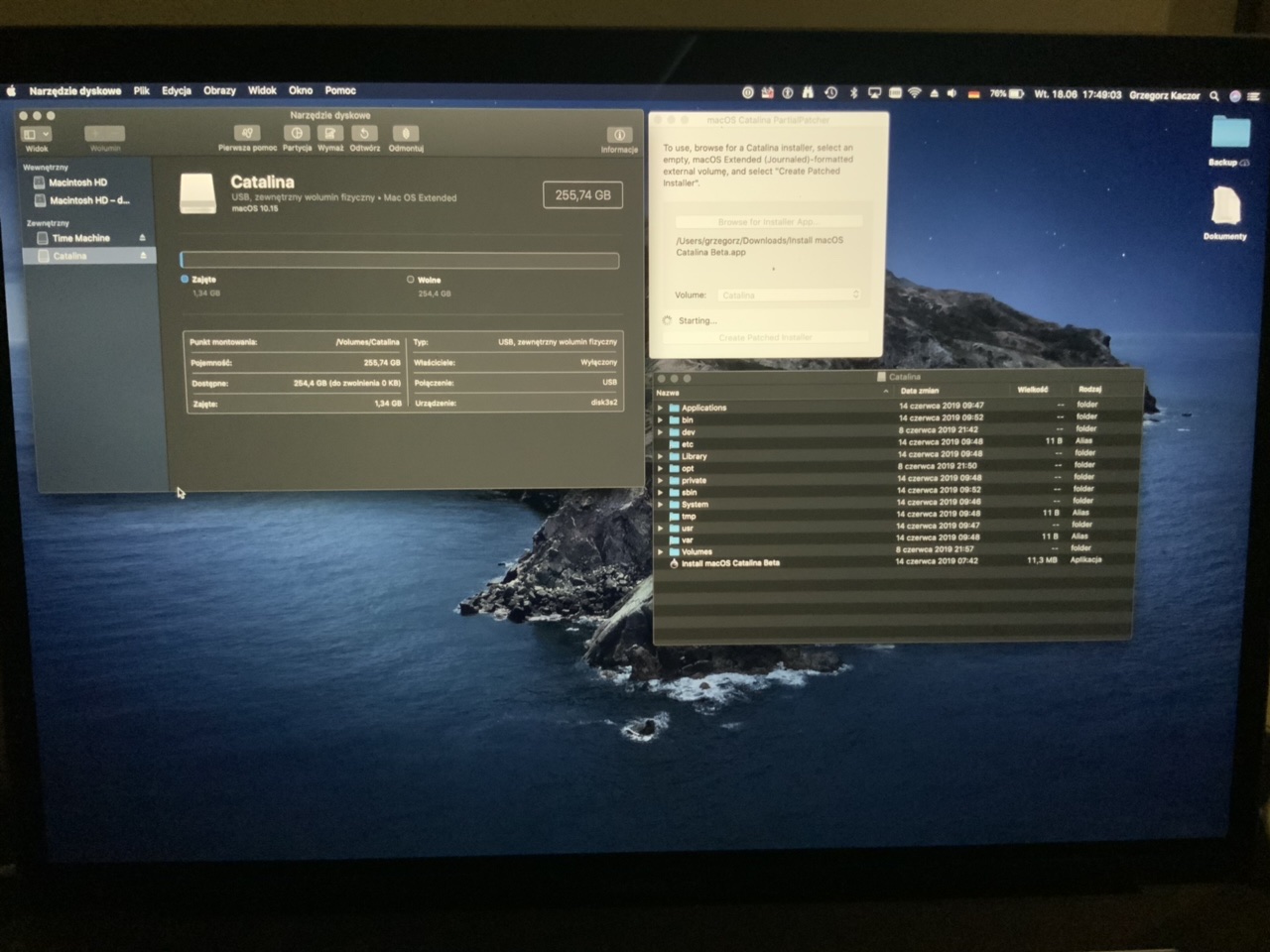

Your Catalina Partial Patcher Tool does not work on machine with already installed Catalina OS.
It’s not possible to create bootable USB. After press Create Patched Installer this tool hangs on starting....
Its create volume on USB with 1,34GB data and nothing more.
