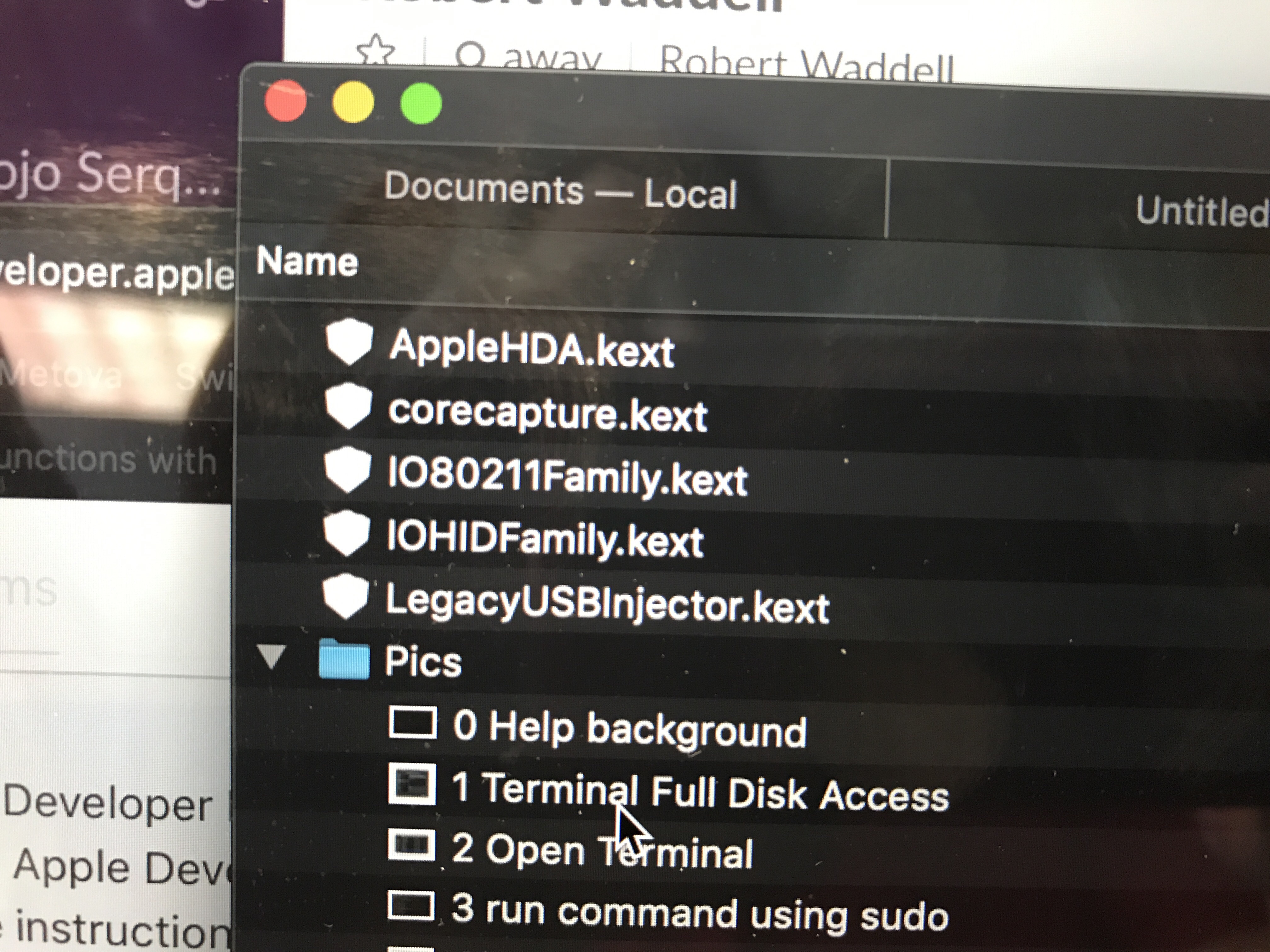

I am using
1.Sentienbot’s HID patch
2 legacy USB patch: works with all Cat’s USB drivers
3 Apple HDA patch for native sound
4 Wifi patch minus CoreResponder, 802.11_2nd kext left intact
5 iOUSB family and IOUSBHost left intact
With that set, running them on a clean install from my own interactive shell script to make it easy to test clean systems, I got my Magic Trackpad and 1080p webcam working natively without additional drives. Through lots of testing on clean installs using ASR to image the drivers in 2 minutes, I was able to test many sets of patches. Ran into scenarios where everything worked but 1 thing would barf.
My 3,1 patch tool is just 17MB. I will check out a clean install on b1 and b2 to see if things hold up.
I was running into conflicts with my cam and trackpad. And I think I got that worked out thus far.

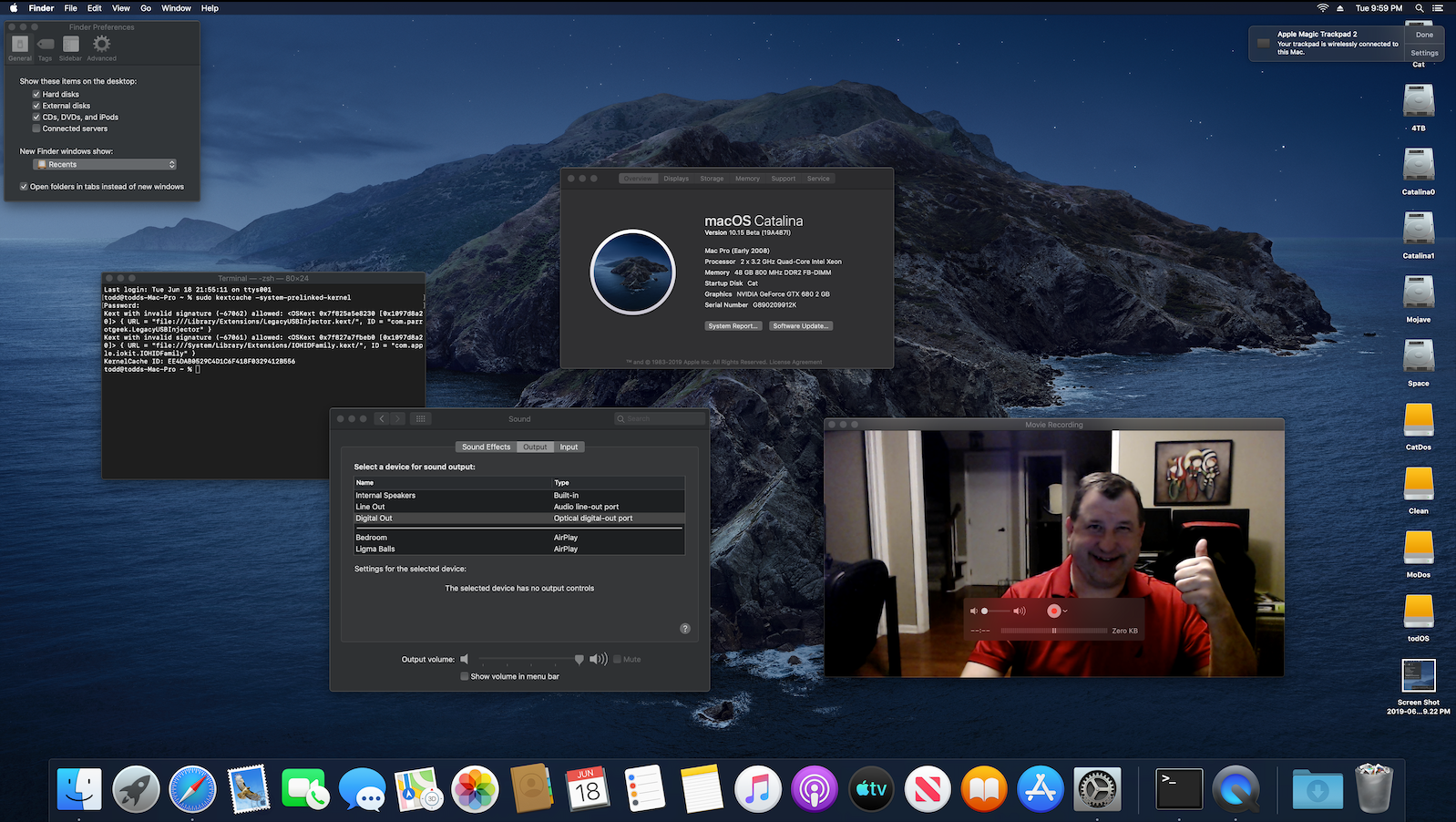

I am in my final round of testing Beta 1 soon Beta 2 with the patches I've compiled. Bluetooth can still be a little bit a bugger with the Mac Trackpad 2, but having USB working flawlessly helps with that problem. Simply plug it back in and bam it's sync back with bluetooth like it should. For me that little Legacy USB kext solved all my issue problems without having install other USB patches on top of the system. Without finding that fine line, I had Cam work, No Trackpad and vice versa. I even had Wifi, no sound and was getting all kinds of wierd stuff like that til I focused on narrowing the set of patches that were used on Mojave mostly from the Dosdude1's patcher and try to find the least common dominator and with some patience I am really happy with the results.
I have a couple other Macs I can get into patching later which include Mac Book Pro 2009 (two units) and a 27' iMac 2011. I may get an eGPU case for the 2011 unless I can swap the GPU easily enough that box is a pain to get inside and an eGPU for me might be best and I can not limited to just one card model.

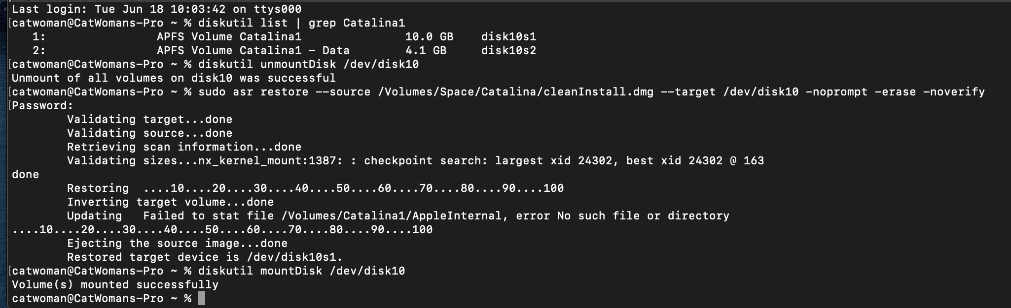

Anyways, I wanted to share my terminal screen for copying a fresh install DMG:
I do plan to make this much easier with a UI. Mainly so we can backup a booted patched system easier. Not really to make clean installs, but I am using it that way as a clone of a clean install takes only 2 minutes.
The thing about Apple Software Restore or ASR it requires 2x data space for the restore (this is where the inversion takes place at the 50% mark), but the good news it does not require a full disk copy like dd does out of the back. ASR can work with rdisk like dd can. See asr man page for details about cloning APFS and inversion.
I am using hdiutil to create the disk images. I still need to try dd soon and will probably do that with beta 2. ASR can clone disk-to-disk or image-to-disk as long as the target space is not over 50% full.

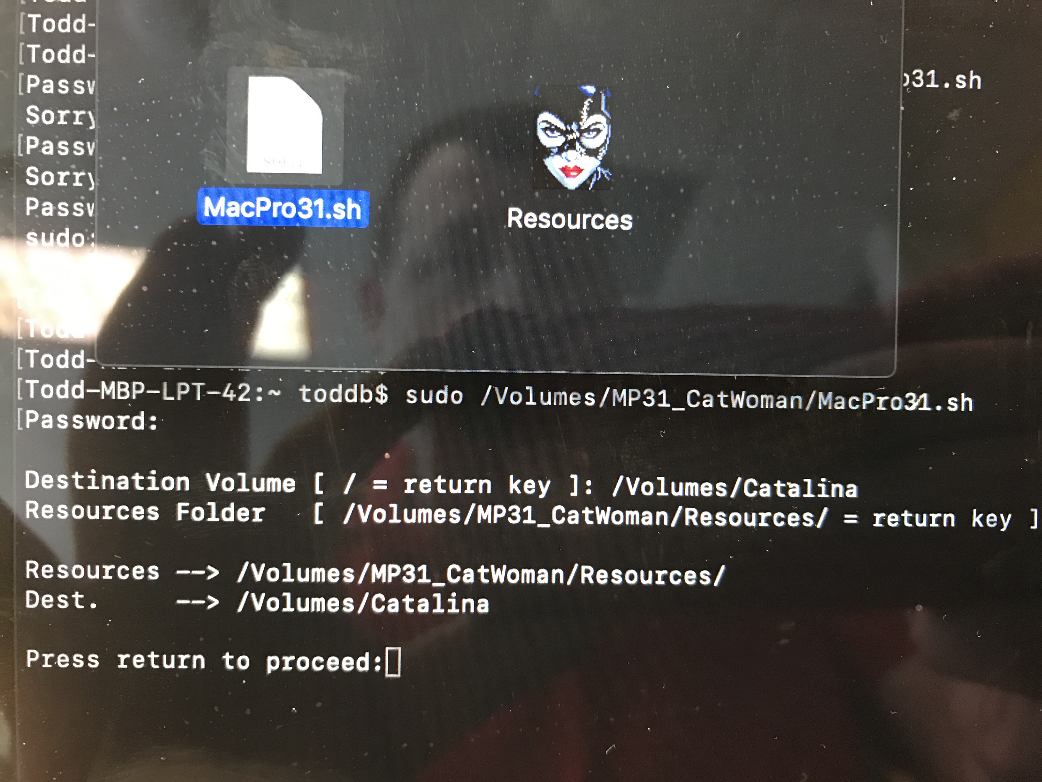

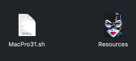

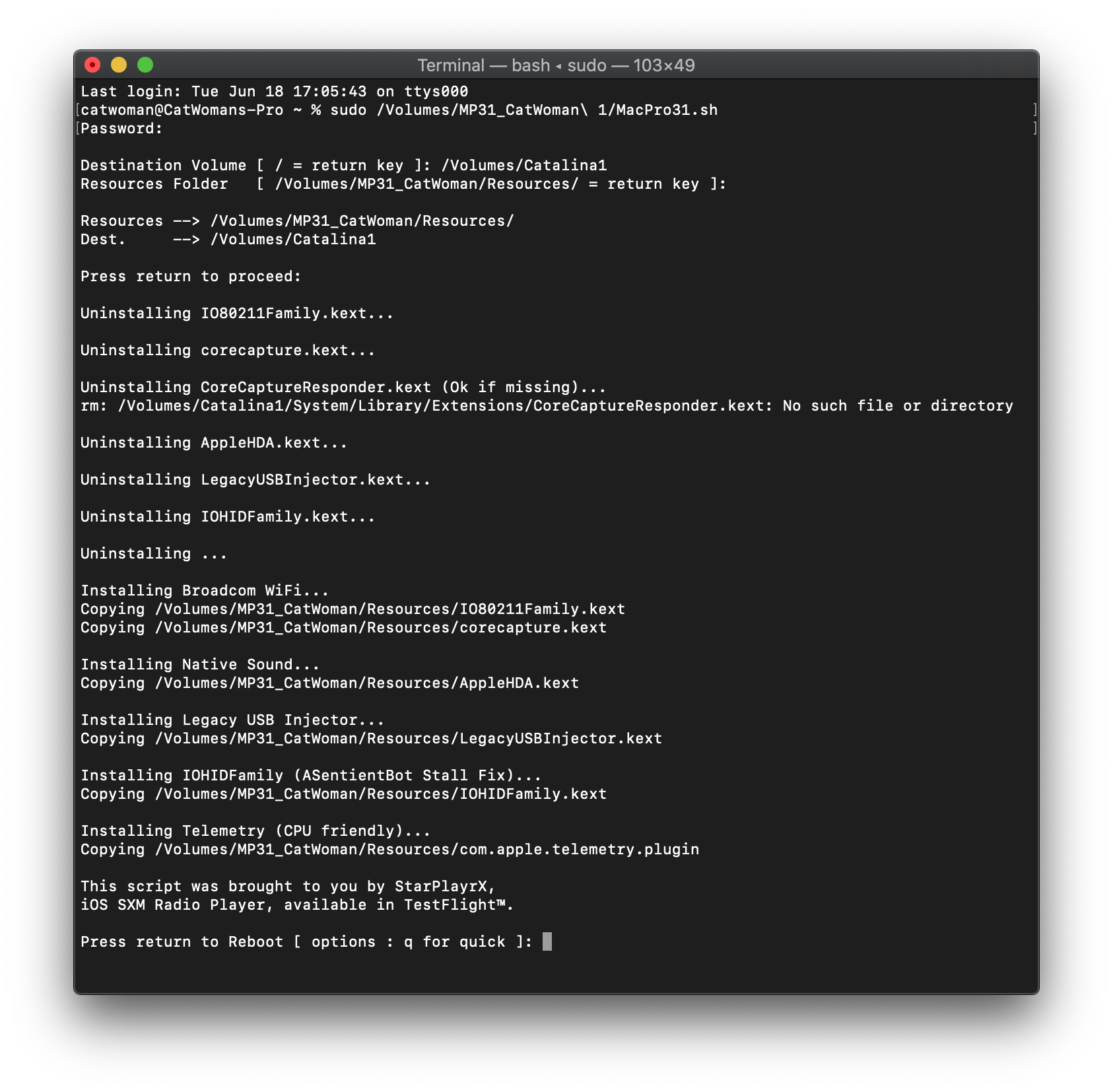

Here is my interactive shell script patch tool for Mac Pro 3,1 (2008) for Catalina Beta 1
MP31_CatWoman v01b1
My script is designed for a clean install on Catalina Beta 1. I have not tested it with Cat Beta 2 yet, but will soon.
It does not install macOS. It only patches a clean installation that can be done with a Supported Mac or Dosdude1 patched installer tool. I narrowed the MP3,1 patches down as much as possible and allow maximum compatibility especially with USB.
Download the dmg here.
Terminal needs Full disk access. run command with sudo. Pay attention to the prompts. It allows you to change the destination volume with either / or /Volumes/DestName. You should not have to edit the source path. Press enter for defaults. It will not run until you press Enter on the third prompt, showing you a print out allowing you to abort if necessary.
It may work fine with Core2Duo machine except there are no video patches. All my work thus far has been on MP3,1. (It's been only tested on MP3,1)
I did not write any of the patches and tried to give credit at the bottom of the source code. The ones I used are mostly from Dosdude1's Mojave Patch tool, but very focused and tried to get everything working out of the box in one quick shot. I spent many days with applying various patches to clean installs and in the past few hours spent today found what I consider to be a great combo. Whoever wrote the Legacy USB Injector is brilliant. That's all that's really needed with Catalina Beta 1 to get USB fully functional with many different types of devices on the Bus.
MP31_CatWoman v01b1

Can you give a simple command to make a DMG of a working APFS drive? One that only takes as much space as is used and doesn’t contain all the free space like dd does?
Okay. Here is some info on how to create a DMG without dd that can be restored later to another drive of a volume is equal or larger using another command. I know not that simple. Trust me, it will be soon.
First find the disk and here Cat is replace it with your Volume name:

[doublepost=1560917919][/doublepost]I am restoring Beta 2 now and will be testing my set of patching on it shortly right before I go to bed.
Here are my commands for restoring a disk via asr.
diskutil list | grep Catalina2
1: APFS Volume Catalina2 - Data 57.1 GB disk7s1
4: APFS Volume Catalina2 10.1 GB disk7s4
diskutil unmountDisk /dev/disk7
Unmount of all volumes on disk7 was successful
Here rdisk can be used and it will speed things up by 3x.
sudo asr restore --source /Volumes/Space/CatalinaB2/Cat_cleaninstall.dmg --target /dev/rdisk7 -erase -noprompt -noverify
Password:
Validating target...done
Validating source...done
Retrieving scan information...done
Validating sizes...nx_kernel_mount:1387: : checkpoint search: largest xid 772, best xid 772 @ 31
done
Restoring ....10....20....30....40....50....60....70....80....90....100
Inverting target volume...done
Updating Failed to stat file /Volumes/Cat 1/AppleInternal, error No such file or directory
Ejecting the source image...done
Restored target device is /dev/disk7s1.
diskutil mountDisk /dev/disk7
Volume(s) mounted successfully
That was done in how long it took to write this message.
Then run patches.
Rebuild Prelinked Kernel manually for now on Beta2.
This restore was from a 32 GB drive to a 500 GB. asr handled it great!
I was able to rebuild the prelinked kernel Manually in Beta2. Apple fixed their AppleUSBAudioKextSigning In b2.
Sseeing if my patch script takes on b2. If successful, I will add the commands. If not successful, I’ll troubleshoot the differences in B1 and B2.
[doublepost=1560920867][/doublepost]
I was able to rebuild the prelinked kernel Manually in Beta2. Apple fixed their AppleUSBAudioKextSignung, seeing if my patch script takes on b2. If successful, I will add the commands. If not successful, I’ll troubleshoot the differences in B1 and B2.
With running this command to rebuild:
sudo kextcache -system-prelinked-kernel
on Beta 2.
My b1 patch script works fine. I will add in that command as well as
sudo kextcache -system-cache
before reboot happens.
That will be in my b2 script soon.
If you have any suggestions on the prelinked rebuild commands, especially for running it on another target, please let me know. I'd like some good advice there for the script.
I am happy to report rebuilding the prelinked is working for me on Beta2 and it was required this time around for the patches to take unlike Beta1 that would let stuff run in the Wild. Boot of course is even faster. Guess it does not rebuild on it's own even when if says ...kext triggered rebuild. Just means to rebuild it. Got it. Apple has fixed my issue with it, so I will be adding it to my next script 01b2 eta 24hrs.
Least Beta2 is not much more trouble than B1. I don't know about Dosdude1's installer yet. I have not used it. I've been doing the transfer thing instead using HDIUTIL and ASR commands. I will test Dosdude1's solution soon.
