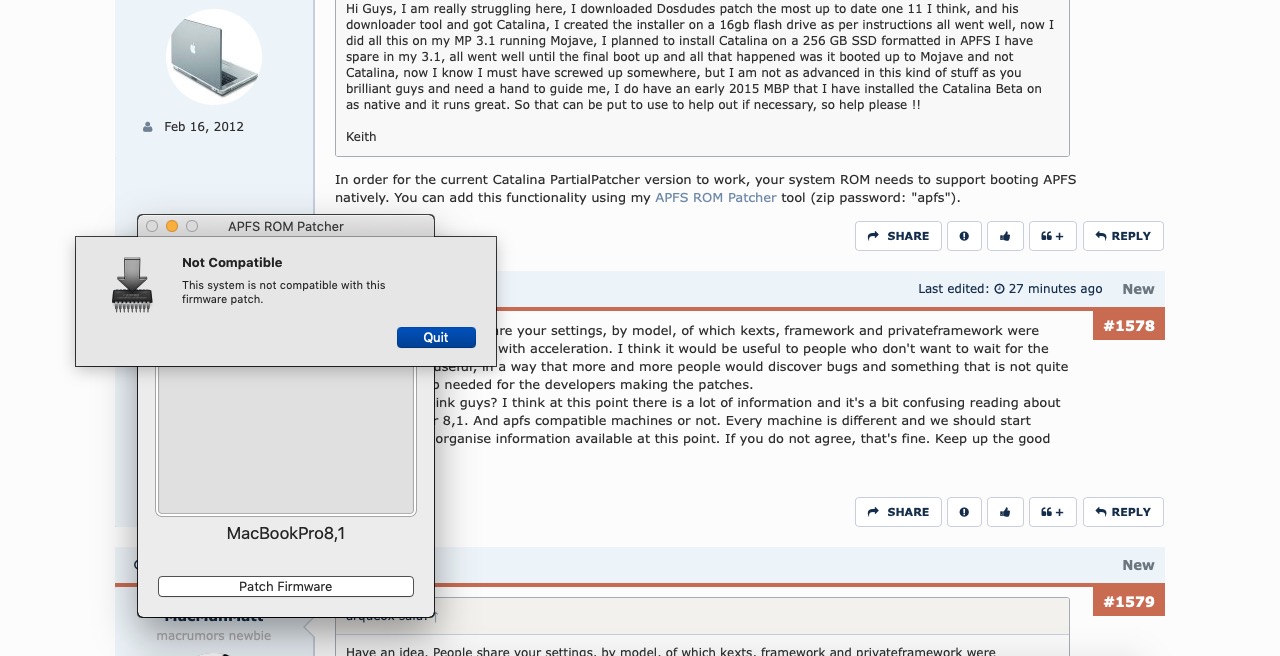

Hi Guys, I am really struggling here, I downloaded Dosdudes patch the most up to date one 11 I think, and his downloader tool and got Catalina, I created the installer on a 16gb flash drive as per instructions all went well, now I did all this on my MP 3.1 running Mojave, I planned to install Catalina on a 256 GB SSD formatted in APFS I have spare in my 3.1, all went well until the final boot up and all that happened was it booted up to Mojave and not Catalina, now I know I must have screwed up somewhere, but I am not as advanced in this kind of stuff as you brilliant guys and need a hand to guide me, I do have an early 2015 MBP that I have installed the Catalina Beta on as native and it runs great. So that can be put to use to help out if necessary, so help please !!
Keith
In order for the current Catalina PartialPatcher version to work, your system ROM needs to support booting APFS natively. You can add this functionality using my APFS ROM Patcher tool (zip password: "apfs").

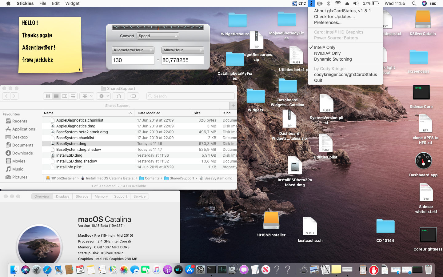

Right, but I used the other @ASentientBot method (with a little modification in my case) that is createinstallmedia that keeps the full CatalinaInstaller.app as is, then replacing inside the InstallESD.dmg (RW shadow volume) the OSInstall.mpkg (apple signed) from HighSierra.
However I was able also to create a custom BaseSystem.dmg and embed it there keeping all the (shadowed patched) dmgs mounted in RAMdisk when you boot targeting this USB Drive.
I add some picture in a while.

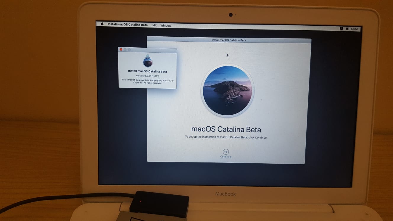

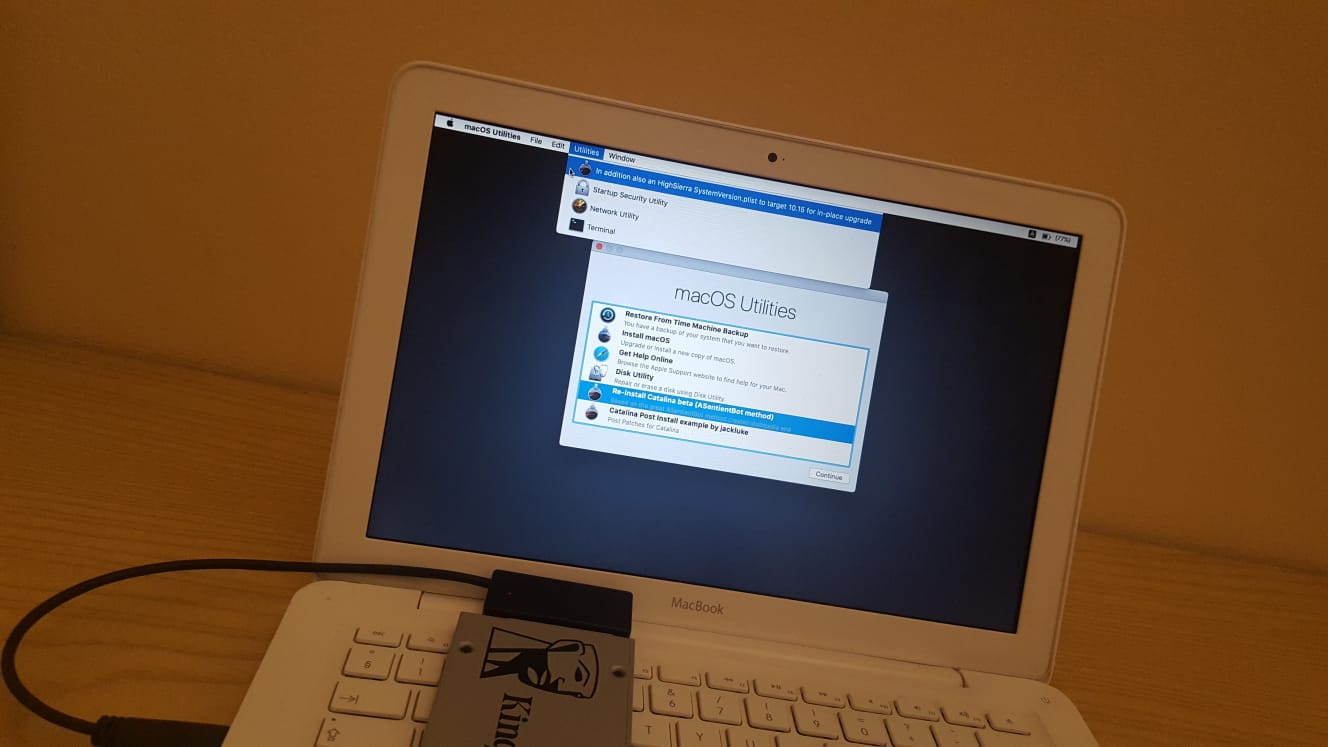

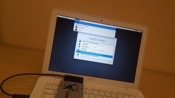

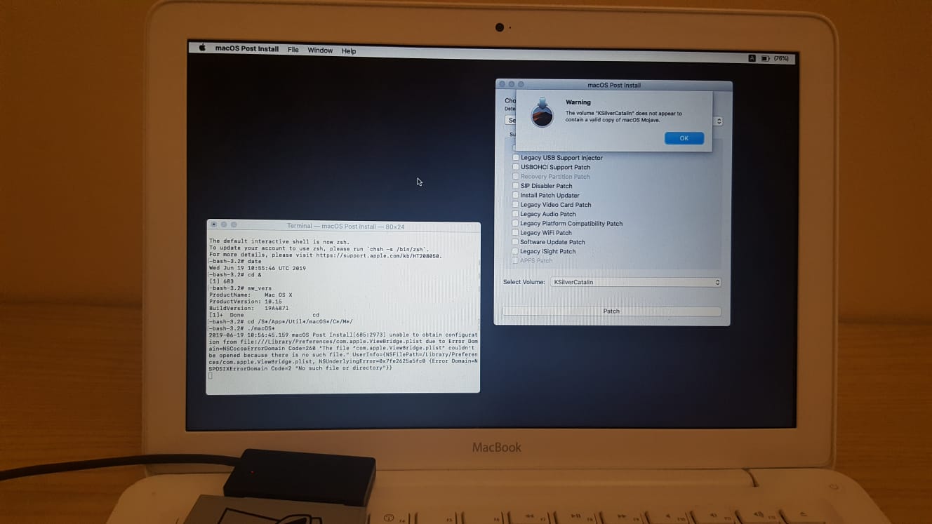

I know that to create a Catalina Installer (for unsupported machines) both your method and dosdude1 work, but also the @ASentientBot one allowed to customize the Installer boot menu, adding for example the dosdude1 Mojave Post Install.app, that putting inside a Catalina BaseSystem.dmg will work , except that "Video Legacy Patch" needs to be updated with SkyLight.framework, CoreDisplay.framework, IOSurface.kext and IOHIDFamily.kext to reflect @ASentientBot new Catalina patches, but all the other retro-patches are Mojave confirmed.
The pictures showed are booting from a full (manually patched) CatalinaInstall.app (with all the dmgs inside as stock createinstallmedia) and pre-patched with shadow volume to allow inject the required modifications.
For InstallESD.dmg just this /Packages/OSInstall.mpkg (HighSierra apple signed)
For BaseSystem.dmg just the "Mojave Post Install.app" in /S/Applications/Utilities/
and Utilities.plist customized
And on my root CatalinaAPFSVolume /System/Library/CoreServices/SystemVersion.plist (from HighSierra) to allow an in-place upgrade over a previous Catalina.

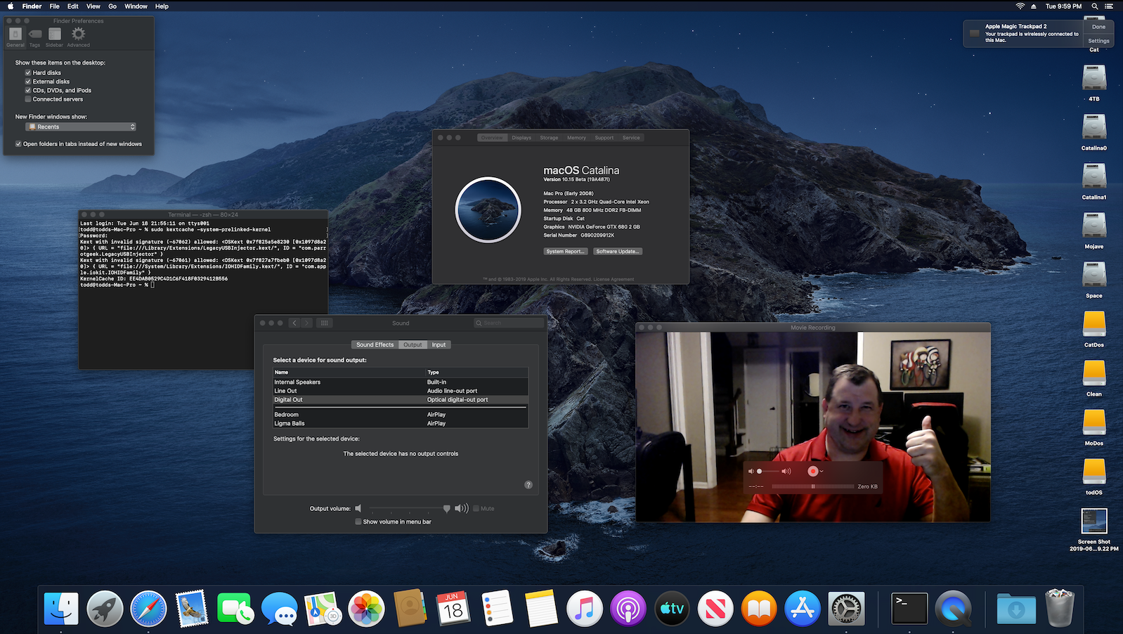

Acceleration achieved on DP2! :)
View attachment 843591 View attachment 843597
Yay!

Good job, that's a great solution for unsupported machines.
