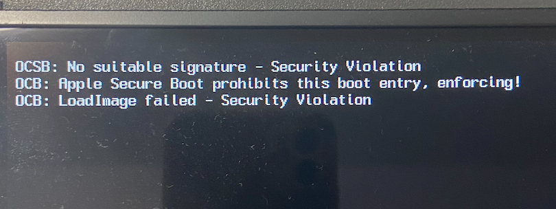

got this and no matter what version of oclp i use with catalina/mojave custom video card. Any advice?

Oh, i got this, but after installing Mojave system says - 14 mib unknown video card
Most likely you need to apply the patches after primary installation. Take a look into the OLCP online documentation, the process is always the same, regardless which macOS version you install.
And it would help if you reveal some more information about your hardware.

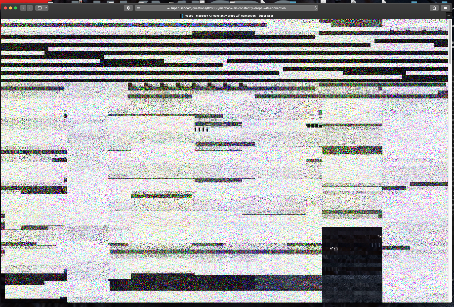

after previous legacy patcher i have wrong display of Safari :/ I attached file. Does anybody have fix for this?
I cant install latest legacy patch :/ Running Catalina 10.15.7 on macbook pro mid 2010
thank you

My recommendation, since theres not much activity here, is to reinstall the OS again, and avoid the legacy patcher..tbh it was the source of a few problems for me. my safari is fine.

OLCP has dropped Catalina and Mojave support with version 0.4.4. Of course you can download and use an older version to enable root patching and technically there is no reason to use the latest OCLP version with Mojave or Catalina.

@grooveq @Ausdauersportler I have Geforce 330M (pre-metal)
I was able to solve this problem - I dont know how, but i was able to install latest legacy patch (I think it was released around week ago).
I dont have any other problems - Only one with video playback in safari. Usually I have black "window" when I try to play video on youtube or facebook. I have to force QUIT safari and open it again :/ Maybe somebody know about fix for this - I have this issue since I updated OSX to Catalina.
Thanks
