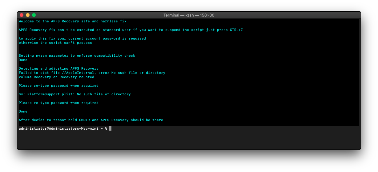

The script just needed to integrate or to type before running in Catalina Terminal: sudo mount -uw /
However keep in mind that the "CMD+R" associated to your machine is only the latest macOS installed or re-installed or beta updated.
For example, if on internal disk I have two APFS containers with Mojave and Catalina, and I install/update Catalina, then "CMD+R" Recovery is Catalina, if instead I re-install or update Mojave to its next beta then APFS Recovery becomes the Mojave one.
I tried that and this happened. I wasn't asked for my password and upon reboot with CMD+R, nothing. The computer froze and needed to be hard reboot.

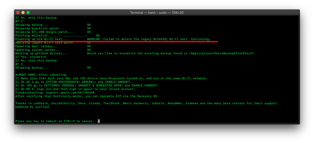

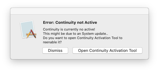

So then Continuity Activation tool, I get this warning when I run it...
And this when I reboot into my admin account. I normally use a standard user account, like I am now.
Nowhere in my settings do I have a check box to enable Handoff as I did in previous OS's

You should use an administrator account for both the scripts.
Maybe you have a Catlaina APFS empty Recovery, could you check from Terminal:
diskutil mount Recovery
open /Volumes/Recovery/
and check inside if there are basesystem files.

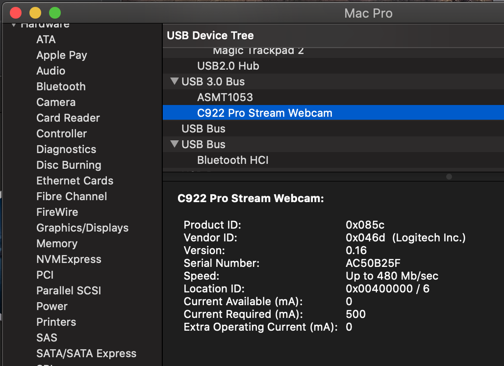

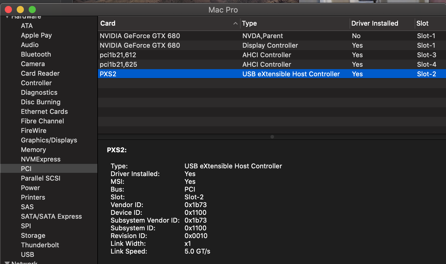

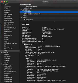

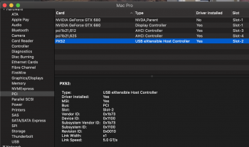

I purchased a red Inateck® USB 3.0 PCIe card. It sports 4 USB 3.0 ports. The card is 1x width and runs up to 5.0GT/s. You can put it on a 4x slot on the Mac Pro 3,1 but it will run at 2.5GT/s. It is too bad you can't configure the slots on the MP3,1. It did not require additional drivers to operate on Mac; works well with whichever Catalina USB drivers uses along with Parrotgeek's USB Legacy Injector (this is all I use for USB). The card does not require additional power. It runs about $29 and the seller offers volume discounts.
eBay: https://www.ebay.com/itm/Inateck-Inateck-4-Ports-PCI-E-to-Interface-USB-3-0-Expansion-Card-for-Mac-Pro/272407976946?ssPageName=STRK:MEBIDX:IT&_trksid=p2060353.m2749.l2649
on eBay it says it's Incompatible with Mac OS X 10.10 Yosemite or above, which is untrue.

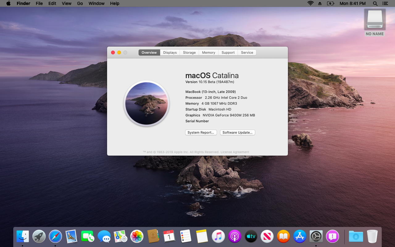

MacBook 5,1 Unibody Late 2008 (8Gib+SSD), running Mojave 10.14.5 on HFS+, it does not support APFS boot natively. Is there a way to upgrade it to Catalina without losing data? Or fresh install. I think current available options are for device with native APFS boot, right?
