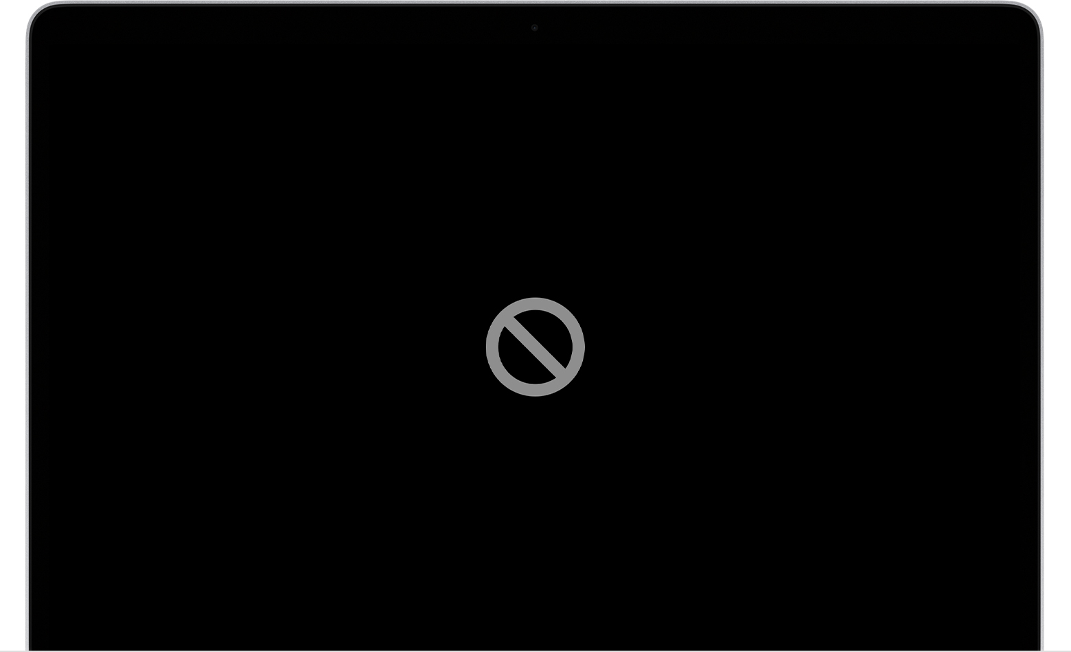

after I downloaded Big Sur and hack file and typed the command , unable to boot and got this error .
There is something missing
(MACBOOK PRO MID 2012)
Try this: Post #3,056, Monday at 08:55

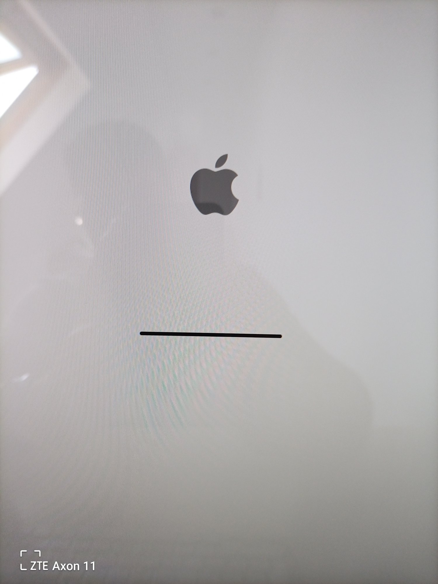

my fresh install is in a boot loop. In verbose mode it gets through everything fine. It’s when the Apple turns white and the bat loads a little bit and then it reboots. Iv gotten past it before. I’ll let you know what I do.

Many thanks for trying to sort it posted those log files their in page 123 post 3063
As far as I can tell it says the install succeeded, I’m lost with it doesn’t make sense beta 2 installed no problems at all
That was using the parrot geeks method
I see both on the drive with beta 2 if I try to update it and on a Catalina desktop it’s labelled as update but on a fresh install I see nothing. In disc utility it reports the drive as “installer” and is not mounted if that helps at all
