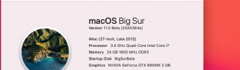

Upgraded iMac 13,2 (27 inch, late 2012, HD- fusion drive)
Used Barry's K. Nathan's patcher 0.1.0 to create USB stick with patched Big Sur beta 6. Installation went smoothly; Airdrop , Handoff and Hostspot fully functional. It was a clean install on reformatted (empty) partition.
Had to reformat partition containing Beta 5 when message appeared, that there was not enough space to complete install. There was a note from B.K. Nathan, in previous posts, that implied "not enough disk space ... to install..." message, might be an issue with the patcher (?)
When installing, make sure to follow B.K. Nathan's instructions carefully, e.g., when instructions direct to quit "installer assistant", and shut down the Mac, do so.
Did not try to upgrade MacBook Pro 5,2 from beta 4, given lack of graphical acceleration.
Thank you to all developers, who have made the BIgSur viable on the "abandoned" Macs.

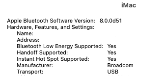

Successfully installed on Late 2013 27" iMac. Had to manually set args and csrutil disable a few times to get it accepted to run. I think with filevault turned on, it's best to go to disk utility and make sure the disks are mounted and unlocked first. Unlocking during install did not work. Then after making sure they were unlocked, that didn't work either. So, making sure they were unlocked, mounted, then running args and csrutil, I was able to get install to work.

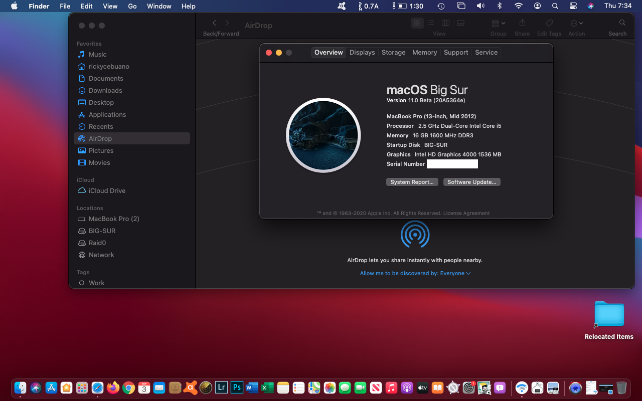

Would this approach work on a MacPro 2008 with GTX680 and BCM94360CD as well?
Had the same (expected) issue on MBP 13" mid2012. You need to run the installation from a micropatched USB installer. Follow Barry K's instructions.

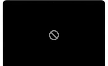

I did at first and posted here the picture came out the data was not found and I ignore that trying to installed the big sure patch and always got stuck at 12 minutes with forbidden sign and shutdown by itself and here's the picture attached and thanks to you and Perry was trying to help me solve this issue
You may have to erase the USB and start from fresh, just follow Barry's micro patchers instructions step by step you will get it.

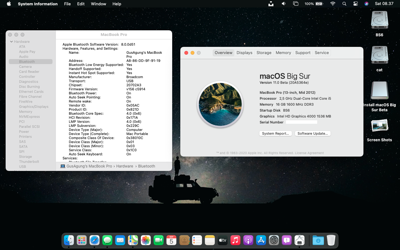

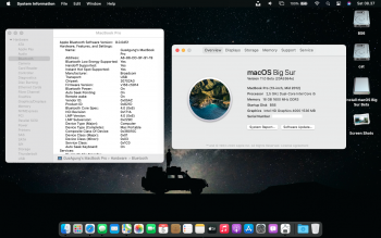

MBP 2012 BS B6 Work Ok
Use Micropatcher 0.0.19

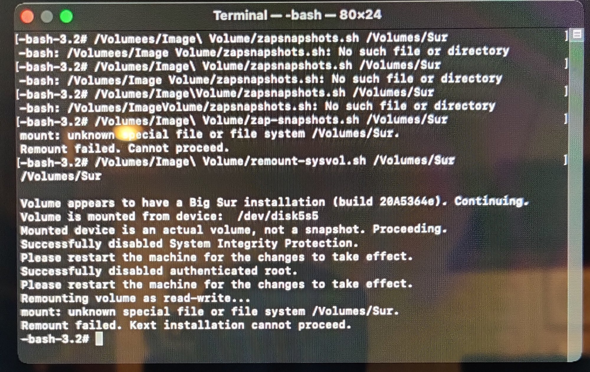

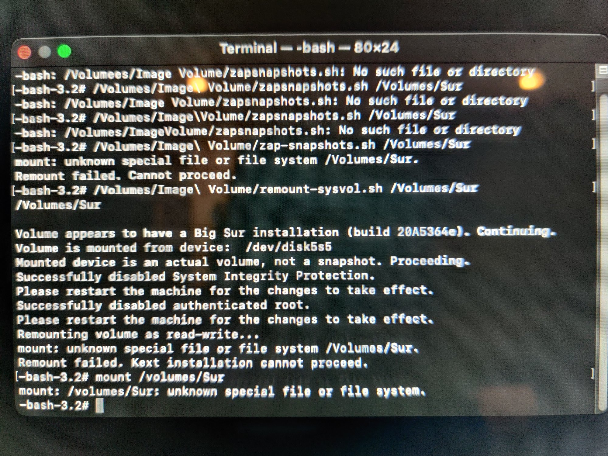

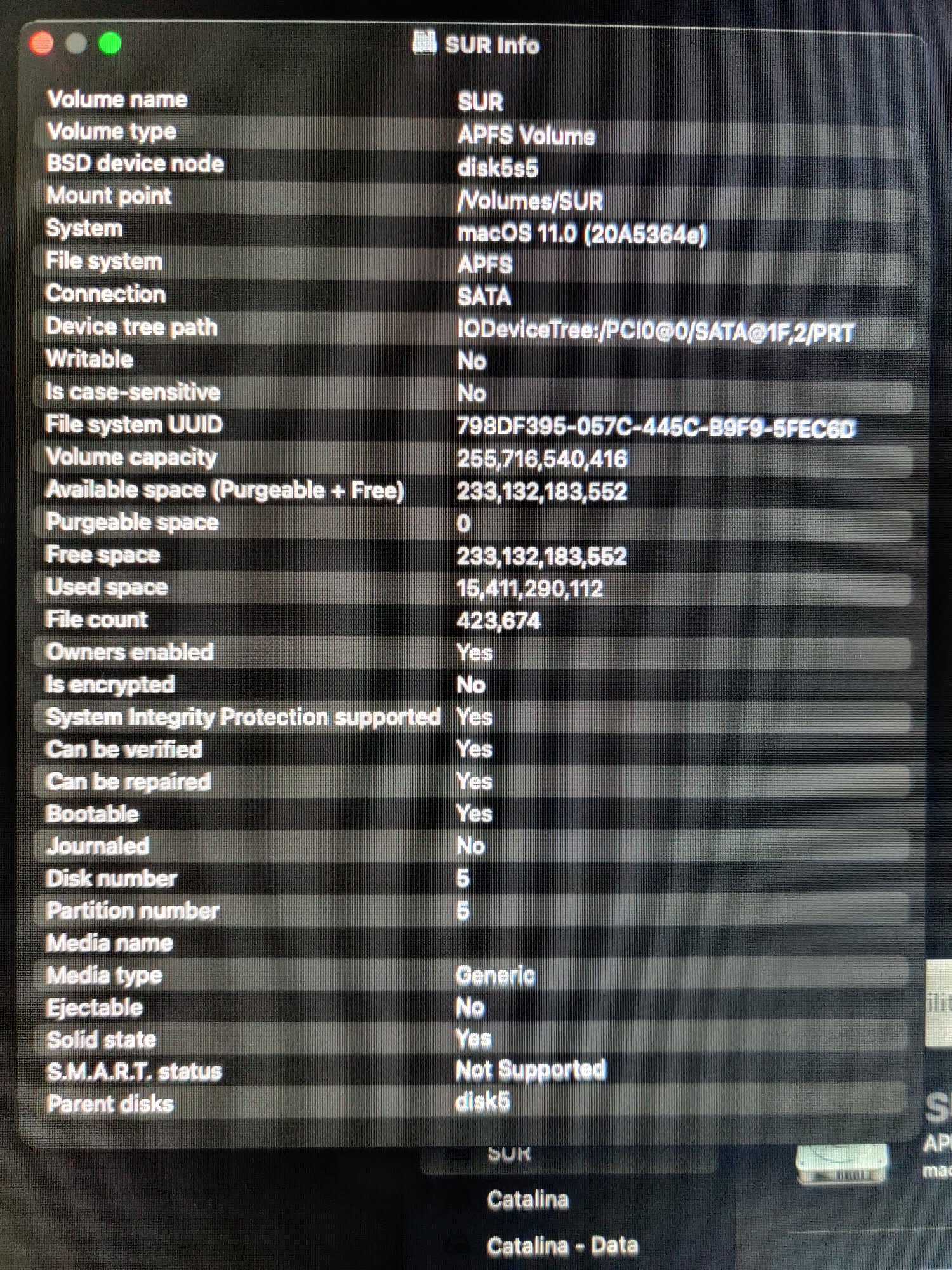

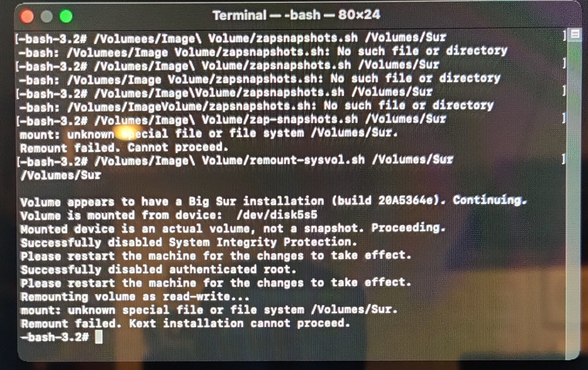

Updated from beta 4 to beta 6. I have an annoying issue in Recovery that my volume is "unknown special file or system". I also see the volume is no longer writable which probably means it has sealed itself. I ran the proper set-vars.sh at the beginning before the install. Anyway to unseal the volume again?
The "unknown special file or system" message has been addressed in one of the previous posts in this thread.
Attached is a copy of the response which solved this message problem.
Please note, that credit for this workaround belongs to the original author of the excerpt I included in the post.
You do have to identify the disk ID on your drive and substitute for the "disk2s5" entry. Hope this may be of help.
From USB BS Installer Recovery Terminal:
diskutil mount disk2s5
Volume Big Sur on disk2s5 mounted
terminal command ==> mount -uw /Volumes/Big\ Sur/.
system response ==> mount: unknown special file or file system /Volumes/Big Sur/.
Workaround (message):
Regarding the "unknown special file or file system" issue,
I had the same issue. However it did work for me when I put the path within quotation marks.
mount -uw "/Volumes/Big Sur"

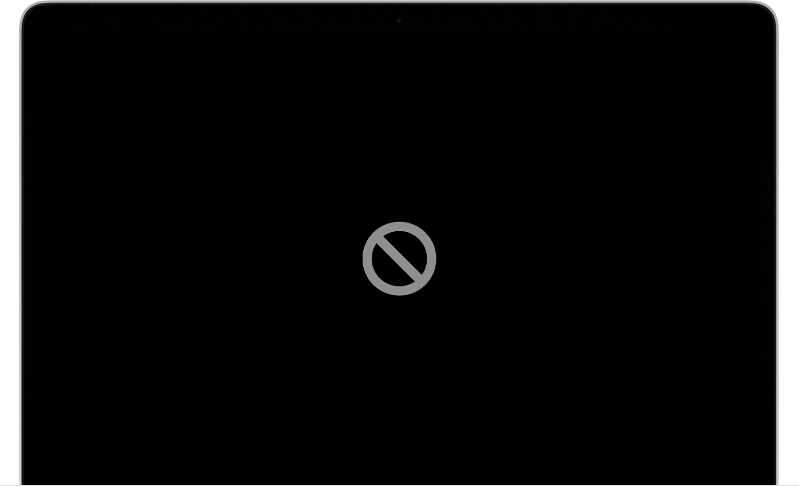

reset nvram will make already exist Mac os big sur fail to start

Because it is wrong, it is
/Volumes/Image\ volume/set-vars.sh -v
Not
/Volumes/Image/ volume/set-vars.sh -v
You see the difference...?
forward slash is the wrong one, i did installled beta 4 and 5 before for some reason can’t install it now ,i was using beta 5 and reset the nvram then i lost it trying to re-install using usb but “nvram error boot arg not found”
