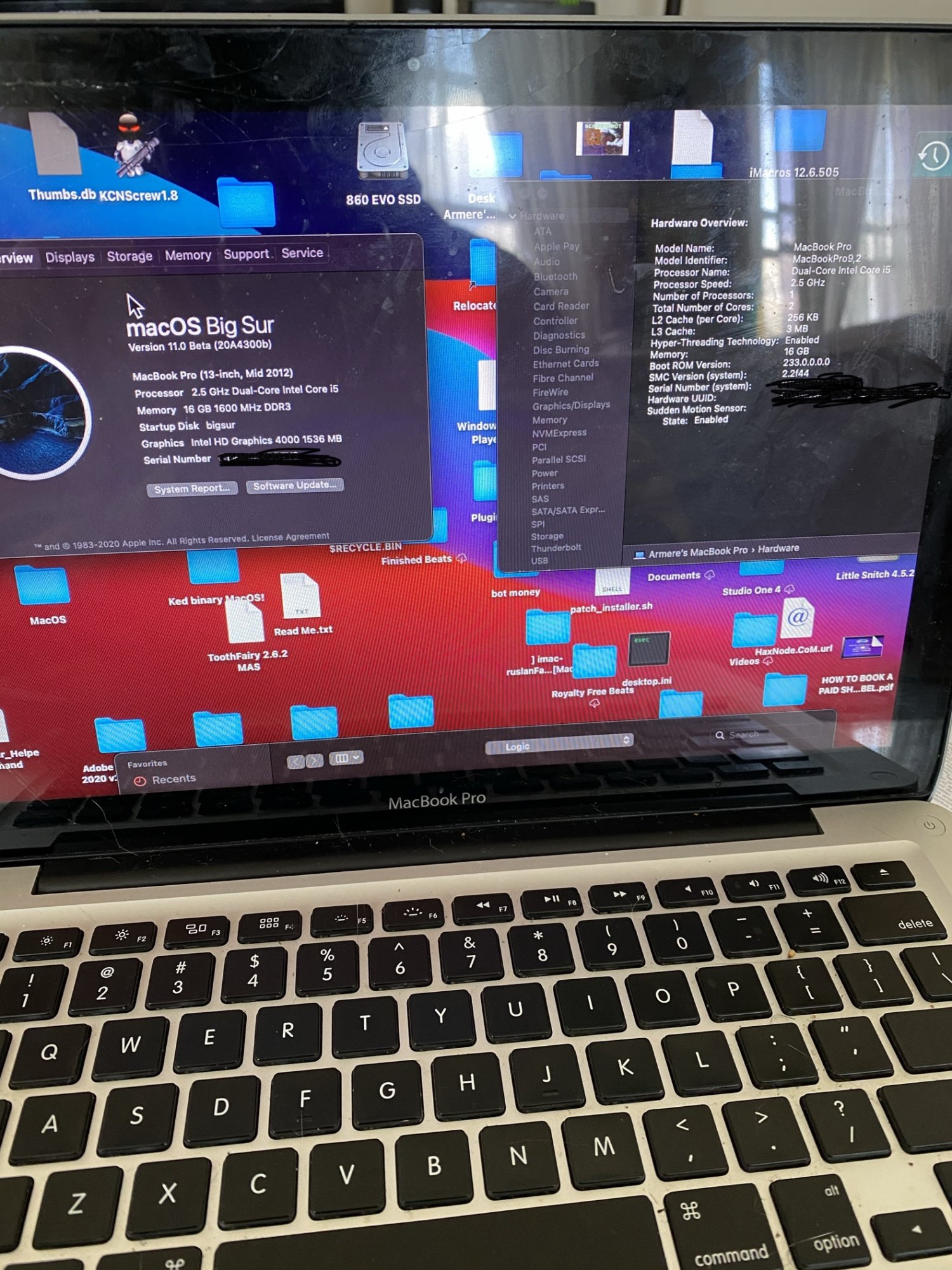

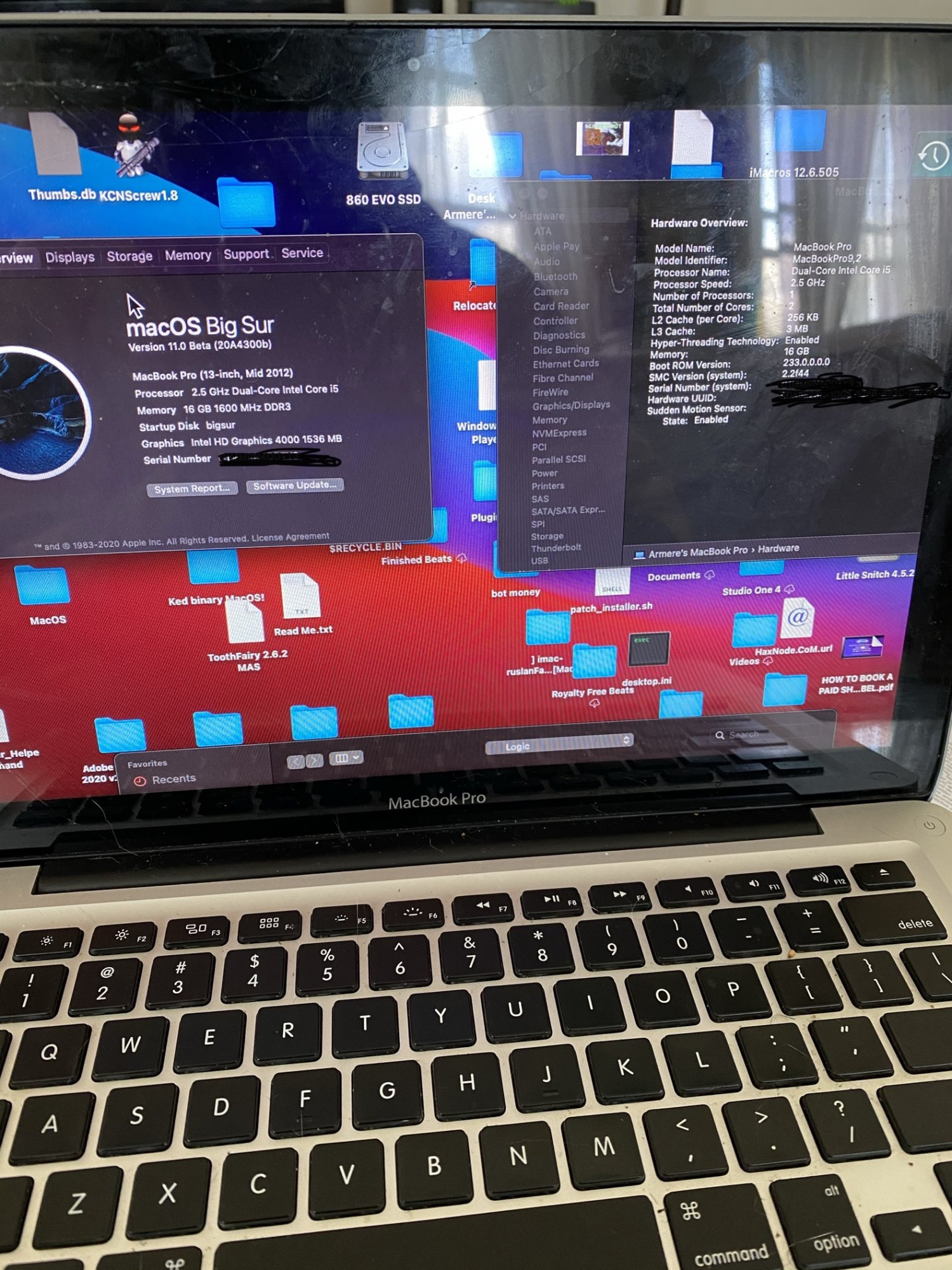

SUCCESSFULLY GOT BIG SUR BETA 6 on MacBook Pro mid-2012 16 GB 1600 MHz DDR3 with x2 1 TB Samsung evo SSD’s internal and a WD My Book 4TB external HDD on the side it works With Everything wifi airdrop etc.. thank you to @Barry K. Nathan micropatcher Great work keep it up!!!
Hi! You have installed Beta 2, not beta 6 ;)
Reactions: TimothyR734
oh wow thanks and I was wrong air drop don't work or handoff
[automerge]1599503407[/automerge]
do u kno how
to fix it
Download beta 6 and start the whole procedure again...yes...I know, that's the only way to update to beta 6.
