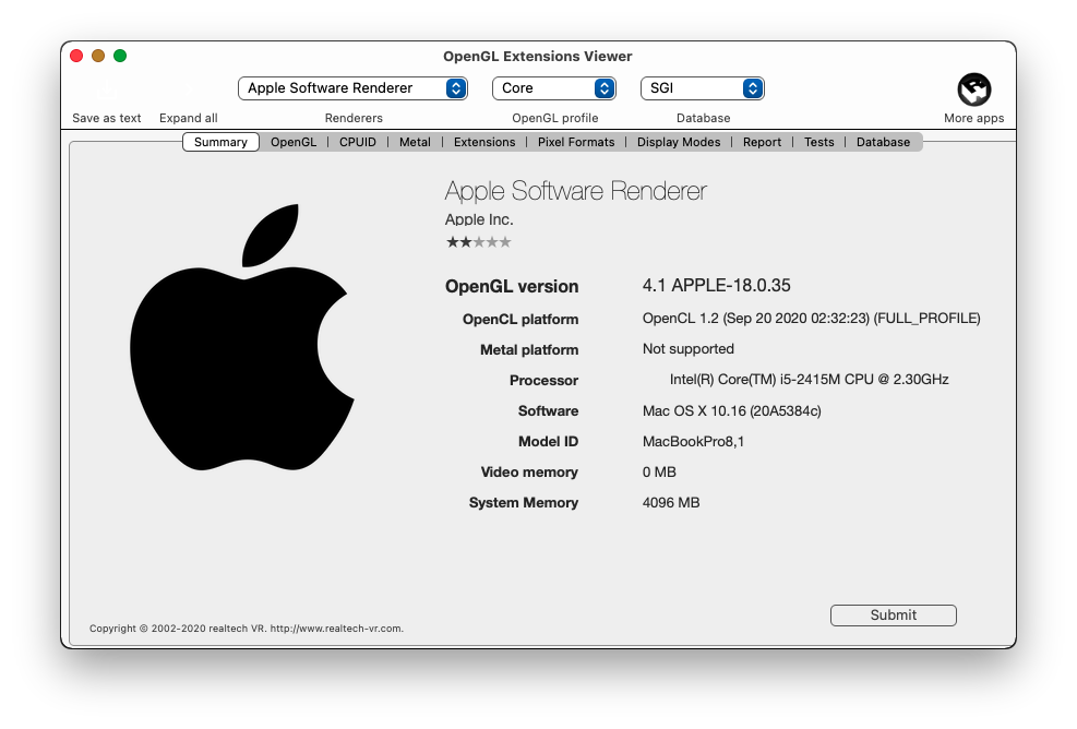

This instead should work on BigSur too but instead of kextcache it requires a kmutil snapshot kext installation and @Barry K. Nathan could test it: IntelHD3000 VRAM increase pre-patched HighSierra/Mojave/Catalina

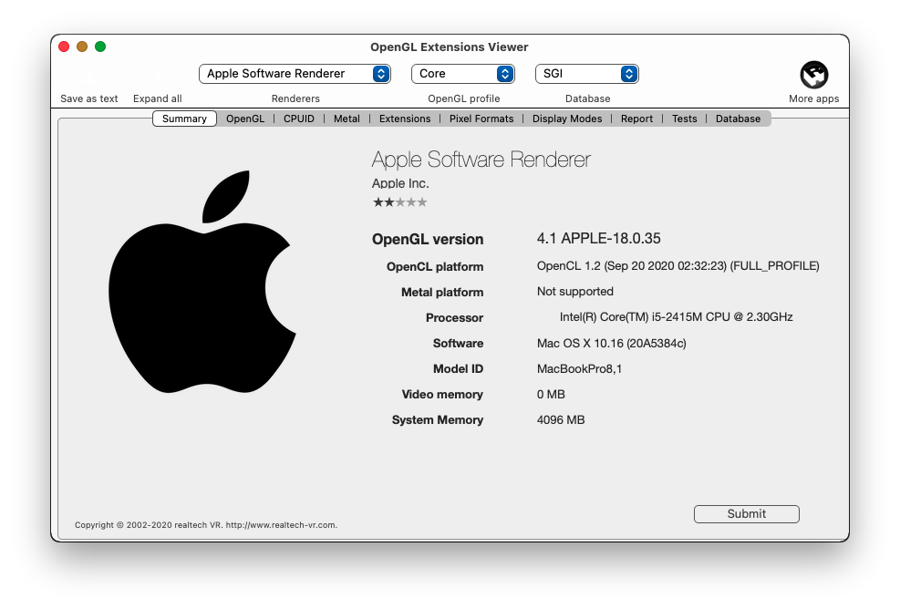

after kext patch to verify the VRAM increase just use this app: https://apps.apple.com/br/app/opengl-extensions-viewer/id444052073?l=en&mt=12
Note the amount of VRAM listed by the app. (On this same Mac, About This Mac shows 384MB VRAM.)
I would like to remind everyone that we're talking about the Intel HD 3000, which does not support Metal and does not have acceleration under Big Sur.
I tried the 2048MB version of the patch and it actually reduced performance for me -- minimizing a Safari window takes 14 seconds without the patch and 16 seconds with the patch. (Not too surprising; the extra VRAM doesn't help because the shaders are running on the CPU not the GPU, and the CPU's performance suffers from the loss of RAM.)

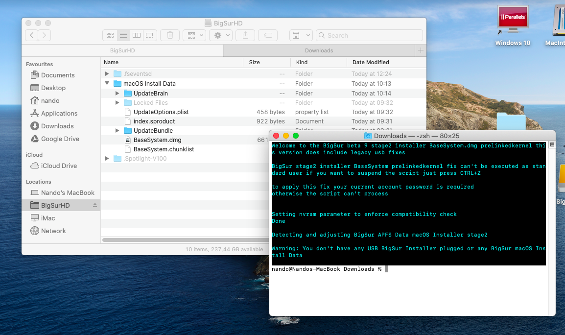

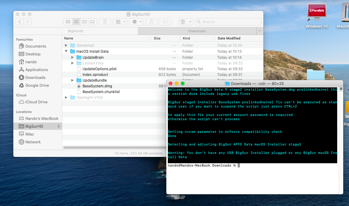

Before run the script, you need to plug the "USB Install macOS Big Sur Beta" (BaseSystem b9 legacy USB fix and fix2) because from there the patched BaseSystem is copied, it also makes a BaseSystembackup.dmg .
I wrote a condition on this new stage2 script that require also that BaseSystembackup, you can check from terminal with: ls /Volumes/*/BaseSystem/BaseSystembackup.dmg
After the patch you should notice in that "macOS Install Data" folder a new BaseSystem size 620 MB (from your picture the BaseSystem 661 MB is still the stock beta 9 incompatible with Legacy USB) and in "Locked Files" a BKE (prelinkedkernel) size of 25 MB (while the stock beta 9 one is 65 MB).
There was an issue on the script about unlock the "Locked Files", just fixed so redownload (updated also on previous post): BigSur BaseSystem stage2 installer fix.zip
Reactions: TimothyR734
There was an issue on the script, just fixed so redownload (updated also on previous post): BigSur BaseSystem stage2 installer fix.zip
Before run the script, you need to plug the "USB Install macOS Big Sur Beta" (BaseSystem b9 fixed) because from there the patched BaseSystem is copied.
I wrote a condition on the script that require a backup of BaseSystem, check from terminal with: ls /Volumes/*/BaseSystem/BaseSystembackup.dmg

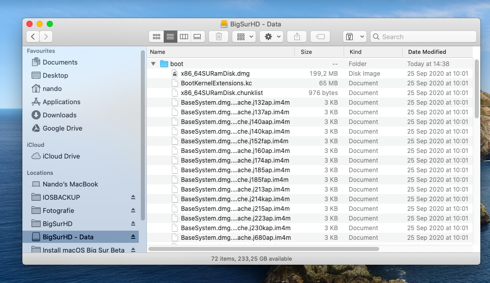

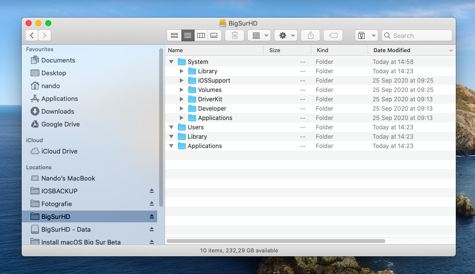

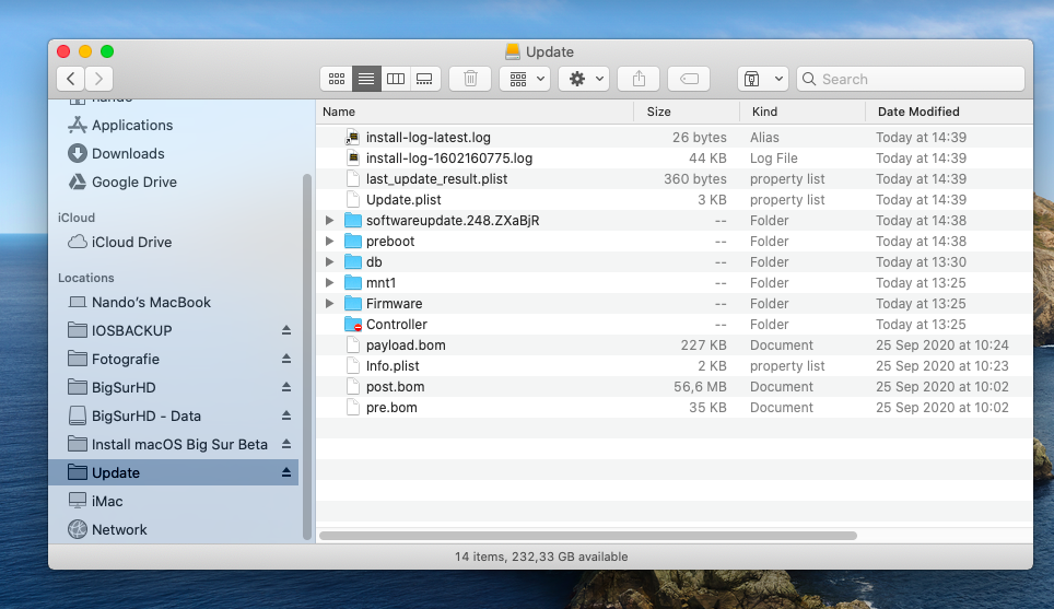

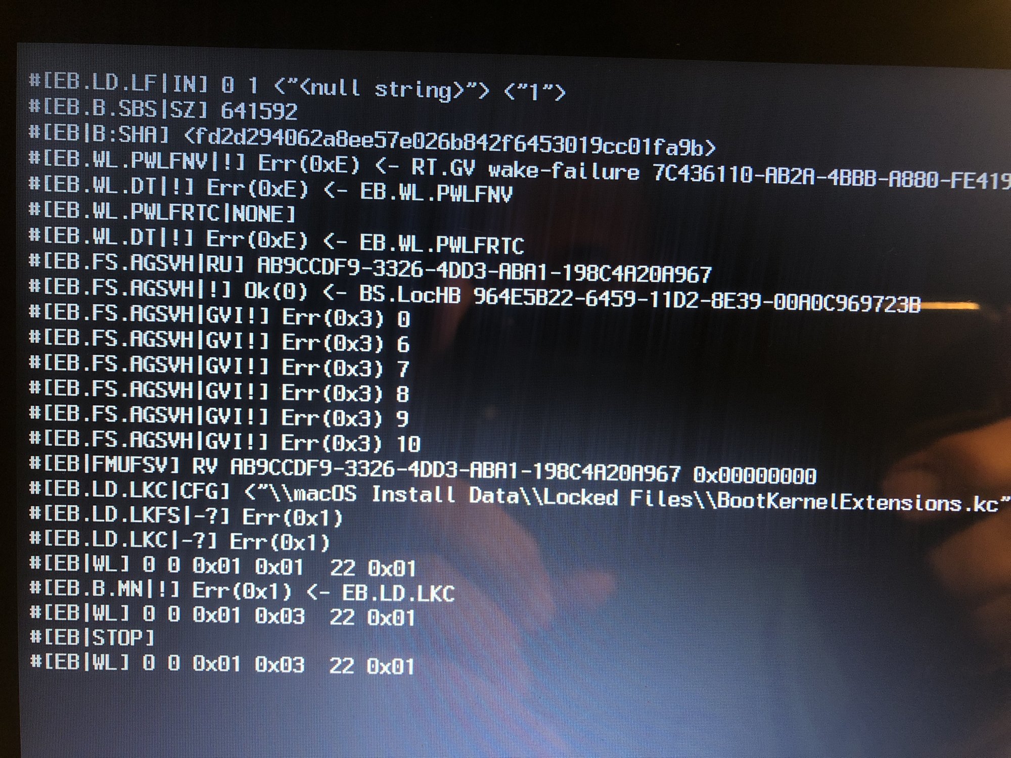

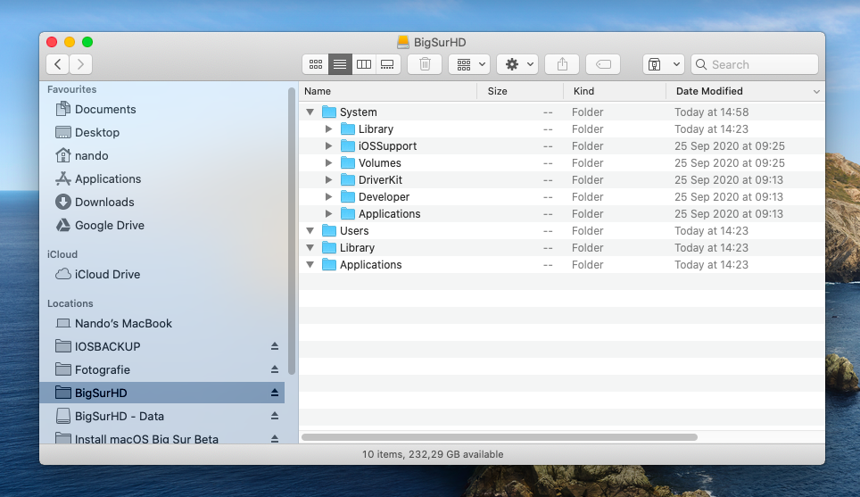

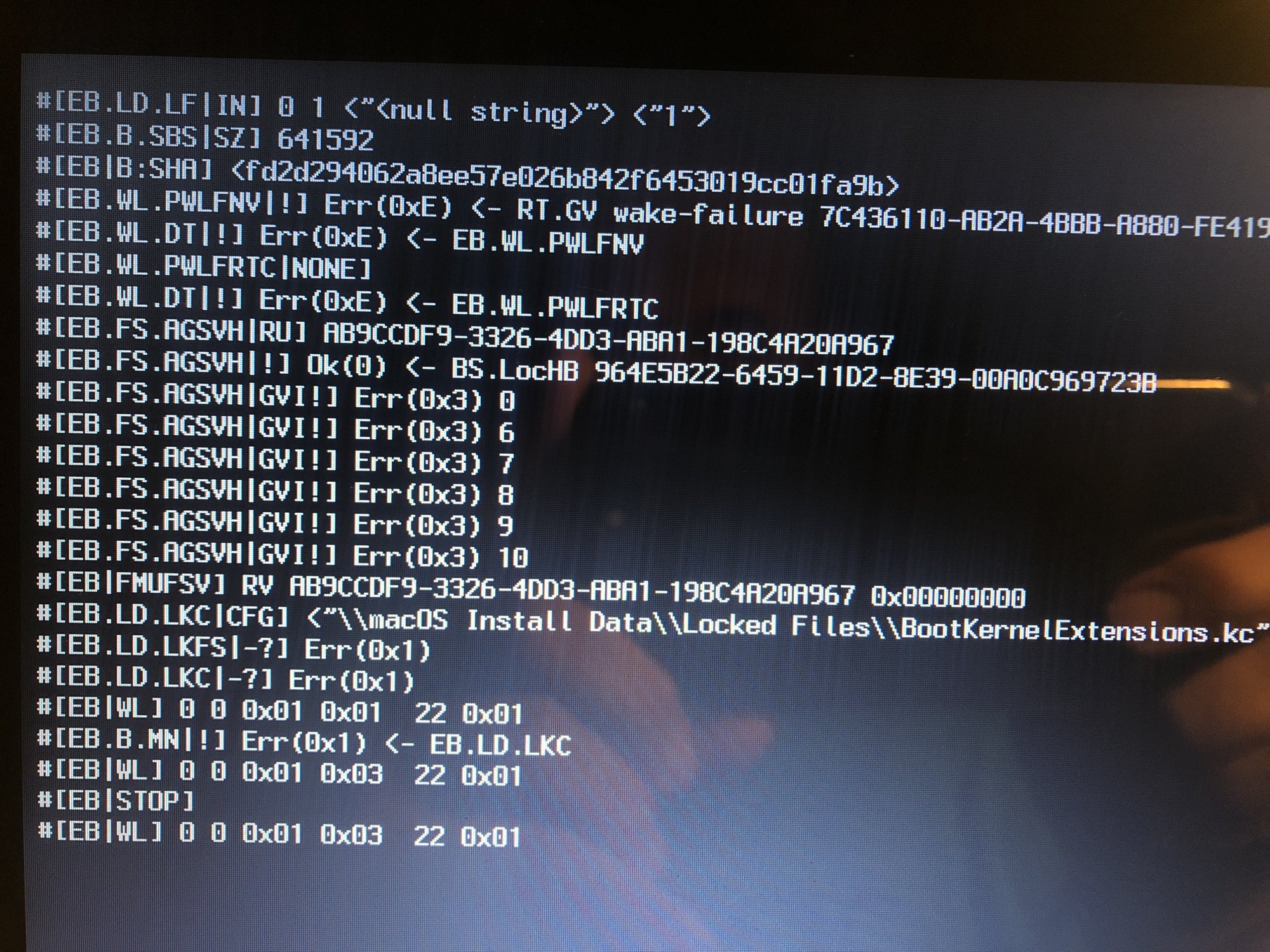

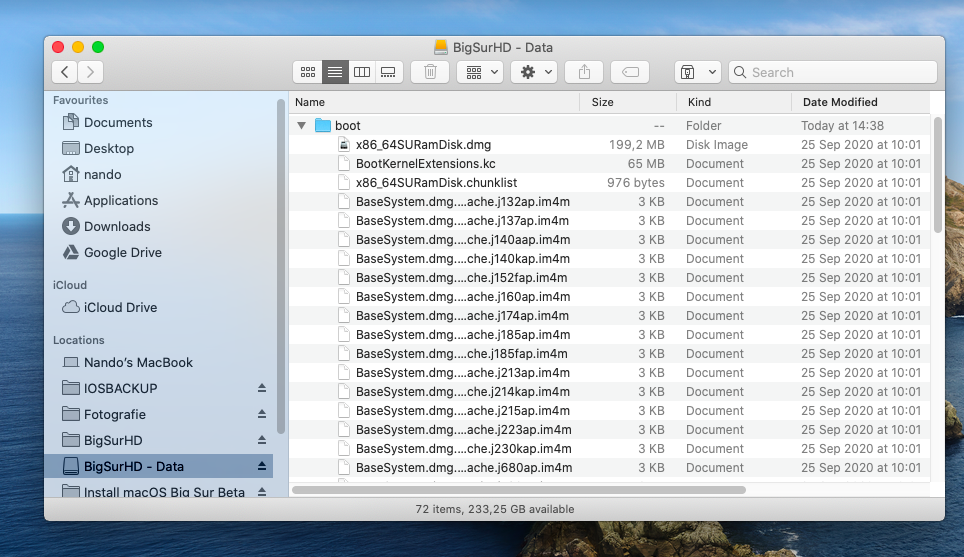

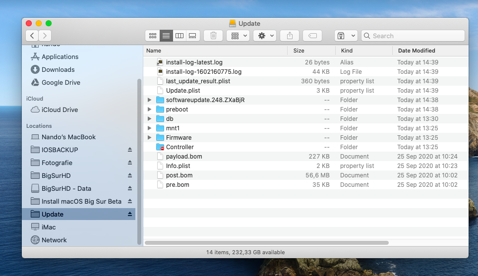

Well, the stage2 completed. Unluckily can't reboot to BigSur, even with Opencore4s1 that shows the "macOS Installer" yet. The listing of CMD+S is the same as before. But the BigSur volume is changed as in pictures.
Screenshot 2020-10-08 at 15.13.33.pngScreenshot 2020-10-08 at 15.14.27.pngScreenshot 2020-10-08 at 15.14.58.png
View attachment 964209View attachment 964210View attachment 964212
From those pictures installation completed, the boot folder x86_64SURamDisk.dmg is the stage3 installer (for this can't apply a legacy USB fix), that makes seal and system snapshot, but I often manually skip it booting directly targeting the "BigSur Data Volume", skipping stage3 also allows "sudo mount -uw /" (or mount -uw / from single user mode).
To clear the "macOS Installer" and maybe show the "BigSur Data" at apple startup manager, I can manually fix the Preboot, but first needed from Catalina terminal:

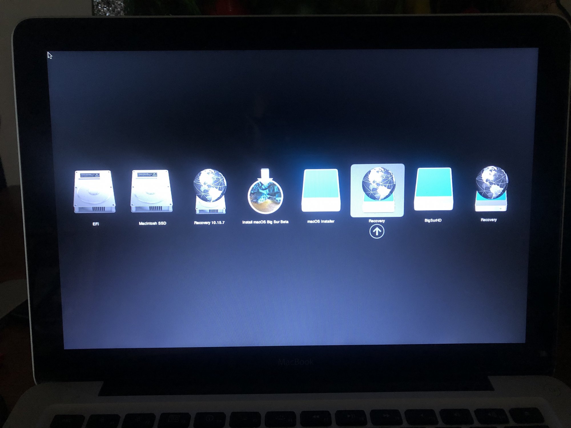

Well, at this point in time I have two recoveries... both blink the BigSurHD drive for a while and turn back to the boot screen.
Maybe it's time for a fresh new installation...

reboot with USBOpenCore and BigSur Recovery should work with CMD+S on the MacBook5,1 .
Anyway your issue is simply the Preboot, just adding boot.efi and BootKernelExtensions.kc should work.

@jackluke I just changed my HD3000 Mojave kexts using your method to 2048mb on my 2011 MBP. Does this have any affect on performance or is it just a joke?
Also, is there this kind of a hack for the CPU, or only the GPU? I kinda wanna spoof my Sandy Bridge Core i5 too...
I'm just curious. I've never "added" VRAM before
It should improve the UI and graphics allocation to some apps, there are also CPU spoofing but imply opencore advanced ACPI patching on IOPlatformPluginFamily.kext that I don't know, on this other thread they made more advanced opencore config: https://forums.macrumors.com/threads/opencore-on-the-mac-pro.2207814/post-28644718
Also some frameworks editing: /System/Library/PrivateFrameworks/AppleSystemInfo.framework/Versions/A/Resources/en.lproj/Processors.strings
