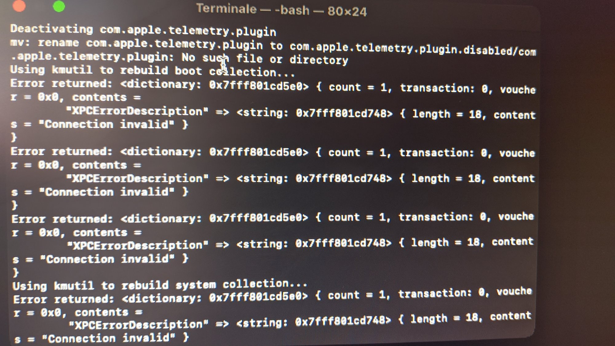

@Barry K. Nathan @jackluke Confirmed: Reinstalled BS B9 from scratch instead of unpatching and retrying, using only 0.3.3 patcher. (After installation I had to remake the createinstaller + micropatcher.sh + install-setvar.sh because it was no more accessible (forbidden symbol, also when trying booting BS B9 without OpenCore) Now Wifi works and I can boot it again from Apple Booter without OpenCore but USB mouse and keyboard do not work while USB mic and webcam yes (???) and (sudo) mount -uw / returns error 77 and 66. I really do not understand what is happening, but this report could help you both to fix something on Mac mini 2010 (Macmini4,1) On my previous post you can find the screenshots with errors on patch-kekts.
The errors seem to be normal for beta 9, just ignore them. However, if those screenshots are still representative, then you're still forgetting the --2010 option on patch-kexts.sh. (A future patcher release will add automatic Mac model detection so that the --2010 option won't be necessary.)
In my last installation I have added --2010, too. I'm available for all tests you need, I'm really curious about why I cannot use mount -uw /, while SIP and authenticated-root are correctly accepted using your 0.3.3 patcher. Maybe csr-active-config w%00%00%00 ? And why now I can boot installer and BS B9 without OpenCore? :) Error 66 on mount -uw / also using Cmd + S terminal
PS: I have also a working BS B4 on SSD if it can help to fix BS B9.
I always found making mount -uw / work to be too difficult; I made remount-sysvol.sh to be a substitute for that. However, I've neglected that script recently, so right now it doesn't work. I'll probably fix the bugs and make it work again before my next patcher release (unless Apple releases a new beta later today and an urgent fix is needed for the patcher).
There's output near the beginning of the patch-kexts.sh script that's missing from your screenshots and would make troubleshooting easier for me. Also, make sure you're specifying the --2010 option before the volume name and not after (so, for example, do /Volumes/Image\ Volume/patch-kexts.sh --2010 /Volumes/Macintosh\ HD and NOT /Volumes/Image\ Volume/patch-kexts.sh /Volumes/Macintosh\ HD --2010).
It might be easiest to wait until I add automatic Mac model detection to patch-kexts.sh, and then try again at that point. (Maybe I'll write the code later today, in which case it'll be in the next patcher release.)

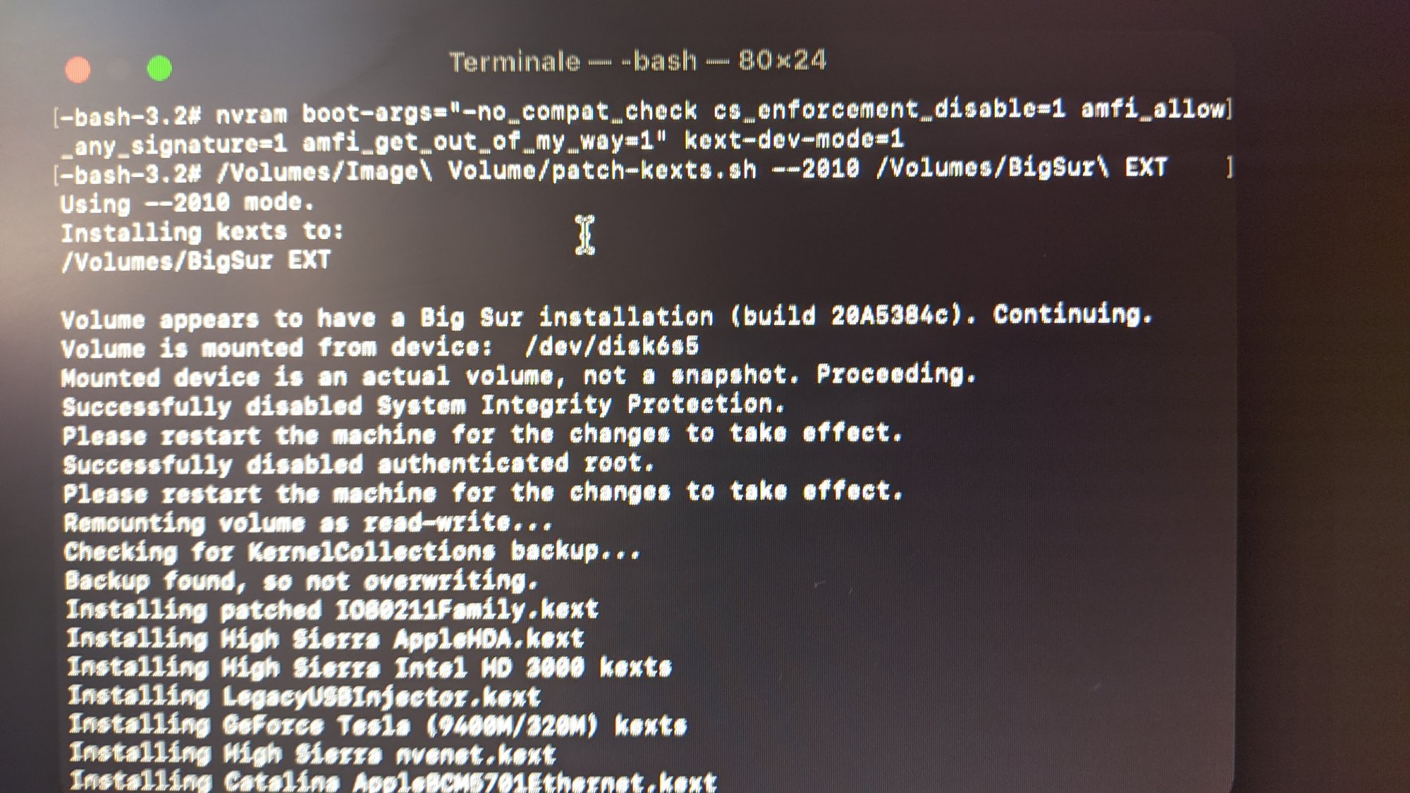

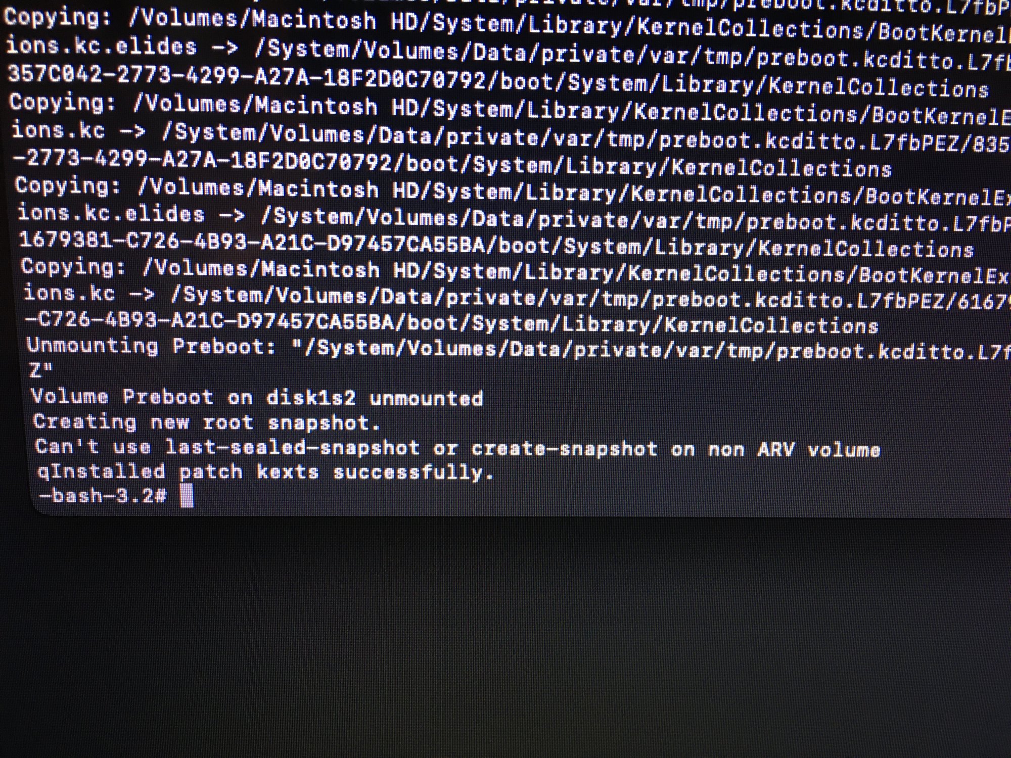

@Barry K. Nathan Reinstalled patch-kexts.sh to show you first two screenshots, using
sudo nvram boot-args="-no_compat_check cs_enforcement_disable=1 cs_debug=1 amfi_allow_any_signature=1 amfi_get_out_of_my_way=1" kext-dev-mode=1 on your BS B9 micropatcher 0.3.3 (Thanks @CuchoM !) :
AUDIO OUT NOW WORKS!

@Barry K. Nathan Reinstalled patch-kexts.sh to show you first screenshot
OK, that first screenshot looks correct this time. See if you're still having USB and audio problems. If you are, then boot back into the installer USB and try running the following:
/Volumes/Image\ Volume/zap-snapshots.sh /Volumes/BigSur\ EXT
Then reboot and see if the problems are still present.
D
Done! Snapshot removed succesfully: bluetooth, wifi, usb mic and webcam (no Siri), internal audio ALL OK, but still USB mouse and keyboard not detected (using iMac magic mouse and keyboard).

Meanwhile, I've run into a new error that I need to investigate now... Edit: I suspect I managed to cause some kind of disk corruption through a weird sequence of events. Later on I'll try recreating it and figuring out how to recover from this scenario, but I expect that other people are unlikely to run into this, so I won't worry about it right this moment.
Can't use last-sealed-snapshot or create-snapshot on non ARV volume

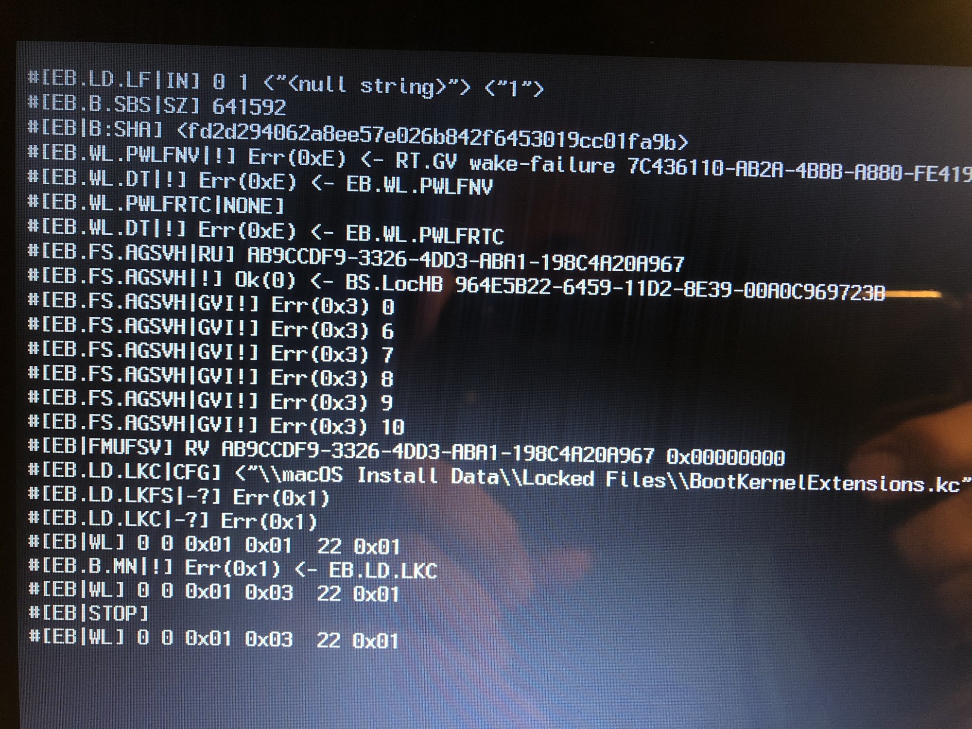

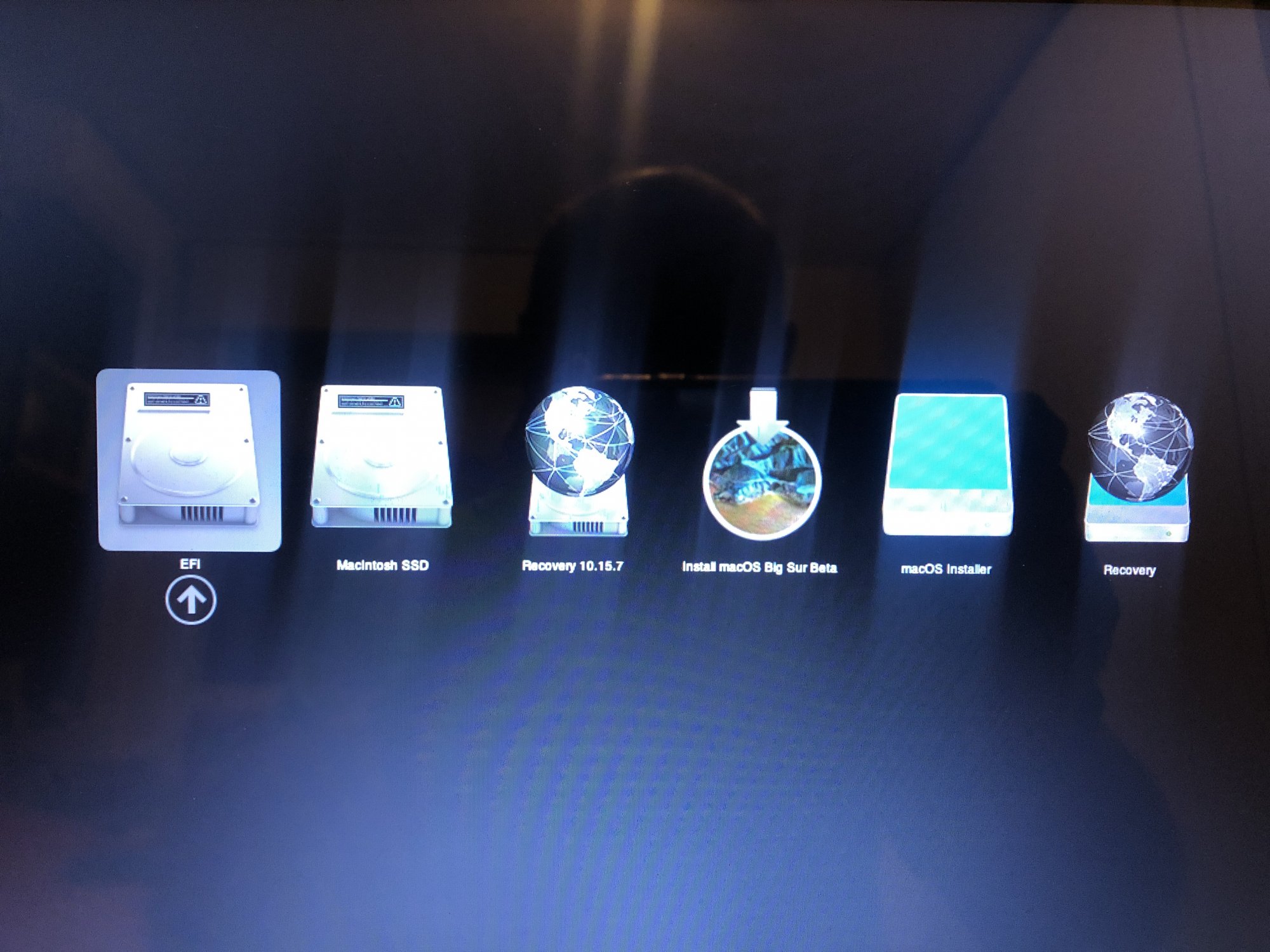

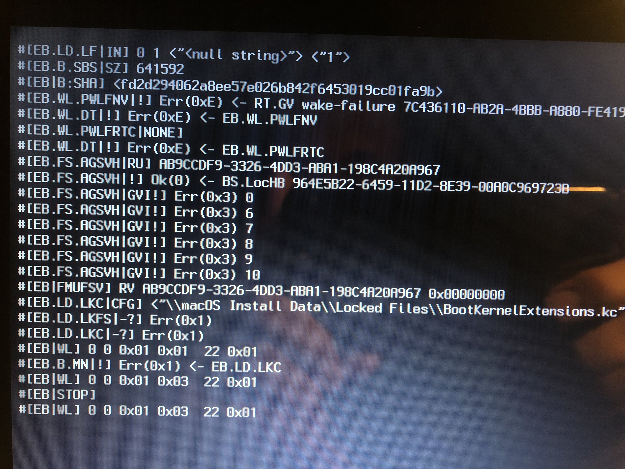

Hi jackluke, I tried your method on my MB5,1. I patched the USB stick with fix and fix2, successfully booted the USB installer and execute the terminal command. I launched the BigSur installation that completed the stage1 and the installer rebooted. I got the forbidden sign as expected. So I reboot the EFI provided by your OpenCore4s1 and got a new scenario as in pic 2. I reboot the "macOS Installer" but still I got the forbidden sign.
Any idea where I was wrong?
Thanks a lot for all your contributions.
View attachment 963937 View attachment 963938
That is a Legacy USB non-APFS Mac, so if you are installing BigSur on an internal SATA disk to continue the "macOS Installer" you should boot without USBopencore, but from a macOS Recovery or an USB Catalina Installer (patched by dosdude1), open a recovery terminal and type:
Code:
nvram boot-args="-no_compat_check"
csrutil disable
This should continue the BigSur stage2 installer targeting an internal SATA disk.
While instead if you intend to install BigSur on an external USB disk you should use USBopencore, due to non-APFS legacy USB issues , then from Catalina copy my BigSur patched BaseSystem.dmg overwrite to this path: /Volumes/BigSur Data/macOS Install Data/
and my patched prelinkedkernel rename to BootKernelExtensions.kc and copy overwrite in this path: /Volumes/BigSur Data/macOS Install Data/Locked Files/
The "Locked Files" is a locked folder, so from Catalina (or Mojave) Finder "Get Info" on the "Locked Files" folder and give to admin and everyone read and write permissions.
This should continue the stage2 installer on a non-APFS Mac targeting an external USB disk.

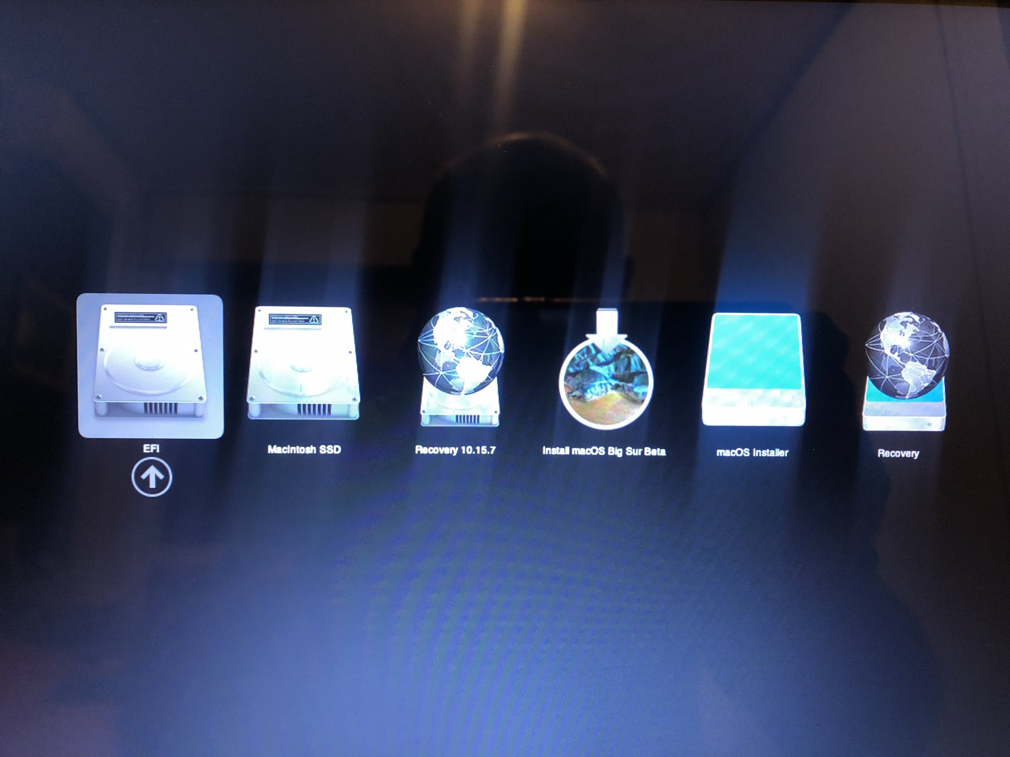

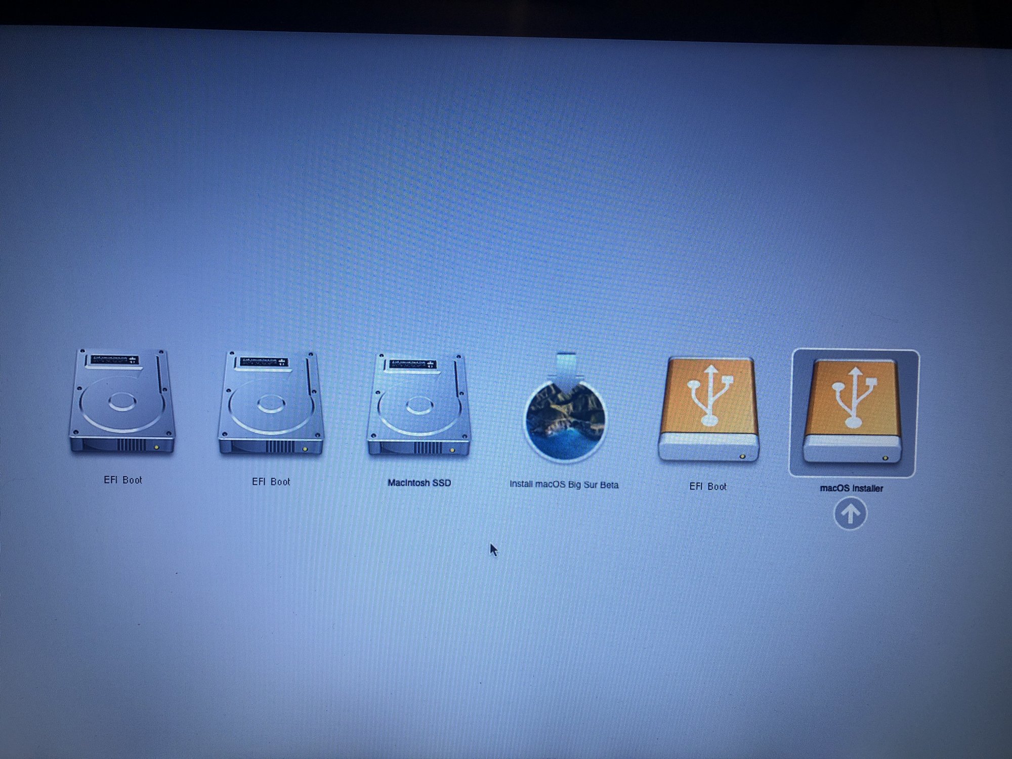

Hi jackluke, I followed your instruction to reboot to USBOpencore and then boot to "macOS Installer" with CMD+S and I got what you see in pic 1.
Thanks.
