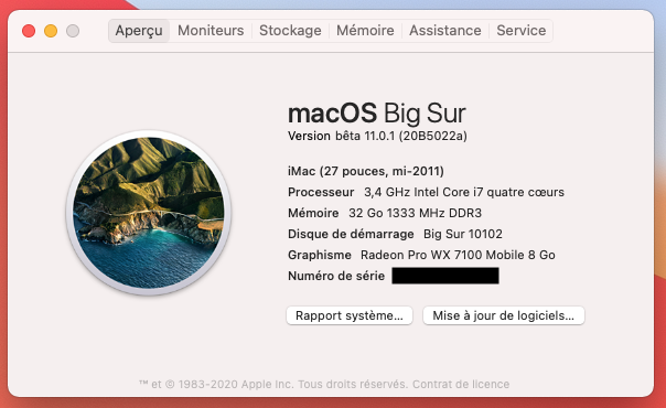

BS Beta 11.0 (20B5022a) on an iMac 11,1 using the OC DSDT patch and micro patcher 0.5.0 and some unreleased personal adjustments to auto detect and patch the iMac family....

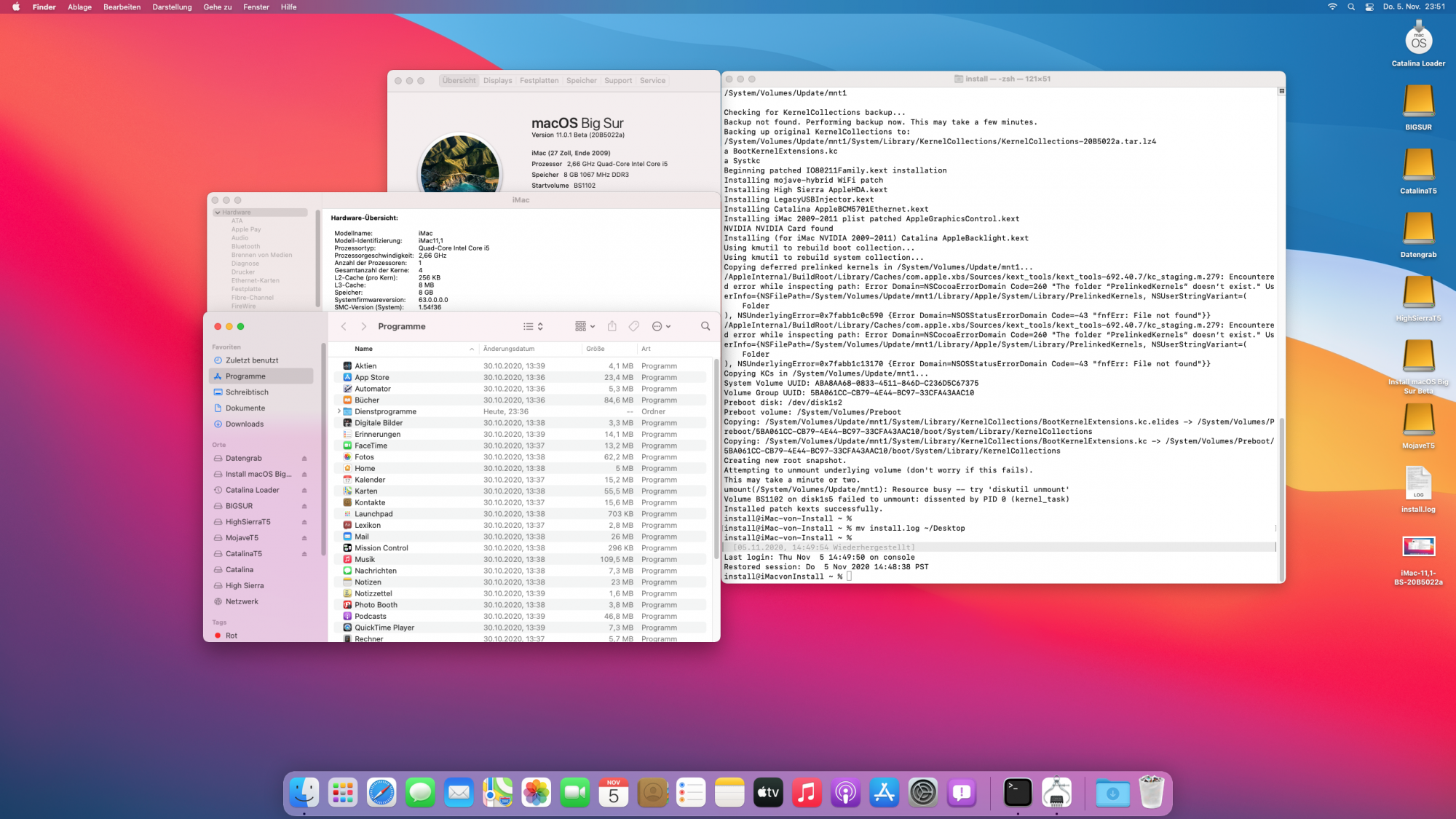

Thanks a lot @khronokernel and @Barry K. Nathan and @jackluke !
(it was the link @jackluke posted an hour ago....)
  • install.log.zip

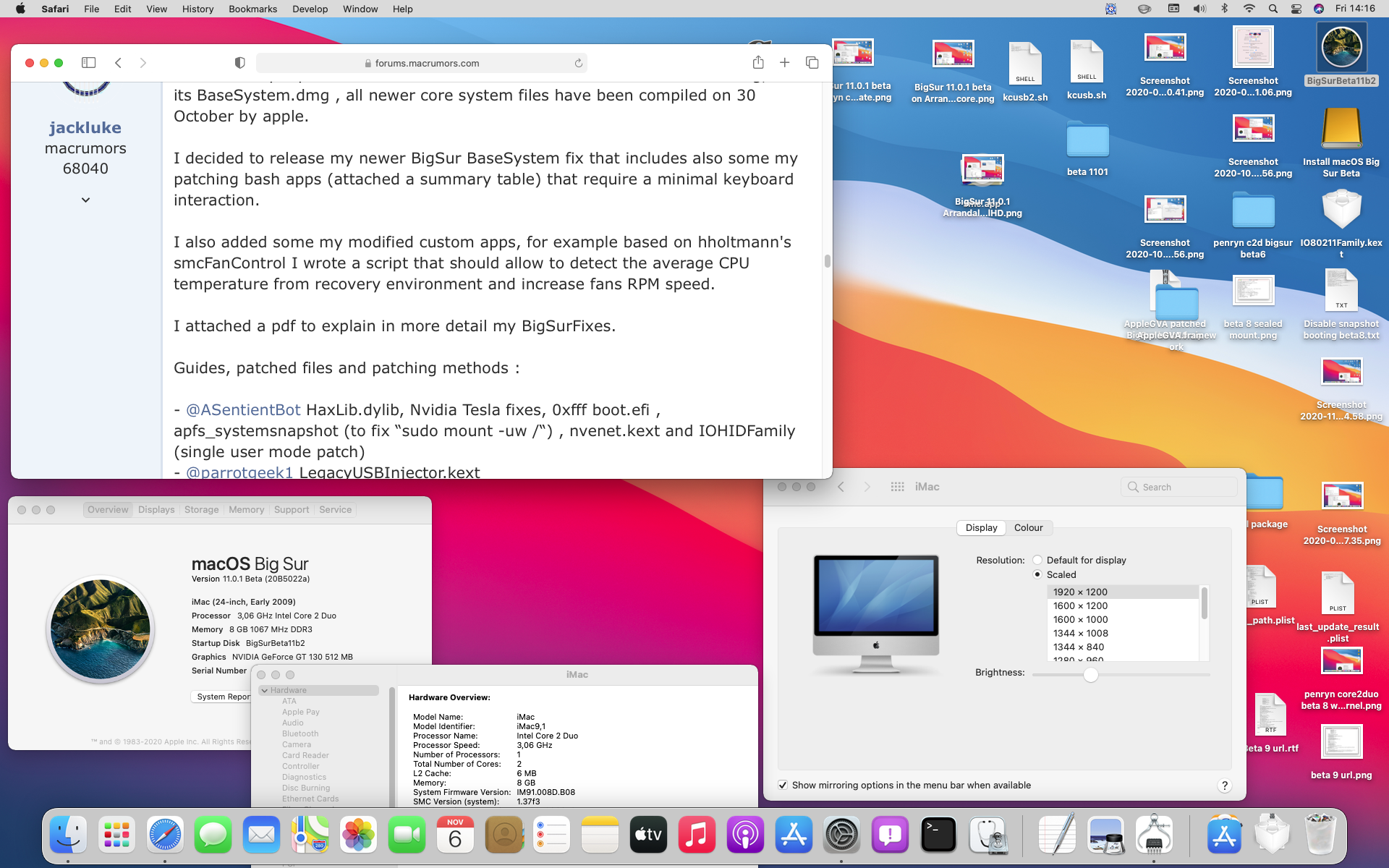

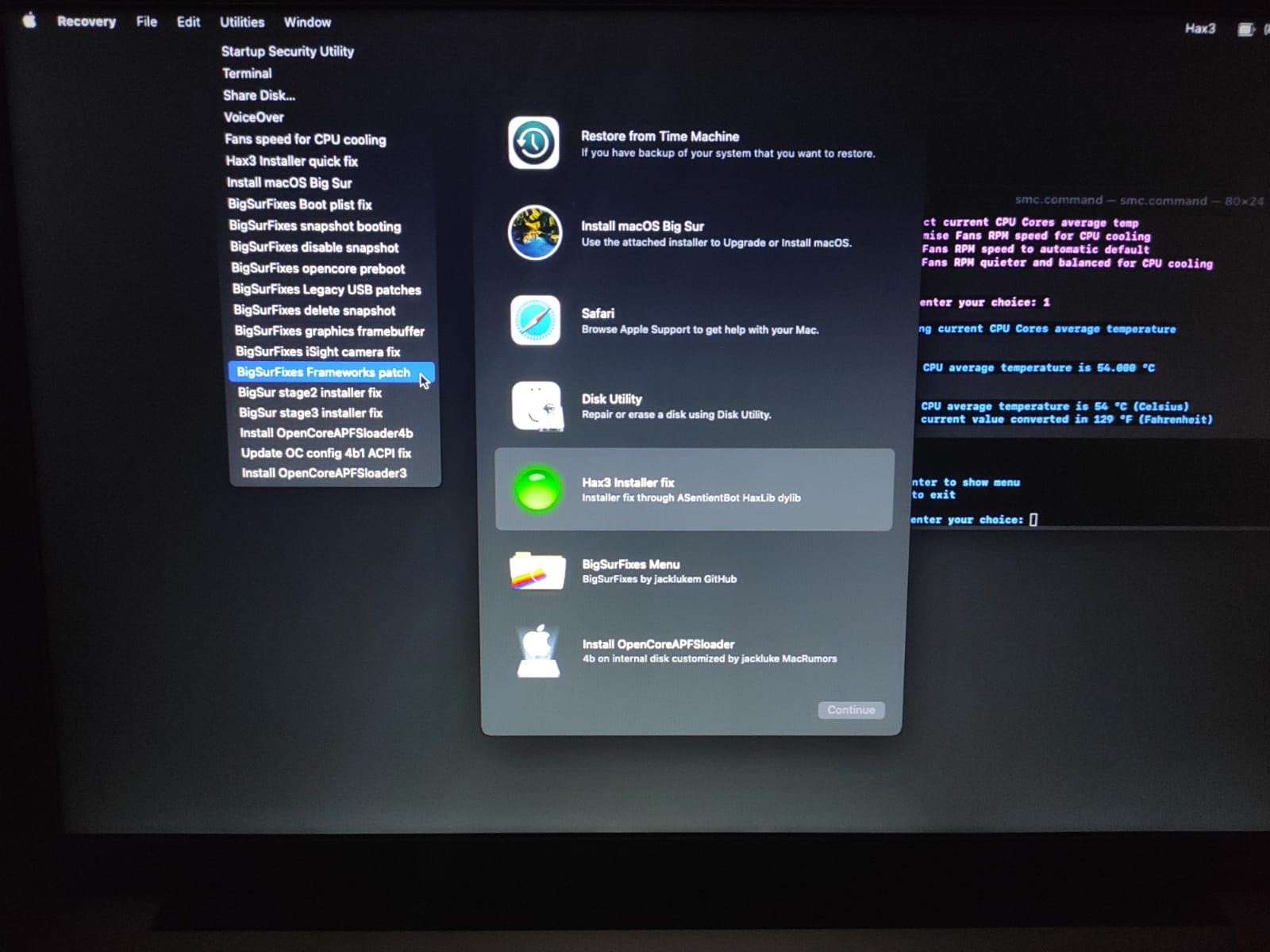

So as already reported this 11.0.1 Release Candidate has still a Beta naming, also its BaseSystem.dmg , all newer core system files have been compiled on 30 October by apple.

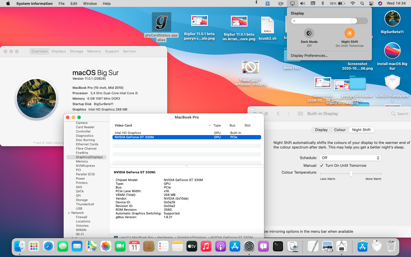

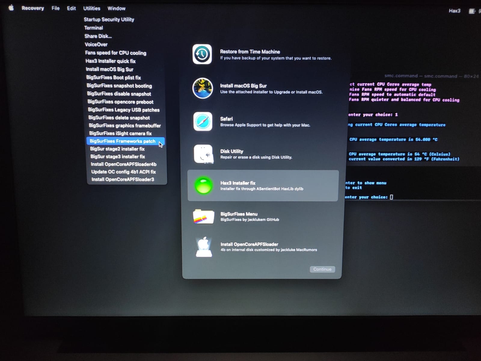

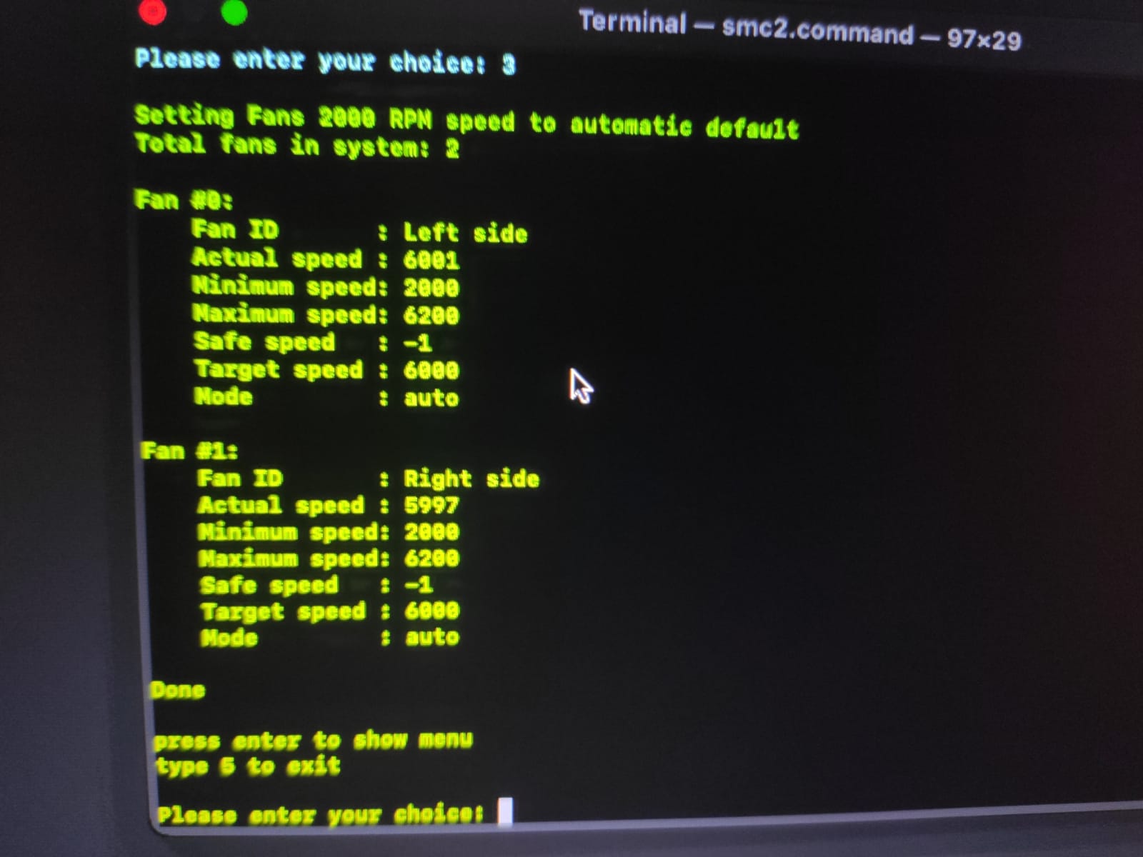

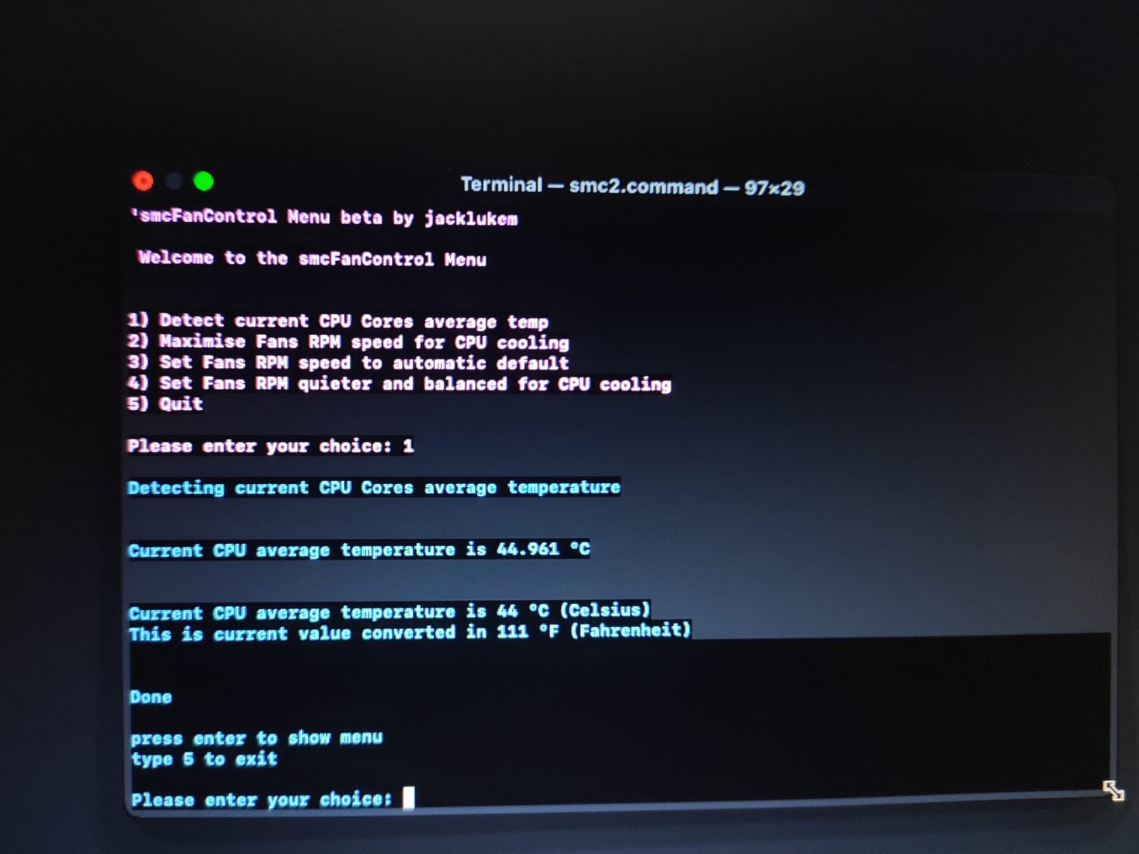

I decided to release my newer BigSur BaseSystem fix that includes also some my patching bash apps (attached a summary table) that require a minimal keyboard interaction.

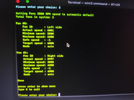

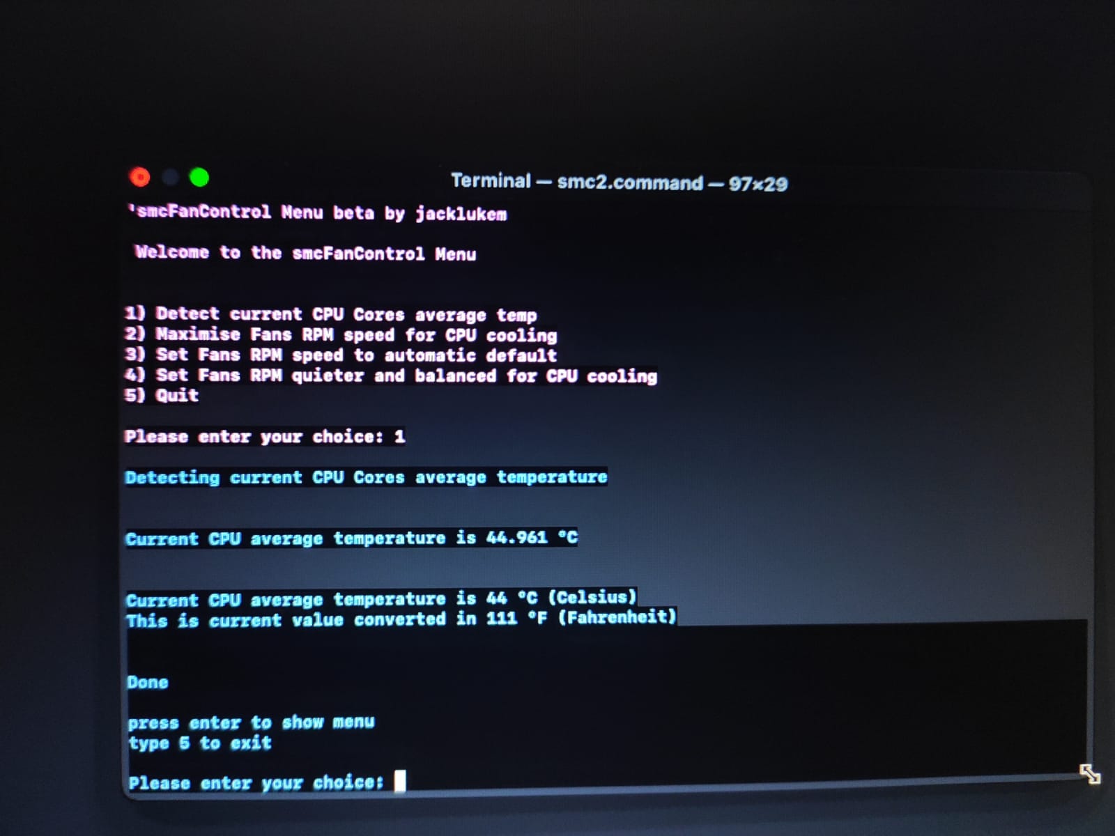

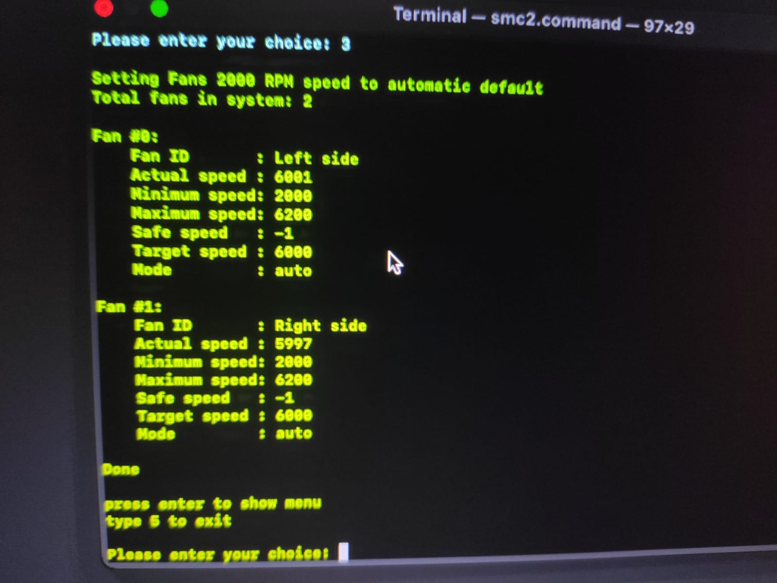

I also added some my modified custom apps, for example based on hholtmann's smcFanControl I wrote a script that should allow to detect the average CPU temperature from recovery environment and increase fans RPM speed.

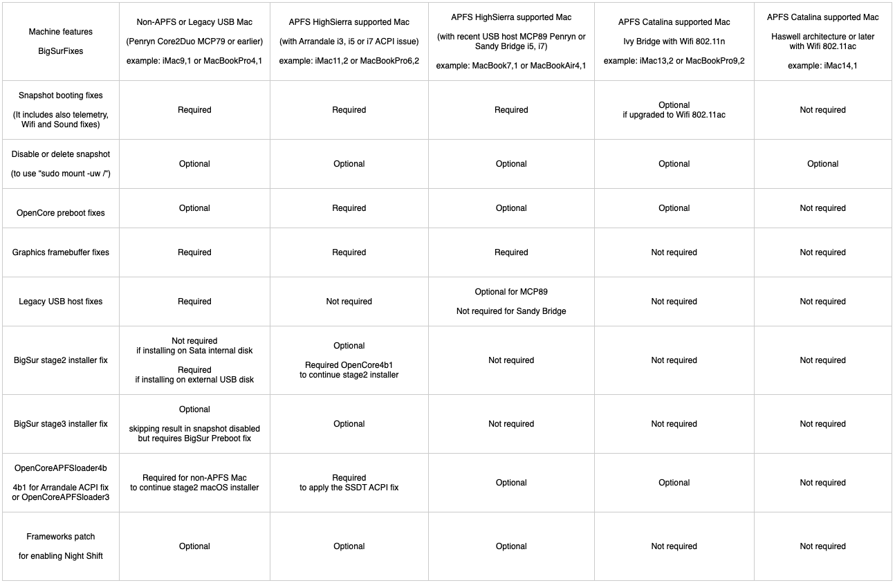

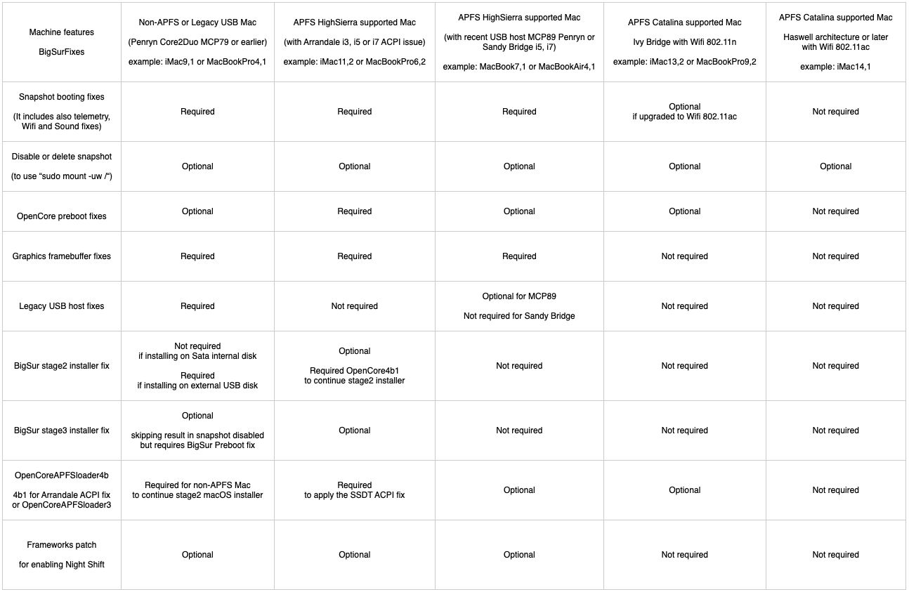

I attached a pdf to explain in more detail my BigSurFixes.
Guides, patched files and patching methods :
- @ASentientBot HaxLib.dylib, Nvidia Tesla fixes, 0xfff boot.efi , apfs_systemsnapshot (to fix “sudo mount -uw /“) , nvenet.kext and IOHIDFamily (single user mode patch)

  • BigSur BaseSystem legacy usb fix.zip
  • BigSurBaseSystemfix.pdf

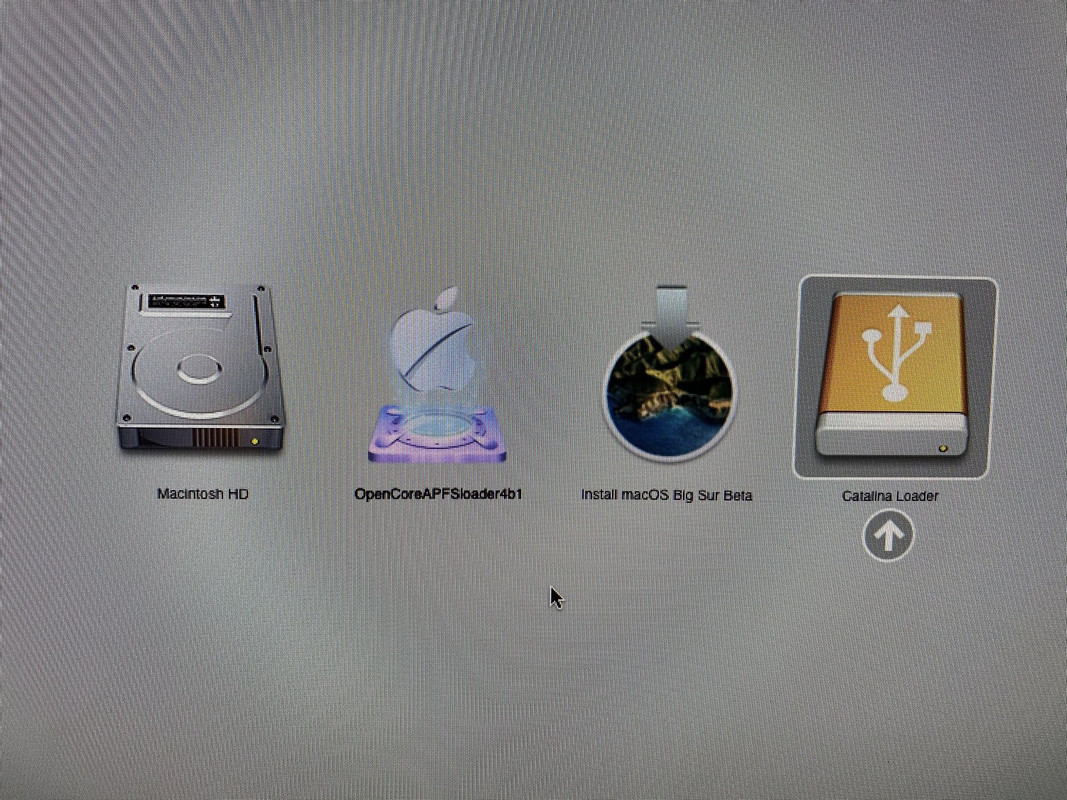

So close! But still not yet :(
I followed your instructions, exactly.
1) Create new BS bootable installer, to USB
2) Downloaded and applied BigSurBaseSystem fix
3) Unplugged, plugged USB back in
4) Applied BigSurBaseSystem fix2
5) Reboot into Catalina Loader, pick Macintosh HD from OC bootpicker
6) Launch Install macOS Big Sur application directly from USB
7) Installer begins, but errors out at same screen, i.e. "Your Mac needs a firmware update.... Please select a Mac OS Extended (Journaled) volume instead"
I'm thinking I need to find/use OpenCore4b1, if someone could kindly point me in the right direction. I'm using iMac 11,1 Late 2009 27" i7-860 with patched K2100M. Runs perfectly fine with OC 0.6.0 on High Sierra 10.13.6.
EDIT: I found your OpenCore4b1 on post #5504, and now my error when installing is "The update cannot be installed on this computer"
EDIT#2 (sorry) - I think it's working :) After Reboot/Option, I pick my Catalina Loader, then from OC boot picker, I choose Install MacOS Big Sur
EDIT #3 nope - same error "The update cannot be installed..." even when booting from OC Big Sur installer. I even tried installing Big Sur to an external SSD (via USB), formatted as APFS, GUID Partition Map.
Even booting from OpenCoreAPFSloader4b1, then into Install macOS Big Sur Beta USB via the OC boot picker, I cannot get it to work.

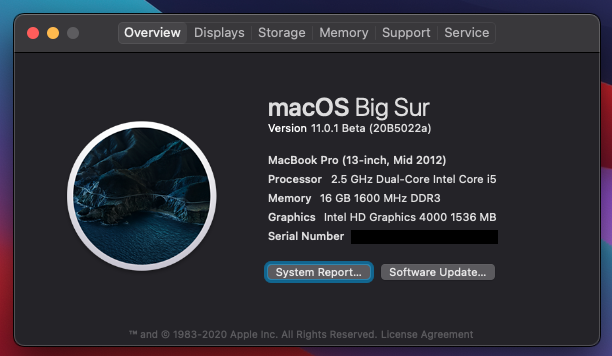

Updated my late 2013 iMac from 11.0.1 B1 to this RC using big-sur-micropatcher 0.5.0. One thing noticed since the restart, there is *considerable* disk activity going which in some cases is making the system barely usable. So, not sure what is going on under the hood, but will see if it settles down over the next period

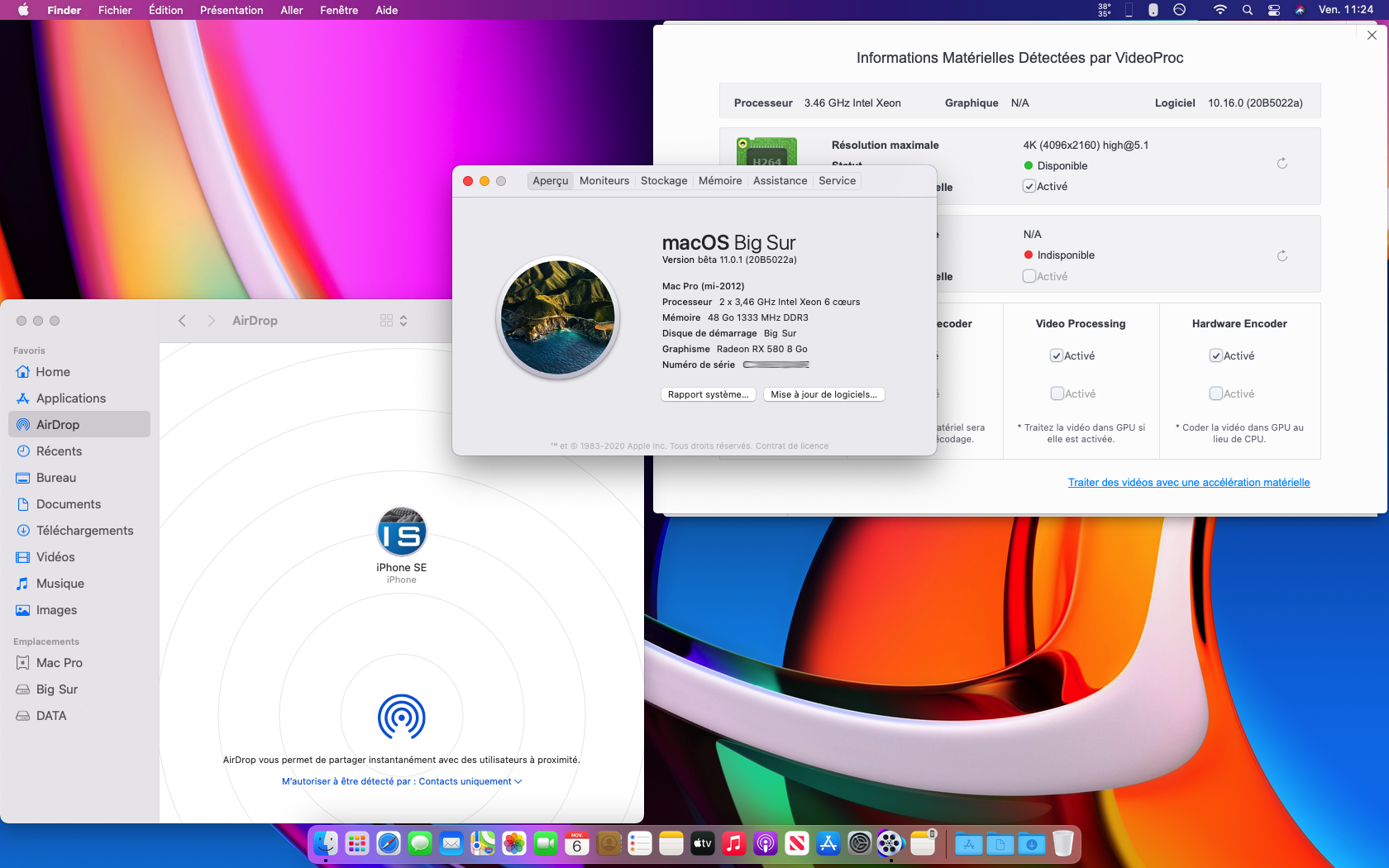

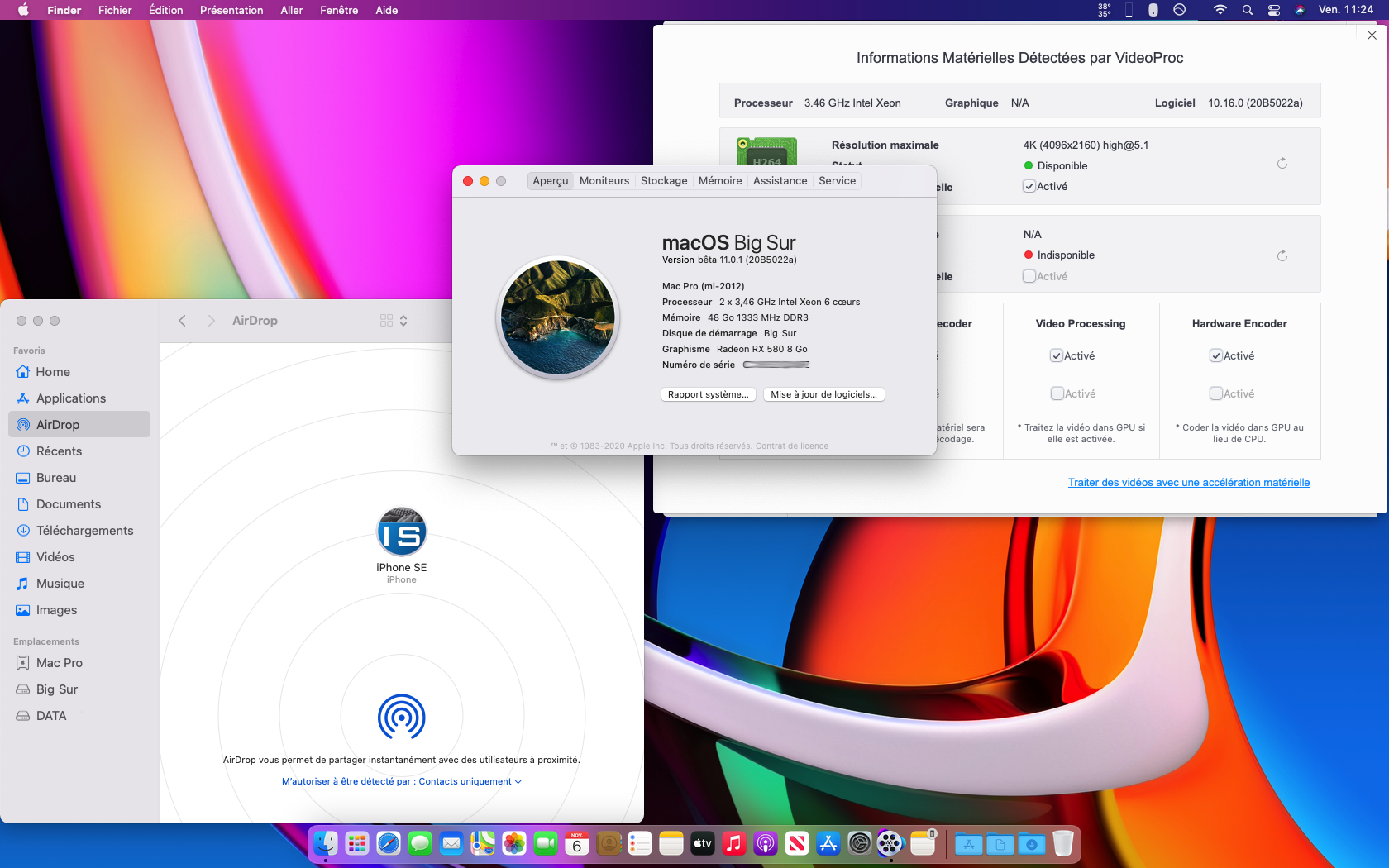

Hi all,
macOS Big Sur 11.0.1 20B5022a successfully installed on cMP5,1 with micropatcher 0.5.0 (on top of 20B5012d)
Everything seems to work, Airdrop, Handoff and H264 acceleration
this release has regressed on an important point: the welcome screen, the default wallpaper is back, even if you change it. I don't know if there were other points that regressed, but that was the first thing I noticed when installing this RC.
