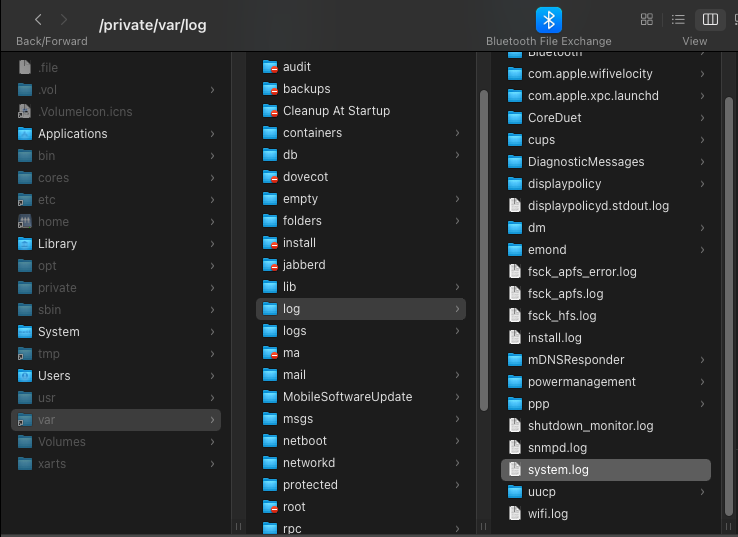

I booted in Verbose mode but when it got near where it would crash and reboot- but it went by too fast to read.
Do you know any way to capture verbose mode to a log file?

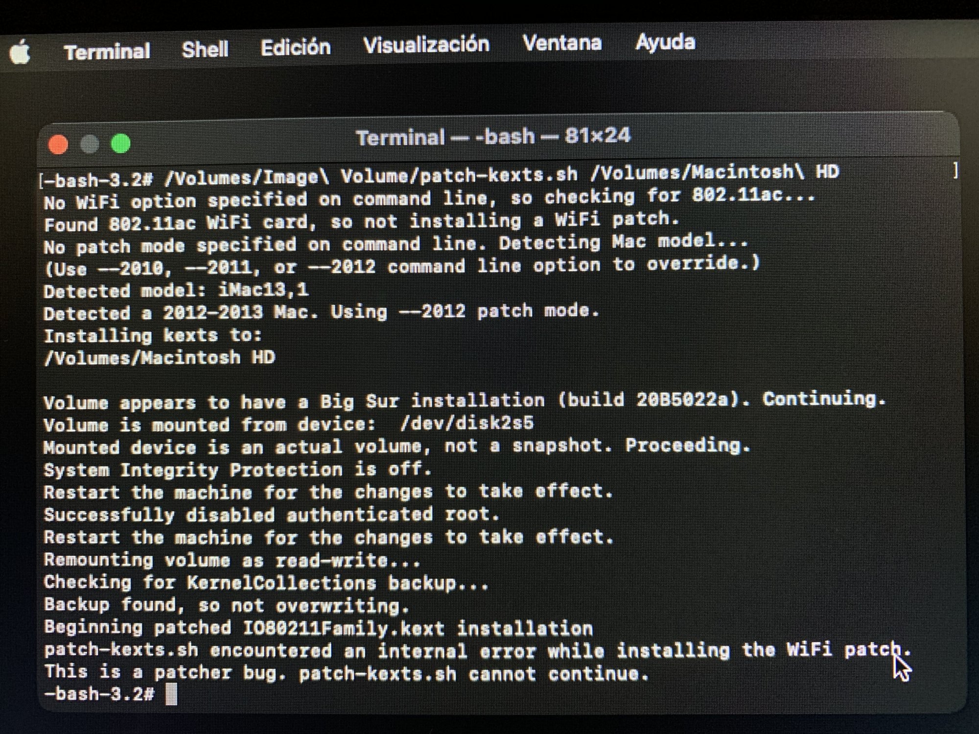

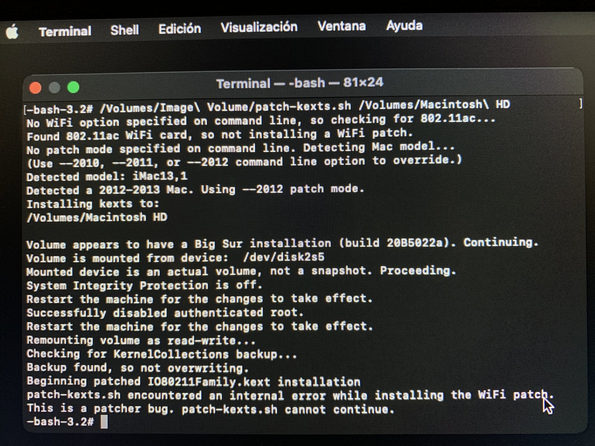

someone help me? I have successfully installed the Release Candidate, but when I try to patch for Wi-Fi I get this error. What am I doing wrong? in previous betas this command has worked well for me. It's a late 2012 iMac and micropatcher version 0.5.0.
It happens to me. You have a USB wifi device plug in USB. You can read that the patch detect it in the begging of the text
I unplugged the usb wifi and boot with usb system and run the kext patch

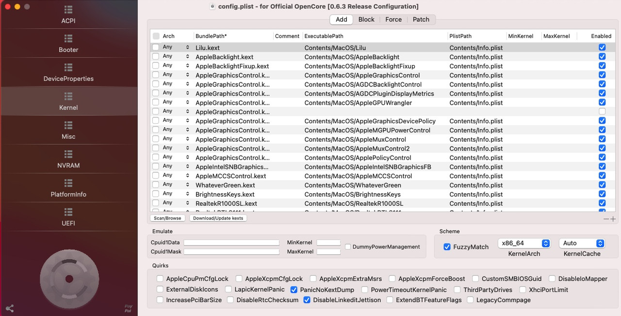

I've got Big Sur installed on my iMac 11,1 (Late 2009 27" i7-860), but no more brightness control with my K2100M.
I have tried to rebuild a new OC per your instructions above. Keeping in mind that I was never able to successfully use OC 0.6.2, always relying on 0.6.0.
Would you kindly review my screenshots below and provide guidance? I see your reference to using --useOC option, but after diligent searching, I don't see any instructions on where to designate this --useOC option.
