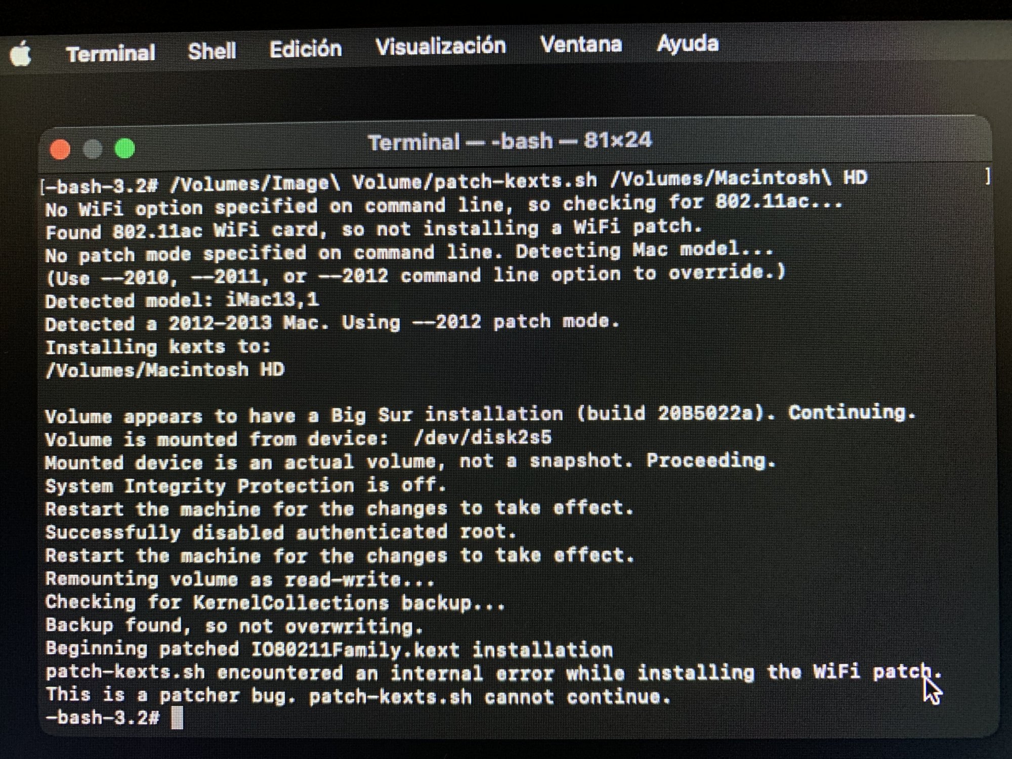

someone help me? I have successfully installed the Release Candidate, but when I try to patch for Wi-Fi I get this error. What am I doing wrong? in previous betas this command has worked well for me. It's a late 2012 iMac and micropatcher version 0.5.0.
Fixed, I have unplugged a USB Wifi AC adapter and it has been installed. it had not happened to me in previous betas

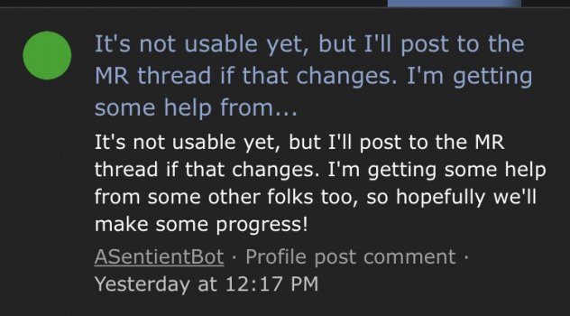

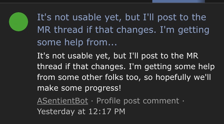

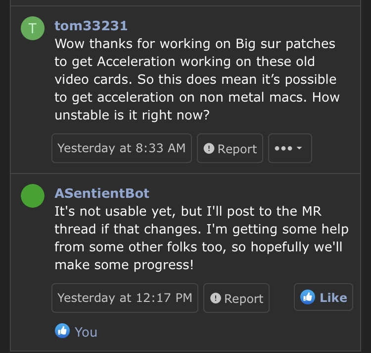

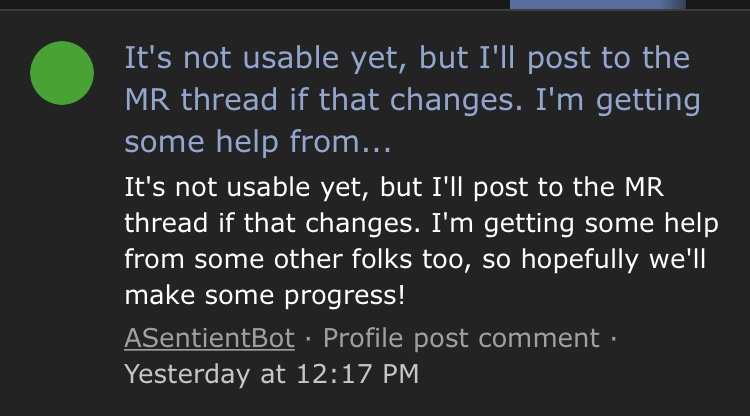

Looks like hardware acceleration maybe possible on Mac OS Big Sur on non metal Mac hardware example MacBook Pro 7,1. 😁
