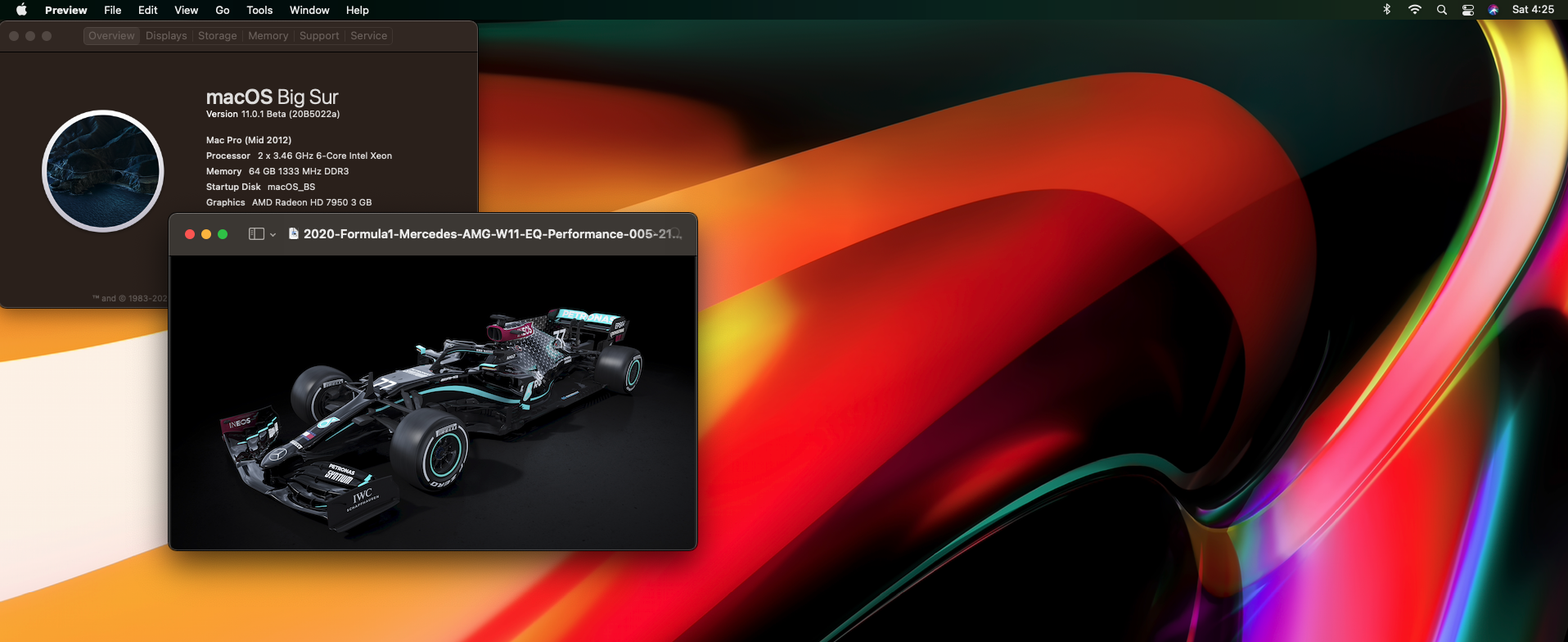

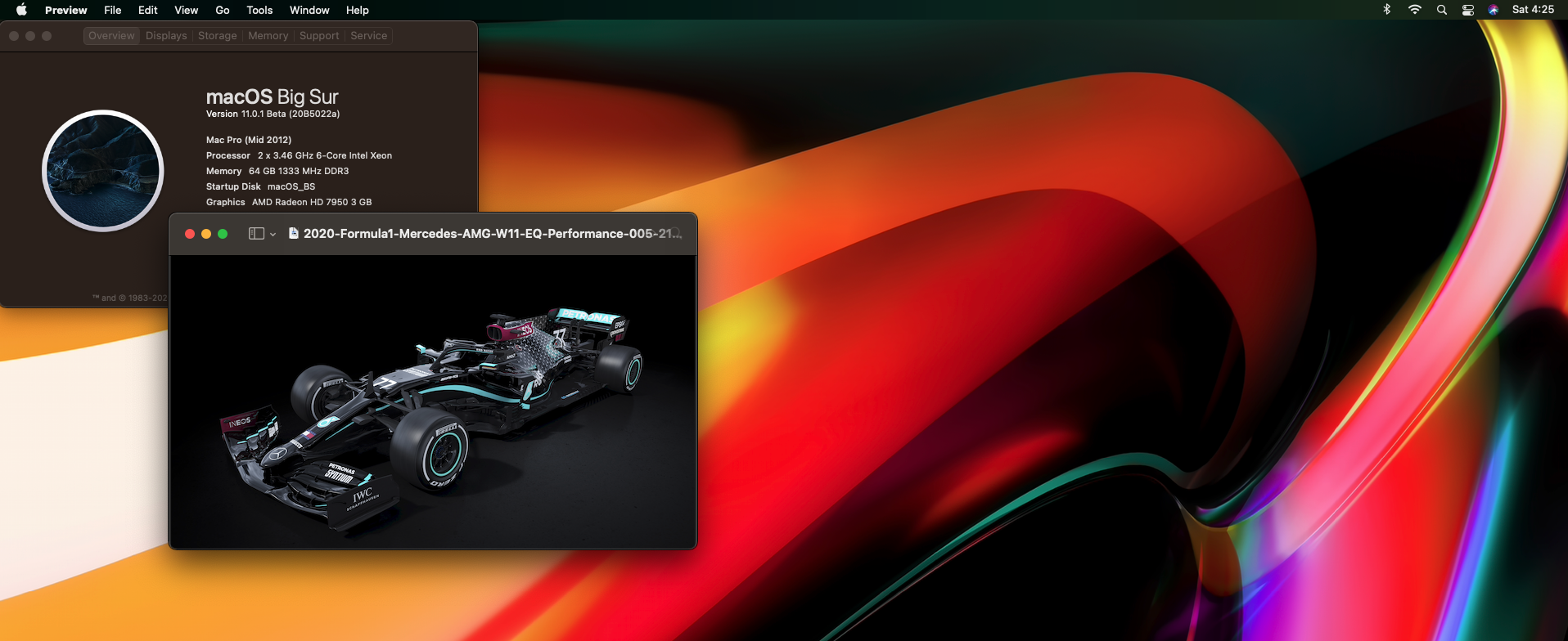

You may don't have cMP mid 2012 with all hardwares supported such as GPU, BT 4.2.
I never have had any issue with install Big Sur from day one with Jackluke or Barry's micropatchers.

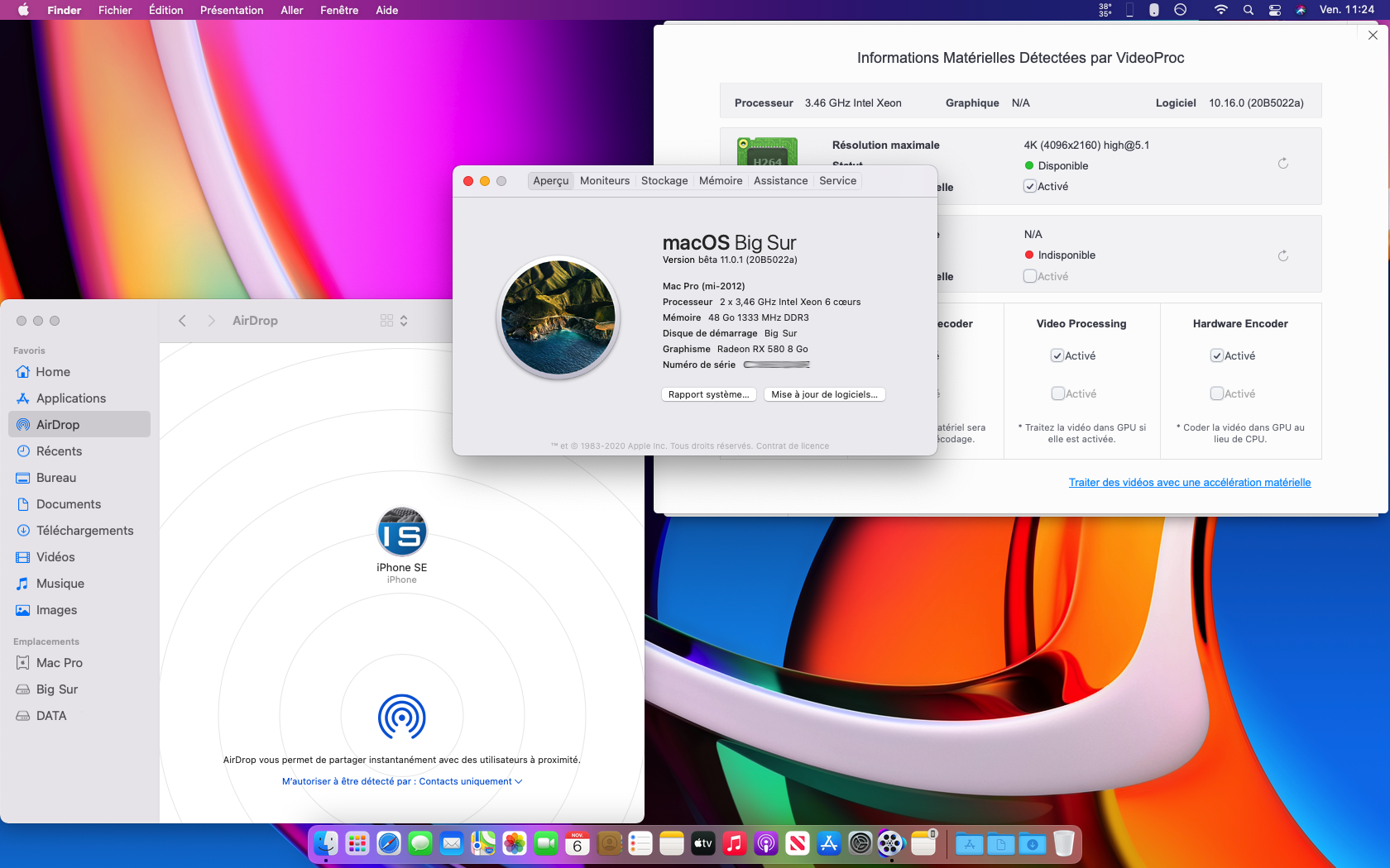

Just wanted to post about my iMac11,2. Got everything up and running with a flashed K1100M, using barryk's micropatcher and khronokernel's OpenCore fix. Only things that don't work are brightness and sleep.. this is my first run with upgrading and flashing a GPU for one of these computers--so I might be totally oblivious on a fix for brightness/sleep. Regardless, I'm glad to have Big Sur on this machine. Big thanks to the devs for making this possible.

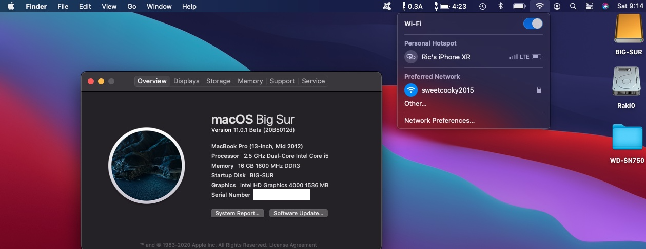

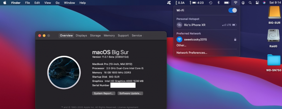

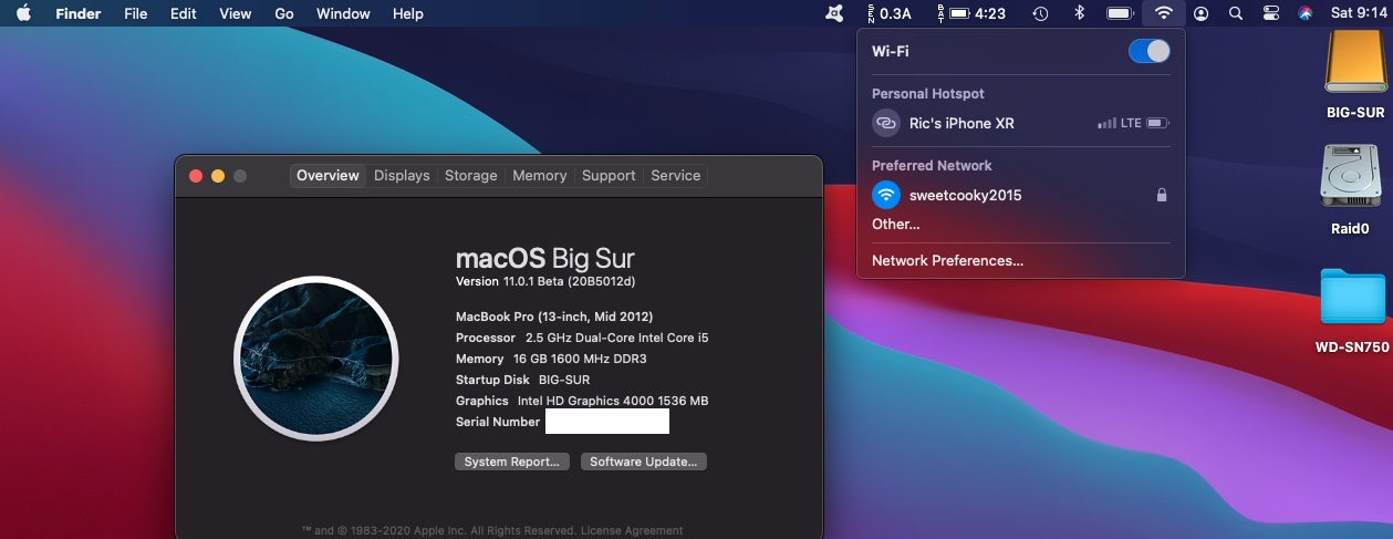

I've followed this guide and it worked flawlessly for Mid 2012 Macbook Pro 13, Thanks.
