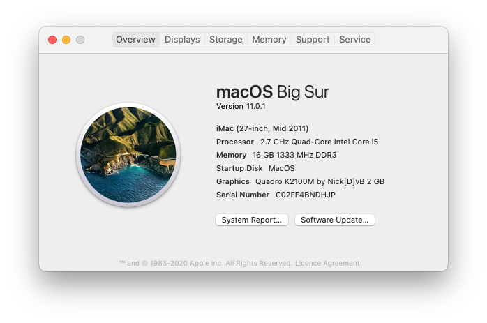

Micropatcher working fine for me so far.

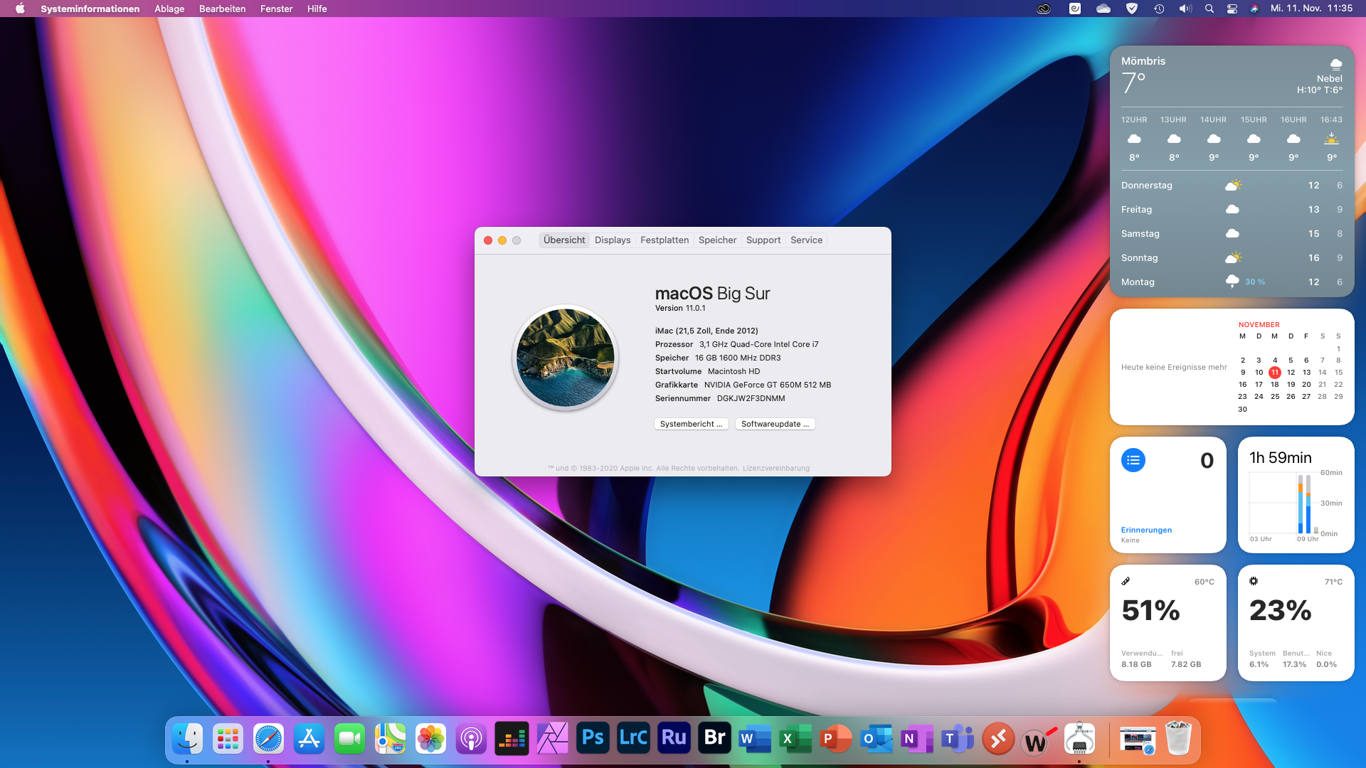

It got stuck in a reboot cycle for a while (screen totally black, rebooting every few minutes (could only tell by the sound)), but fully powering off and back on fixed this (actually I booted to the USB stick in between powering it off and on, but didn't do anything there).
Installed the kexts, wifi's working. Can keep and resume fine too, only thing that's not working currently is brightness control. Can't remember what I had to install in Catalina to get that working. My GPU temp sensor and Macs Fan Control are all working though, so it's fine.
I accidentally did an upgrade rather that fresh installation though (I thought the installer would aks me which I wanted, it didn't), which the Micropatcher notes say is unstable coming coming from a dosdude patched Catalina, so we'll see. I might need to re-install at some point.
Anyway, long story short, and it's early days, but Micropatcher gets an initial thumbs up from me.

To get brightness control with this K2100M GPU you need to use the OpenCore / Catalina Loader mentioned in the post in my signature. You will not get it back just by patching the OS. It is (and was) the same as with all other prior MacOS versions.
So the missing brightness control is not a missing piece of the micro patcher, is is a missing piece in your basic installation. These things are (right now) not related as long as we have a patcher without an OpenCore setup included.

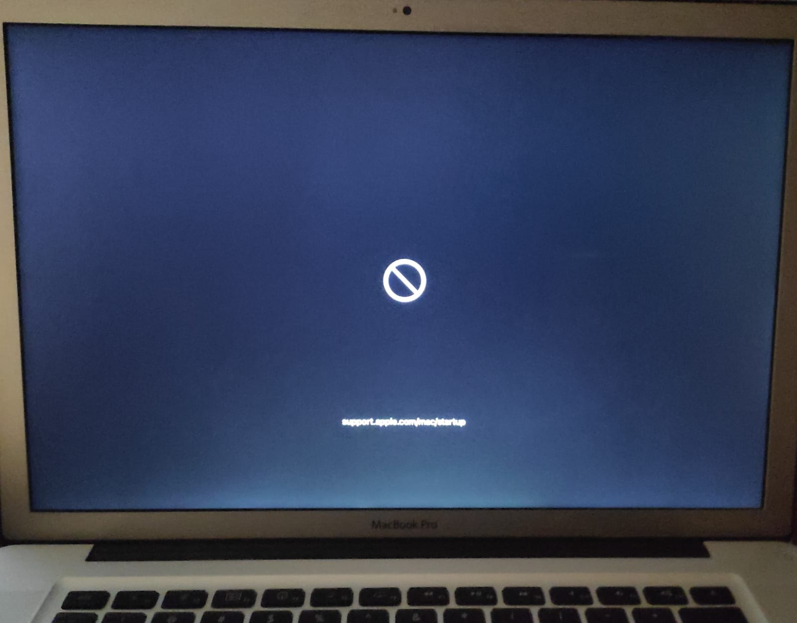

About BigSur "non Beta", my BaseSystem fix still works for legacy USB patches, either micropatcher or BaseSystem fix will work to "Install or Upgrade Big Sur" (through ASentientBot Hax3 fix), because apple automatically populates the Recovery menu with the "Install app" (and its SharedSupport.dmg) available on the root Installer ramdisk.

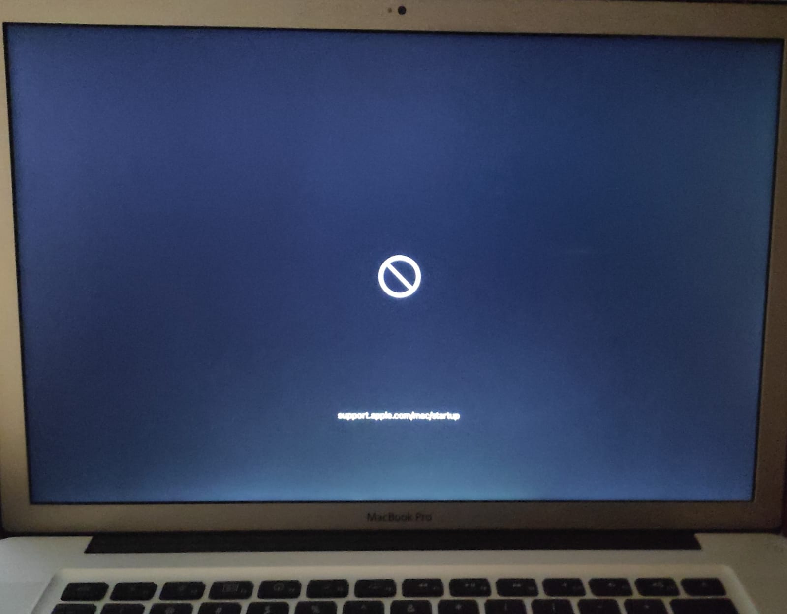

Then I add that those who encountered the new prohibitory symbol with a new text support.apple.com/mac/startup, know this is unrelated to any unwanted EFI firmware update, instead it's simply an updated apple driver apfs.efi or boot.efi (currently size 724 KB, previous beta size 642 KB).
I tested this easily, installed BigSur 11.0.1 RC2 on external USB drive, then plugged this external drive to another Mac, used the stock 724 KB boot.efi, cleared boot-args, boot.plist, nvram and csrutil to provoke the "prohibitory symbol" and I got exactly that text message support.apple.com/mac/startup from a machine where BigSur hasn't neither installed directly, so most probably is only the updated boot.efi that contains also some pictures and icons, for example the dark boot screen, apple logo, loading bar and others graphics.

Nvidia Kepler cards are metal compatible and get all the acceleration needed to run smoothly with Big Sur. It has been discussed more than one time here and it has been even published on the GPU thread and it is part of the first post there. Where did you sleep the last weeks :) BTW, election is over, too.
Ah, OK, thanks. I thought maybe it wasn't that because I thought that Catalina Loader was also required for "Put Display to Sleep", which is working without it. I must have misremembered.
I've still got Catalina Loader on a USB stick, though if brightness control is all that's missing I might not bother. The default brightness looks fine.

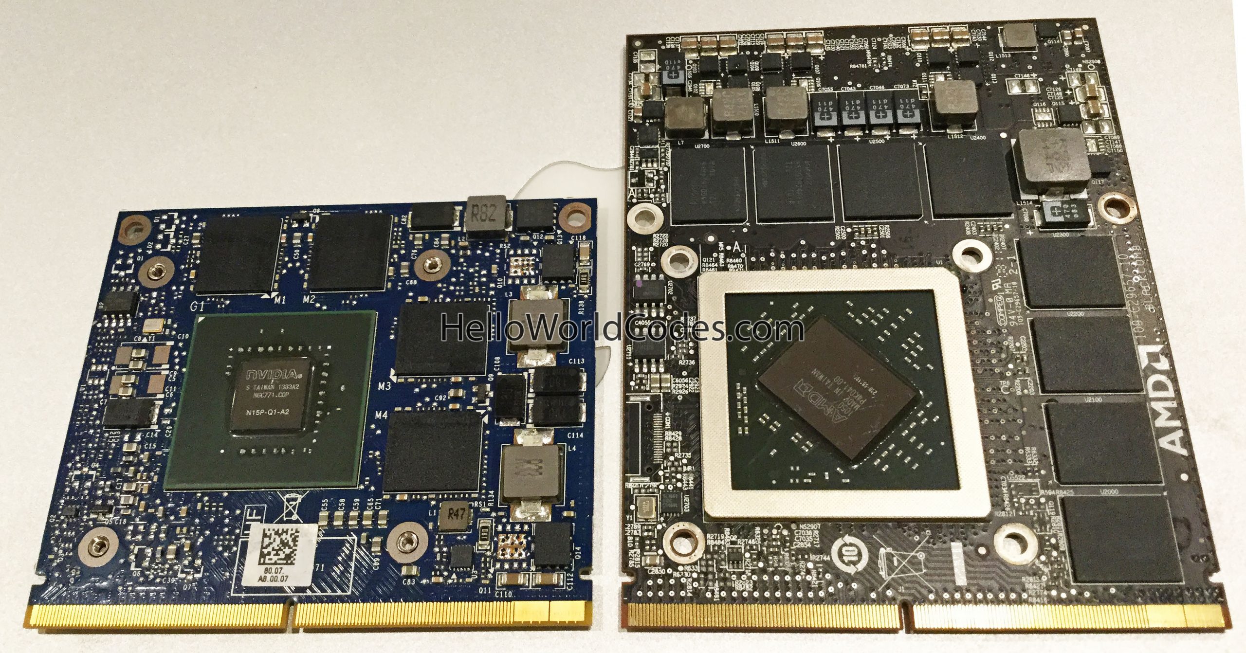

I asked because your iMac has an Quadra K2100 GPU upgrade.
Some of the older unsupported Macs have older generation of nvidia and AMD cards.
Many seem to work under Catalina, including the Radeon HD2600 Pro in my iMac 7,1 (mid 2007) and nvidia GeForce 320M in MacMini 4,1 (mid 2010), which I owned and both running Catalina.
The user interface is responsive, though of course a bit slow as compared to recent GPUs, and videos played smoothly in QuickTIme with very few skipped frames.
But the ATI HD5000 & 6000 series are not Metal compatible. My iMac 11,3 (mid 2010) with HD5750 can run Catalina with DosDude's Patcher, but the Finder interface is sluggish. Videos still play smoothly in QuickTime with probably CPU decoding support without obvious skipped frame. This is running WITHOUT the legacy graphics patch as I am also preparing to change it to metal compatible GPU with unluckily multiple hurdles.

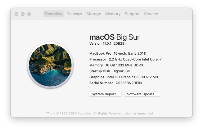

Done! Installed 20B28 on MBP 8,2 using micropatcher 0.4.4 with Jackluke's corebrightness added.
Hi @air.man! Very nice! Intel HD3000 remains without acceleration by all material shared here, if I understood correctly. How usable is your machine, for daily work, with this macOS? I have a MBP 8,3, with same GPU. I'm thinking to replace my MacBook by a cMP 5,1 with a RX580 for daily drive, once my work is most at home now, if Catalina was the last version for my MPB with a GPU accelerated. Thanks!

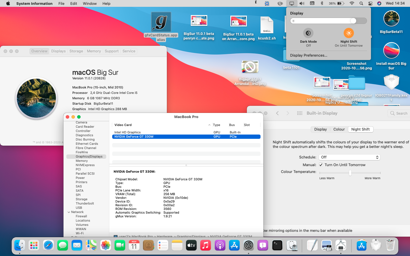

Added on BaseSystem "BigSurFixes Frameworks patch" for enabling Night Shift on unsupported BigSur non Metal, but graphics framebuffer is required .
