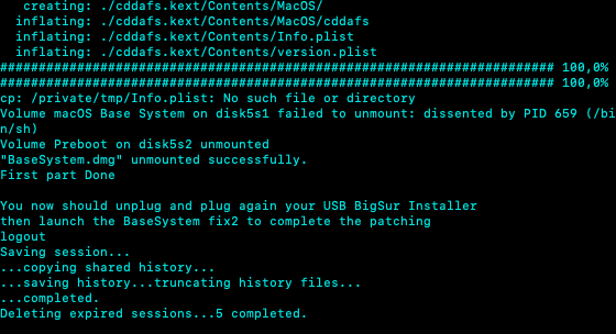

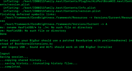

To those who encountered issues in making my recent BigSur BaseSystem fix with unbootable Installer or "disk full error" or patching errors, you should verify these:
- an internet connection is required because resources are downloaded from my Github, if Github is in maintenance then the script won't work properly
- BaseSystem fix can take up to 10 minutes and fix2 up to 5 minutes to complete
- after fix1 unplug and plug again the USB drive or unmount from DiskUtility the "Install macOS Big Sur" disk , then mount again that disk and continue with fix2
- to make the createinstallmedia installer use at least a 20 GB HFS+ disk partition (this is faster than any USB drive) or use a 32 GB USB drive (in my test also a 16 GB worked)
- check that the output of Basesystem fix and fix2 is as attached pictures (of course Preboot is different diskXs2)
- to check if BaseSystem is properly made you should have on the USB root these files: (some hidden folders), "Install macOS Big Sur.app", Hax3.sh , HaxLib.dylib and a kext folder (don't rename the files inside that folder)
- from terminal type ls -l /Volumes/Install*/BaseSystem/ , you should have a BaseSystembackup.dmg (about 650 MB) and BaseSystem.dmg (that is the patched one, it's size is around 630 MB)
- if you use opencore to boot maybe use this version that includes "Restart and Power off fix" to keep "-no_compat_check" and SIP disabled: USBOpenCoreAPFSloader4b.zip

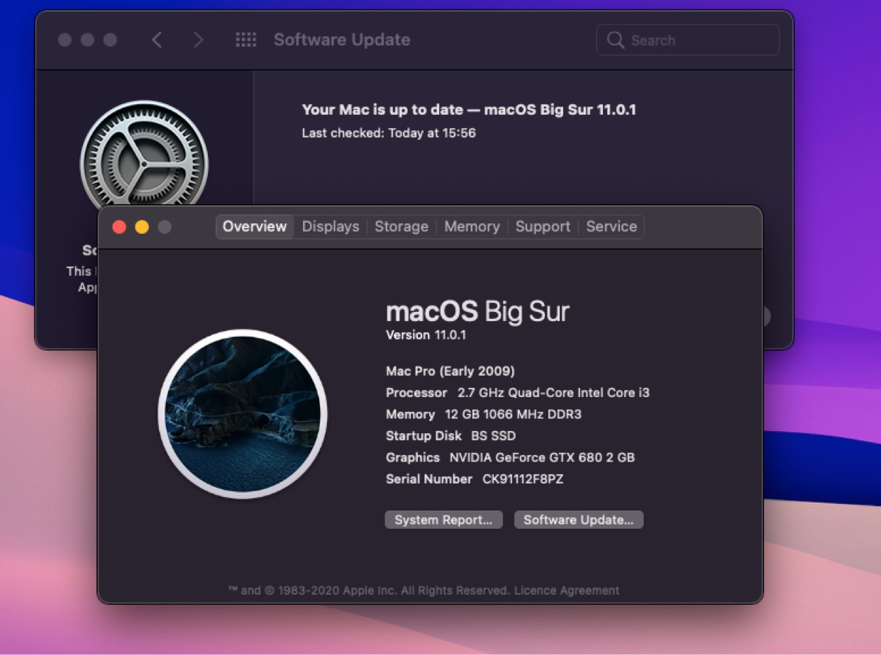

Big Sur on a Macpro 4,1/5,1 with a stock opencore 0.6.3 config 100% vanilla
