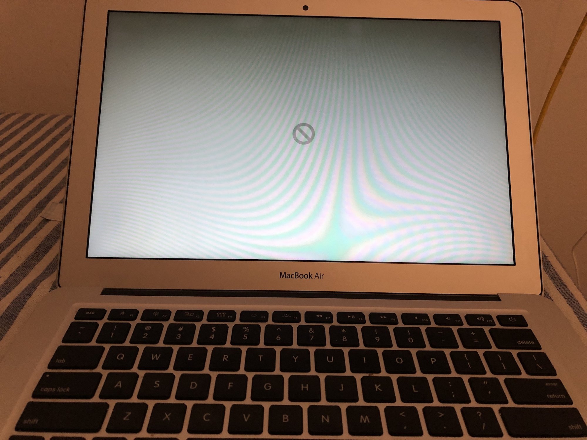

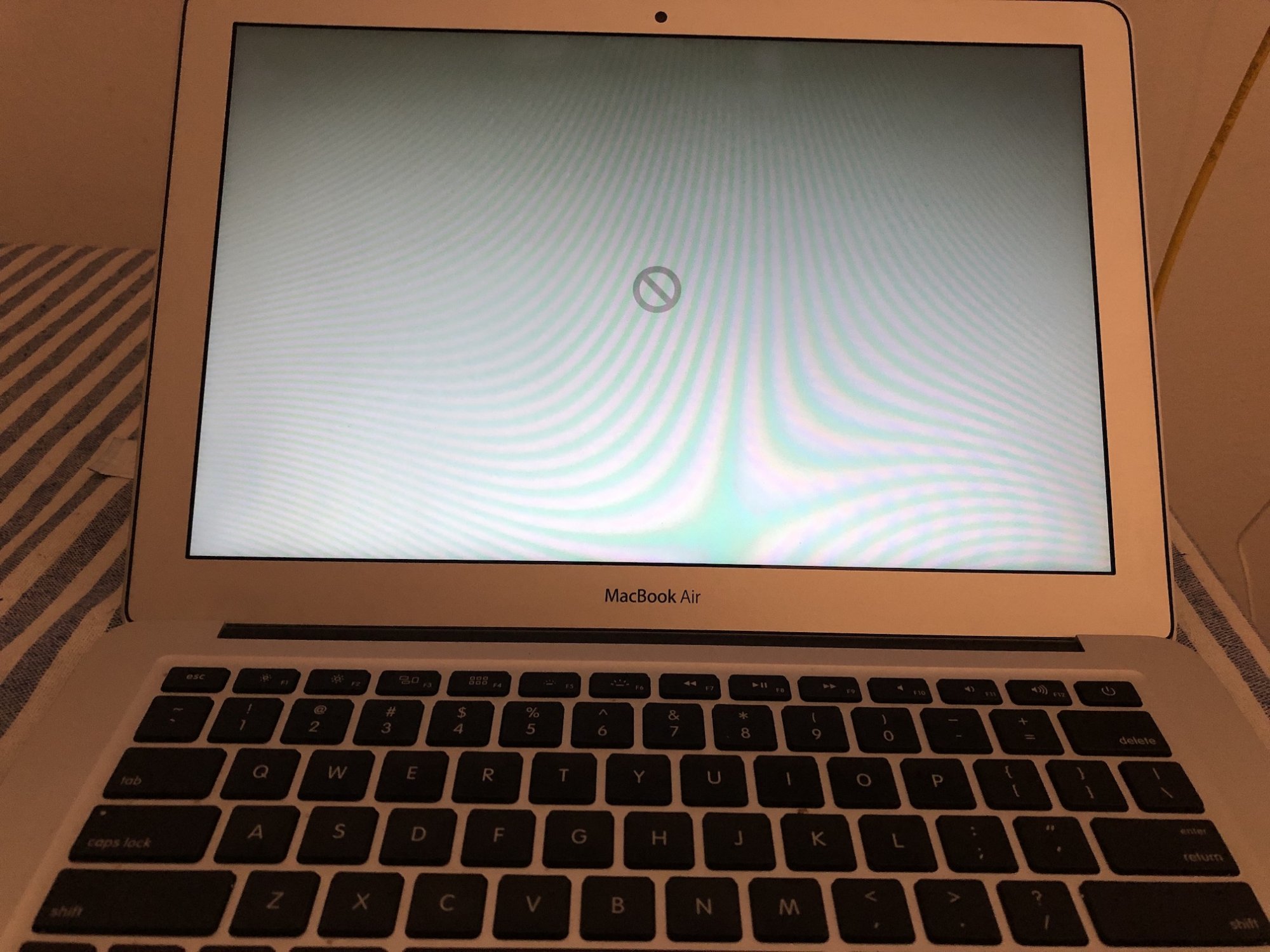

I tried to install it on a MacBook Air 13" 2012.
The install process worked, (reboot, update the EFI or something (big progress bar), reboot, 9minutes left, reboot) and got the screen below unfortunately.
Any idea what's this mean and/or if there is a way to get Big Sur on MacBook Air?
I'm going to do a recovery, and re-install macOS for now
This was right thing to happen and you are meant to trick NVRAM to not check the compatibility! Could be done via Terminal from macOS Catalina reinstall drive or perhaps - recovery option.
Just let it reboot, then push option key and open Terminal from recovery option and type nvram boot-args="-no_compat_check" would fix the issue.

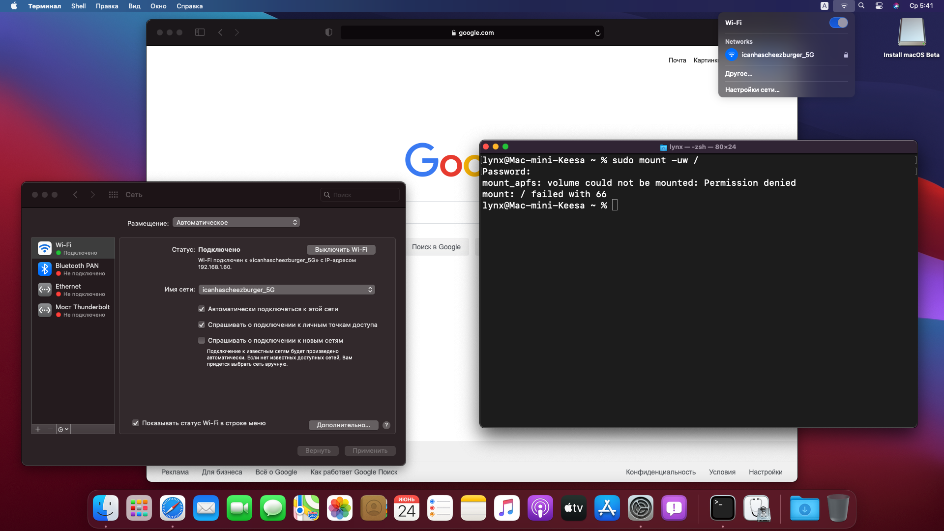

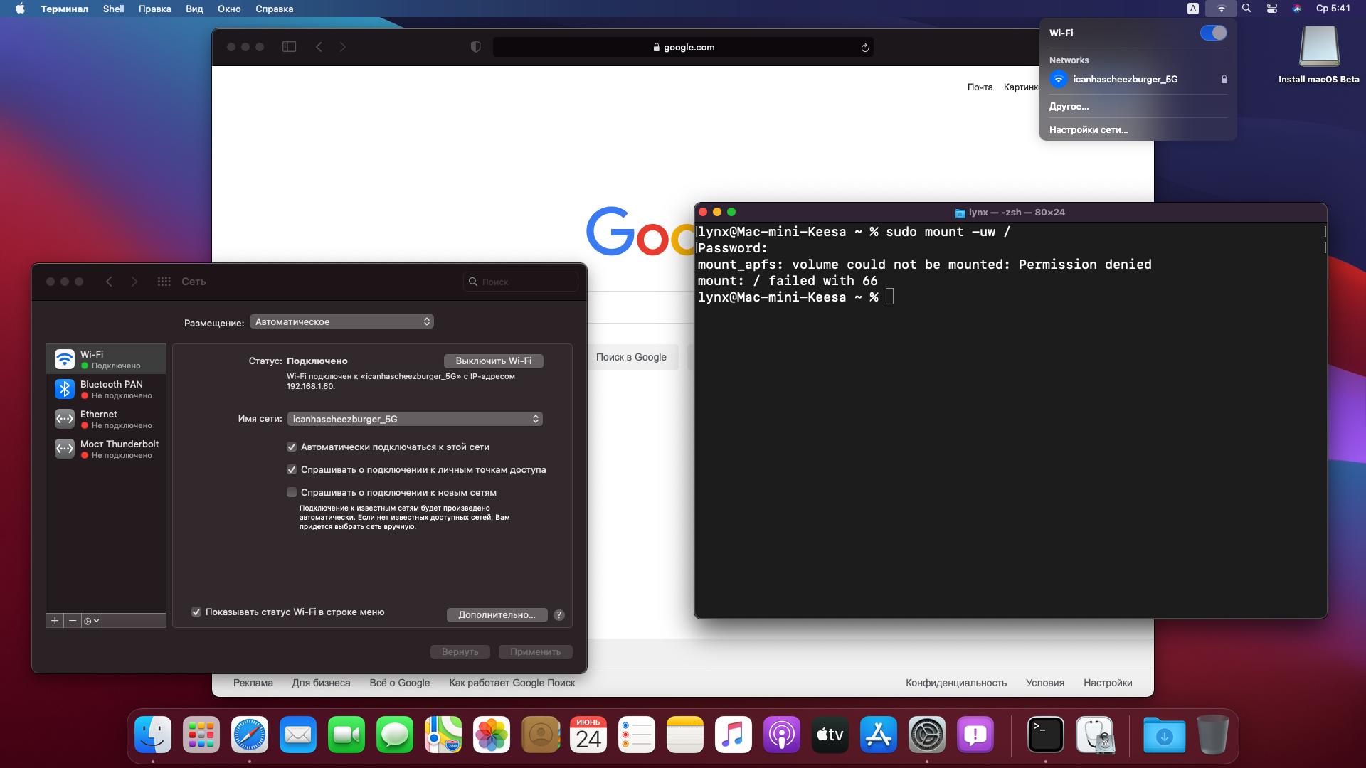

I've finished my guide on making wifi work with "failed with 66" error.
DO IT ON YOUR OWN RISK. THERE IS HIGH CHANCE OF DAMAGING YOUR OS AND HARDWARE.
NEVER DO IT ON MACHINE THAT HAS IMPORTANT DATA.
I'M NOT RESPONSIBLE FOR ANY DAMAGES, IT ALL ON YOU.
THE PROCESS IS COMPLICATED.
Huge thanks to @mac_4eva, @jackluke and @highvoltage12v for their research and hints.
Enjoy: https://medium.com/@andv/making-wif...d-macs-with-failed-with-66-error-36c98e3f7965

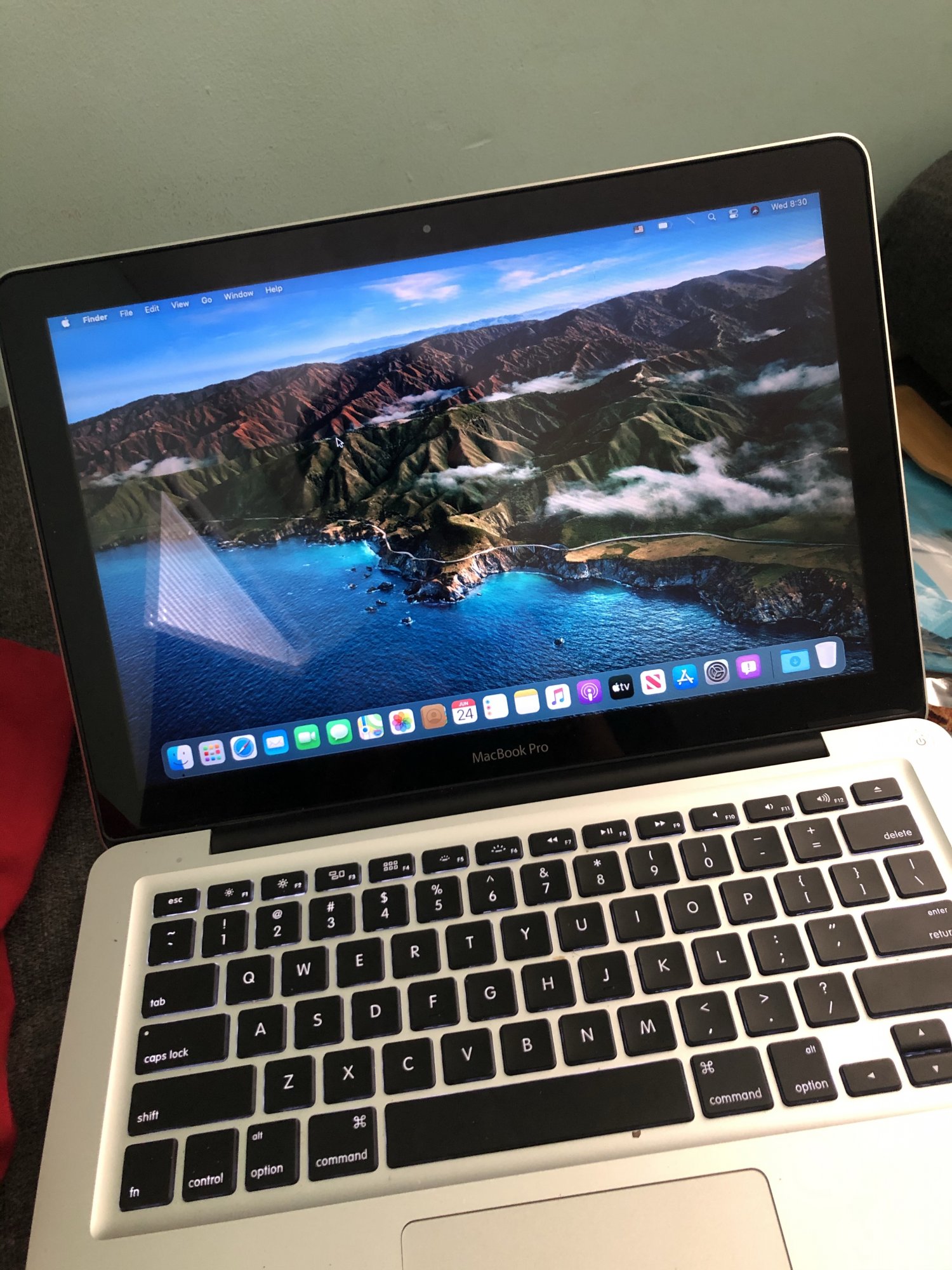

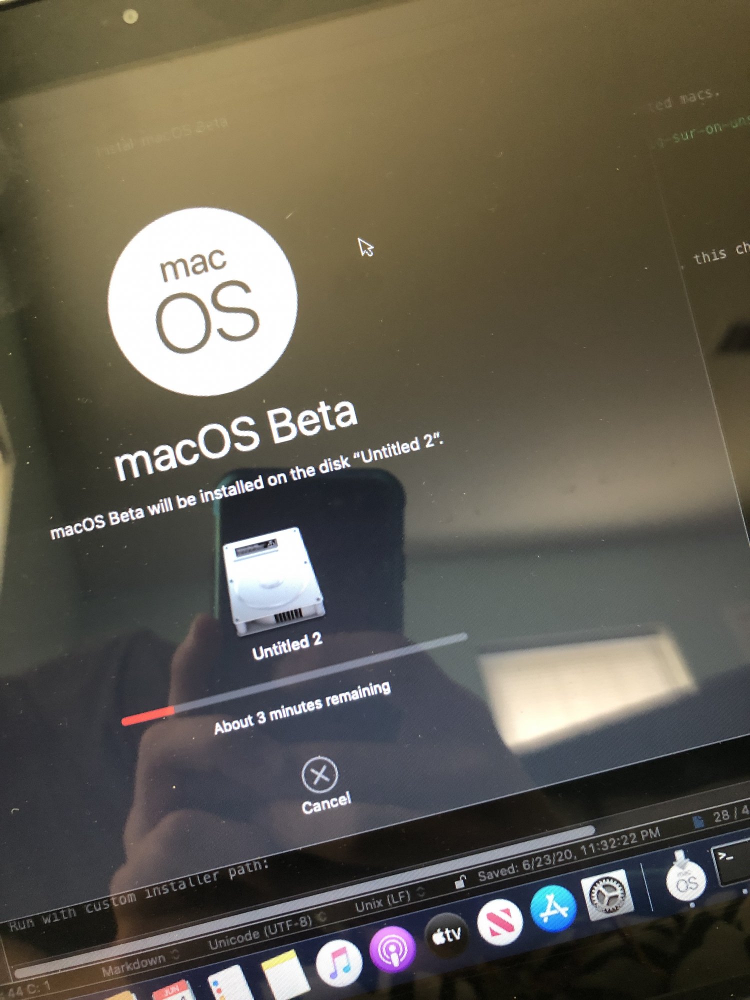

Finally after all the errors it threw at me. It took about 15 minutes to install. Runs pretty damn good on a mid 2012 MacBook Pro. WiFi doesn’t work. But I still don’t understand why Apple would kill these devices if these devices can handle the software
I have same error, start recovery, open terminal and enter "nvram boot-args="-no_compat_check amfi_get_out_of_my_way=1" Then reboot and install will continue.

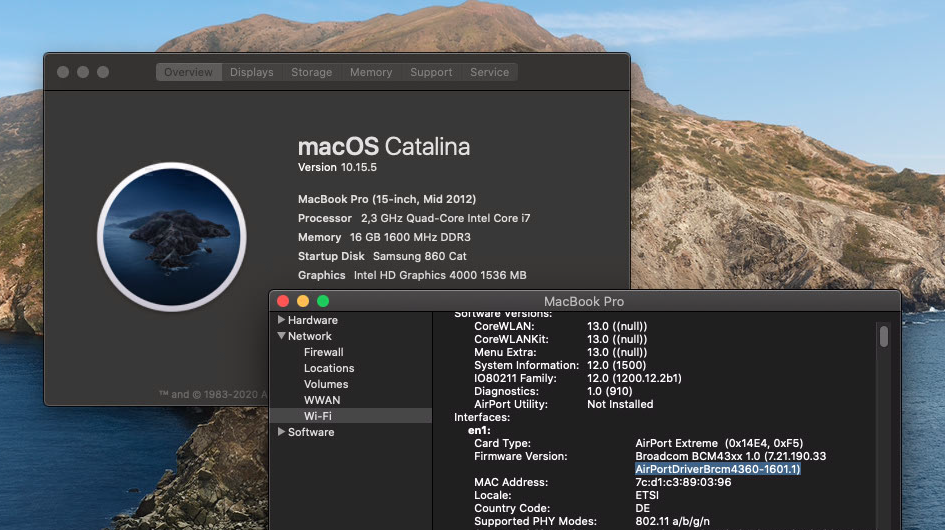

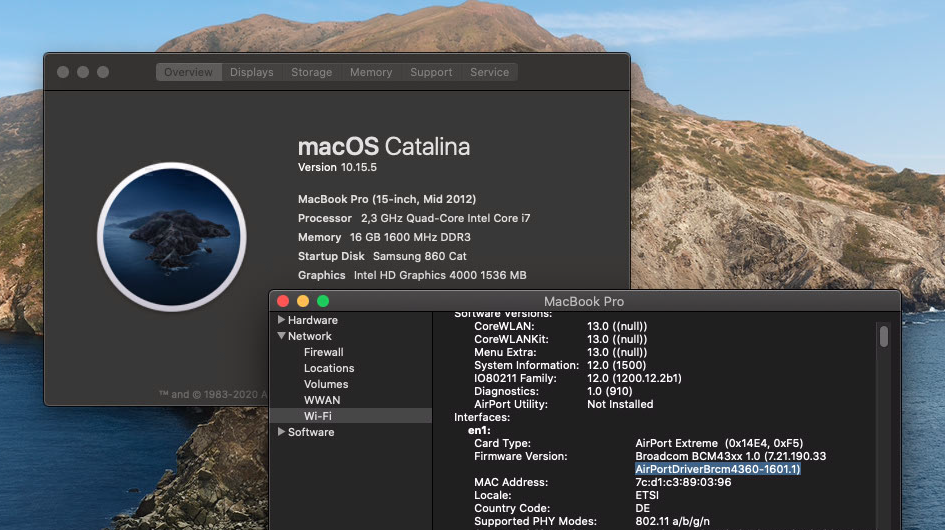

Updated my mac mini 2012 guide with info about wifi:
For enabling Wifi 802.11n on any 2012 Mac or any other unsupported Big Sur but supported Catalina Mac (in few words those who use the AirPortBrcm4360 driver), this will work:
To install it properly, simply open a BigSur terminal and copy paste (one line at once) :
Code:
sudo mount -uw / ; killall Finder
cd /System/Library/Extensions/
sudo mv IO80211Family.kext IO80211Family.backup
open /System/Library/Extensions/
copy using Finder the IO80211Family.kext from the link attached
return to BigSur terminal and continue typing:
sudo -s
chown -R 0:0 /System/Library/Extensions/
chmod -R 755 /System/Library/Extensions/
kmutil install --update-all
kcditto
At next reboot you should have a working Wifi 802.11n and a working AirDrop channel.
