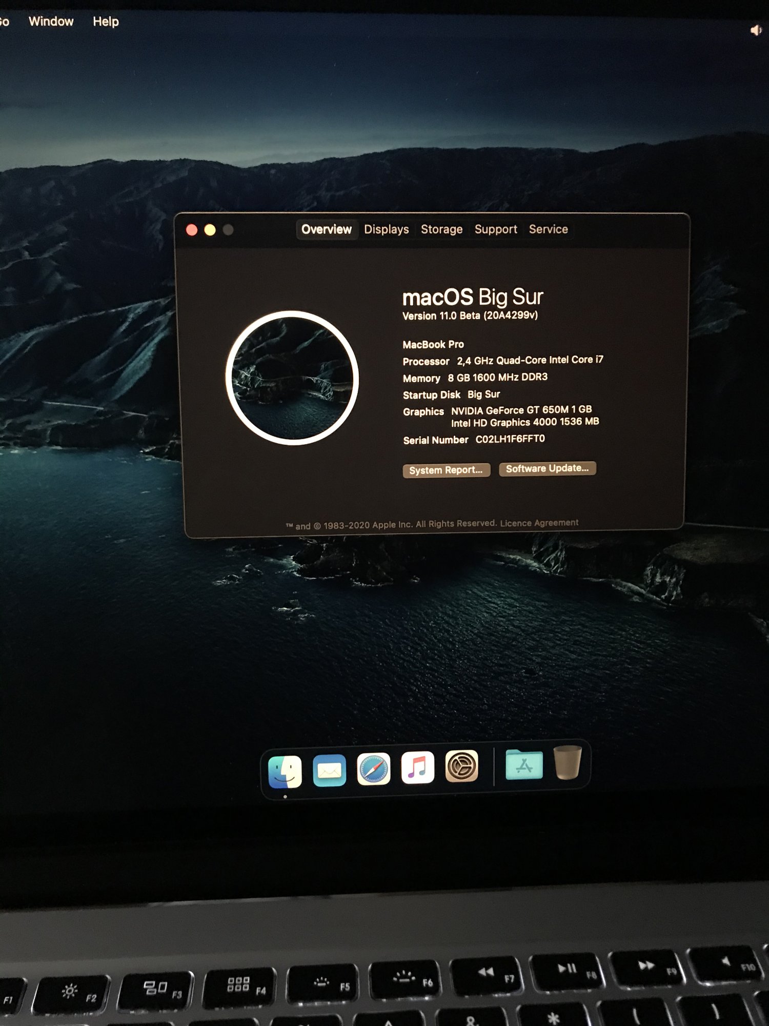

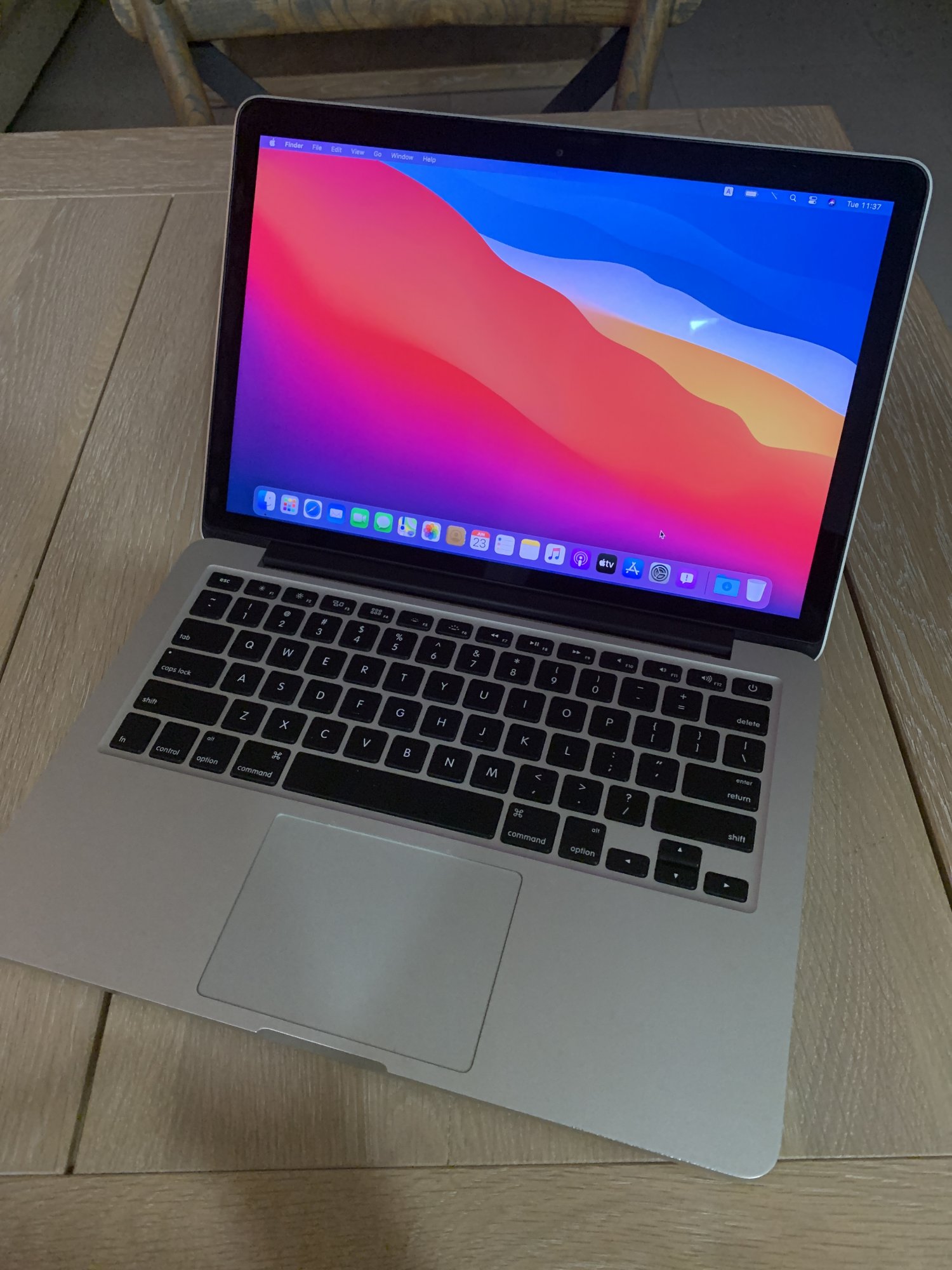

Anyone, any success with MBP retina early 2013?
Yep

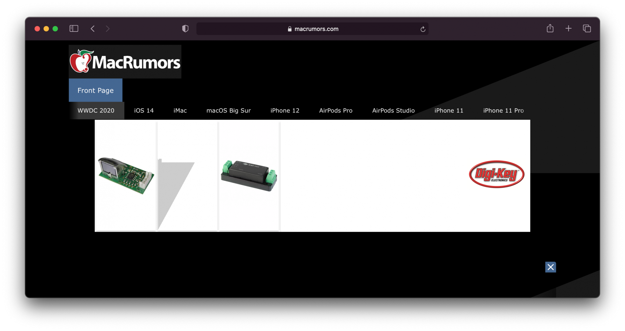

It works so similar to Catalina it even has the same quirks such as Safari rendering bugs on a few sites like MacRumors. Just happens randomly. Most of the time it's fine.

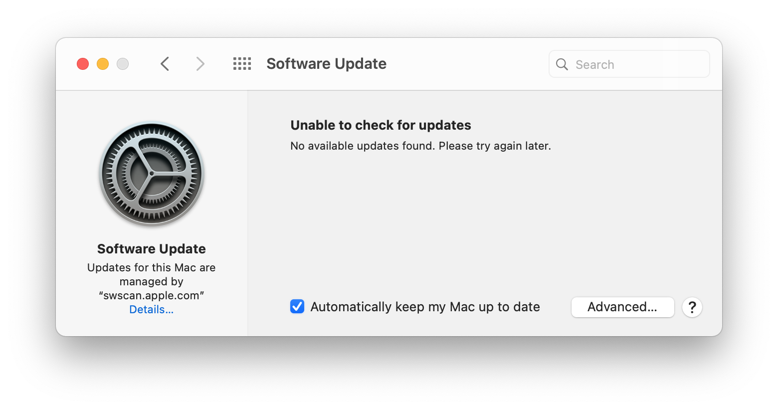

Does swscan.apple.com block updates for unsupported Macs?

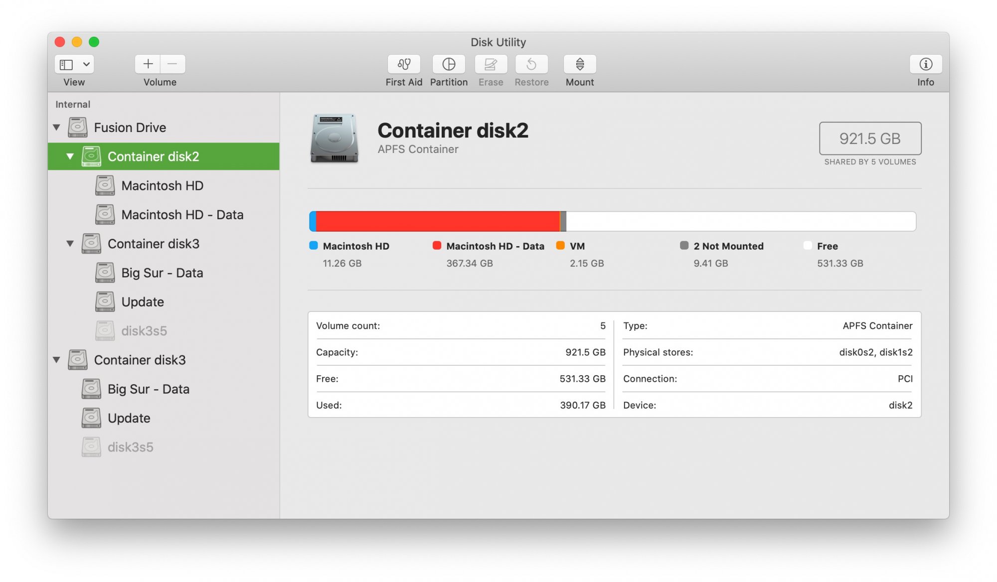

(I made a new partition for this install I recommend you guys do the same!) I also highly recommend this step. Don't add a new volume to the APFS Container which holds your Catalina install. Can cause problems with Catalina. Use Disk Utility to create a new partition, give it time to resize your APFS Container - took about half hour for me. I gave Big Sur partition 200gb to be on the safe side.

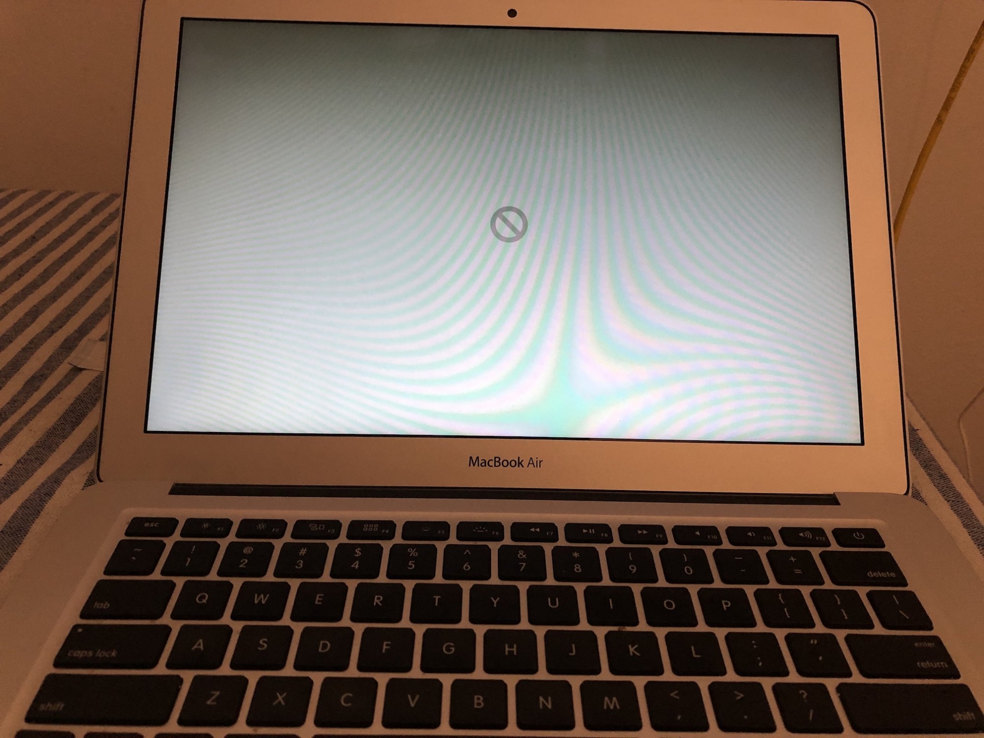

I tried to install it on a MacBook Air 13" 2012.
The install process worked, (reboot, update the EFI or something (big progress bar), reboot, 9minutes left, reboot) and got the screen below unfortunately.
Any idea what's this mean and/or if there is a way to get Big Sur on MacBook Air?
I'm going to do a recovery, and re-install macOS for now

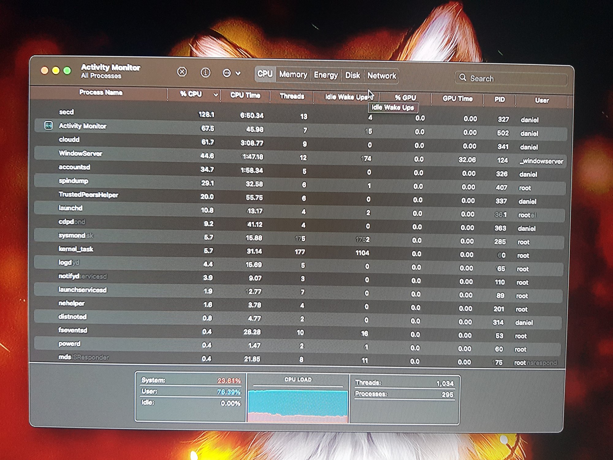

Although I can confirm that Mac mini (Late 2012, i5 with 16GB RAM) is capable running macOS Big Sur - with hardware acceleration working without further driver migration task, I decided to just go back to Catalina just because the process called 'secd' keep (wastes) uses nearly 80% of CPU. This keep happens even if I clean install, so maybe it is something to do with the unstableness of beta version.
