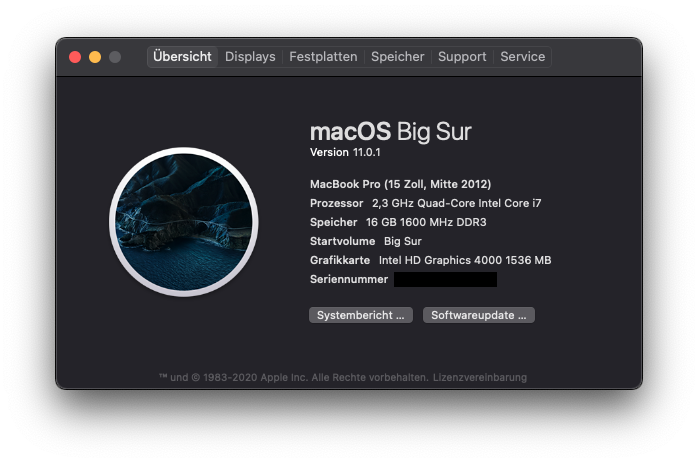

Hi,
I am reading this thread since the first Beta because I am using a 15" MBP 2012 non retina (former MBP 2011 with replaced logic board) and was disappointed to see that Big Sur isn't supported by my Mac. Again, since I used High Sierra for over a year after Mojave release (which wasn't supported by it) till I replaced the logic board.
I have to thank all of you who make this patchers happen! Now I wanted to try it, too.
I successfully installed a fresh Big Sur on an external SSD, just followed Barrys Tutorial, really easy. I will test it for a while and if everything works I will replace my system on the internal SSD. I think I'll wait until the release of 11.1.
What I can say is that on this fresh system everything works so far. :)

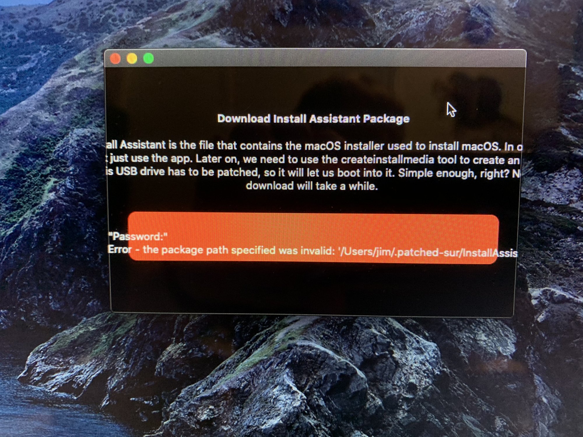

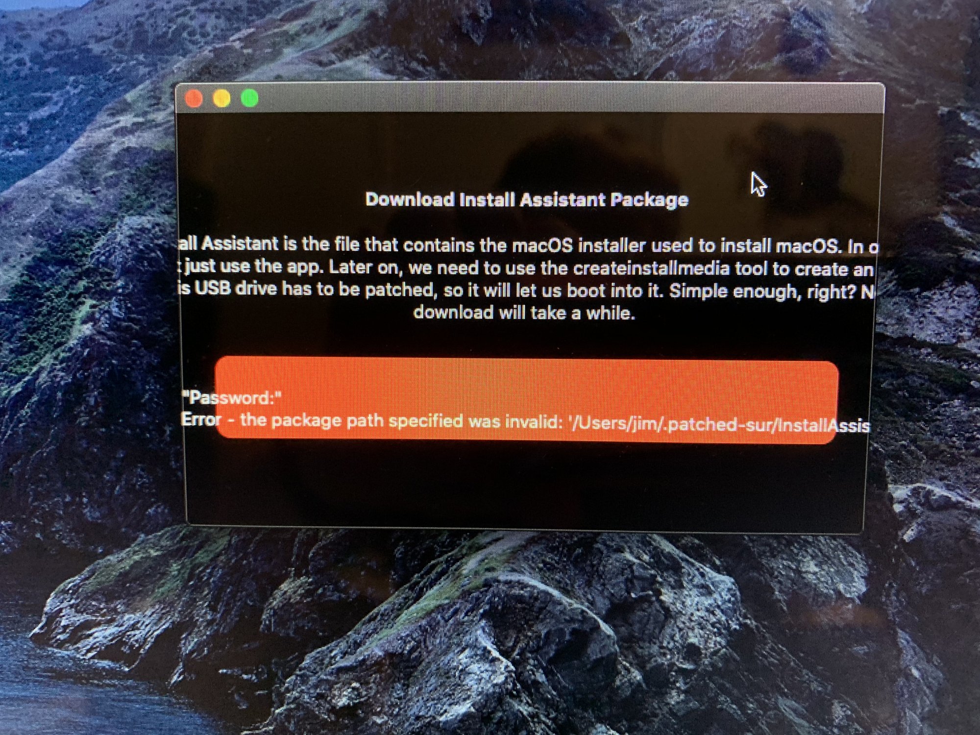

I have a 2012 Mac Pro with a Radeon HD 7950 graphics. I have a hard drive ready, GUID partitioned. Mac OS Extended(journaled) format. I downloaded:
https://github.com/BenSova/Patched-Sur/releases/download/v0.0.3/Patched-Sur.dmg
Followed directions. Ended with this:
What am I doing wrong? I've tried it several times
Did you select public release? You could try downloading the install assistant directly from Apple, install it and then click View other versions in Patched Sur > Find an Installer and then select the Install MacOS Big Sur installer in your applications and see if that works.
Hope this helps.
