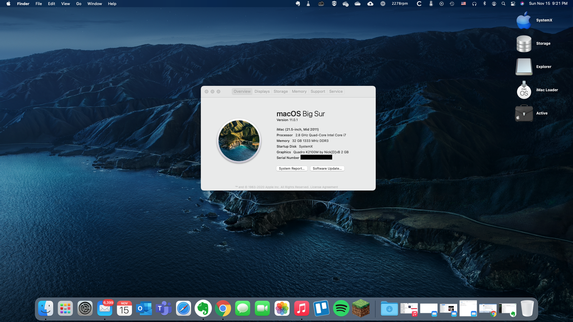

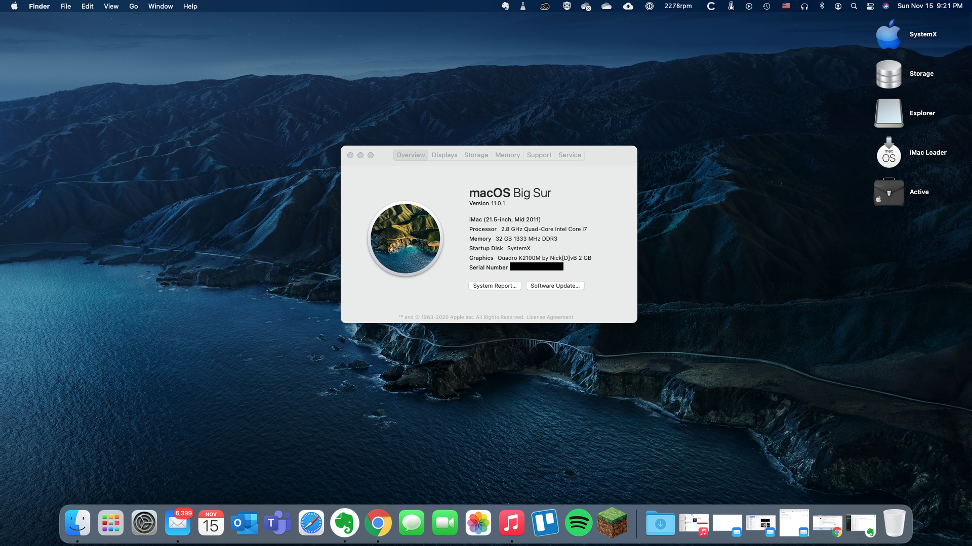

Installation successful on my iMac 2011 21.5" running the K2100m.
I followed the steps from barrykn on his Github page: https://github.com/barrykn/big-sur-micropatcher
I originally attempted Bensova's Patched-Sur utility, but kept getting an error during the USB boot drive creation so went with Barrykn's micropatcher. There is a lot of instruction and the whole tutorial seems quite intimidating, but, it is actually quite straightforward.
Started from Catalina 10.15.6 (I was lazy to update to 10.15.7 these days), patched with Dosdude's Catalina patcher, and booted on OC 0.6.2.
First, I updated my OpenCore USB boot drive to 0.6.3 by moving the EFI folder from the update image. Not sure it was necessary as the tutorial mentioned it's for iMac 2009/2010, but well, might as well.
Then followed the steps from the tutorial.
One thing I noticed, is during the installation the screen would go black. In total three times. What I did was to wait 20-30 mins each time and force reboot, until finally I was greeted by the login window.
From there, booted back from the Big Sur patched install USB, and ran the patch-kexts.sh script. Important if you boot from OpenCore, use the argument --useOC so that the script will install some of the required kext for OpenCore (like Lilu). So the command will look like /patch-kexts.sh —useOC /Volumes/'System_install_volume'
And there you have it. The system is indexing the volume right now so will be running stability tests, but so far it seems to work pretty well.
I am not using wifi on this Mac. It is hard wired to my home network. And Bluetooth seems to work fine with the Apple Keyboard and Magic Trackpad.
