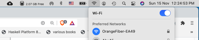

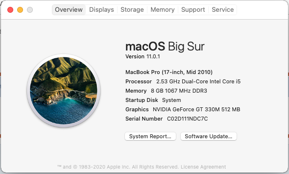

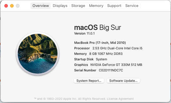

I would like to thank all the contributors to patchers of MacOS for legacy hardware; the list is huge.
Secondly, I guess some MacBookPro6,1 users, like myself, were wondering if BigSur can be installed on their machines or not.
I managed to make it, using jackluke method (see post 5692). I simply used the opencore package provided by him without any modification, then I moved to installation the usual he described.
I have an internal SSD as a harddisk, with 8 GB for memory.
The overall performance is not great, but somewhat reasonable. Opening apps and quitting them is ok. but hiding windows, minimizing them takes long time, as reported also by many other users.
May be of importance to many is that performance of media players (Vlc, Movist, 5kplayer, Elmedia Video pLayer) is very bad. In fact, there was no video output, or amazingly slow, probably because of lack of proper HW acceleration.
Other contributors in this thread are still looking for a solution to the HW acceleration. Let'ts hope they find a solution.
Edit: Wifit is working:
Many thanks

I got the bigsur working and wifi activated however, it only fetches the 2.4ghz network and not 5ghz network. So my main network is not visible even if I try ro join manually.
Many thanks

Hi jacluke. I still see that my post needs moderation. I am not sure why, but probably because it is my first post.
- As for your question, I can't recall now which one (purple or green). I was too excited that it worked :)
- I definitely applied the framebuffer fix, which explains the not so bad performance.
Aside from your questions. I honestlty tried to use @Barry K. Nathan micropatcher, but with no success. Most probably my bad. I also tried to use the automated solution proposed recently that is based on @Barry K. Nathan micropatcher with no success.
Anyway, many thanks for you efforts. Highly appreciated.
