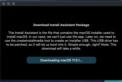

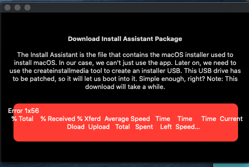

Hi , I have question , I have run the big sur patcher , when it opens it says it is downloading , but there is no progress bar or way to see how much is downloading , and after about 10 minutes it turns red and shows "error 1x56" , is there somthing I am doing wrong ? it does this on 2 mac mini late 2012 , one is fresh install of catalina , how do I get passed this error please , Thanks

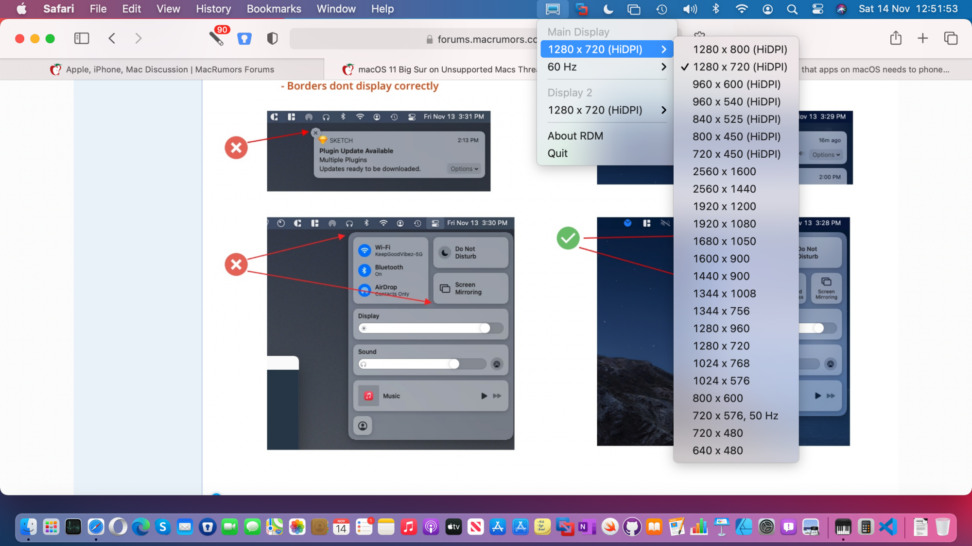

Big thanks to all involved to make this happen! Now I'm curious if I may have the desktop in higher resolution as well?
Reactions: TimothyR734

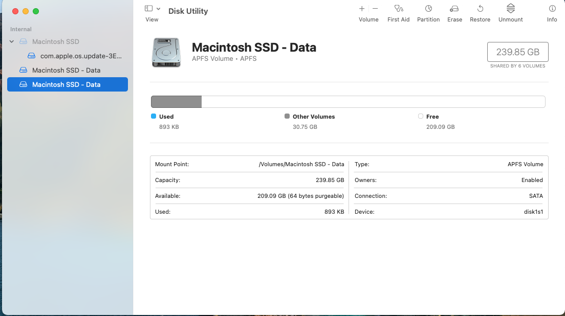

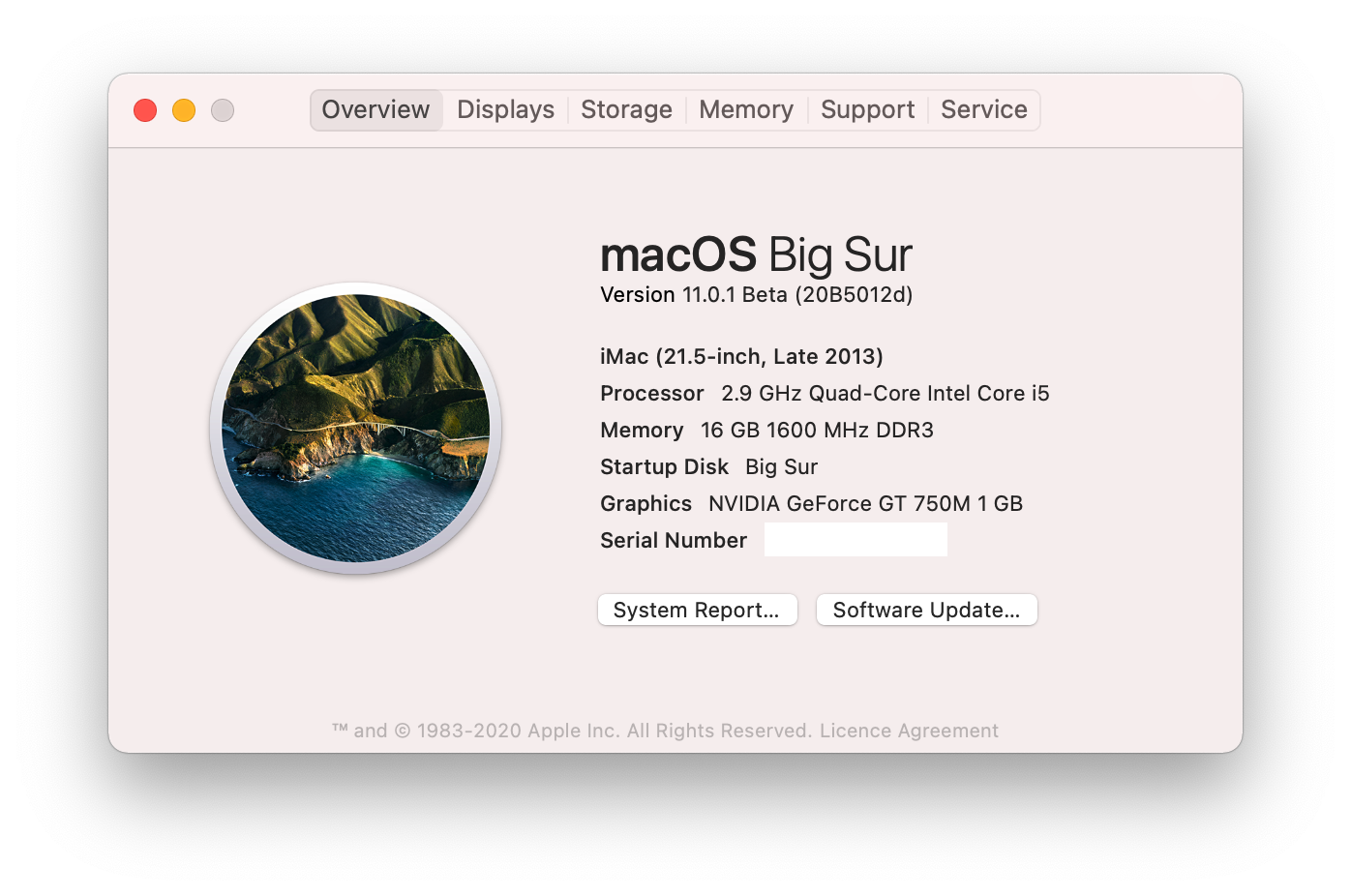

Got Big Sur installed on my 2013 iMac but is this normal under Internal Drive?

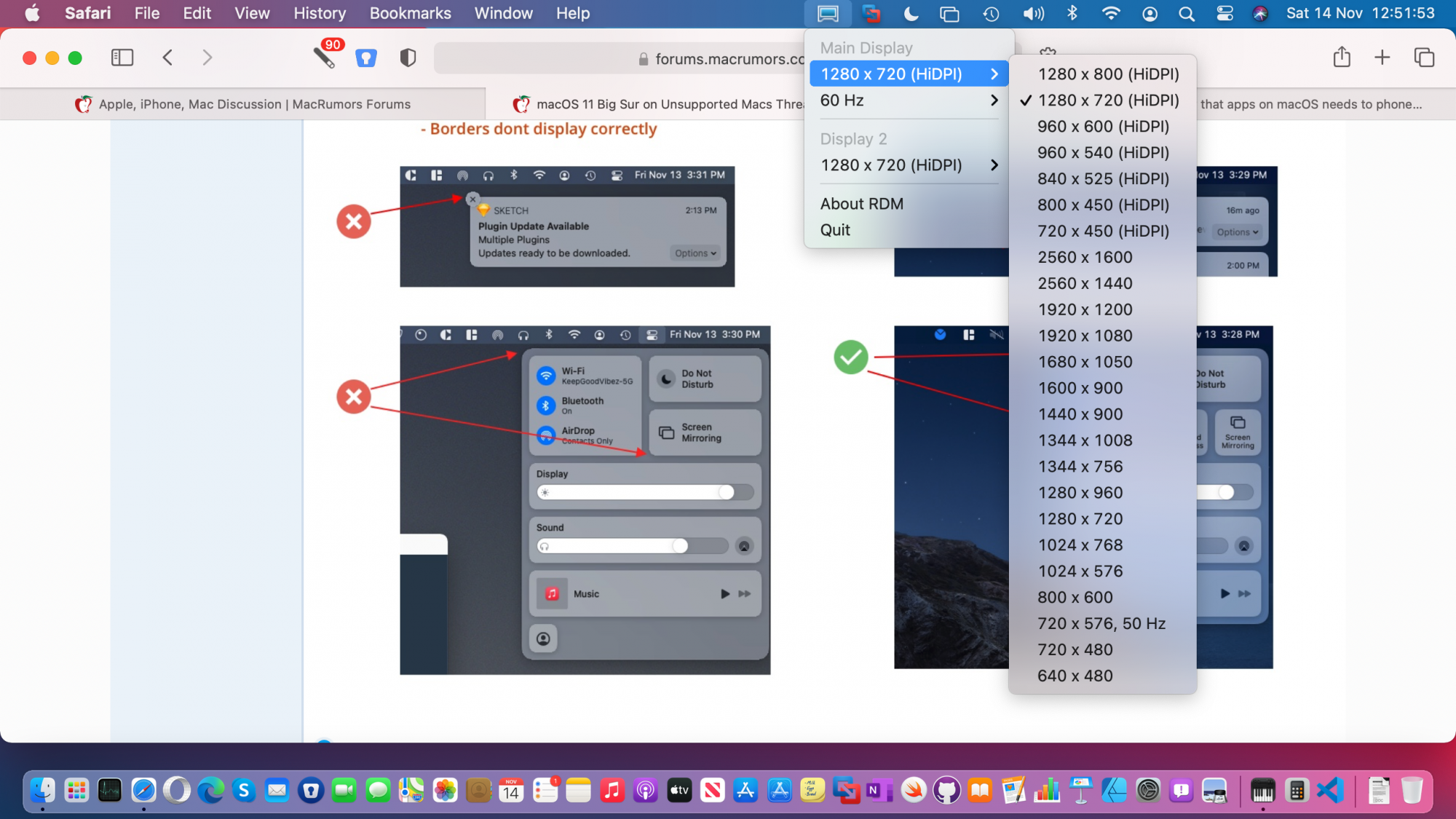

I am having trouble downloading via the patch , patch opens but then it gives error , have not seen a pics of what it should look like , don't know where to look for problem , can you help ?
When running patch this is all I see , how to get past this error , ? appreciate any help
