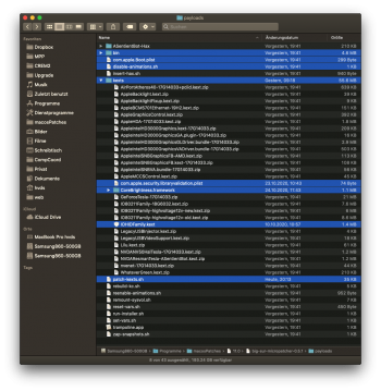

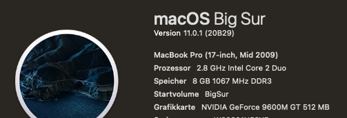

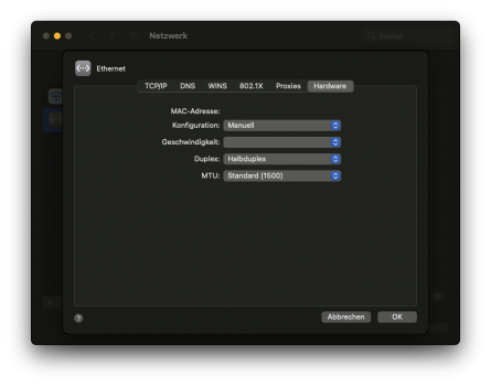

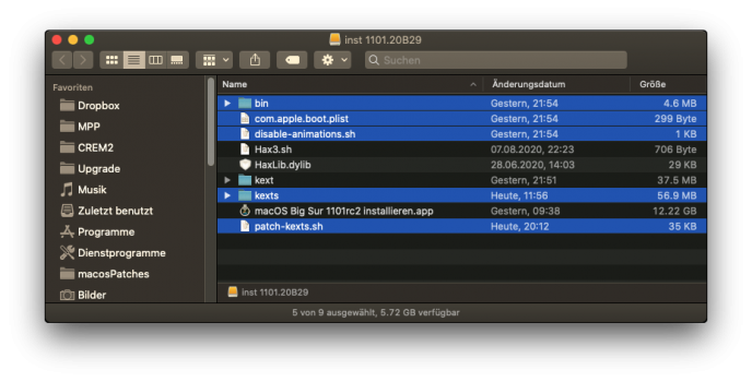

11.0.1 (20B29) on MBP5,2. Running fine but without graphics acceleration.
The two extra complications are: a) legacy USB, b) by my own choice, installation on an external SSD. I'm using jackluke's BigSur BaseSystem legacy usb fix to patch the result of createinstallmedia, and optionally the patch-kexts part of BarryKN's micropatcher 0.5.1. Not using OpenCore.

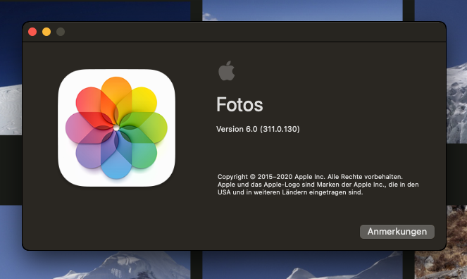

Photos app works since 11.0.1 with my data migrated from Catalina, while it crashed before.
Night Shift, USB mouse (no CMDS+S/exit boot needed), WIFI+Ethernet, internal audio work.

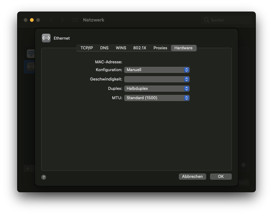

For Ethernet, using jackluke's fixes (legacy USB, framebuffer, snapshot) was not sufficient. In my network at home I need to set speed manually. That worked only after applying patch-kexts.sh which seems to use nvenet.kext differently.
It was very useful to apply disable-animations as BarryKN has recommended. Also did that now on Catalina.

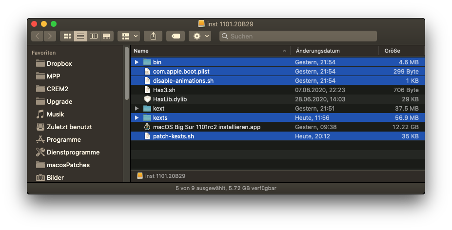

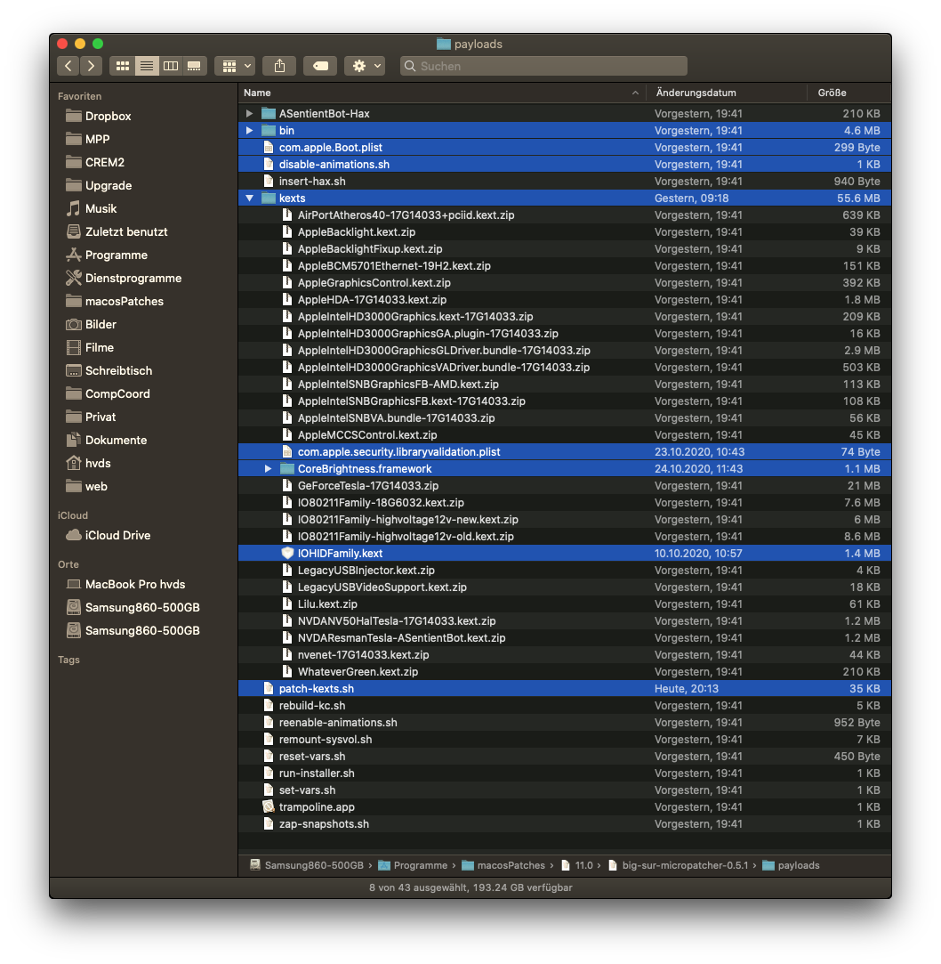

A word to my usage of micropatcher: I copied part of the micropatcher payload to the root of the USB installer after having done the BigSur BaseSystem legacy usb fix, to be able to use it from the same USB volume.
Also I had made an addition to the kexts used by patch-kexts earlier, and modified patch-kexts.sh accordingly. These changes I've now in 0.5.1. They are just for CoreBrightness (i.e. night shift) and IOHIDFamily (i.e. USB mouse with normal booting). - And they are anyway in jackluke's fixes.
For patch-kexts to run properly, had to remove kexts from Library/Extensions of the Big Sur volume (did that while booted from Catalina). Some had observed earlier that otherwise kmutil can fail. These kexts have crept in by migration from Catalina.
You might ask why do that for a system without graphics acceleration in sight. First, I'm responsible for maintaining a supported Mac (MBP11,1 2013) and would like to see how things look before upgrading it to BS.
Secondly, that's my kind of computer game. And I didn't give up hope on acceleration yet.
But my Catalina system must remain in its excellent working condition. With BS only on external SSD, and care to not implant an unwanted firmware upgrade, that should work.
THANKS dosdude for Catalina! Thanks jackluke, BarryKN and contributors!
(in oder not to overload this post further, I'll make an extra one with other installation exercises done)

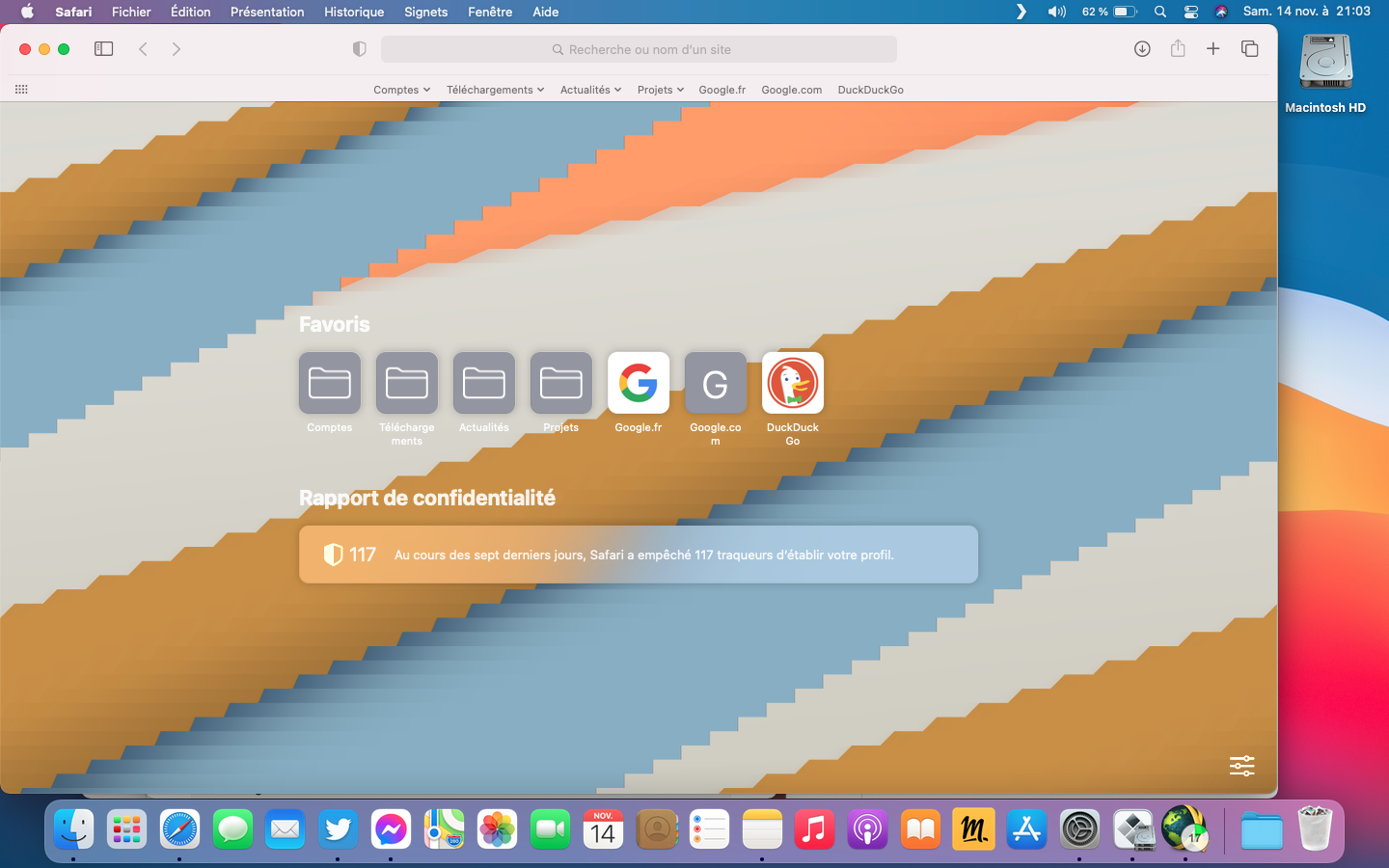

I've installed Big Sur on my 15-inch mid-2012 Unibody MacBook Pro and I have encountered a strange issue on Safari when I open a new tab: the background picture is heavily pixelated. When I change the background it looks normal for a second and it becomes pixelated.
Does anyone have the same issue?

mind me asking if your wifi is working ok on the mac? i'm connected to ethernet at the moment and cannot connect to a hidden network.
jackluke suggested something before but im not sure how to go about that process with the downloaded files.
WIFI works fine for me in Big Sur, but I had to try a few different commands in Terminal (see post #6011) before I got one to work. In Big Sur I only get 2 of 3 strength bars on WIFI, but in Catalina I get all four.
