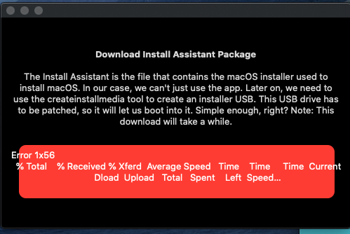

Hi can you offer some insight , every time I run that patcher it errors out with no explanation of why it fails ?

getting it to download is the problem I 'm having , it always gives this error how do I get it to download ?

I am having trouble downloading via the patch , patch opens but then it gives error , have not seen a pics of what it should look like , don't know where to look for problem , can you help ?
It's tough to know what steps you are doing/not doing, but check this video out as I think it's one of the better step by step guides I have seen so far.
Reactions: TimothyR734

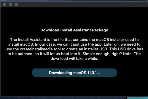

Thanks I will check that out , but the only steps I have taken is right click the .dmg and follow what it says , then it shows this that it is downloading , then the error message

seeing something I have not seen before , I can download anything from anywhere , except this patch , if I use the file I have I get the error shown , but all others including the one in the video I get this 0 bytes 0 bytes/sec when I do a search all I find is about video games , downloads stops at about 1MB , have no idea why
