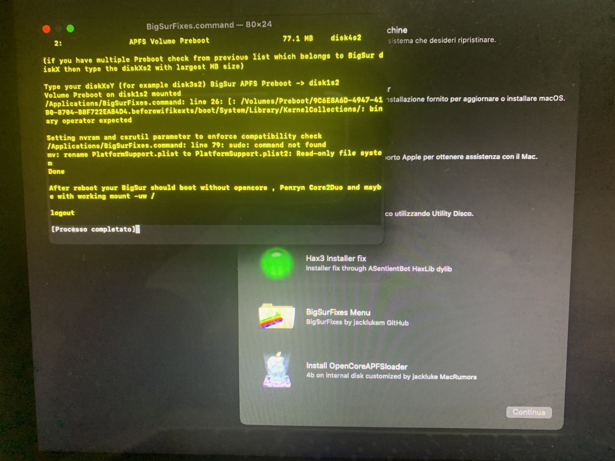

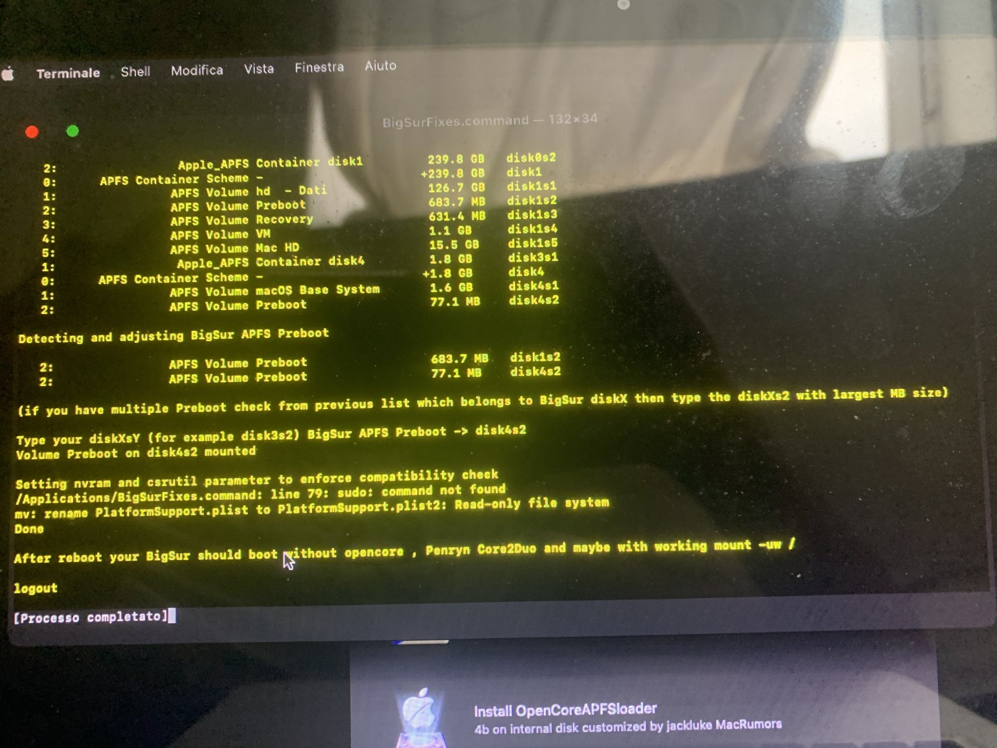

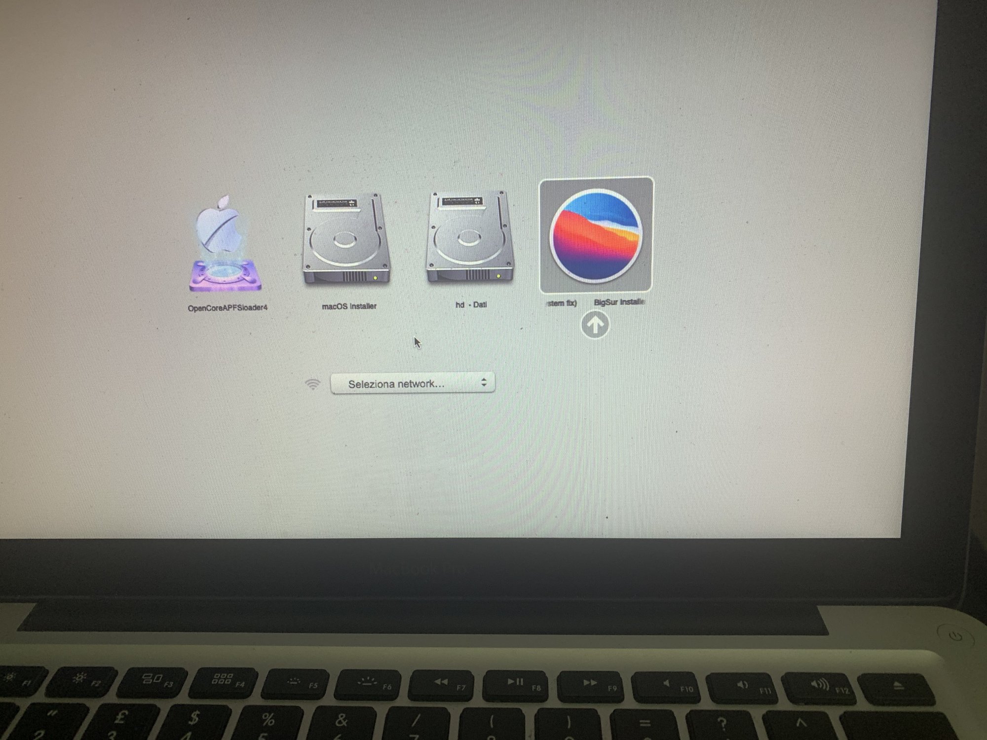

I have already tried, but it always returns this message as shown in the attached photo. I can't understand where I'm wrong. if you can help me I would be very grateful.

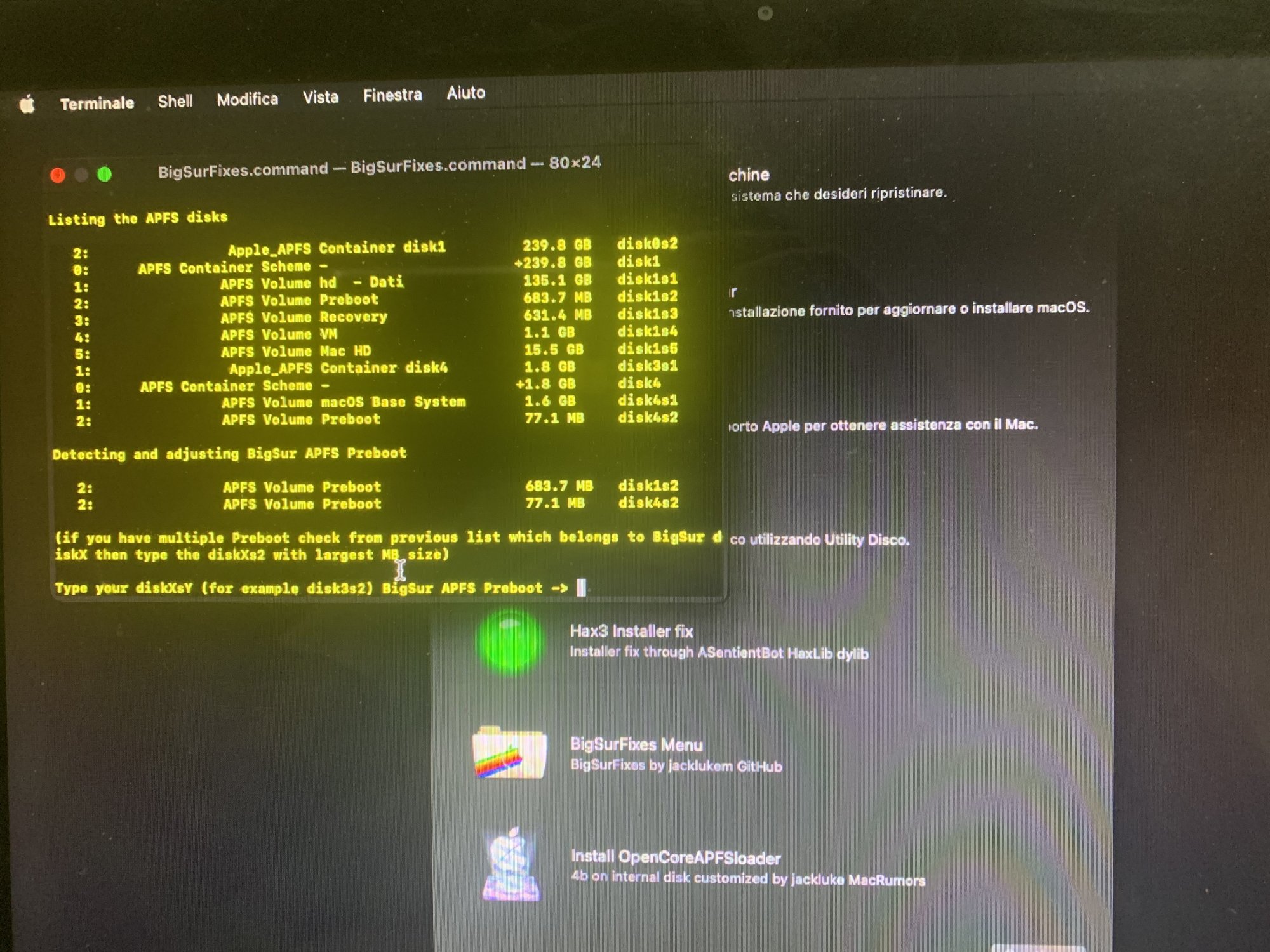

From your picture, for Preboot type exactly disk1s2 that is the largest MB (MegaBytes) Preboot volume that belongs to your BigSur installation on disk1s5, then the fix asks also for your BigSur System label type (from your picture): Mac HD

same result, no ask me for the correction and always returns the same message as in the photo.

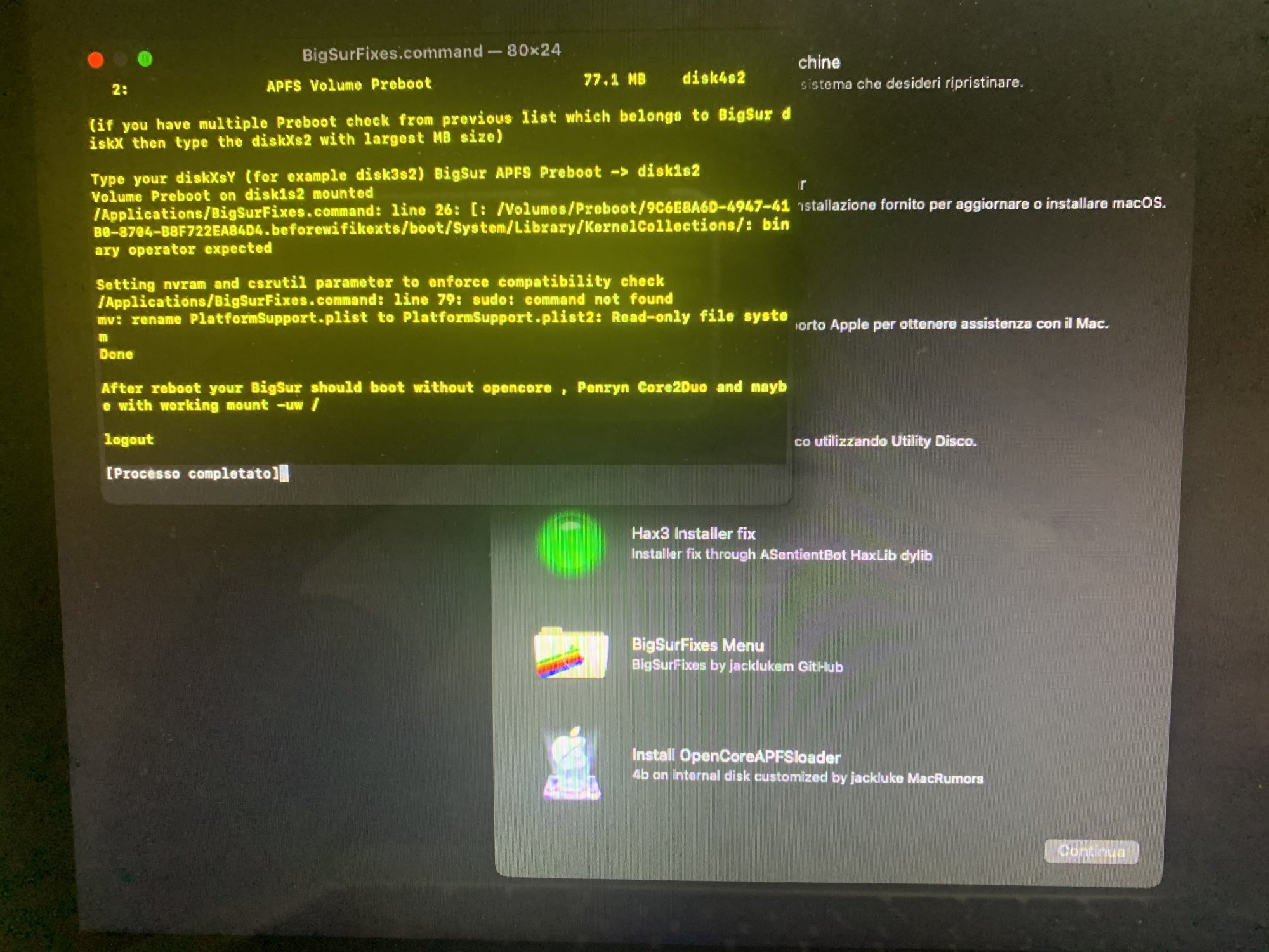

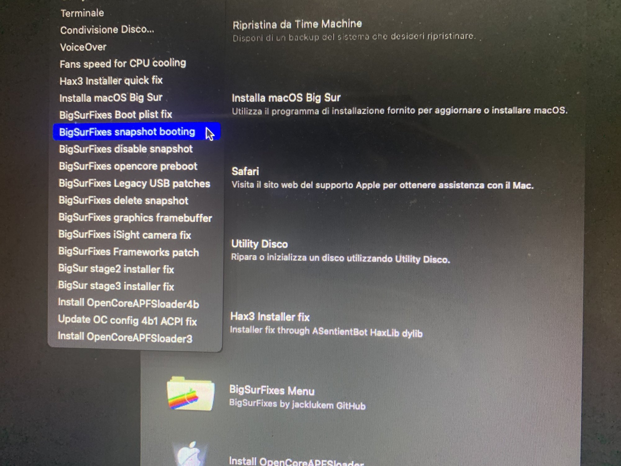

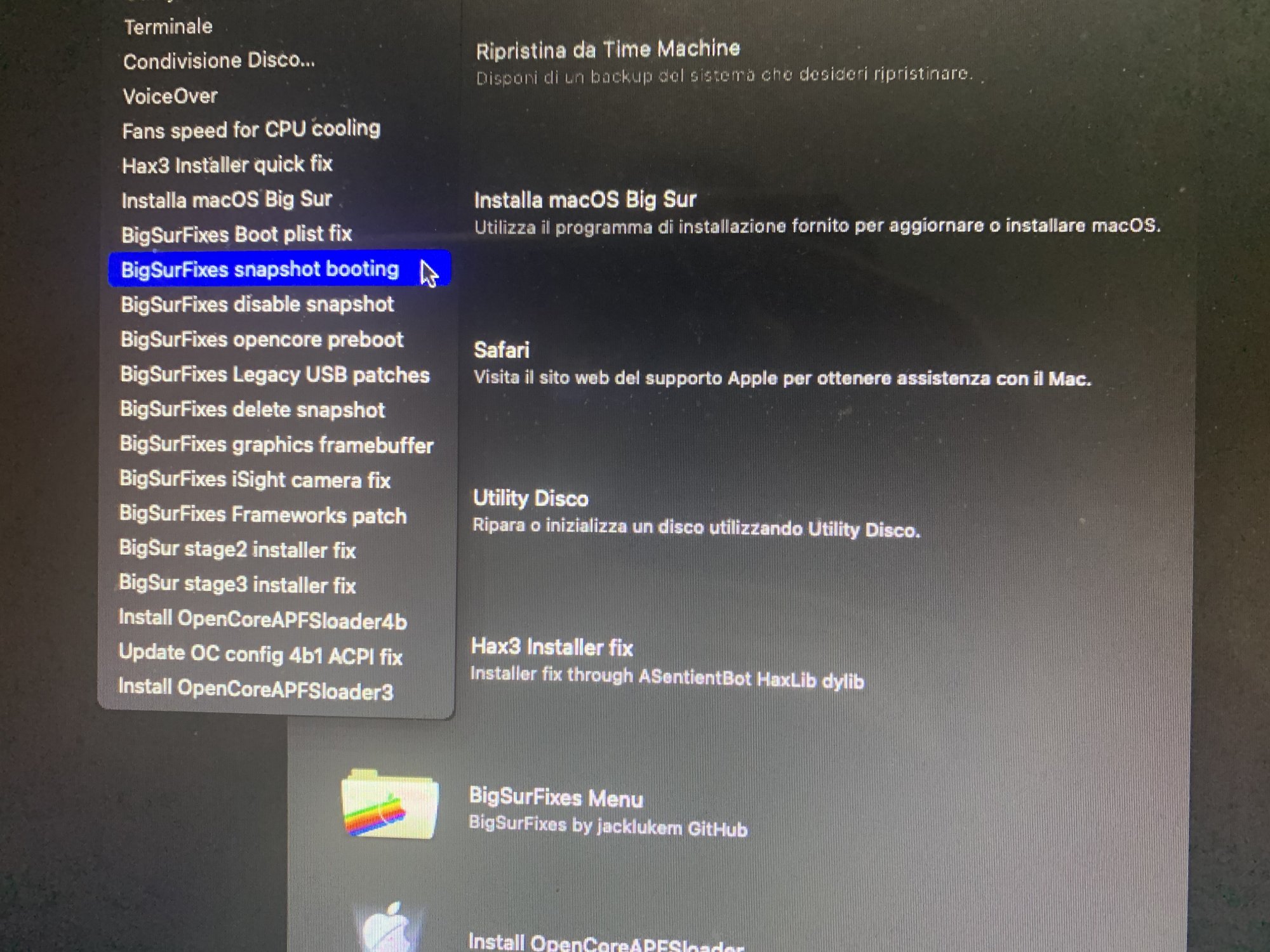

Post a picture where after you selected "BigSurFixes snapshot booting" you typed your BigSur Preboot (683.7 MB) diskXs2 (in your case it's disk1s2) you get an error message.

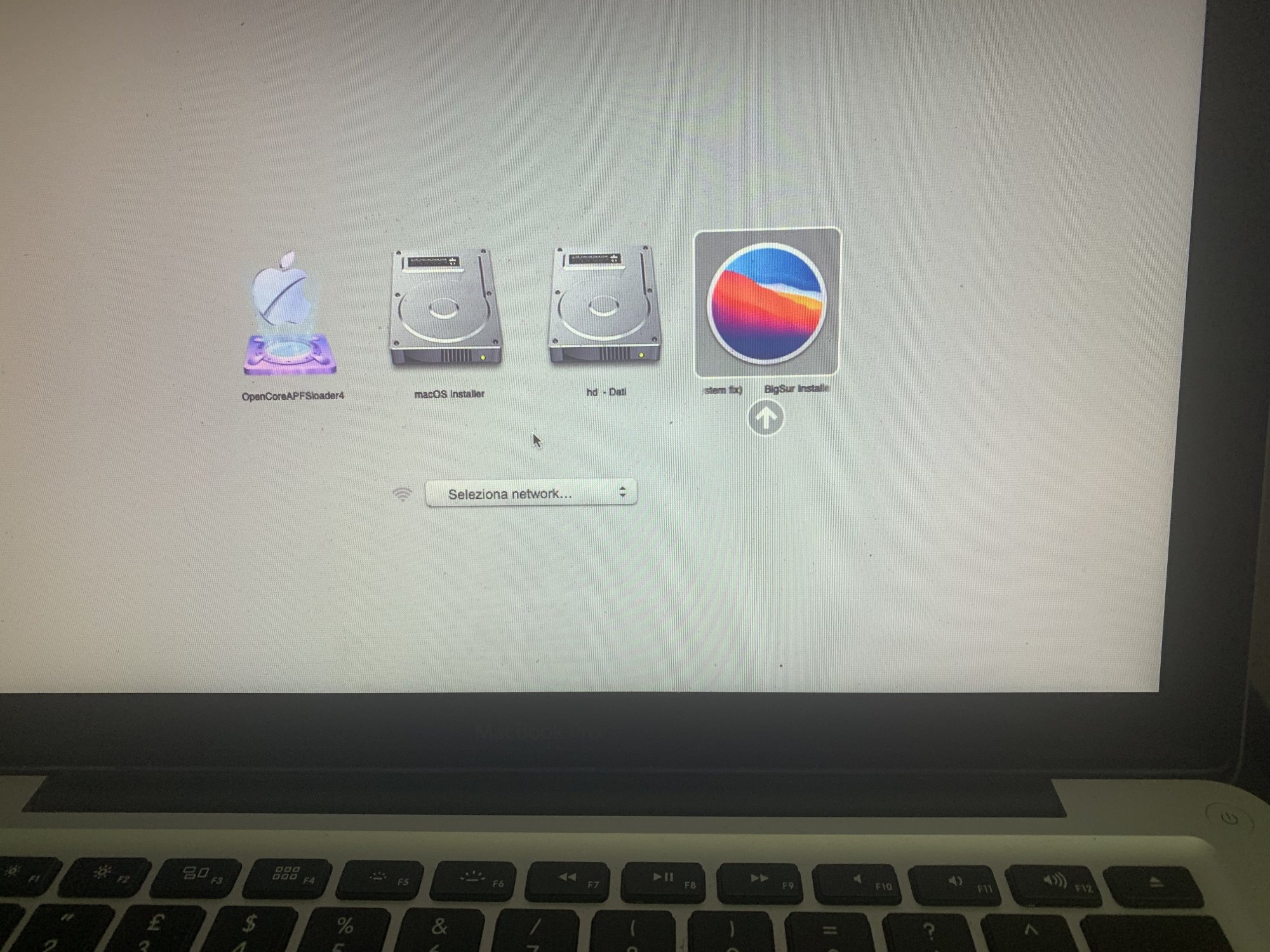

I have a major issued. On following the micropatcher step identically I completed making the boot usb with Bigsur. On pressing option key i saw all drives and last yellow drive efi. I selected efi and the imac shutdown. Now again on restart while pressing option key I dont see any drives but only get my imac fans on with plain white display.
Please advice what should I do to correct this.

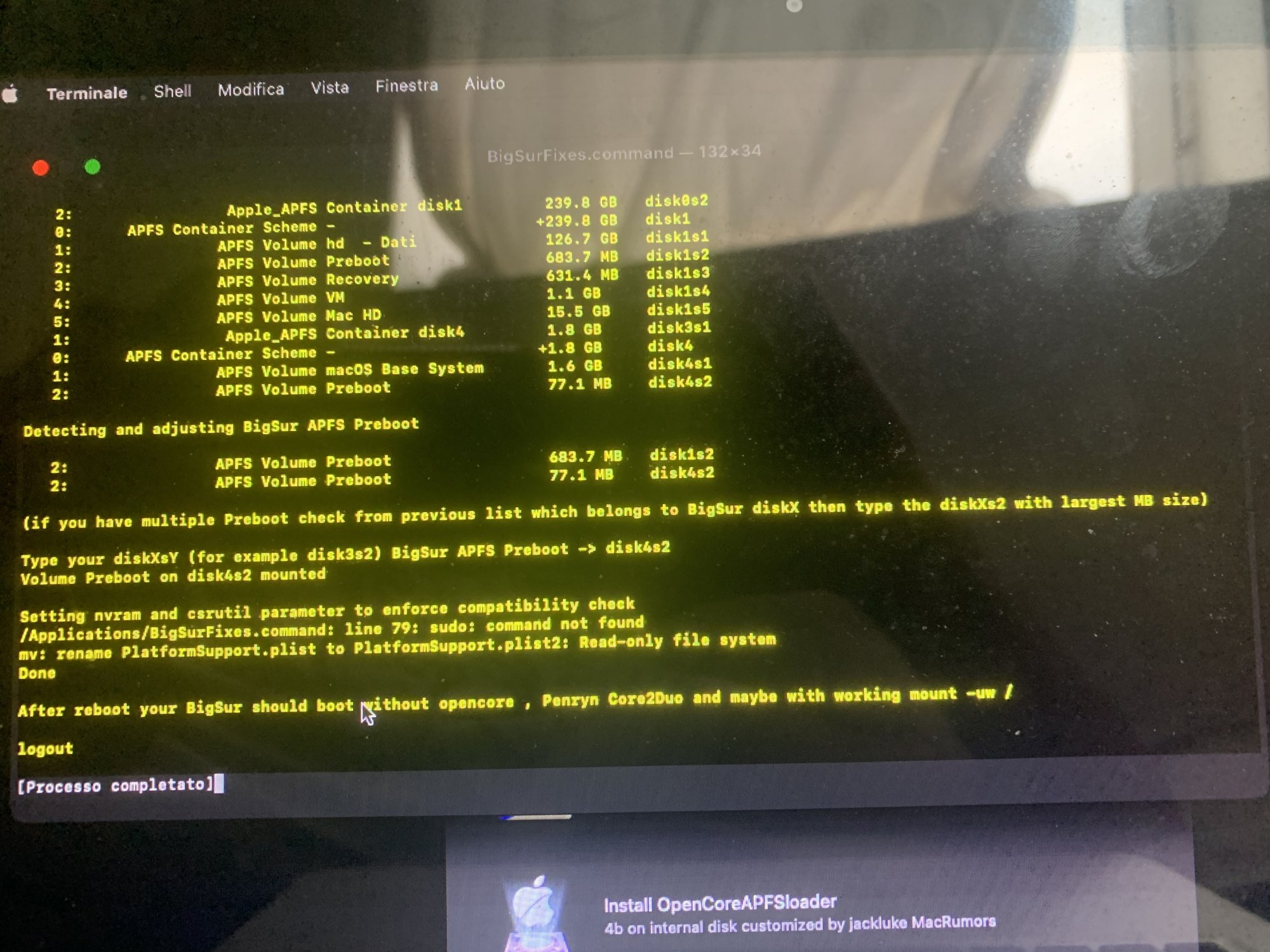

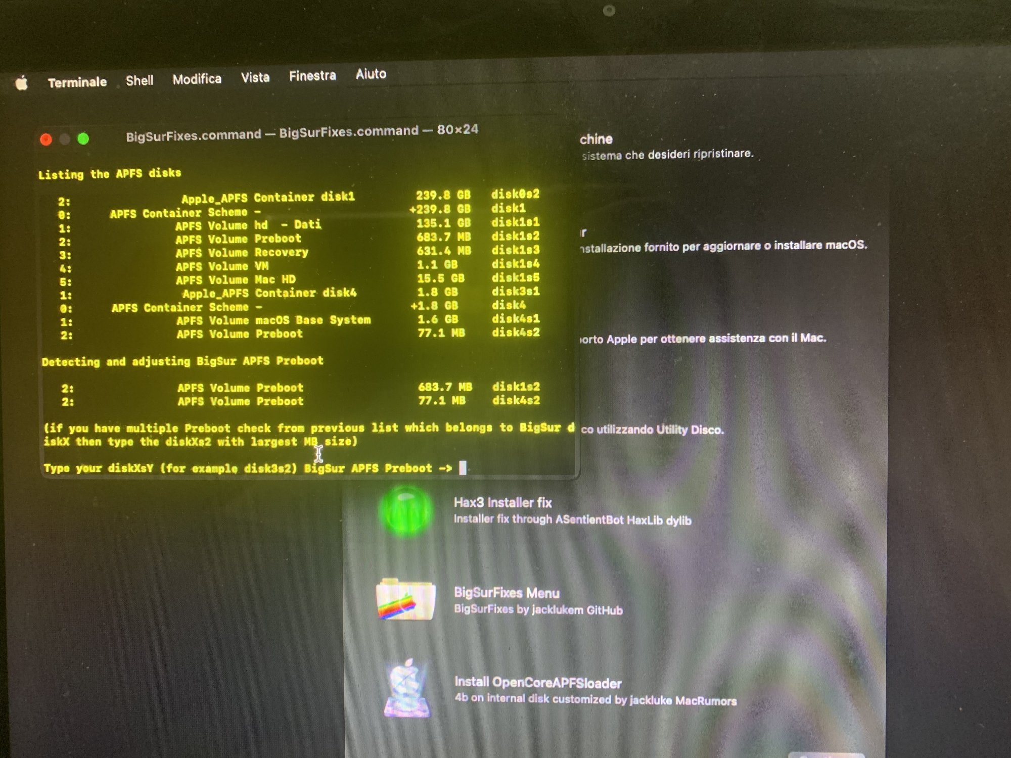

these are the various steps, but I always have this problem ... if instead I run the operation from opencore when I restart I no longer have the disk image and it does not restart.
View attachment 1666044View attachment 1666045View attachment 1666046View attachment 1666047
The issue you encountered is that you used probably micropatcher, because that additional Preboot .beforewifikexts folder is not made by "BaseSystem fix" (that also explains why your BigSur Preboot volume is 680 MB when typically size is around 350 MB ) .
Anyway you could try to fix this way, open from BaseSystem Utilities terminal and type:
Code:
diskutil mount disk1s2
mount -uw /Volumes/Preboot/
cd /Volumes/Preboot/
rm -r *.beforewifikexts
then close and from Utilities menu retry "BigSurFixes snapshot booting", it should work.
After this fix opencore is not required, but to boot also through opencore you should apply "BigSurFixes opencore preboot".
edit:
I just updated BaseSystem fix to include this script on "BigSur stage3 installer fix" for those who during any BigSurFixes encountered that Preboot ".beforewifikexts" folder.
Reactions: TimothyR734

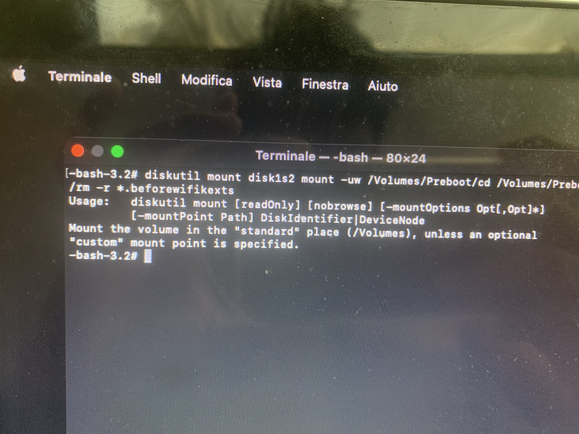

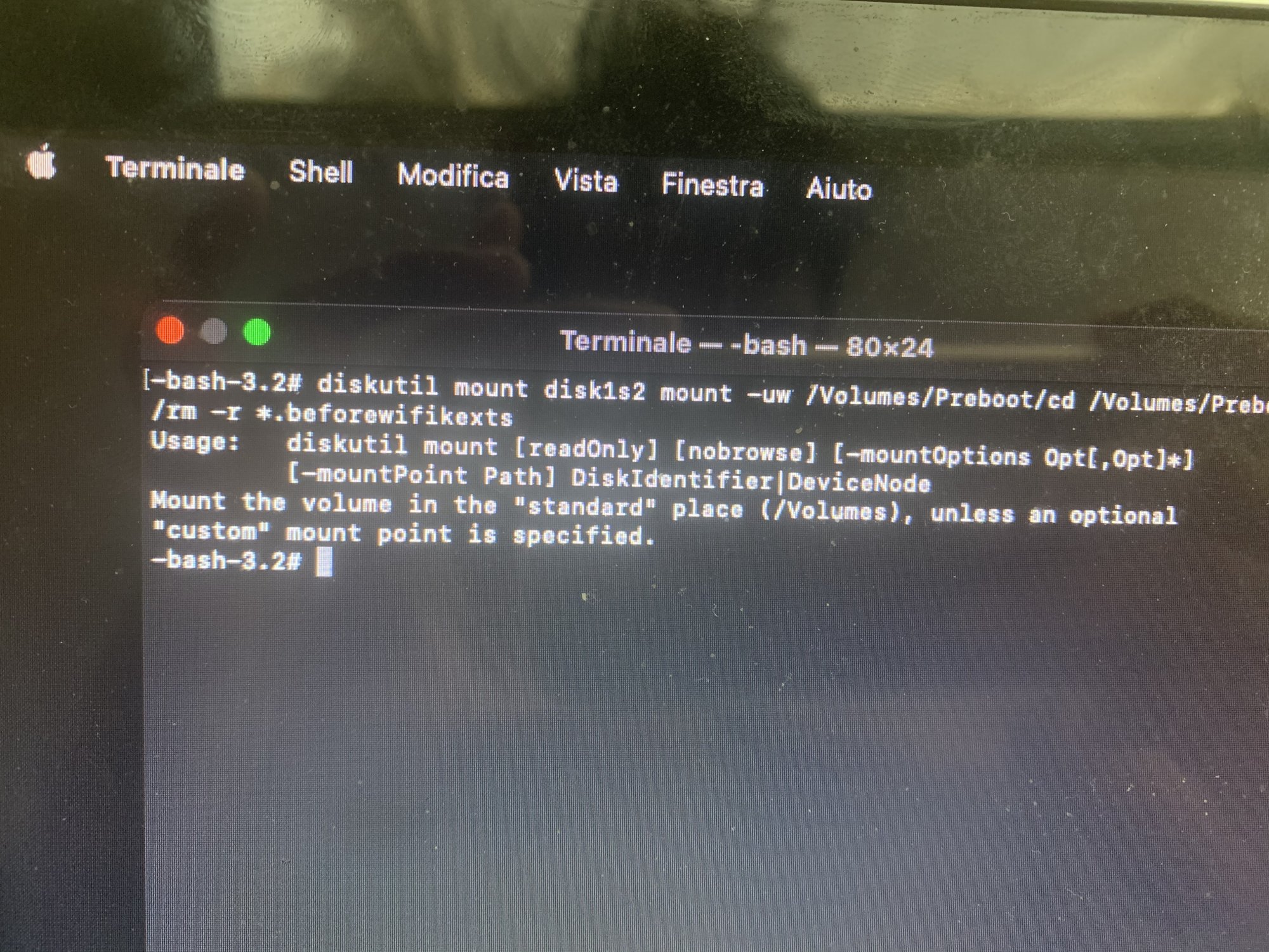

unfortunately to me it has always been an error even when entering in the terminal as you suggested.
I edited that previous post, retry and this should work :
Code:
In few words from Preboot volume you need to delete that .beforewifikexts folder, because in my BigSurFixes I assume that there is only one Preboot UUID for BigSur kernelcollections (as it normally is), after that script your Preboot diskXs2 is halved to about 350 MB that is the correct BigSur Preboot size.

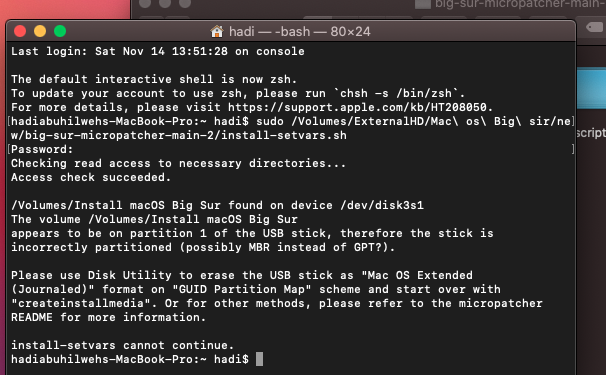

This error came up when applying the last part , dragging install stevars ? any tips
Code:
excuse my stupidity, but what am I wrong??
